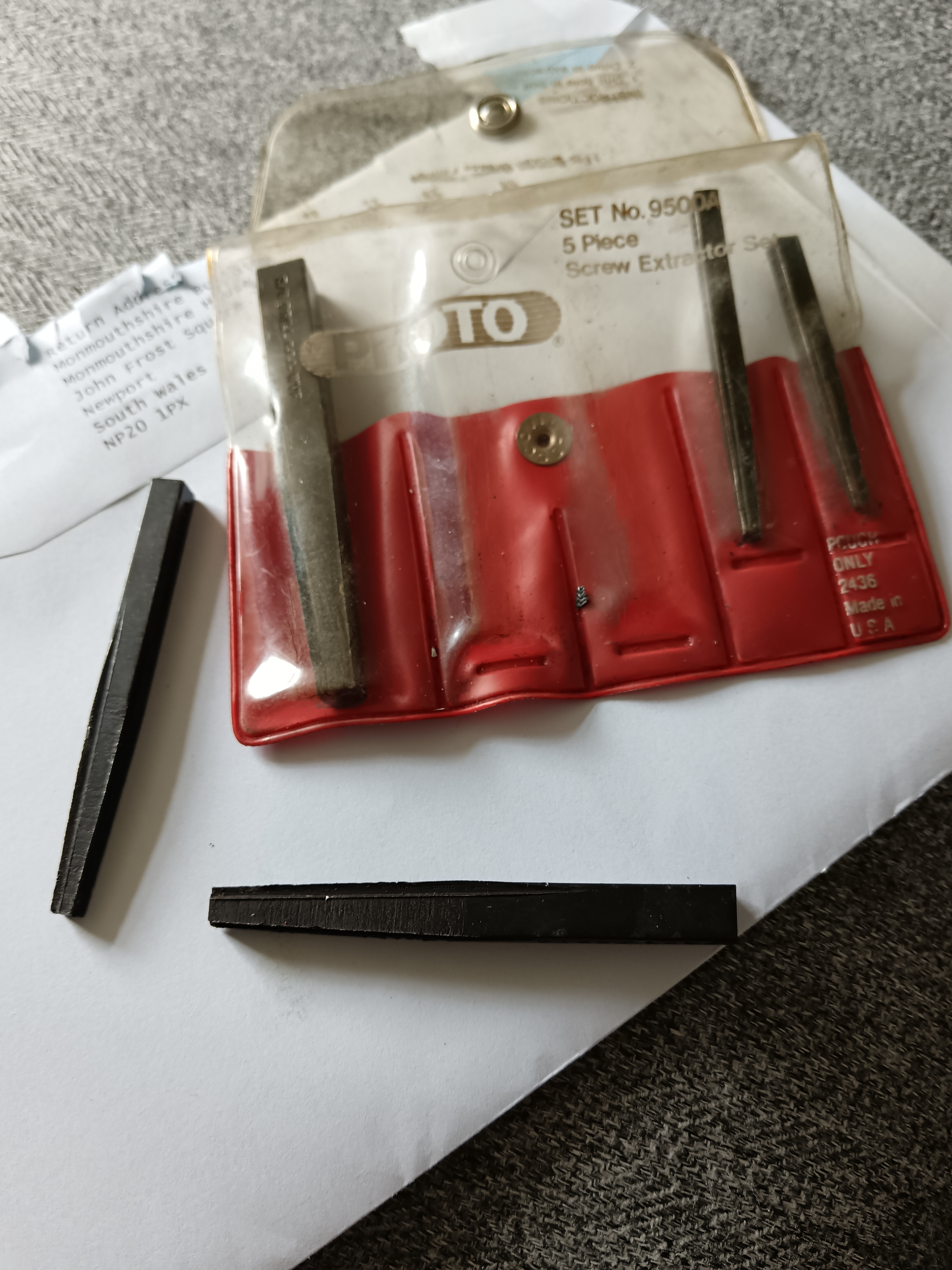

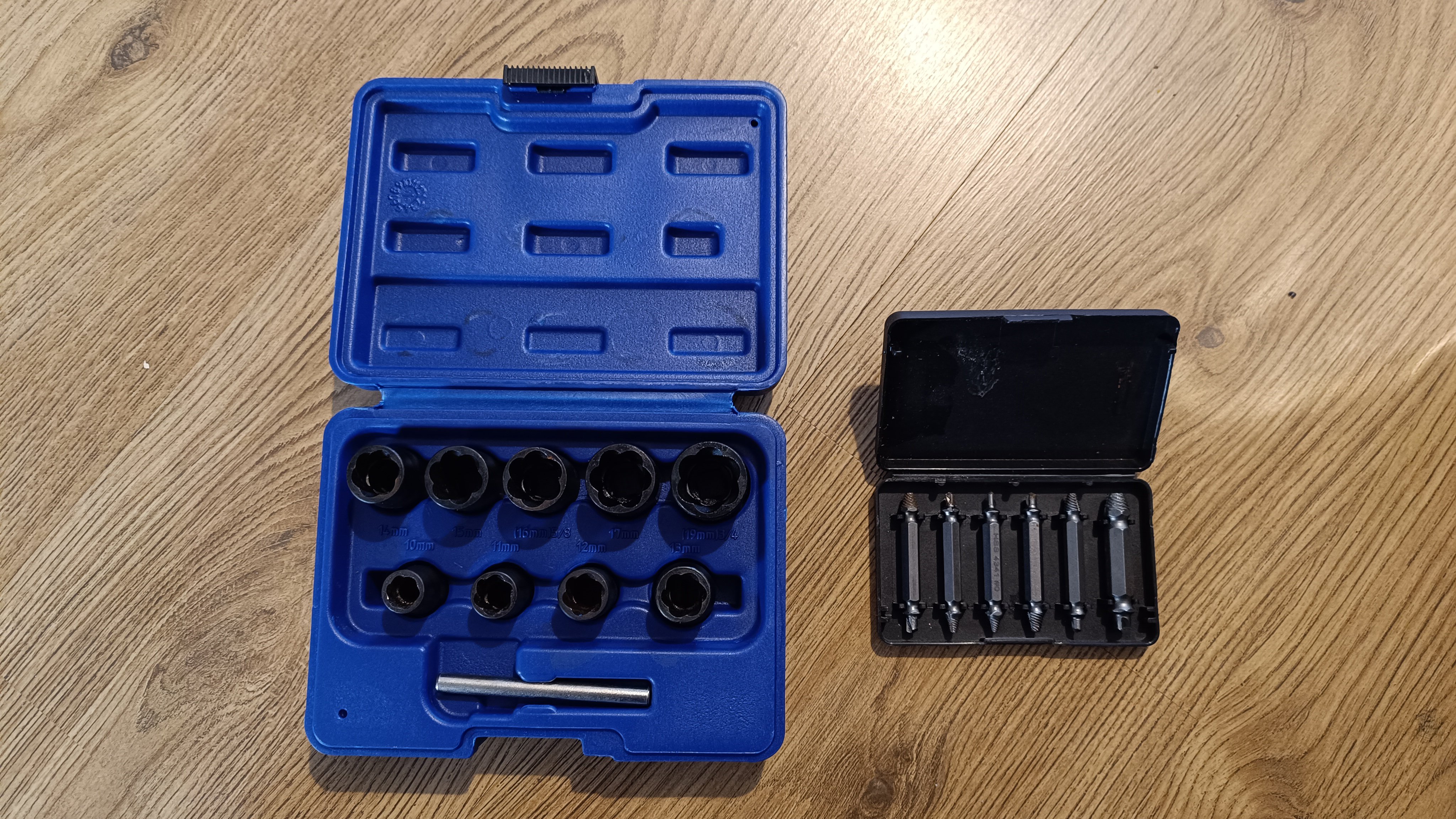

Show us your extractors..
I bet I can predict your issues 😉
FYI in theory you can poke a 4mm drill through the centre (the tapping size for a Standard M6 hole is a full 5.0mm
The idea is to hollow out, to create a "threaded tube"
And the thread can flex a little as you wothdraw it 🙂

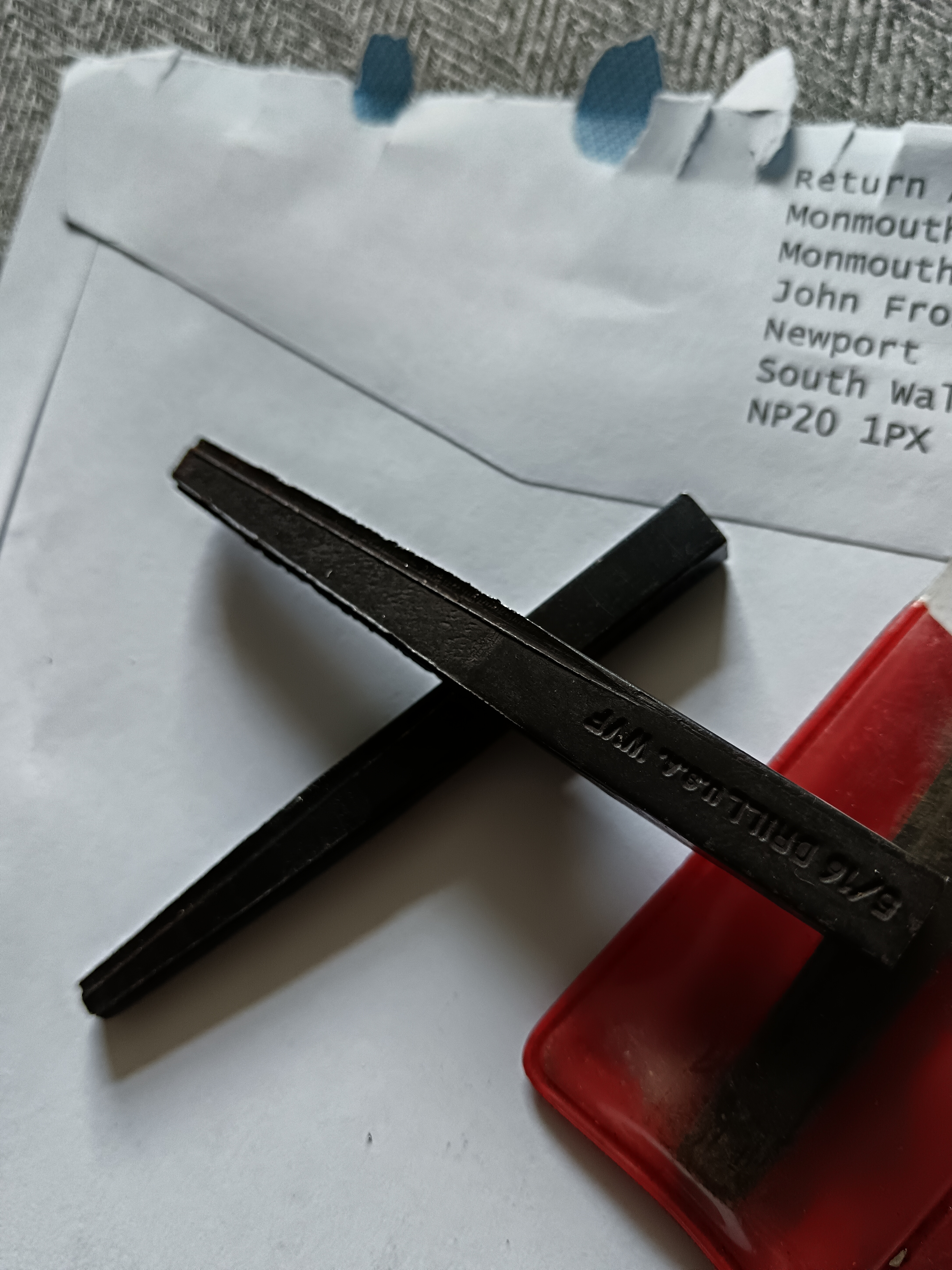

It took me a while to find what i've tried to use in the past.

The bolts can be drilled and tapped or you can get left handed drill bits which will often work well as an extractor
I've only today realised that the 500X and 500X Cross have different body work....i assumed the only difference was that the Cross was 4 wheel drive, i've not found any kind of 4 wheel drive button in the car yet either! Maybe I have Cross styling but front wheel drive?
I found these US style ones with a Chisel Edge far more effective than those scrolls
When you do drill through, soak it all in a penetrant.. The heat will soak into the threads

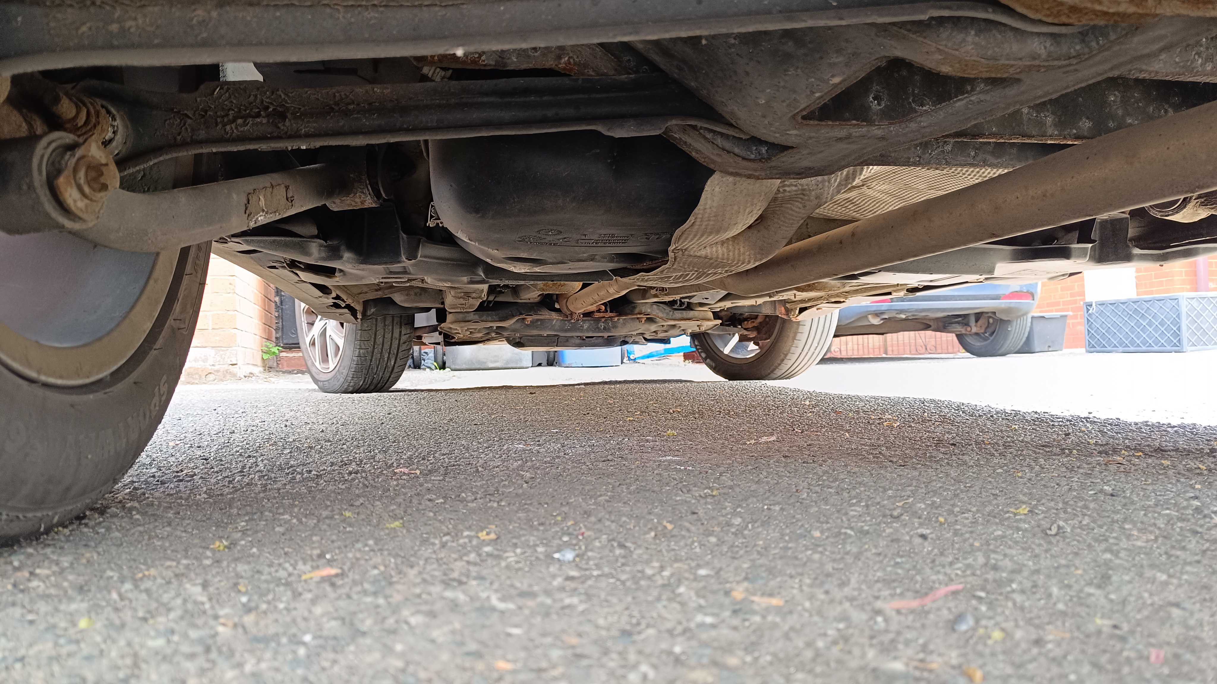

There's no drive train here. I'm actually glad because i'd never use 4WD and its something major that could potentially go wrong in the future.
I can imagine getting anything fixed on this car at a garage would be a lot more expensive than i'd like to pay. That exhaust looks small in the picture but is gigantic in comparison to the one on a Grande Punto.
When you do drill through, soak it all in a penetrant.. The heat will soak into the threadsView attachment 467170View attachment 467171
Thanks for the info. I knew intuitively there were extractors out there that are reliable, so it seems this is them. (y)

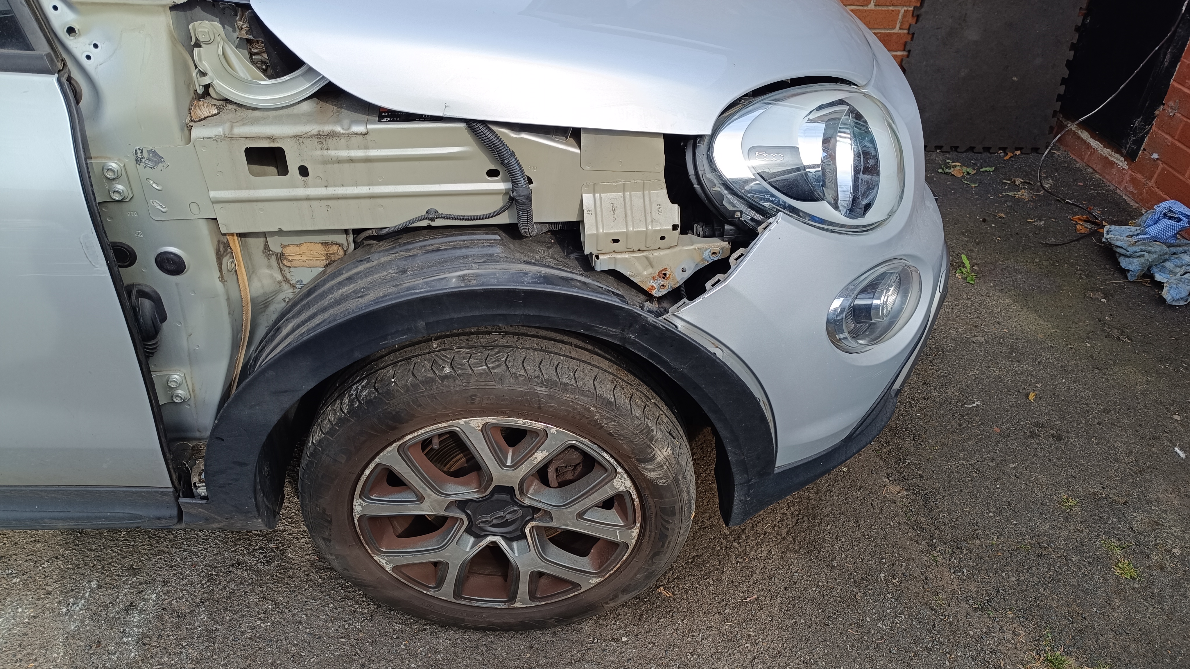

The wing is off and it now looks like this;

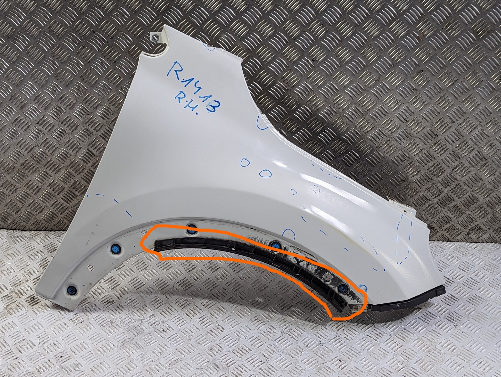

I'm thinking about buying the replacement below, does it look OK?
https://www.ebay.co.uk/itm/226742627669
The only thing that looks different is that on the one I took off there was no plastic lining, i've circled in orange the bit i mean. Maybe i lost that? I don't know.

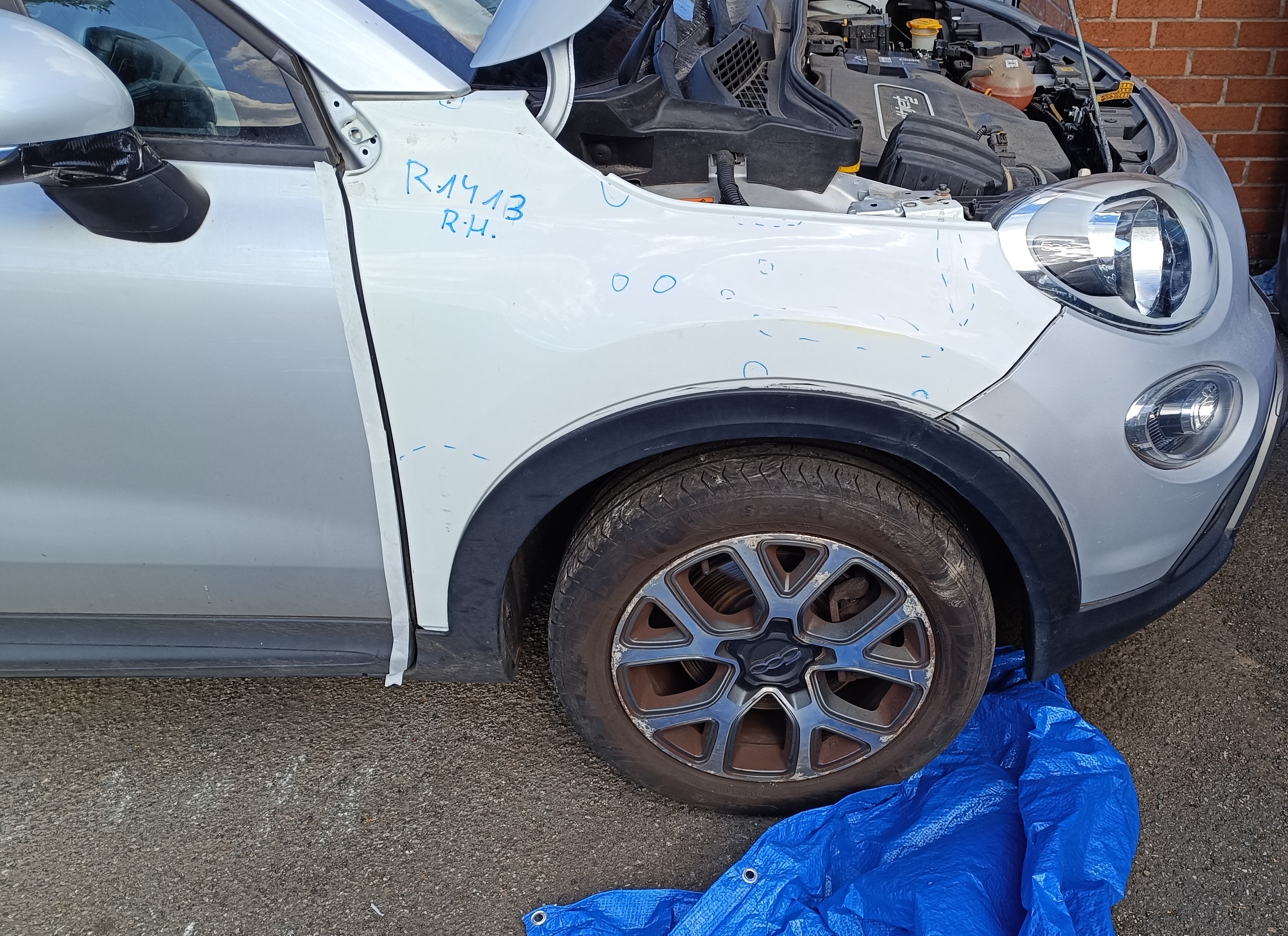

I bought the wing above, and the paint. It appears to fit but i've not secured it, i'll take it off and paint it next week. There is some rain around so I didn't want to leave the car with just a tarpaulin covering that part of the car.
