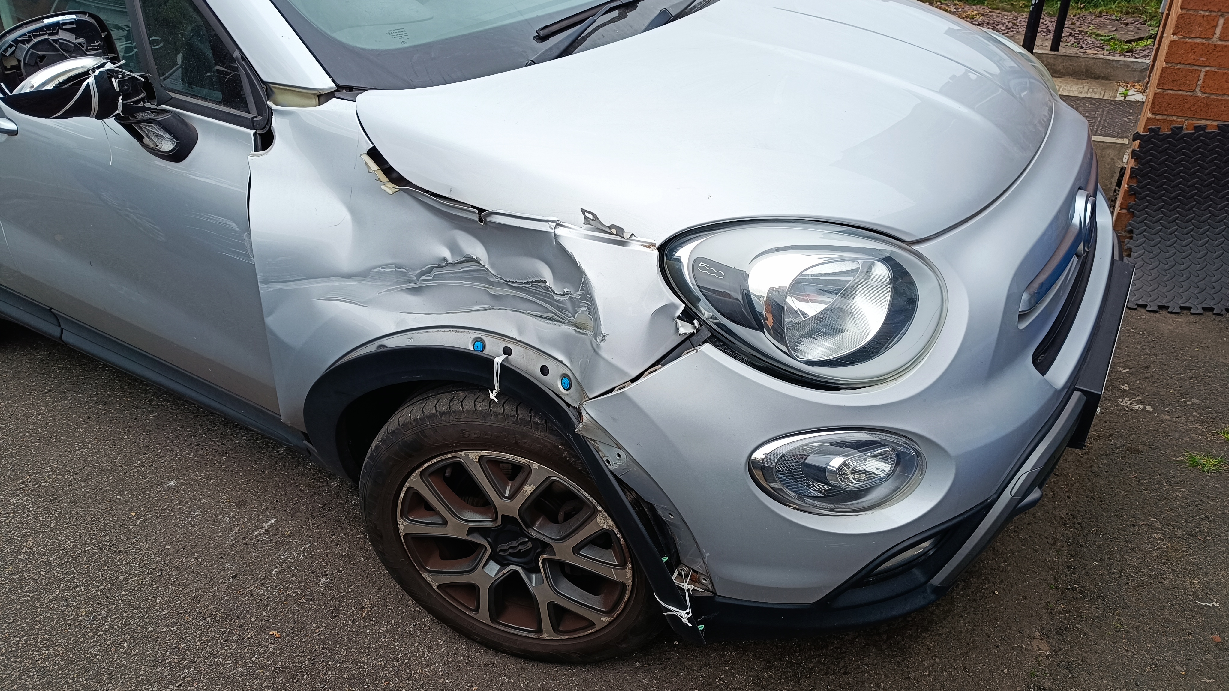

The body work is what i'd hoped for. All I definitely need are the side panel and wing mirror, the rest is probably repairable, leaving some of it in no way mint condition. I have to go out now but will post pictures and an update as soon as practical.

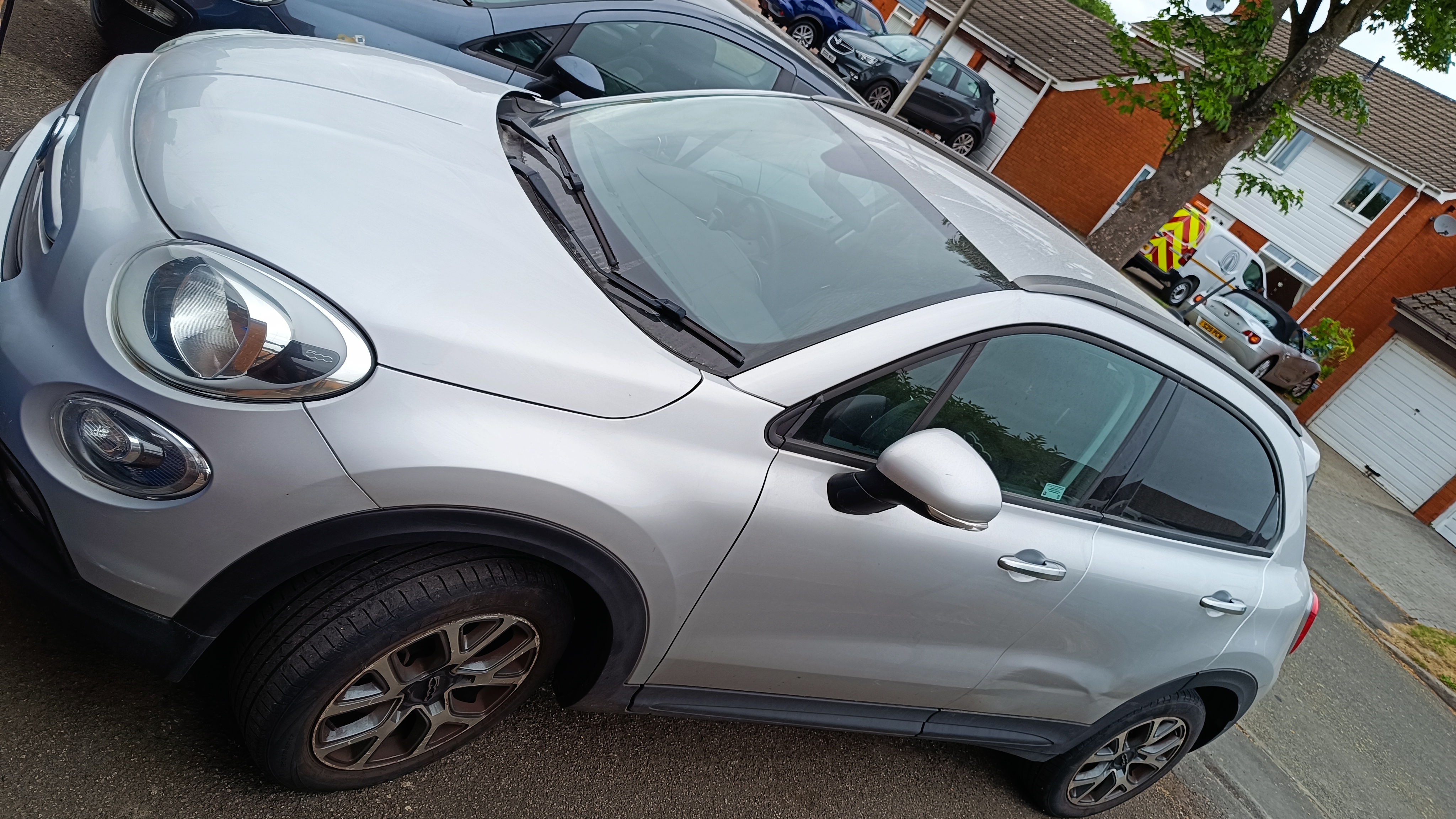

I'm generally impressed with the car! The aircon works! Holy smoke what is that about lol. Somebody cared about this car. I haven't done anything to the car except tear the side panel enough for the bonnet to lock. I took some pics and video. I'm only posting the bad photos, when you see it on the whole it looks great.

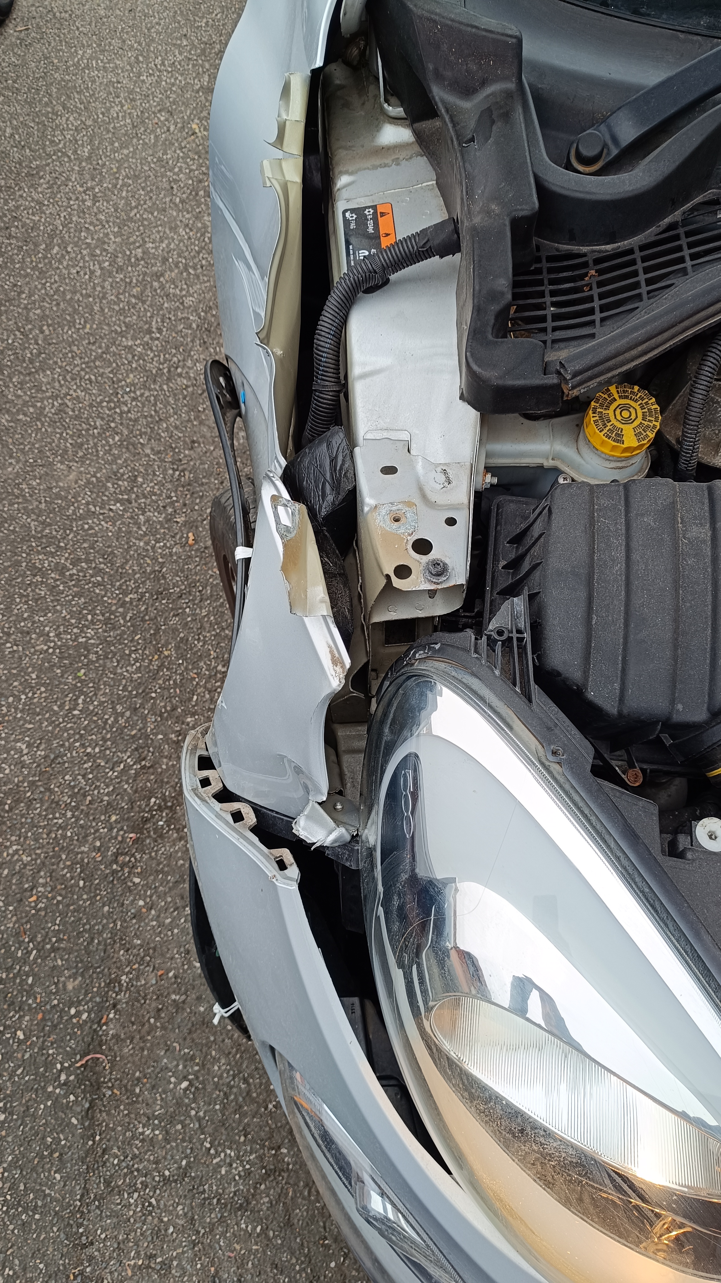

The side panel needs replacing, the bumper under the wheel trim will bend back into shape and the damage will be covered by the plastic wheel trim. The bonnet itself is fine.
Rear passenger side door will repair, it'll be a lot of effort to push and pull it into shape, it'll never look new unless i take it to a body repair shop, so i'm hoping to get it to 80%.

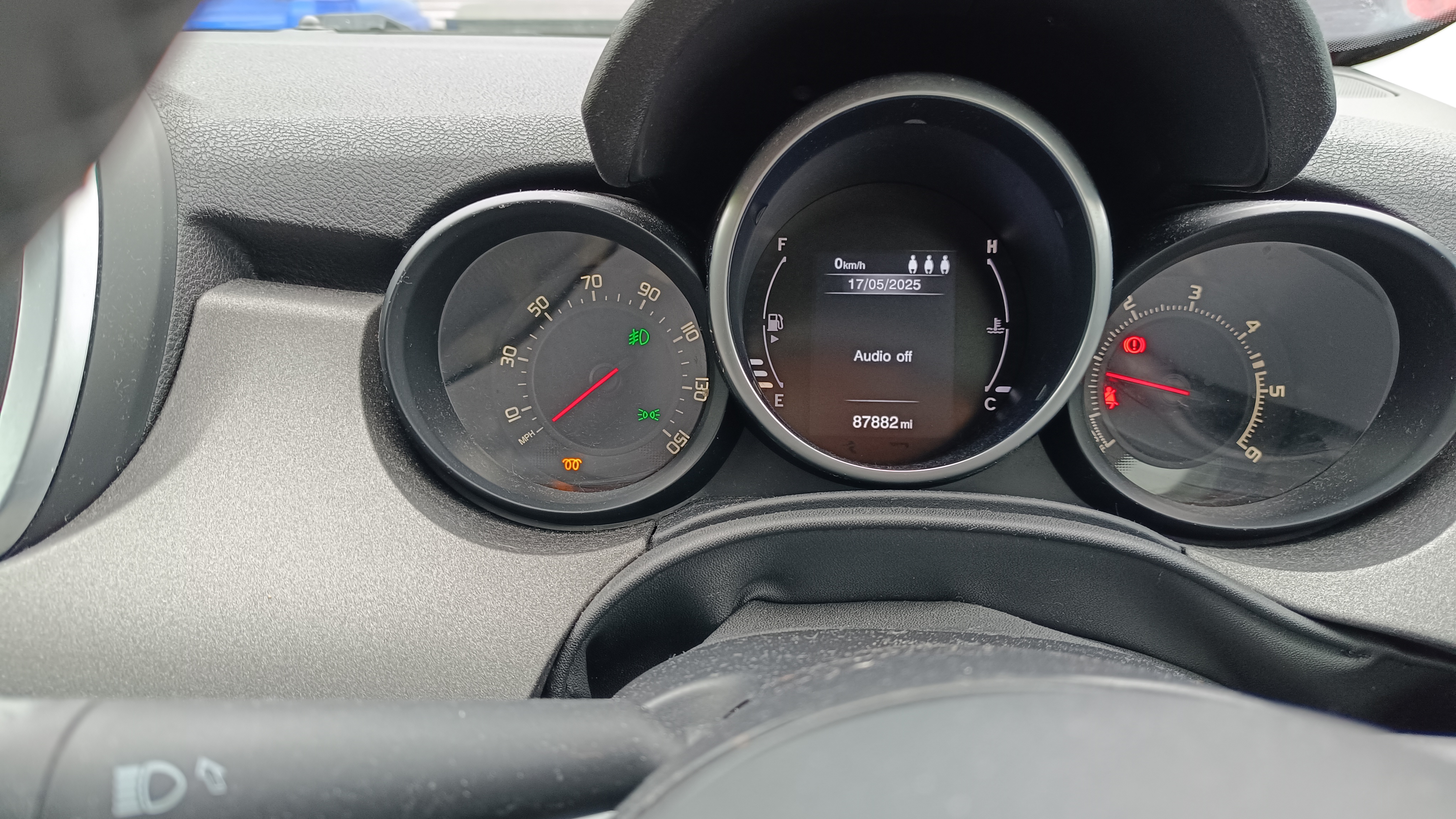

When i started it up for 30 seconds i got a check glow plug engine management light, but that went out. Thoughts on that?

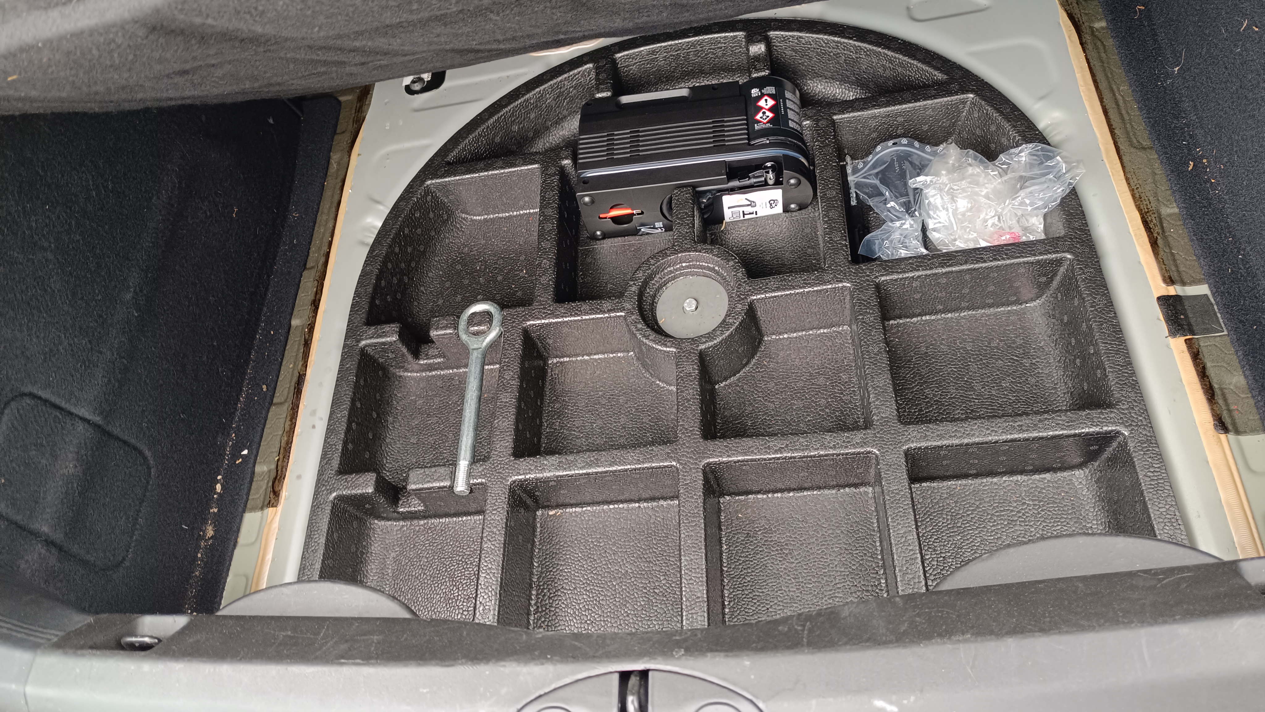

I doubt there's a spare tyre under that, not checked yet, anything missing from here?

Check earth on battery, body and engine/gearbox for glow plug warning light

There's no spare wheel, not that i wanted one, it seems i've got more boot space instead.

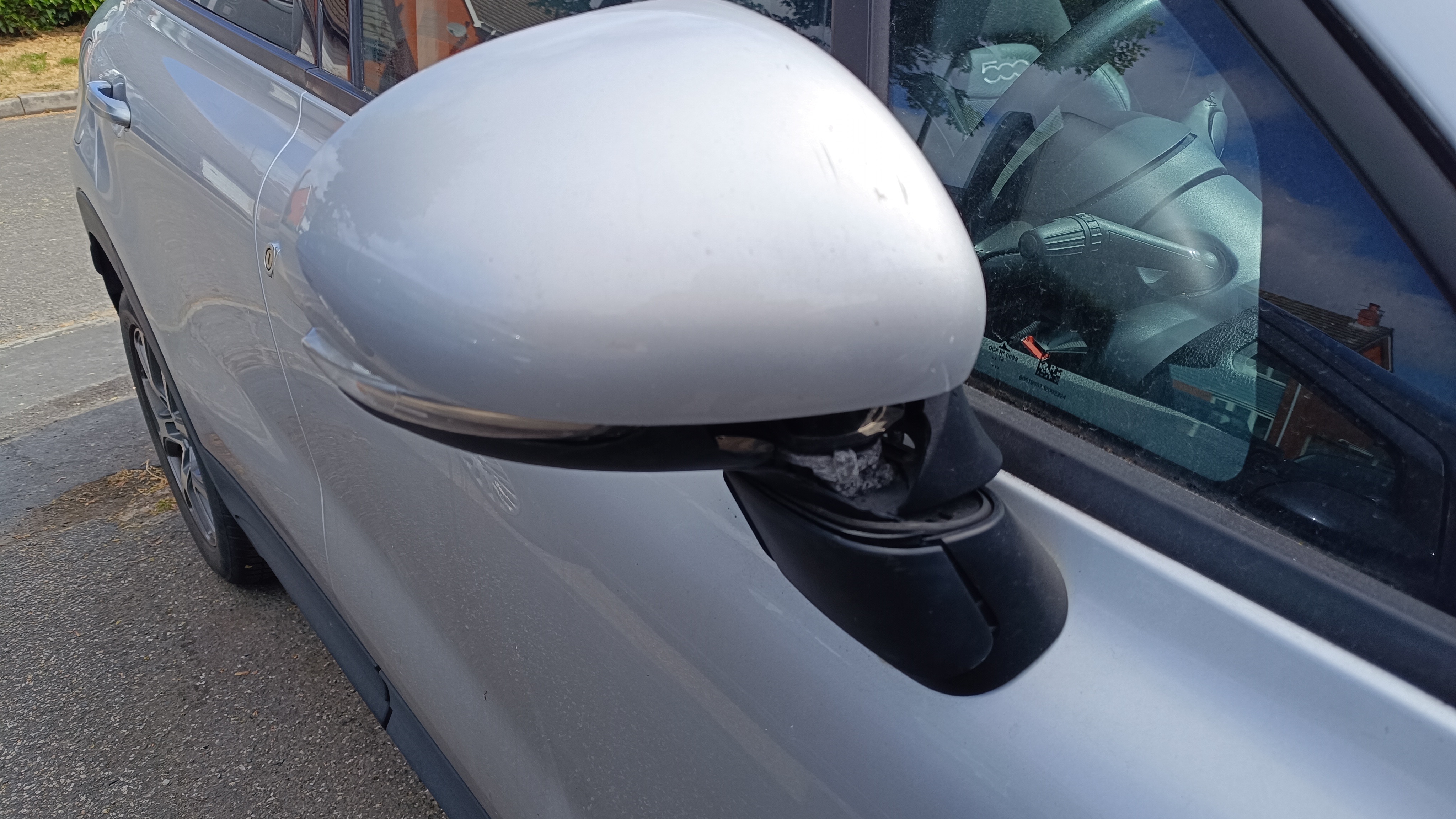

There were some parts for the side mirror in the boot, so i'm actually only missing one piece of black plastic. The mirror itself isn't cracked and all of the electrics in the body of it work.
I could possibly get just part of the side mirror? Or patch it up with something else? Any ideas on how to salvage this?
It came to me like this;
But with the parts from the boot it looks like this;

I think, for that bottom part of the mirror, it comes complete, the covers are available but that looks fine. Guess you could try glassfibre, but to get it looking well you have to be pretty good at it

I got the wing off, it was easier to peel it back with tin snips than remove the bumper and wheel arch to get access to the bolts holding it in place. There's no damage behind wing.
The only thing that went wrong is that two of the bolt heads sheared off. Drilling out bolts is my least favourite job, any advice regarding that?
