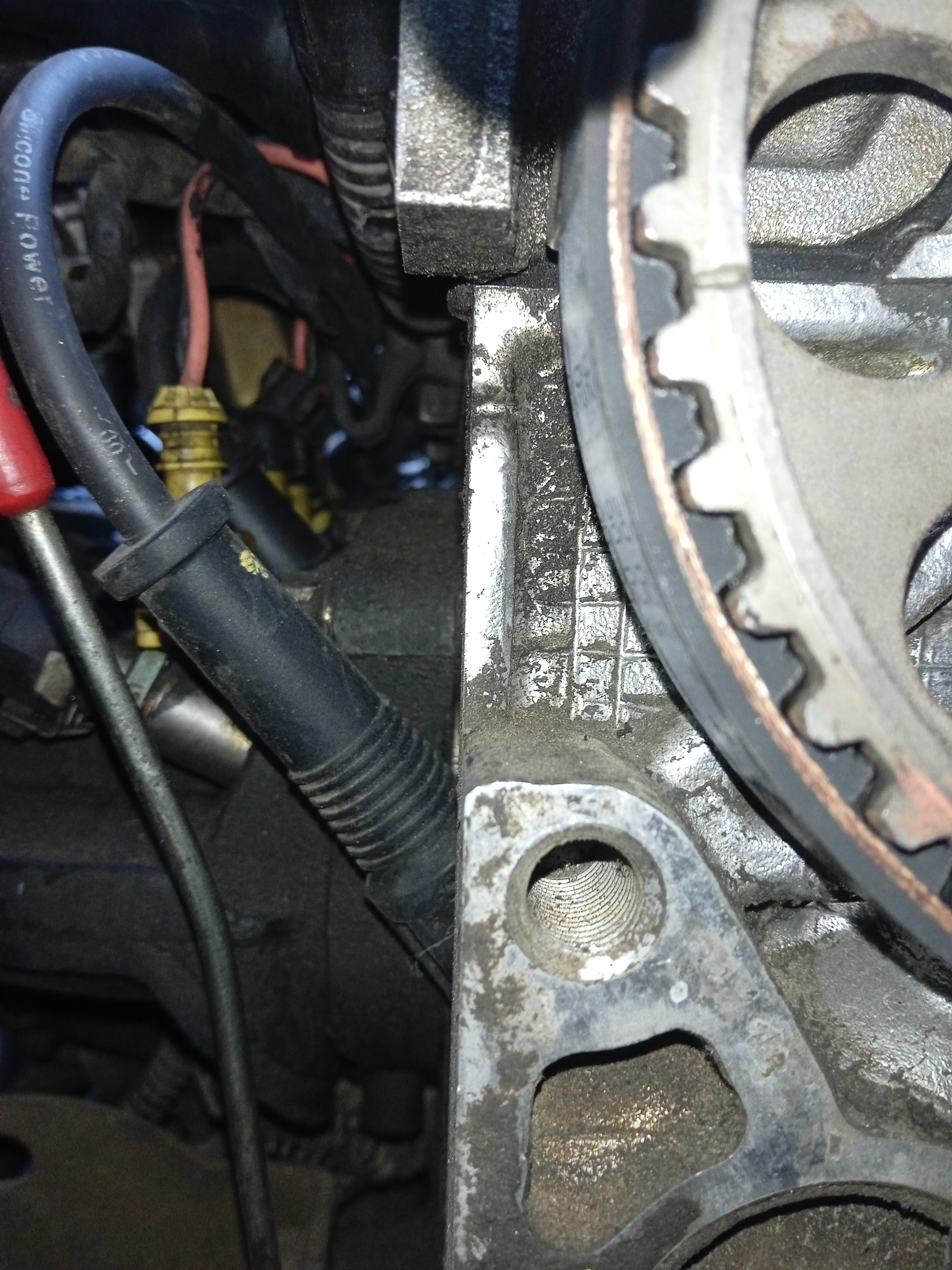

After visiting three different repair shops, unfortunately, the issue with my car has not been resolved. As I was thinking about the changes made at the first shop, I took a look at the car's timing. Could the problem with the temperature not dropping lie here?

After visiting three different repair shops, unfortunately, the issue with my car has not been resolved. As I was thinking about the changes made at the first shop, I took a look at the car's timing. Could the problem with the temperature not dropping lie here?View attachment 489883View attachment 489884
The angle of camera makes mark and line look like they don't align but I suspect they do align when viewed correctly. Plus would not cause heat problem.
