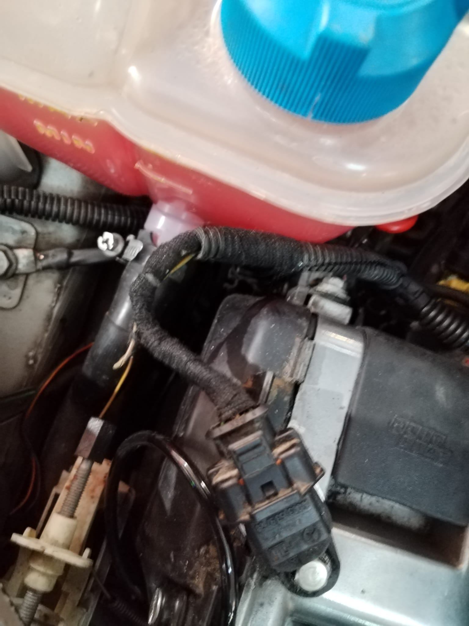

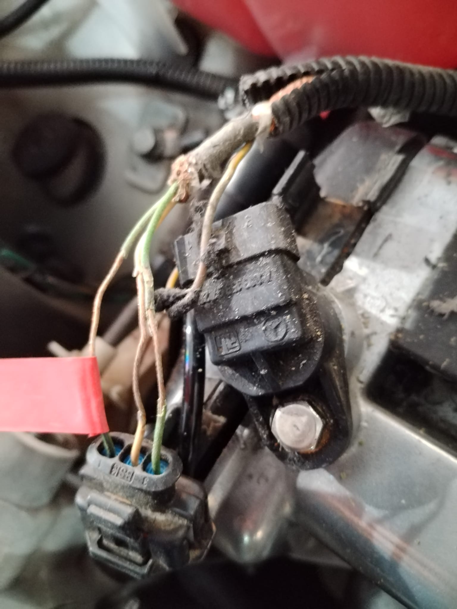

Do you mean apart from the wiring loom repair, the very tight wire to the plug and the spare plug beside it in the last photo and the pretty green/blue odd loose non automotive wire in second photo?:) Bear in mind my eyes are 73 years old so may still be missing things.;)
That and the first photo of engine compartment looks cleaner than the rest, or is it the last photos are zooming in on the dirt.:):):)
The green cable is a wire that I used to hold up pipes. These are photos that I keep when I do things to the car. In that case, it was the heater radiator. The photo is misleading, everything is actually quite clean.
Not intending to cast doubt on the cleanliness and much cleaner than most of my vehicles.:)
Apart from what I assumed to be an air con aluminium fitting I didn't notice the heater hose disconnected.:)
My vehicles often look clean just after purchase as I use my commercial steam cleaner to excess around the engine and everywhere else, indeed I once blew away a imobiliser chip that had been repositioned with the key antenae behind the dash board on a very dirty Iveco Daily pick up ex Water Board from auction. I cover ECU with a plastic bag and go for it, so far with no problems.;););) I keep the engine running for sometime with the bonnet up so that and the hot steam soon dries things.
