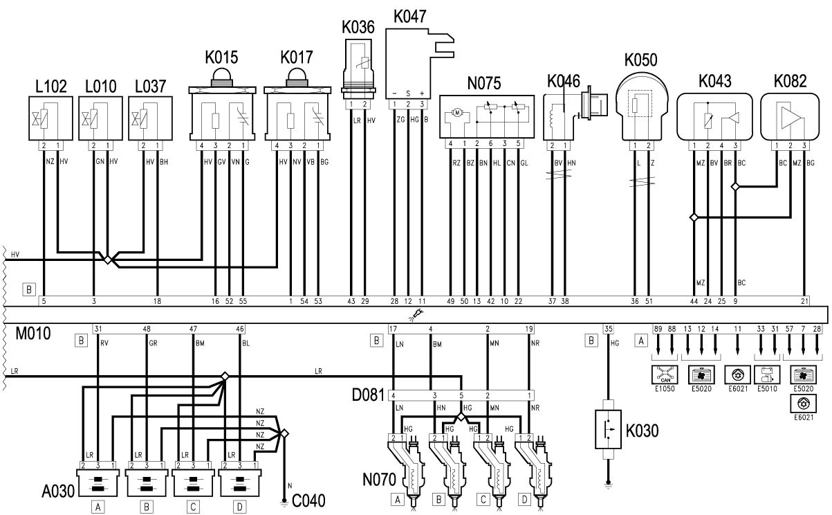

Are you 100% SURE you replaced the right sensor ? The K036 is located on the thermostat housing, under the airbox reinforcement bracket, gearbox side. It's a basic NTC fed with 5VDC for the engine control unit; it sends back the signal to the ECU for processing. The K036 is the only sensor involved in dashboard temperature indicator.

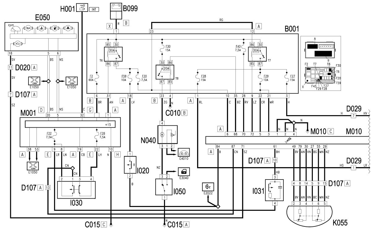

Here are some drawings with pins # ...
Regards, Bernie
Regards, Bernie

Thanks Bernie, useful diagrams.
