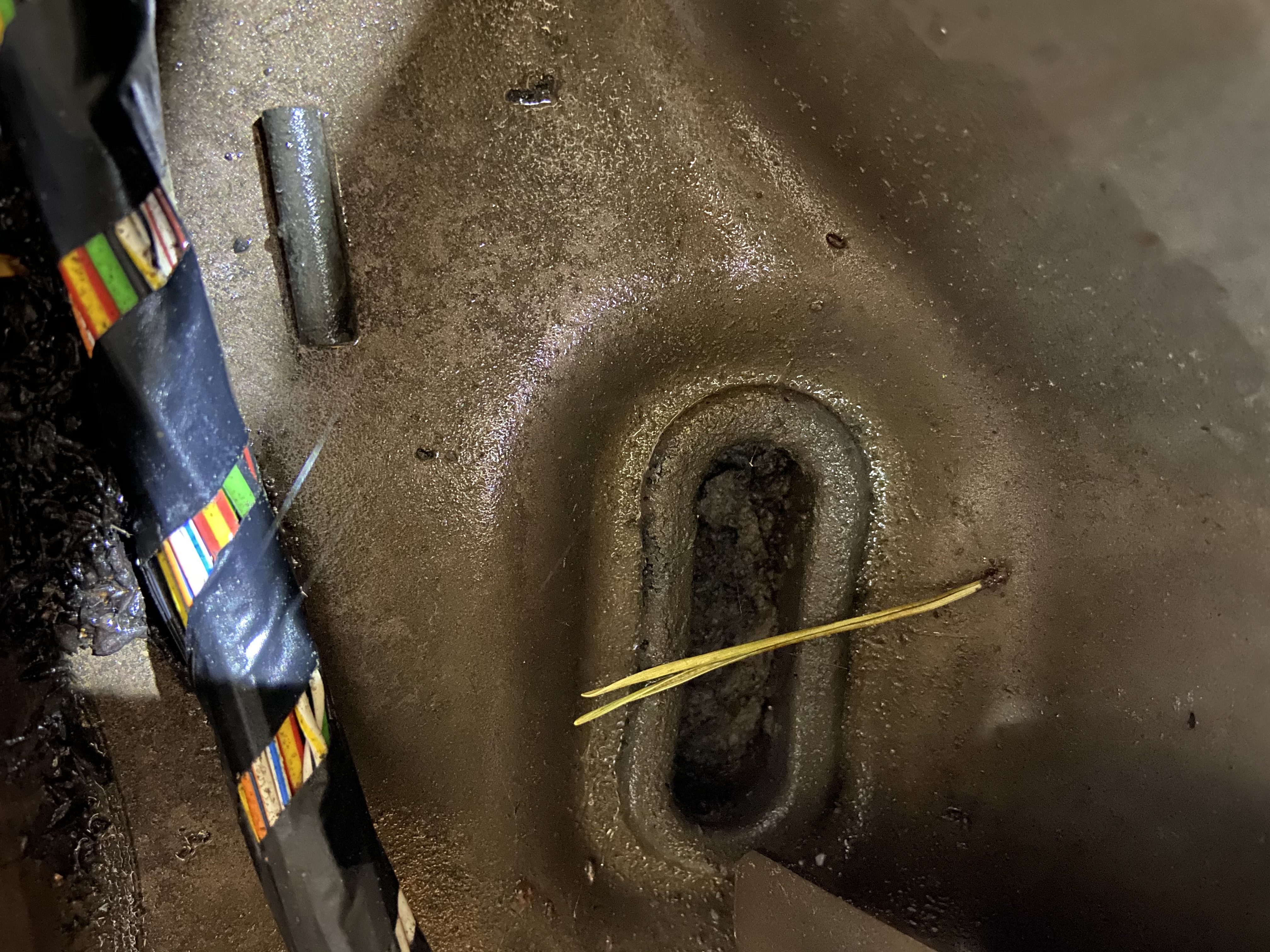

To be honest, I didnt ever think about the drains and looking at photo I dont sdee how it got like that in a year of ownership as not near trees or anything and of course fiat care plan assumed should be checking them. Interestingly, I was watching the rain yesterday before taking it in to the garage and the rain does drip directly onto the mounts and the scuttle was still draining but water was pooled there so it is probably a case of bad bearing design, scuttle cover design and blocked drains. I will certainly be checking as you do after this though!

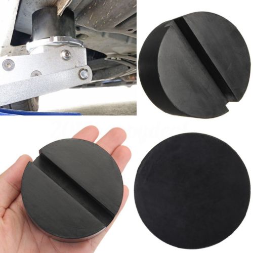

P.S. re jacking up the car, as there's no jack supplied with the car :)bang:) I bought one (Screwfix?) and then cut a notch in the square lift top to accommodate the seam under the car. Bit fiddly to get it right but it works ok. For trolley jacks you can get a rubber disc to make them more under-car-friendly See here ..although they're sold out by this vendor, there are a lot of others selling similar items if you want to look around (y)

I know the things you mean re trolley jacks - they call them `pucks` as they are like hockey pucks and are meant to `swallow` the welded seam to prevent flattening when jacking the car up on its marked points. I put the jack inside onto the chassis rail as per MOT chaps instructions as the side steps have brackets which prevent the marked points being used easily anyway. The chassis rails take the vehicles weight ok. IUts garages/tyre places who wrongly jack up vehicles that concern me having already experienced an idiot at a tyre place putting trolley jack under welded seam of cill just forward of rear n/s wheel arch. He damaged it of course - flattened it a bit and took paint off!

I know the things you mean re trolley jacks - they call them `pucks` as they are like hockey pucks and are meant to `swallow` the welded seam to prevent flattening when jacking the car up on its marked points. I put the jack inside onto the chassis rail as per MOT chaps instructions as the side steps have brackets which prevent the marked points being used easily anyway. The chassis rails take the vehicles weight ok. It's garages/tyre places who wrongly jack up vehicles that concern me having already experienced an idiot at a tyre place putting trolley jack under welded seam of cill just forward of rear n/s wheel arch. He damaged it of course - flattened it a bit and took paint off!
