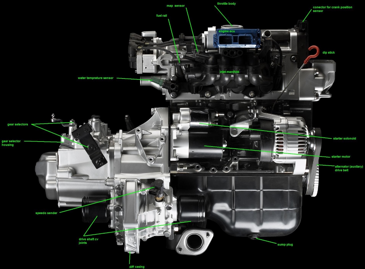

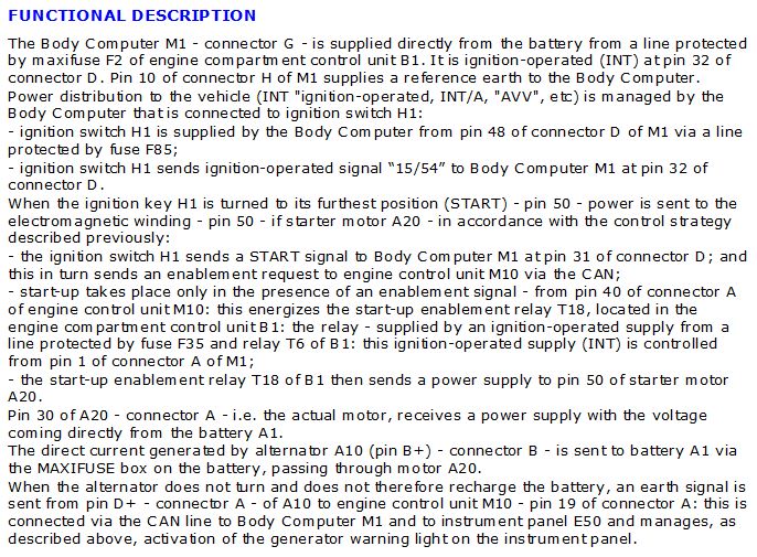

Might be as simple as a fuse, here is all I can find about the starter on a petrol GP, it contains all you need to understand and troubleshoot it ...
If you actually hear the relay T18 clicking (and its contacts are ok), my candidate would be F35 in the distribution box (engine bay).
BRs, Bernie
