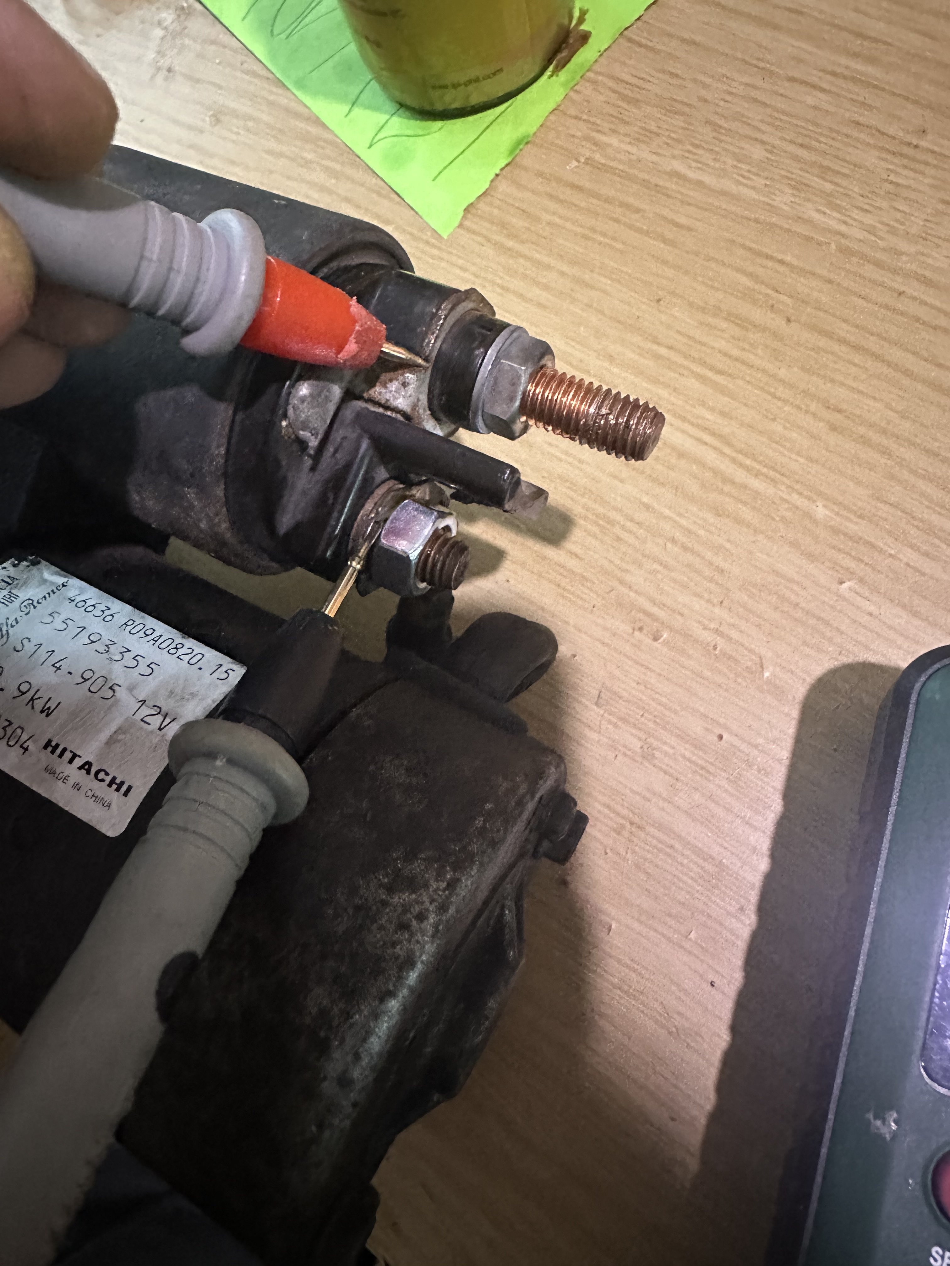

I think I’ll just take the car back and check it myself, they said today the electrician looking at it now but I’m not hopeful, I’ve got the old starter here and I checked it and seems to be working fine, tried it with 12 volts and solenoid and motor is working , just one thing I’m not sure about, in the picture I’ve got the probes, the black probe is ok the wire coming from the motor and the red probe is on the point where the first wire goes on, then the plastic piece goes on next and last the main power wire, both of them points where I have the probes are reading short and I’m not sure if that’s meant to read short ?
I know it’s a simple car and if the starter and battery is ok then it’s got to be a wiring or ignition issue as there’s not much that can cause this issue.
I might have to get the car back and check it myself but I’m not sure if the 2 points on the starter are meant to be both shorted and they both shorted to the ground on the starter, I presume where I got the red probe is the ignition wire that goes there. Where the long thread is the main power cable

Starter coils/windings are low resistance, so regular multimeter will tell "short" (which is not true).

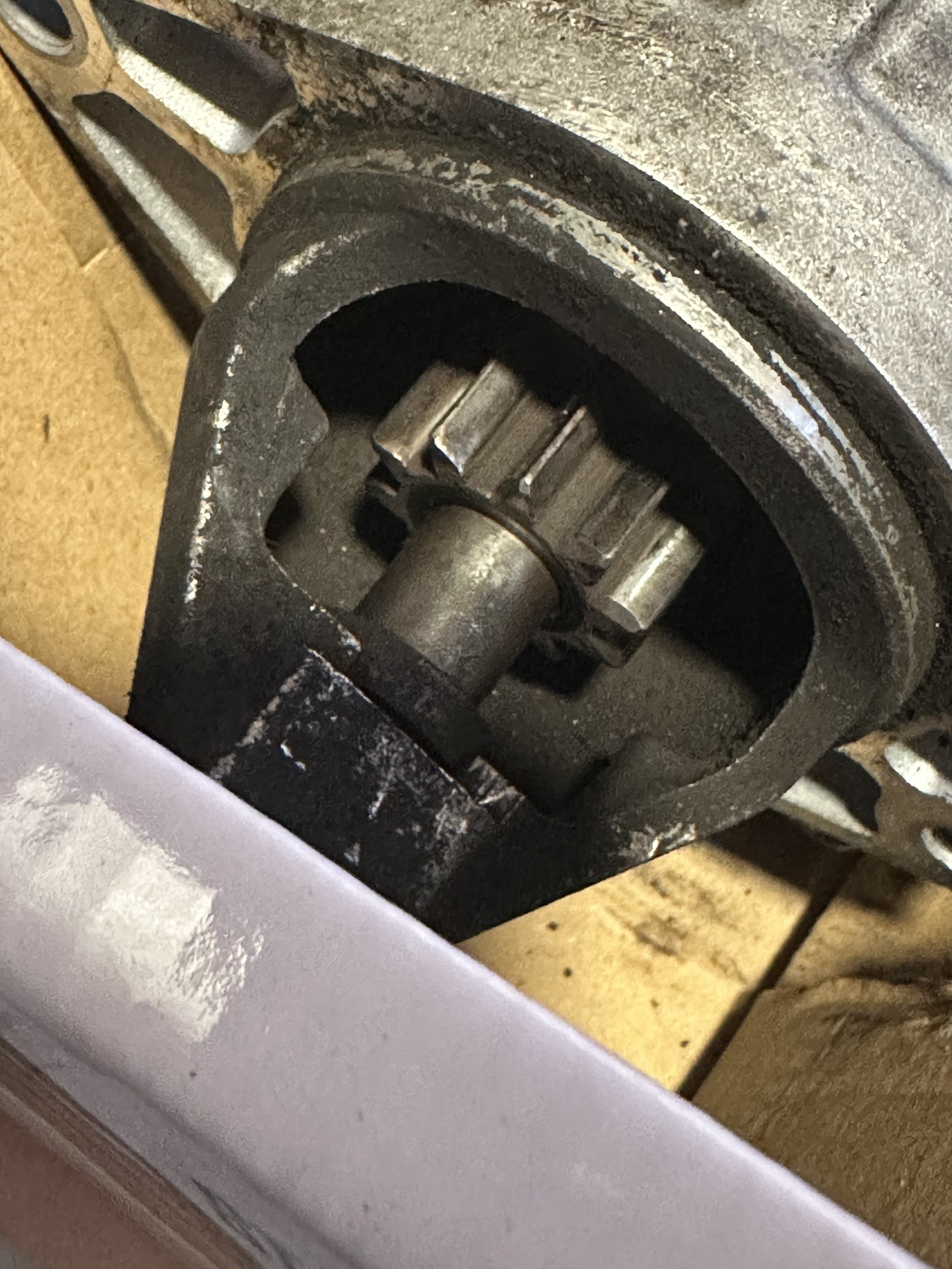

the starter got replaced and I tested old starter and seems to work fine,I done a bench test and solenoid and starter is working, teeth on starter seem fine, but I’ll show a picture, I wasn’t sure if the 2 points are meant to be connected to ground.
I got the car back they never checked the flywheel, it starts they said sometimes it don’t, I tried it and it started fine first time last night, today I tried and it started but as it started made a screeching noise which it didn’t before, drove it a bit and tried to start and it didn’t start and just load screeching noise so turned the ignition off and tried and again and it started fine, I don’t know what they done but now I’m getting these issues with screeching noise on startup or no start and screeching and sometimes it’s fine, hopefully someone can help
