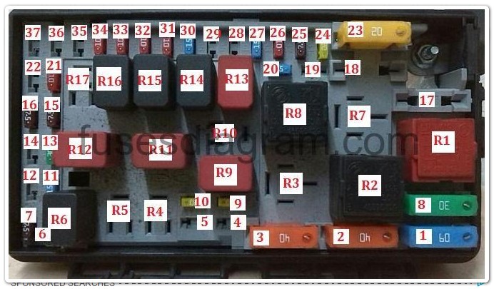

Exactly which relay did you check and how?
Attached is an example of a Grande Punto fuse box.
R2 is the Cranking cut-off relay, auxiliary circuits 1. You can test by temporarily swapping with R8 (Engine coolant blower motor relay 1 - low speed).
R11 is the Starter Motor relay. You can test by temporarily swapping with R9 (Front electric window relay) or R12 (Ignition main circuits relay).
F13 is the fuse for the Starter Motor (30A).
I just swapped the relay around for a good one, I manage to figure out I think why the starter making screeching noise, GSF car parts gave us wrong starter, original starter had 10 teeth and the one they gave based on the part number on the box only has 9 teeth, I don’t know if replacing the starter motor to the correct one will fix the issue, maybe I just had a ground issue and now I got just a wrong starter issue, I don’t know if the flywheel is messed up now, gsf car parts partially to blame then then the garage who diagnosed the issue as old starter tests ok, I need to replace starter and check flywheel and see what happens
