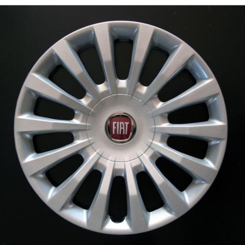

I only want to save her from the scrap heap, nothing more, so all she'll be getting is a new set of wheel trims(unless you like to donate some alloys ;)). What do you think of the trims pictured below?

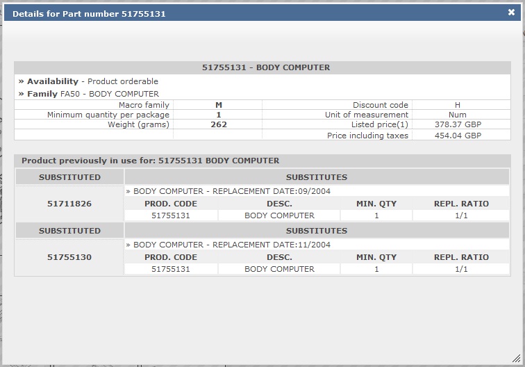

That is what I did earlier and saw that one. It is however for a 1.6 and not the JTD, surely there would be a difference. The thing is, the BC should be as cheap as dirt so I cannot understand why Fiat is asking 450 pounds plus? Are you sure they did not quote the whole engine for that price? ;)
Knowing Fiat they would not sell the BC separately, did you make sure on exactly what they quoted?

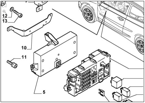

Item number 5 £450 - See for yourself, here's a few screen shots from the ePER.

those trims will look nice but if they cost more than 40 quid you can get some dynamic alloys with tyre for not much more, then sell your old wheels with tyres on to get back the extra money.

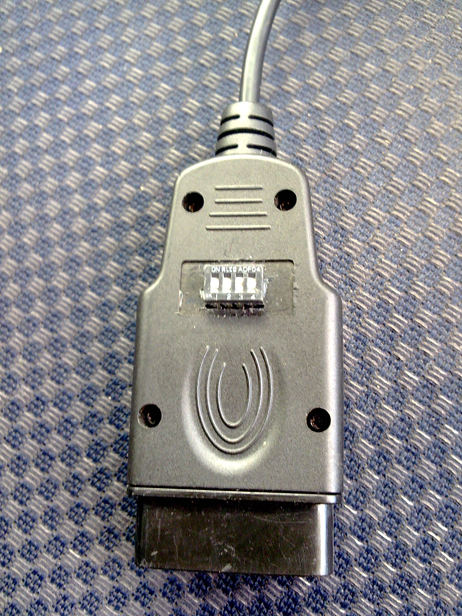

Yes I am connecting to the airbag ECU with my modified VAG COM cable(pic attached showing microswitch) and your correct I did say I wouldn't mess with airbags, best left to the pro's. BUT, as every little boy will tell you, WE HAVE TO MESS! I've been dying to have a mess with the airbags but didn't want to mess up our Multiwagon ... :D
So due to this car just being something for me to do with my spare time I ran the VAG COM cable out the window and plugged it into my laptop that was on the bonnet. Anything goes wrong and 6 airbags decide to fire, I'm no where near them. (y)

dynamic wheels and tyres would go for about 100. Your wheels with good tyres would go for about 70 to 80 so as long as your wheels trims are cheap go for it. I just think a nice set of wheels on a car can change the way it looks

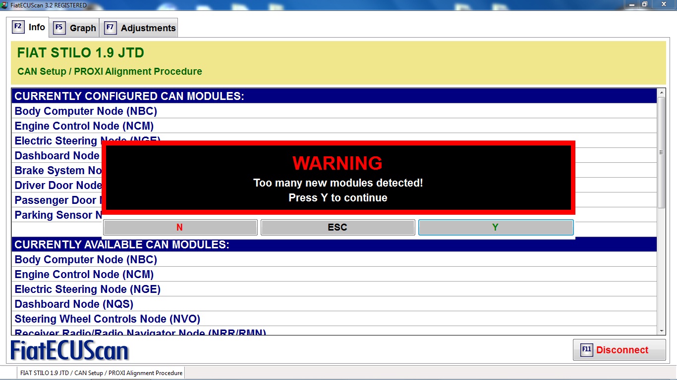

Next I connected FES to the BC and checked the CAN info. It reported multiple NODs removed/changed so I ran Proxi-Alignment and that cured it. So secondhand BC's can be used. (y)

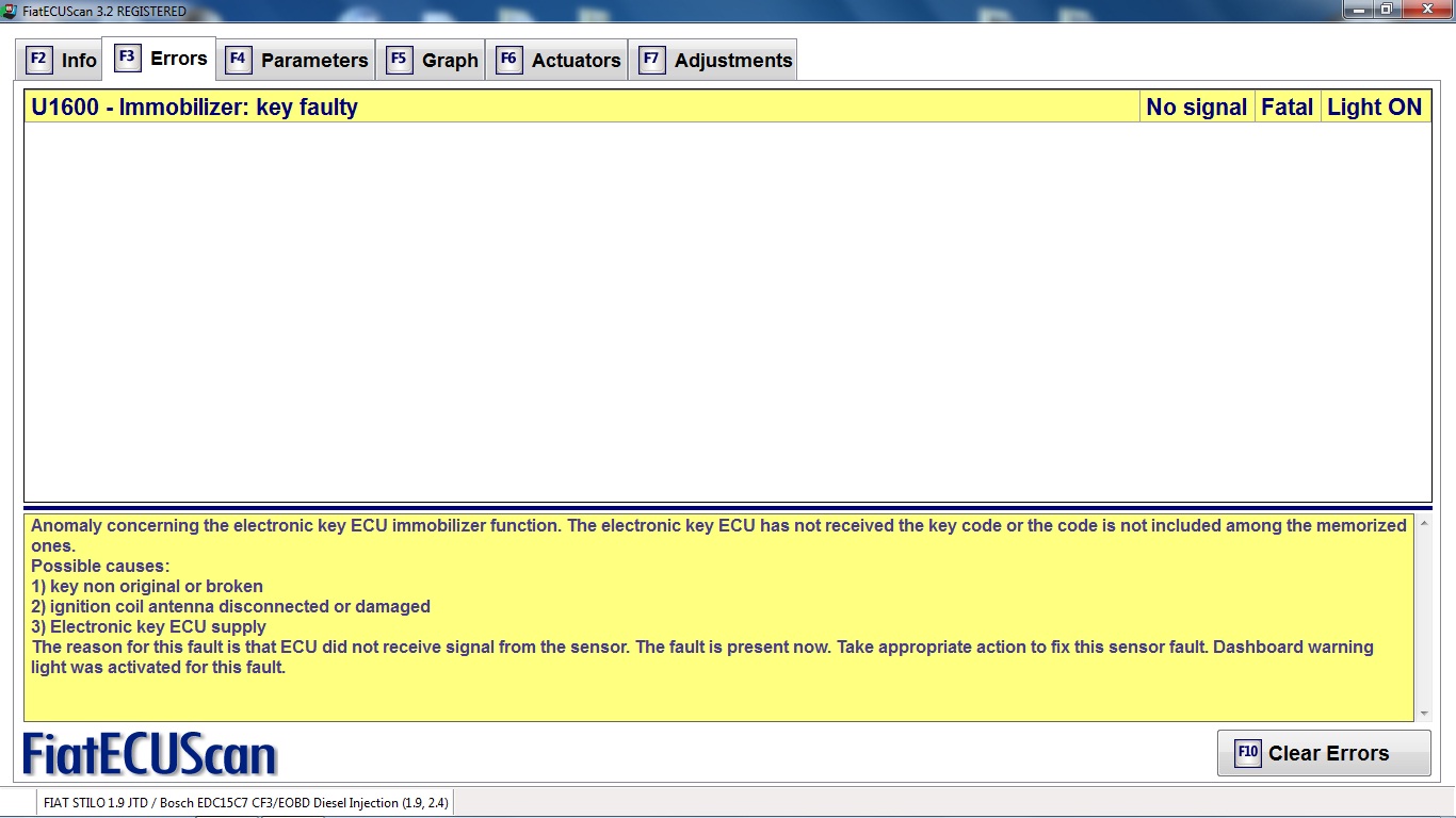

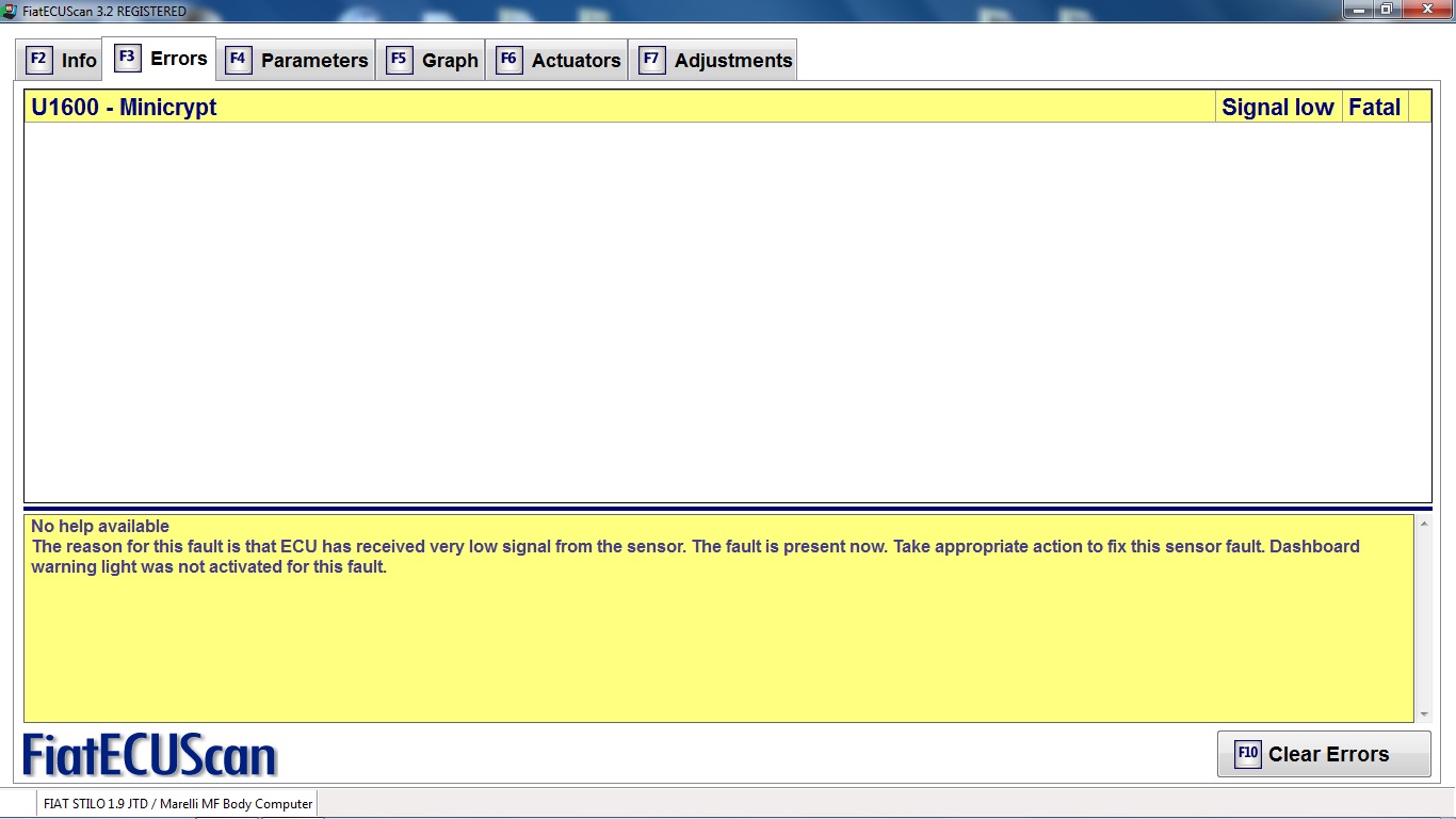

BUT I'm now left with an error code, its the same error code but one in the Engine ECU and one in the BC.(screen shots attached below).
U1600, could this be solved by swopping over the transponder reciever coil thingy's that fit around the ignition switch??
Or do I have to pop it into a Fiat dealer to have the key's re-coded to the car?

Using a second hand BC can be done but FES can't(at the moment) do Proxi-Alignment on a Stilo that has Climate Control(I know because mine has it) so untill FES is able to proxi-align a Stilo Climate Control you'll not be able to configure a second hand BC on a Stilo with Cilmate Control.

So I then swopped the key parts over to see if I could fool the immobiliser and start the engine. Answer - NO..
Did you swap all the key parts including the glass vial transponder?
The transponder should be recognised by it's matched BC which then sends an "Allow Start" signal to the engine management ECU. I don't think the EM ECU holds the key code as well, but just in case it does, you could try swapping the EM ECU too.
I'm now left with an error code, its the same error code but one in the Engine ECU and one in the BC. U1600, could this be solved by swopping over the transponder reciever coil thingy's that fit around the ignition switch??
U1600 would come up if you've used a key with the wrong transponder.
The reciever coil "thingy" is only a coil, it just picks up the code from whichever key you have close to it.
You could have tried it by wrapping the "wrong" key handle in thick Bacofoil so you could use it to turn the ignition (the Bacofoil would prevent the transponder signal getting through to the reciever) while holding the "correct" key (and transponder) close to the reciever.
Just a thought (because of the error message)... perhaps FES can only Proxy-Align one node at a time. I seem to remember that when Yani was investigating Proxy-Alignment for FES it was so he could Proxy-Align a retro fit CN+ into his Stilo to avoid the need for the 4 second delay circuit, not to configure multiple NODES.
If feeling adventurous, you could try disconecting all the extra NODES then reconnect and Proxy-Align them one at a time.
