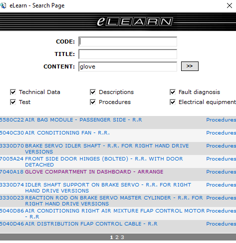

Why not get eLearn? so you can get nice info like this:
-View attachment glovebox.pdf
-View attachment mixingMotor.pdf

I actually have eLearn but can't find where all the procedures for removing and assembling stuff are!
Thanks!
Use the Search functionality:

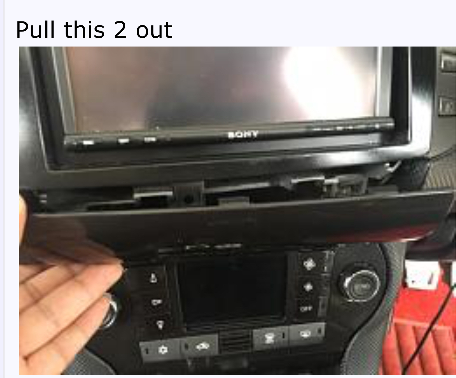

Hi
Can you tell me how you removed this panel please
Remove Sony then remove the mask with buttons -ten screws I think.
This flap will go out with the mask

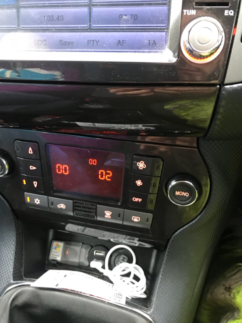

Can anyone tell me which actuator controls flow to the footwells and which one controls flow to either side of the cabin (Bi-zone) as I currently experience one side hot and one side cold. Thanks
Hello my digit air conditioner fitted Bravo claims "B1901 - Windscreen motor feedback" error message and the windshield demisting is weak very much.
According to my mechanic, the white plastic coupling is in good condition. The actuator motor may be off. Can You please tell me what item numbered actuator I may need? The 120° angle version or the 150° ?
