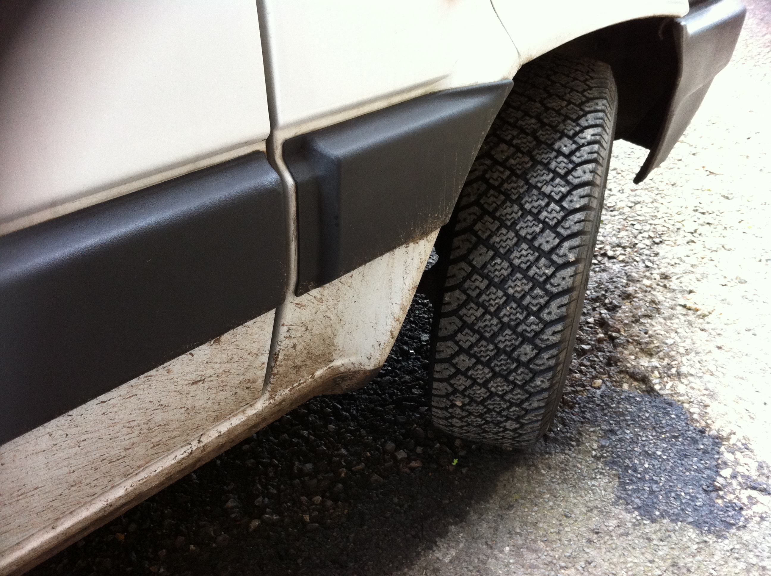

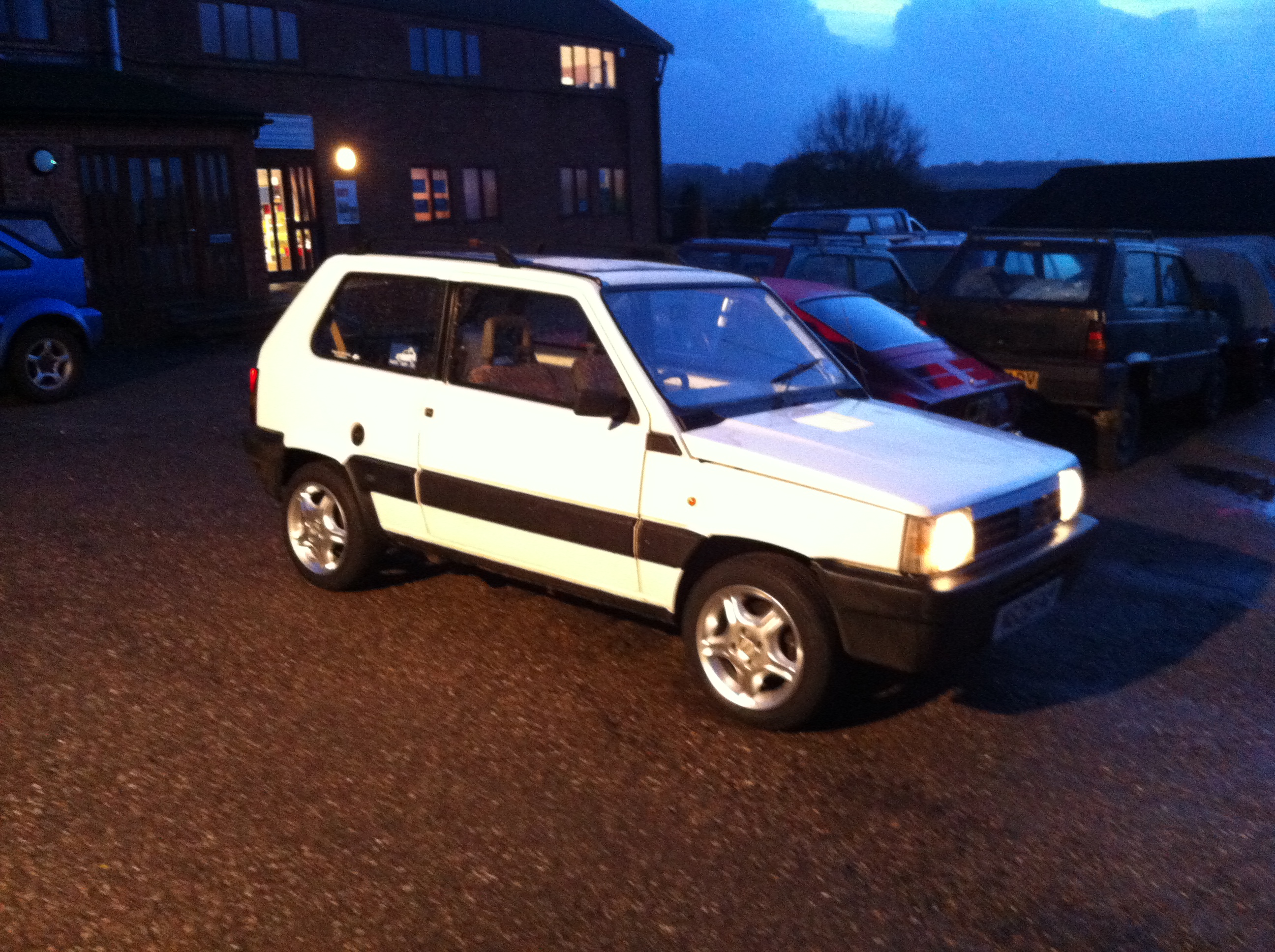

Vern has now swapped the white wheels for alloys with winter tyres. I liked the white wheels but I couldn't take more than one passenger as they scraped on the wheel arches!

Yep, Bo now has his Winter tyres.......
These wheels should fit fine as they are genuine Fiat accessories, mind you, they are not supposed to have 165/70/13 tyres so do still need testing. They were fine on Oslo but it's a different matter on a 2wd Panda.

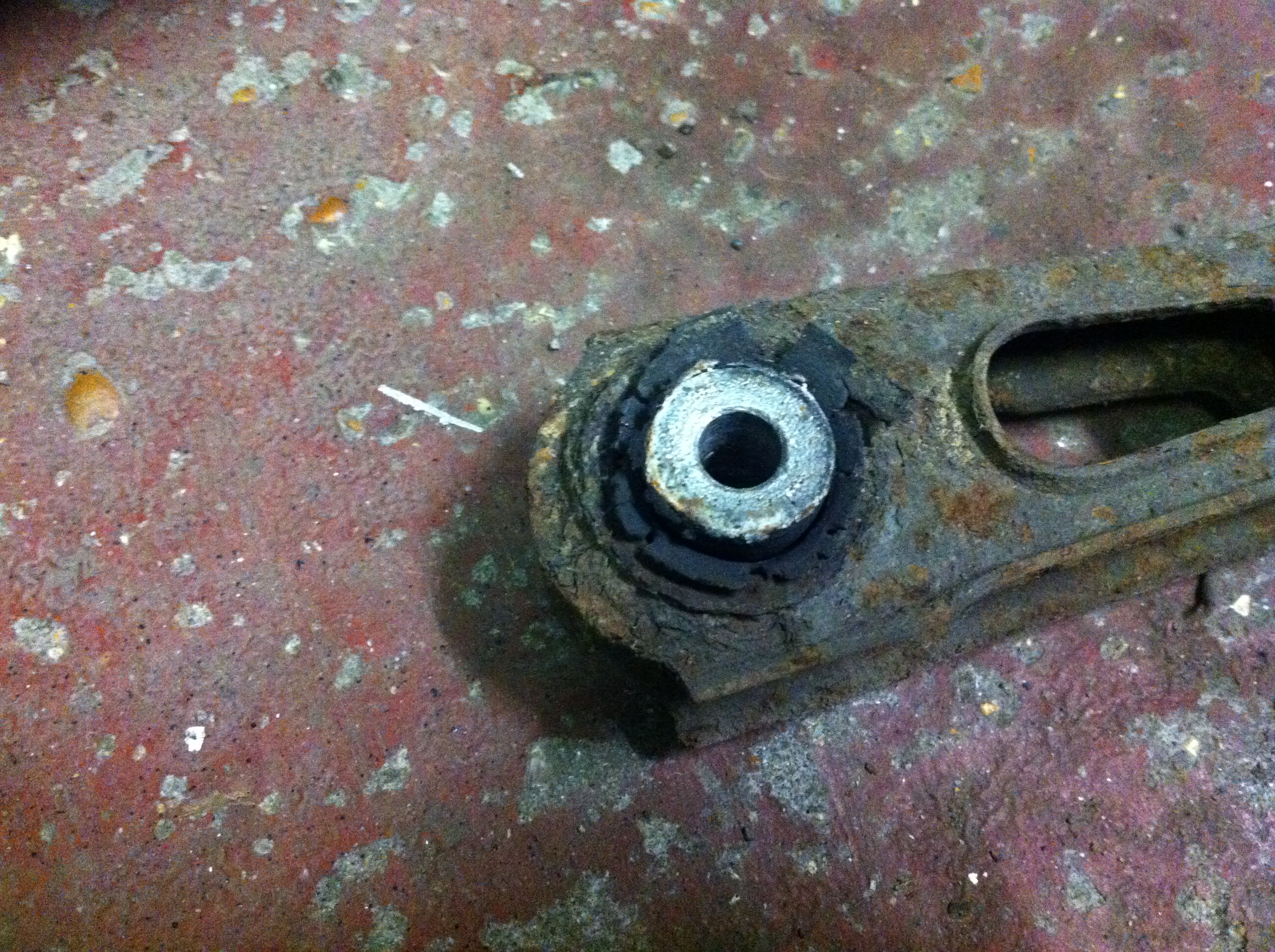

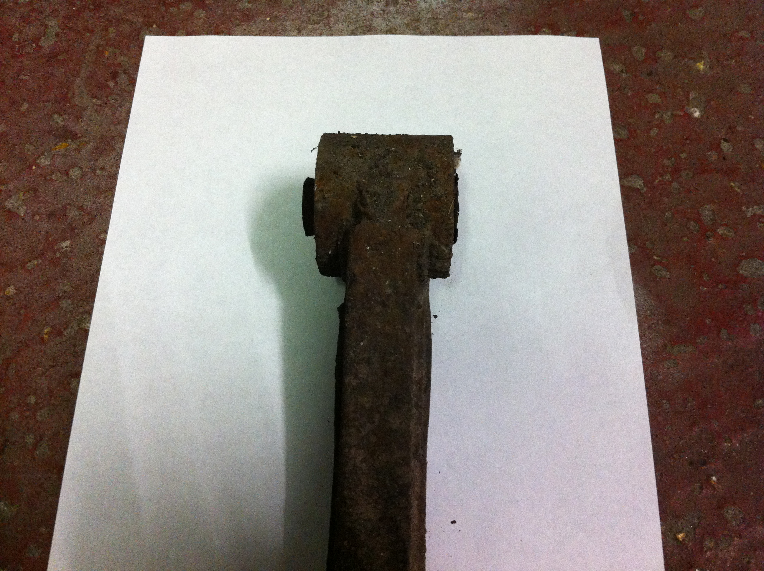

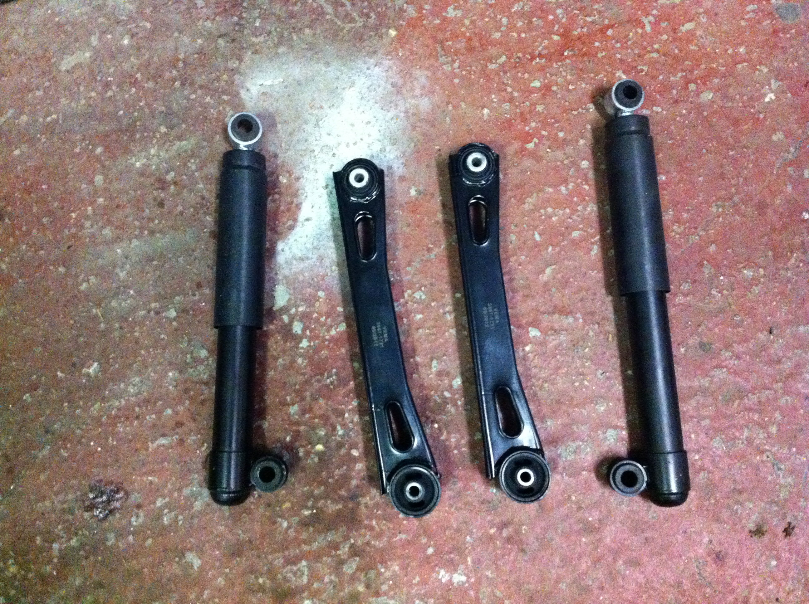

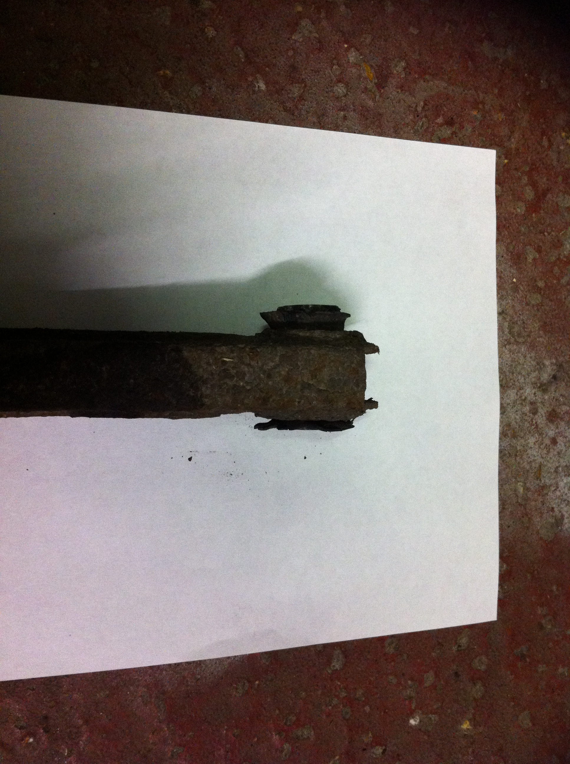

The trailing arms were an advisory on the mot, quite generous I thought once I'd seen them! The bushes were definitely perished, a couple were pushed sideways as can be seen in the pics..........
I also replaced the rear shock absorbers with Bilsteins as they felt worn to me too.........
It's all made a big difference to how secure Bo feels on the road. The front shocks are on order too as they felt worse than the rears.

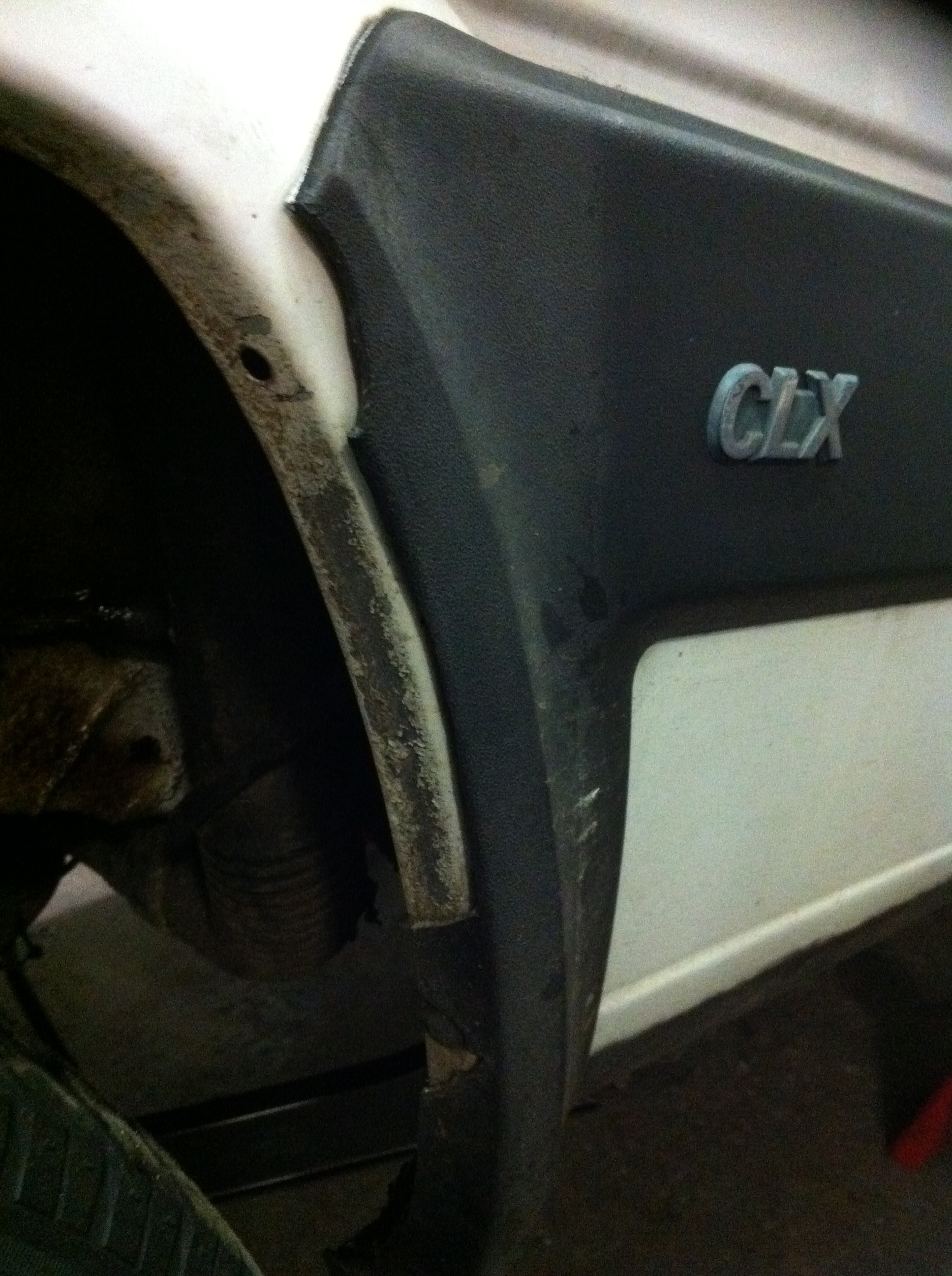

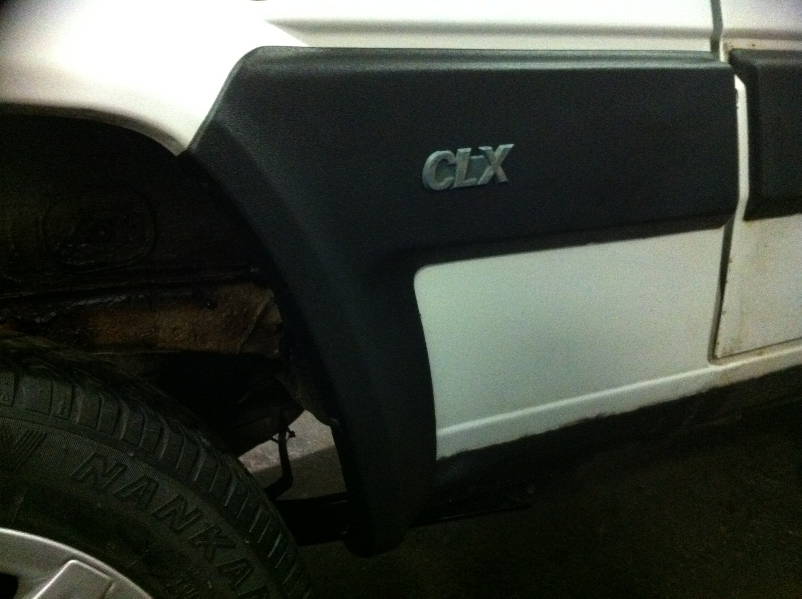

While I had the back wheels off I noticed that the o/s trim was broken.......
So it seemed like a good time to fit a new one. The bodywork behind the trim was in great nick, I'm pleased to say..........

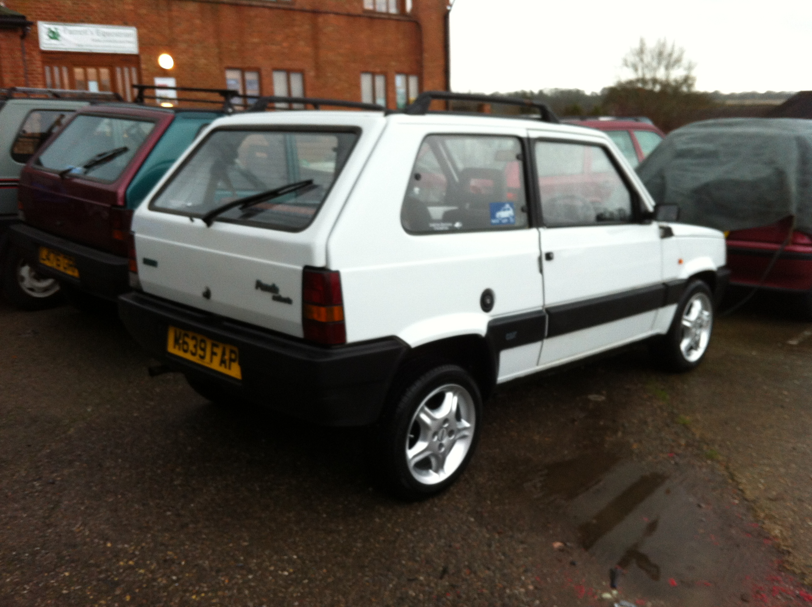

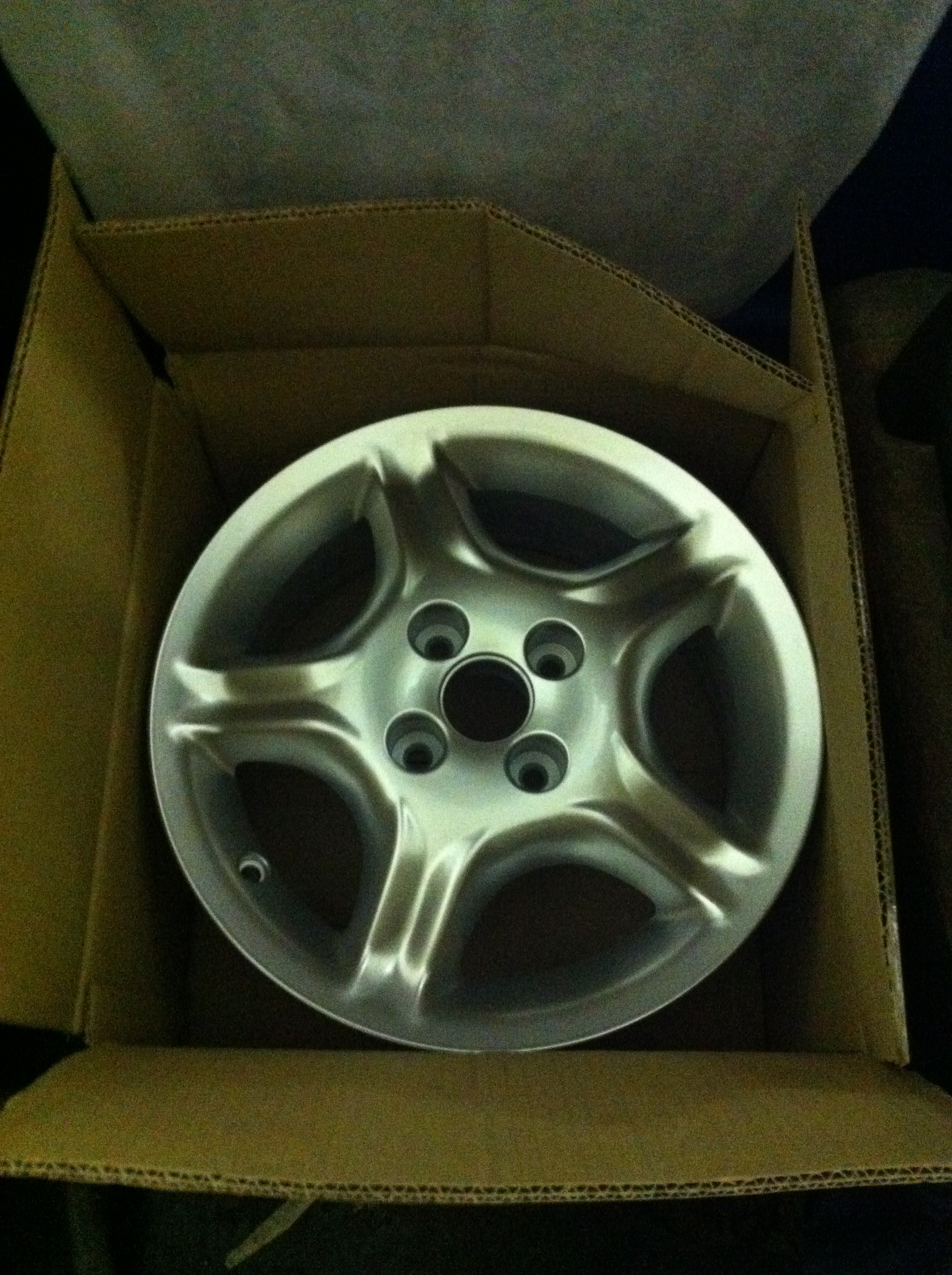

Anyway, I wasn't prepared to try another 13" set only to have the same problem, nor did I want to return to original wheels, so I've now fitted these....
I won them on eBay a few months ago. They are brand new 14" Punto alloys complete with bolts and centre caps all for £87!!! :) Tyres are 165/60/14's.
They are well clear of the shocks but we haven't yet tested to see if they rub on the arches with more than two people on board, they certainly look like they will clear fine. They did need 5mm spacers on the back to clear the chassis on the inside of the wheel arch.

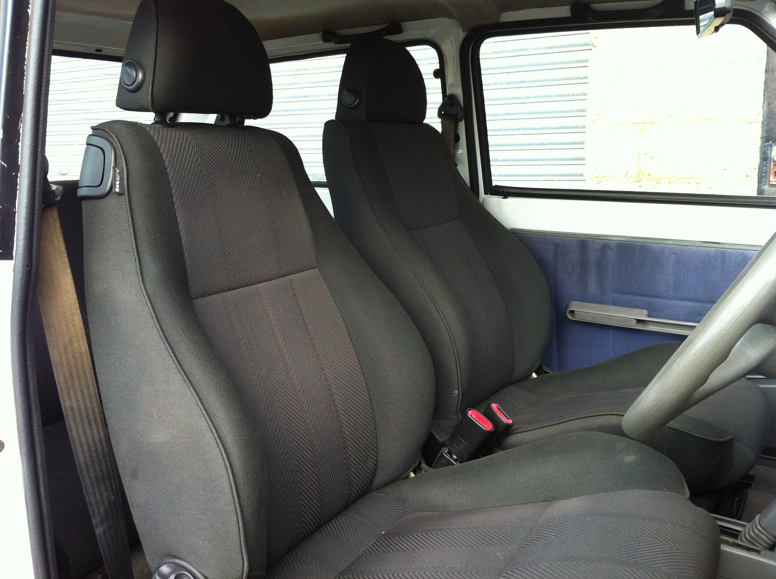

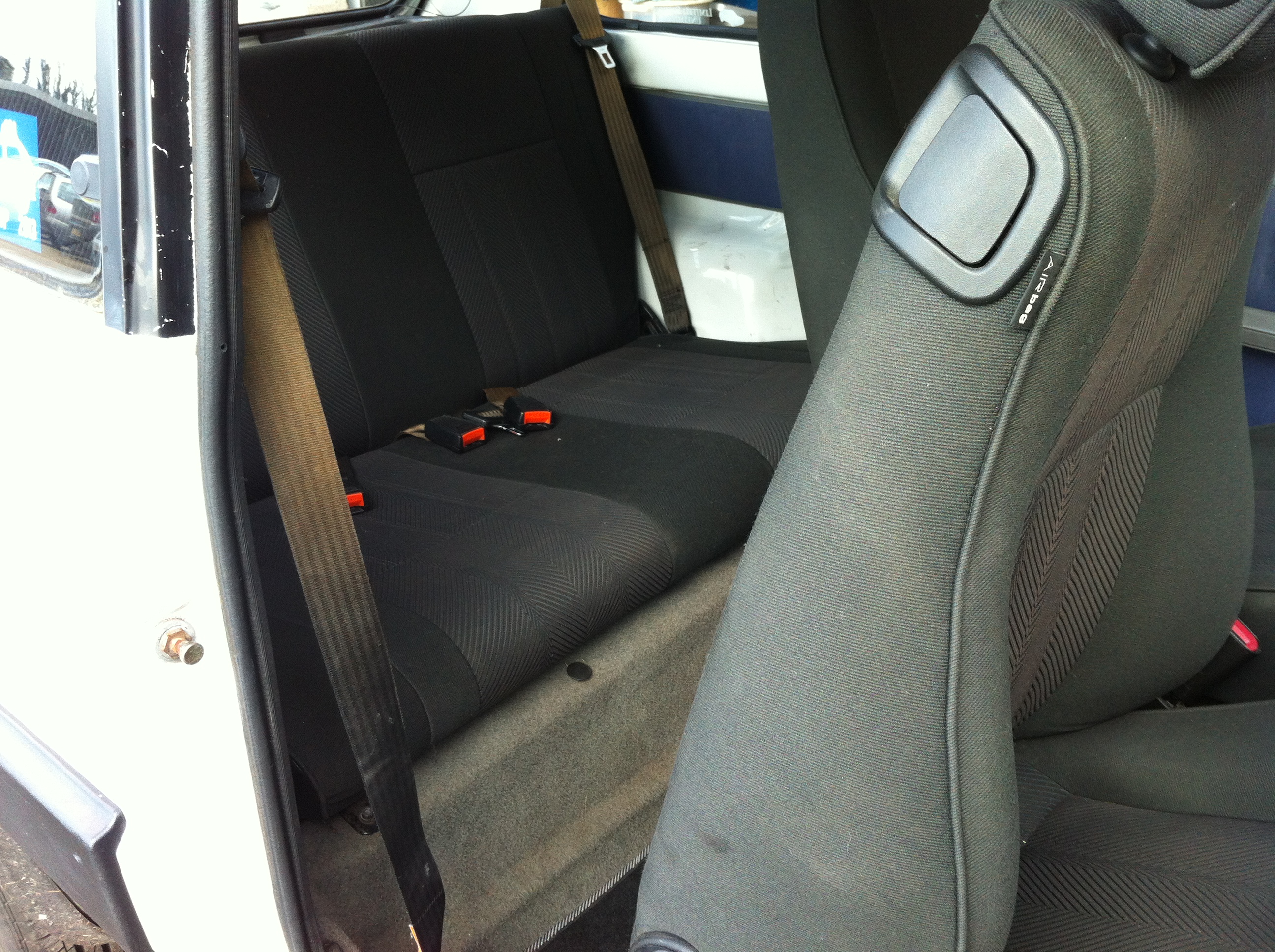

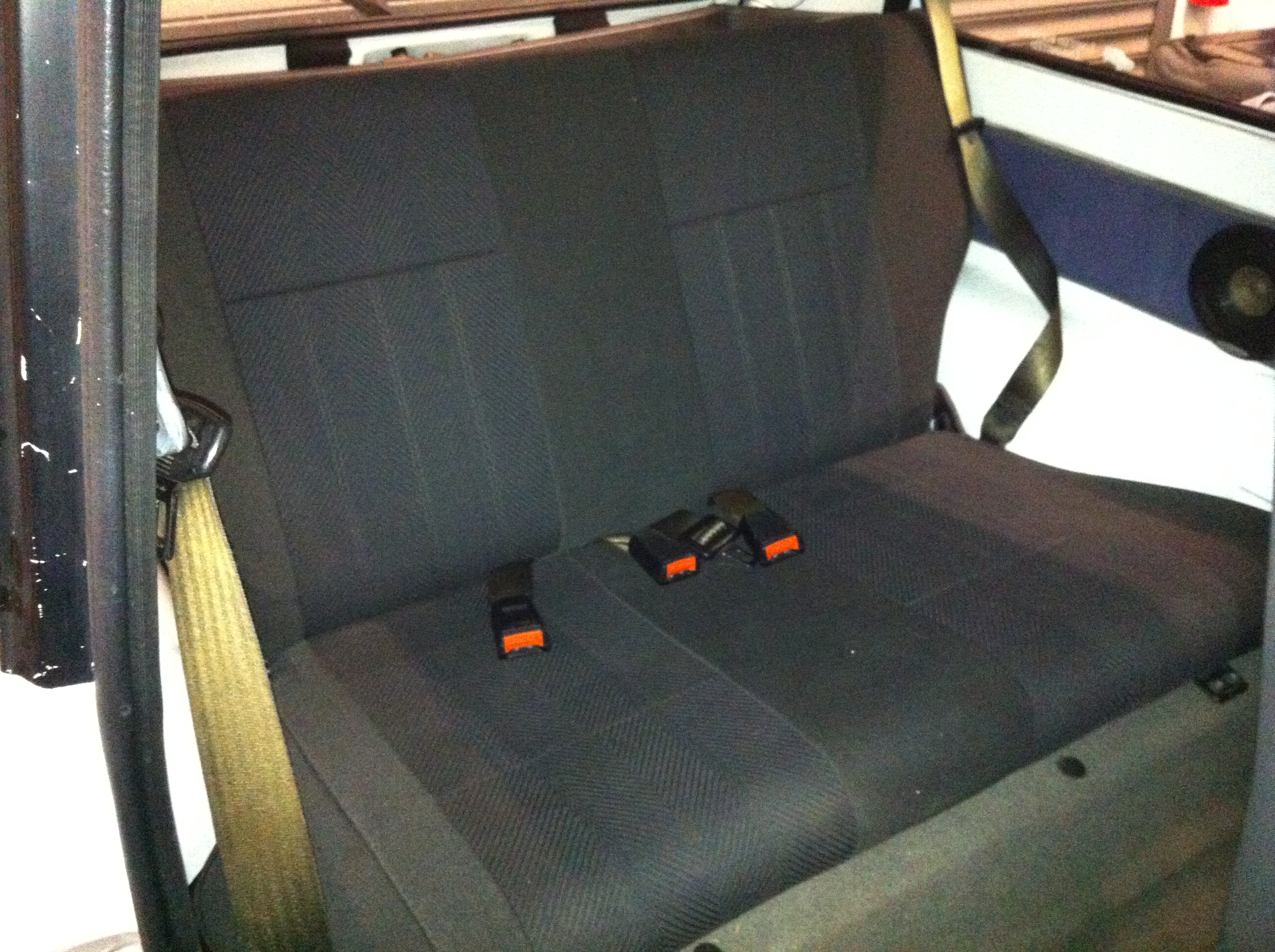

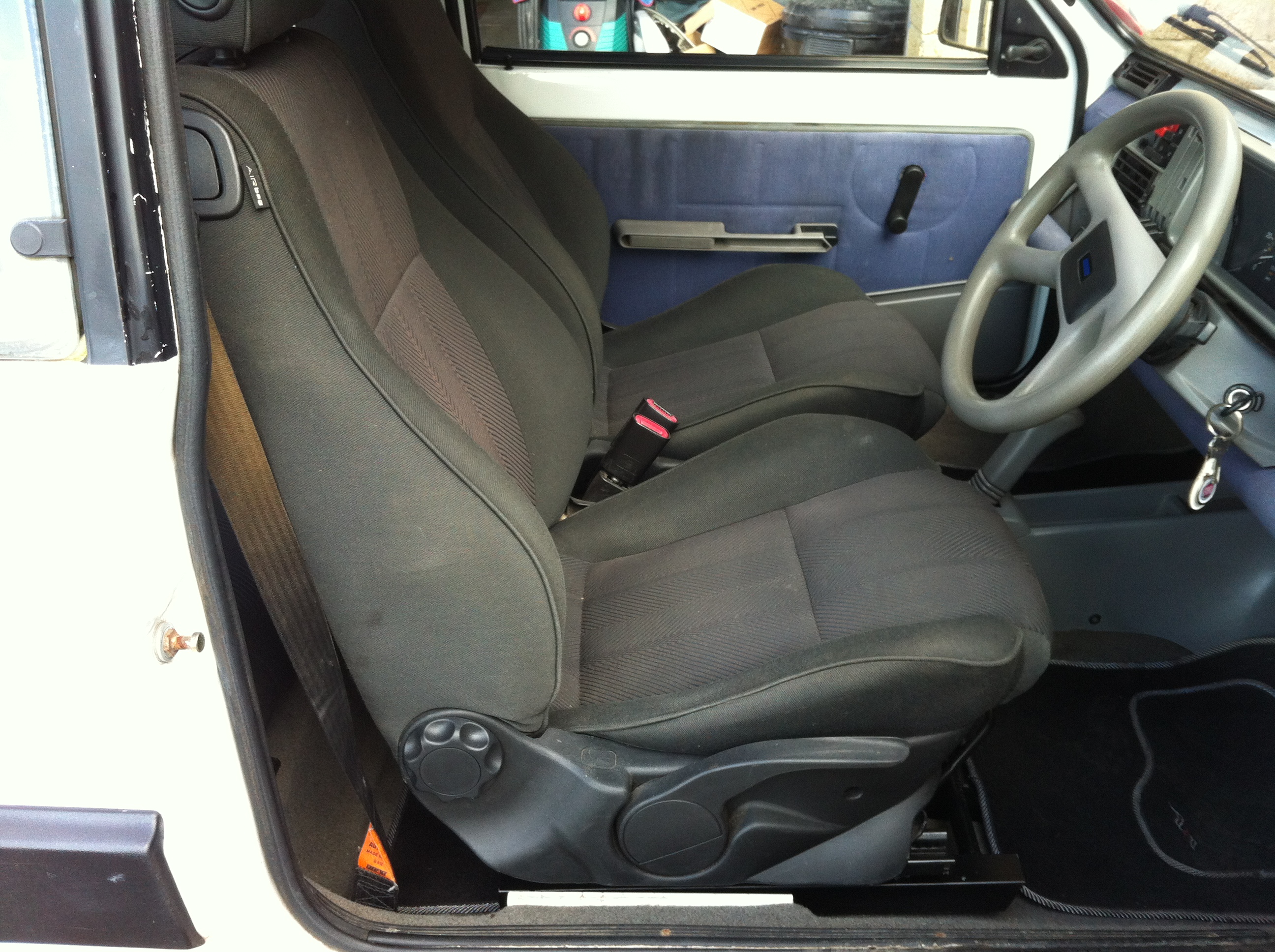

I'd bought, well they didn't cost me anything as it happens, a set of Alfa 147 seats months ago and had the back seat re-trimmed ready to fit to Bo when I got the chance. Well building the seat subframes for Panto gave me the opportunity I needed so I made four subframes, two for Bo.
About a month ago I made some excuse to use Bo for work and quickly fitted the seats. Barbara is back behind the wheel now and her still healing wounds are very grateful for the extra cushoning the Alfa seats provide against our pothole ridden roads.

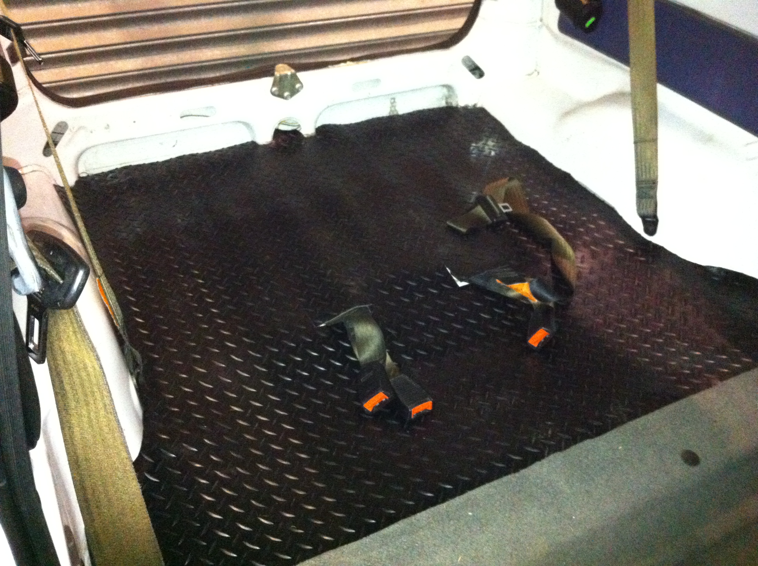

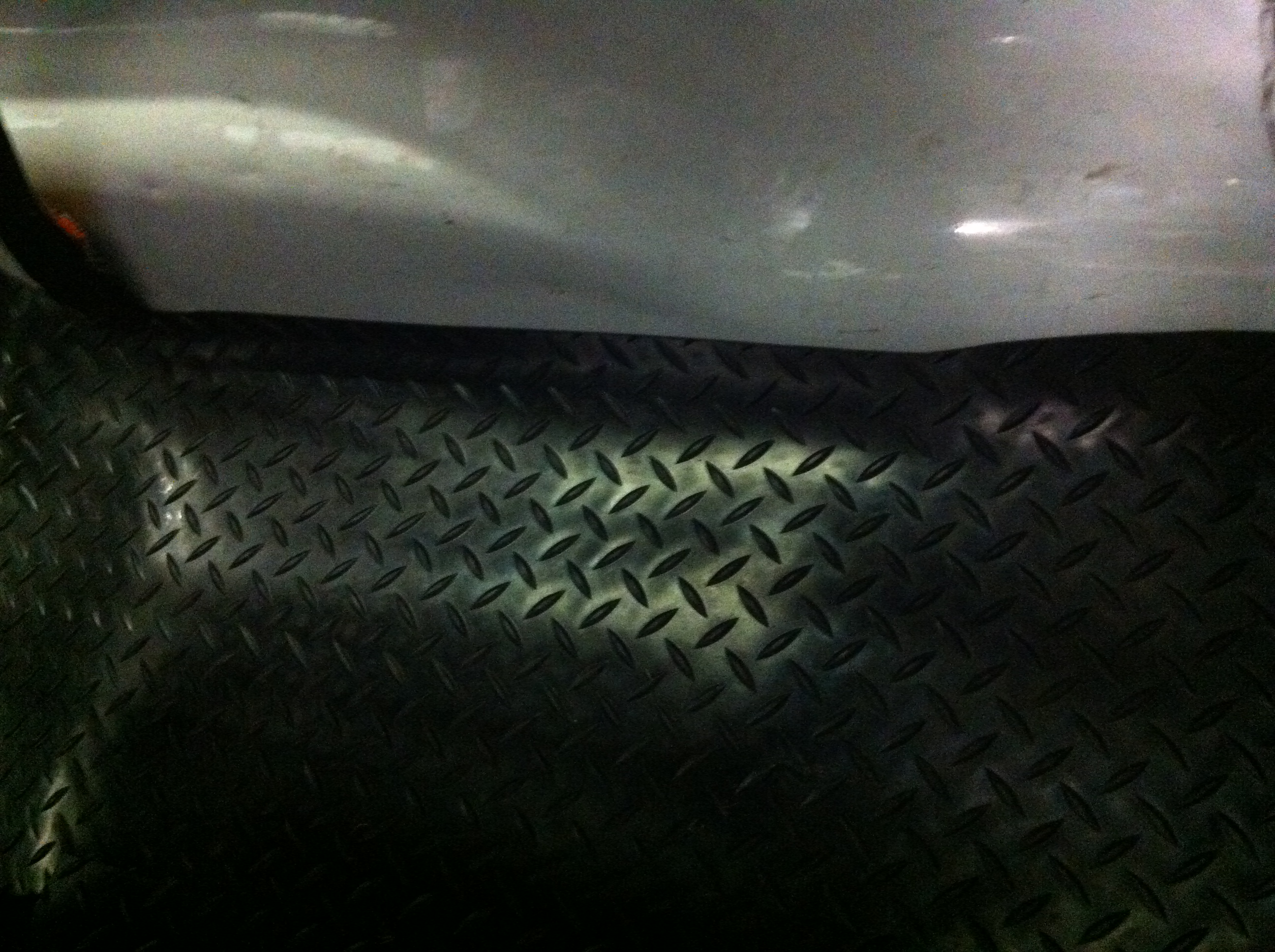

While I was at it I also fitted new flooring in the boot, not original but we like it...
