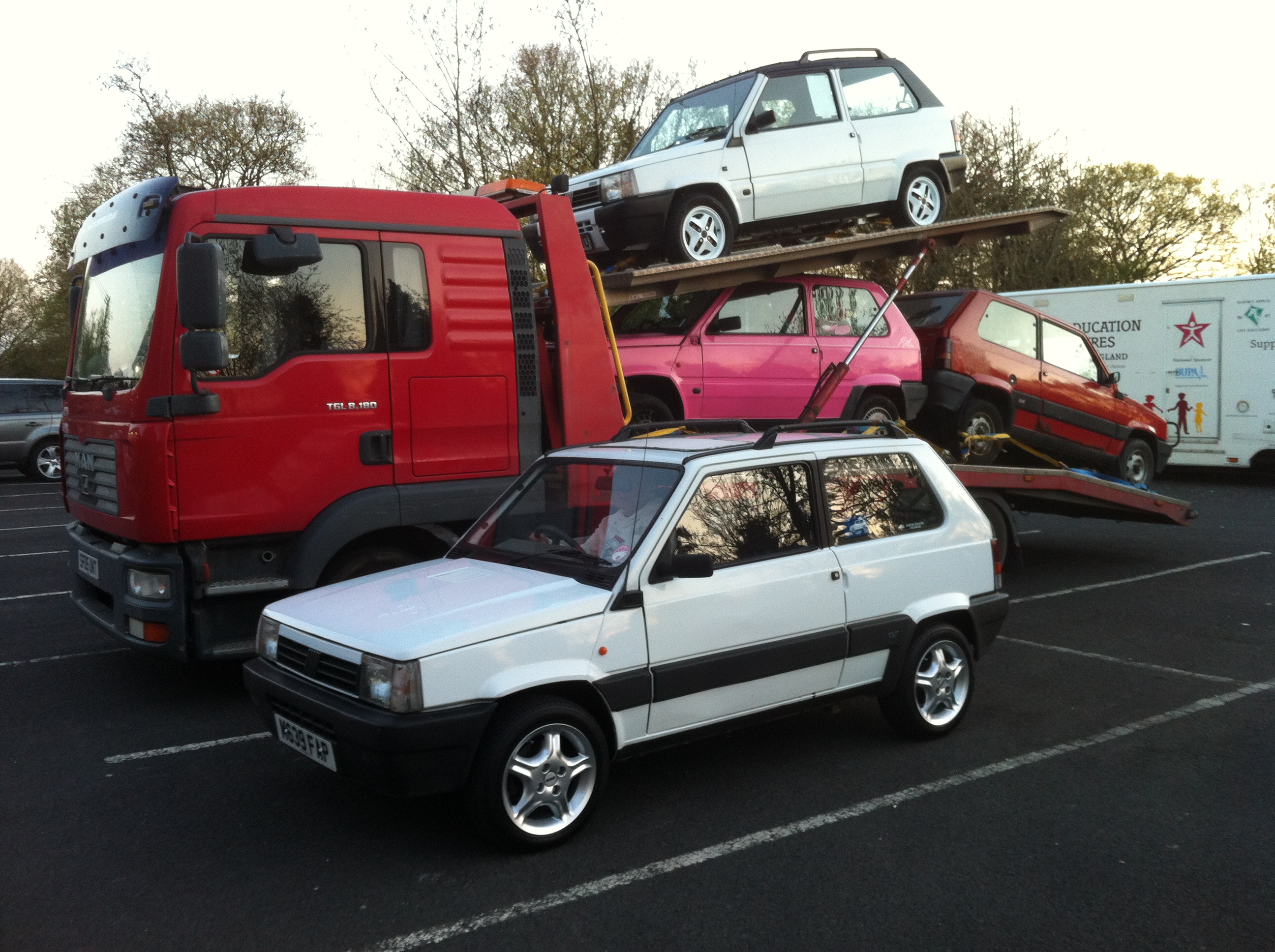

Well, as the pic above shows, Barbara and Bo made it to the NEC last weekend to join the other Pandas that made it there the easy way. Bo also managed to transport Barbara home again on the Monday, and to a hospital appointment later in the afternoon.
Once he got to the hospital entrance however, like a wounded horse collapsing after carrying his rider to safety, Bo collapsed. :cry:
Amazingly there was an empty parking space (yes, in a hospital car park! :eek:) that some kind person was able to help push him into. The AA were called but nothing could be done, and so it was that a fourth Panda arrived at HQ that day on the back of a lorry.
Symptoms are that it stalls as soon as any gear is engaged so I think the problem is clutch related. Now it could be that it's being constantly energised because of a faulty sensor/switch, or components in the clutch assembly have seized/jammed together. I have already swapped the gear lever contact assembly for a spare but this made no difference. Further electrical testing will have to wait a while, and if that doesn't find the problem a gearbox strip down is on the cards.
I really would like to keep this as an auto so will do all I can to ensure that happens, a manual conversion would be the penultimate option, before breaking for spares.
