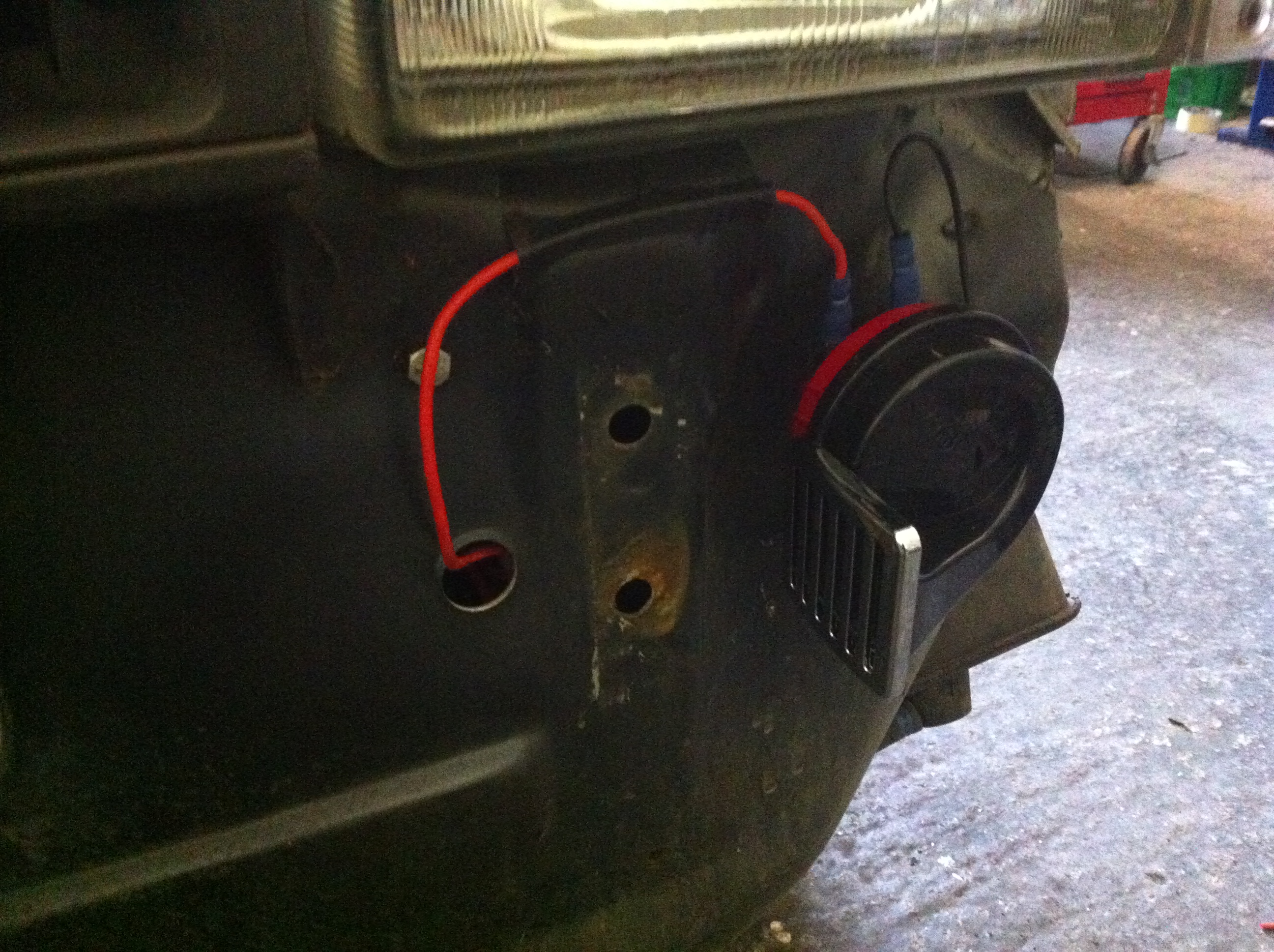

Barbara gets annoyed by the behaviour of some other motorists towards Pandas so one of her main requests was to have a loud horn, well now she has one..........
Twin horns hidden behind the bumper and wired in through a relay does the trick. Barbara's already frightened two old men with them. :)

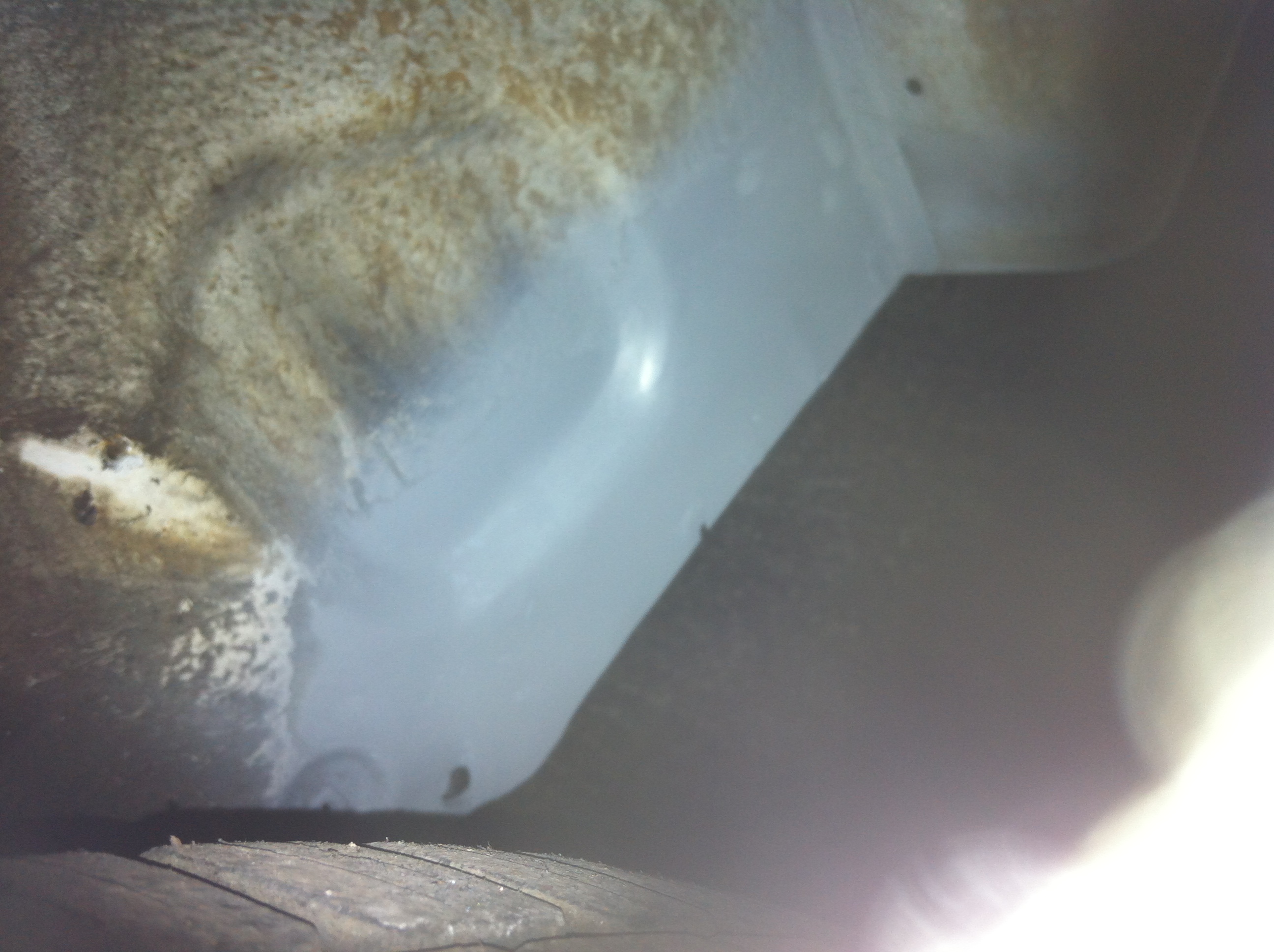

While I was fitting the horns I found a rusty hole under the front o/s wheel arch. I'm afraid I didn't think to take pics until I'd plated and primed it......

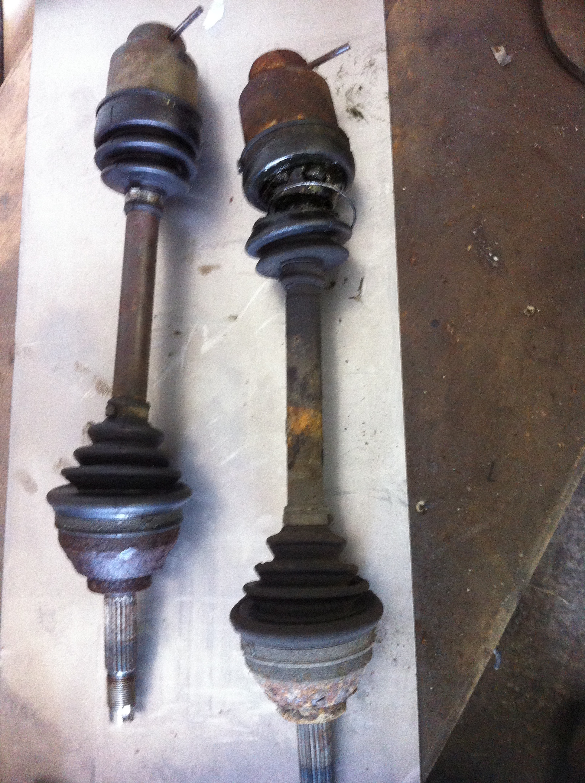

Also found a big split in the cv boot of the inner o/s cv joint. Now the Selecta drive shafts are different to the manual boxes, fortunately, in that they don't have to keep the gearbox oil in. I did have a spare so it was simply a matter of fitting it.

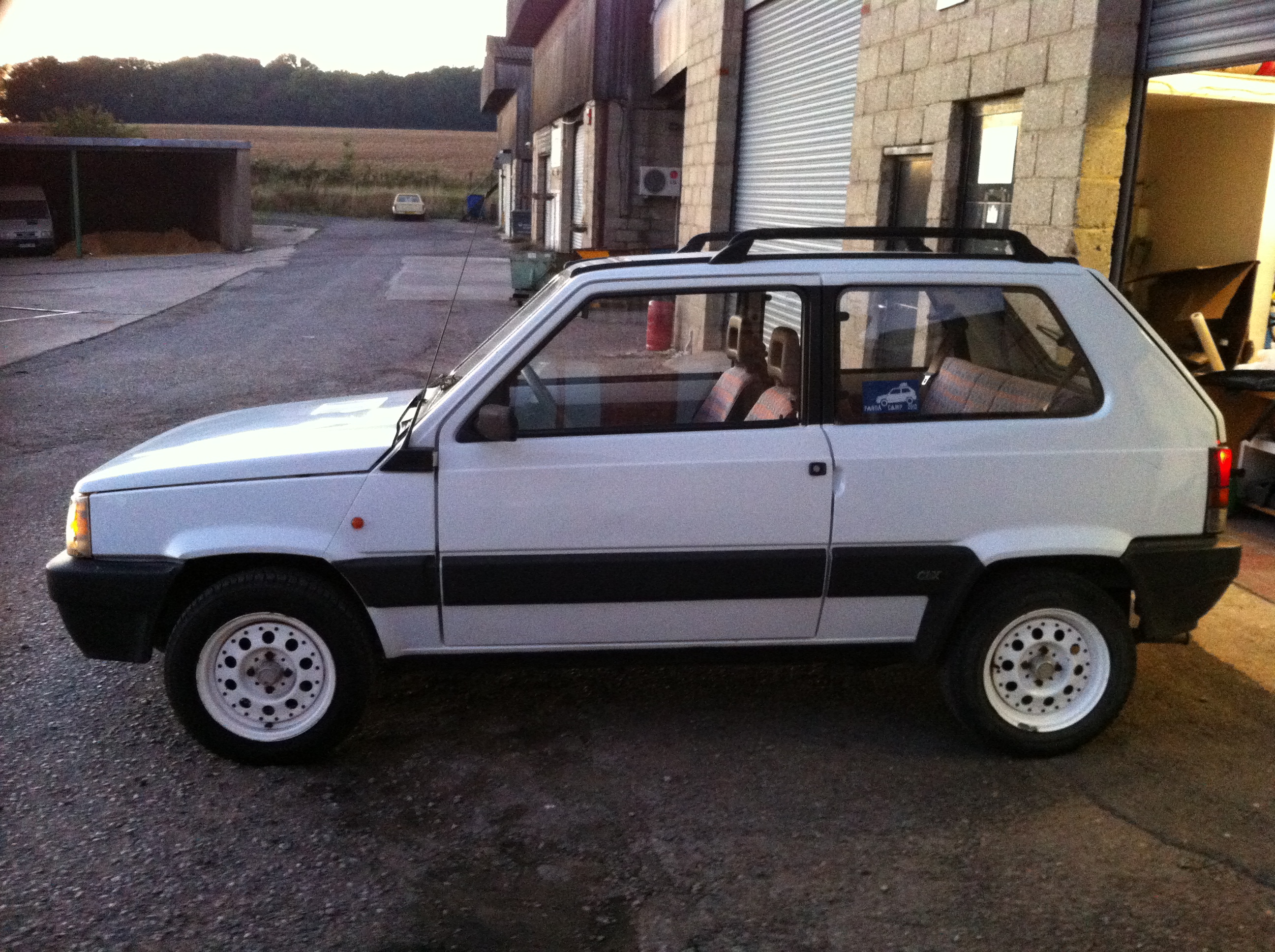

I've also painted the front grille, touched up the paintwork, especially on the B pillars, and generally polished the bodywork.

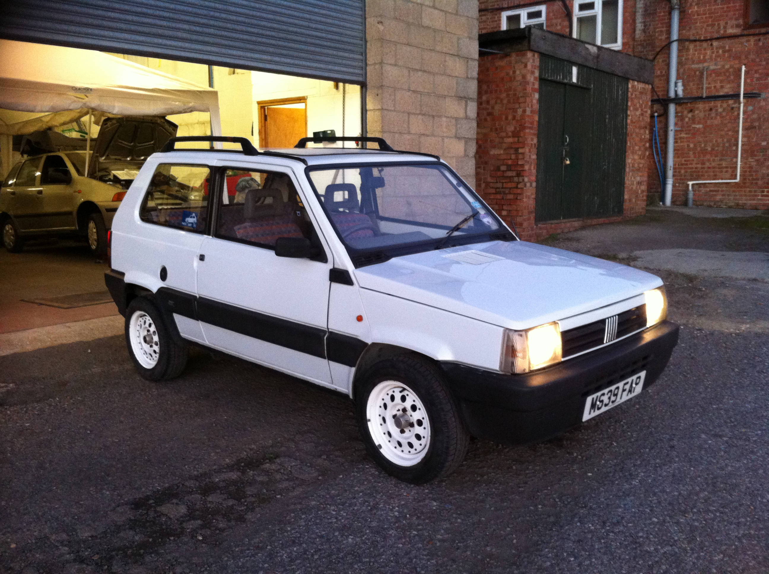

I had some steel wheels I acquired a while back that I thought i'd try on it too. Tyres are 165/70/13's..........

Looks like a different car, nice work! I'm beginning to realise the difference a nice set of wheels can make to some pandas after seeing this and CLS's Beta alloys. Very nice indeed and far more important than some silly petrol leak :p

On those wheels she looks like a 4x4. (y)

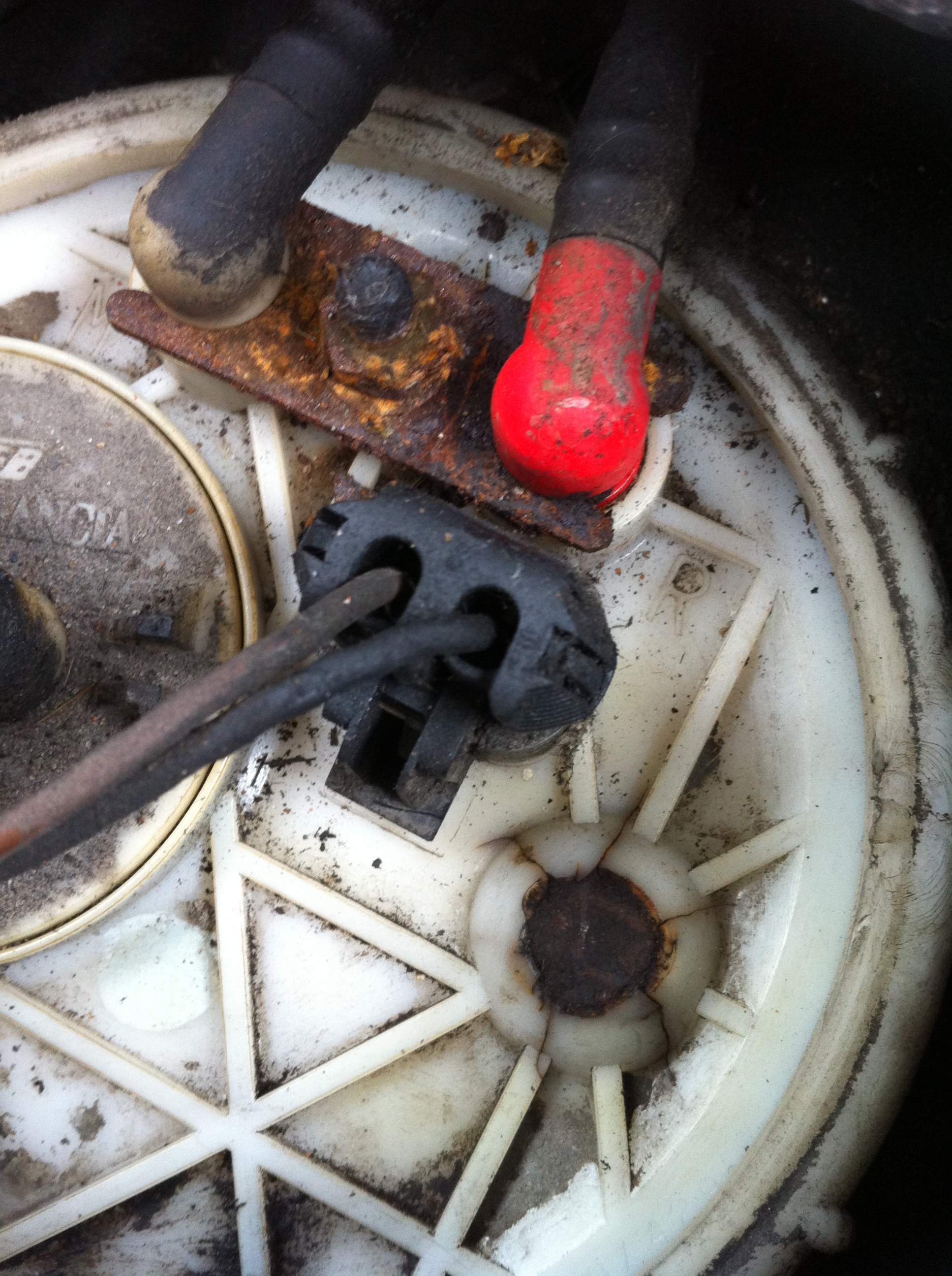

Fuel smell is now sorted, took some fixing though. :( In the end we traced it to this..........
You can see cracking around the little black blob in the lower r/h side of the pic. The green fizz turned out to be really rusty underneath so is now a spares car. I don't like to kill Pandas but it really was the best thing for it as everything attached to the rotten body is good and will serve other Pandas well. I mention this because it gave up its tank unit for Bo as well as all its locks, we had to swap them all even though Bo only needed door locks because they were all on the one key.
When we swapped the tank unit we also found that the fuel pipe elbow was cracked and leeking so we had to repair this too. The fuel smell has now been scent packing. See what I did there :p.
