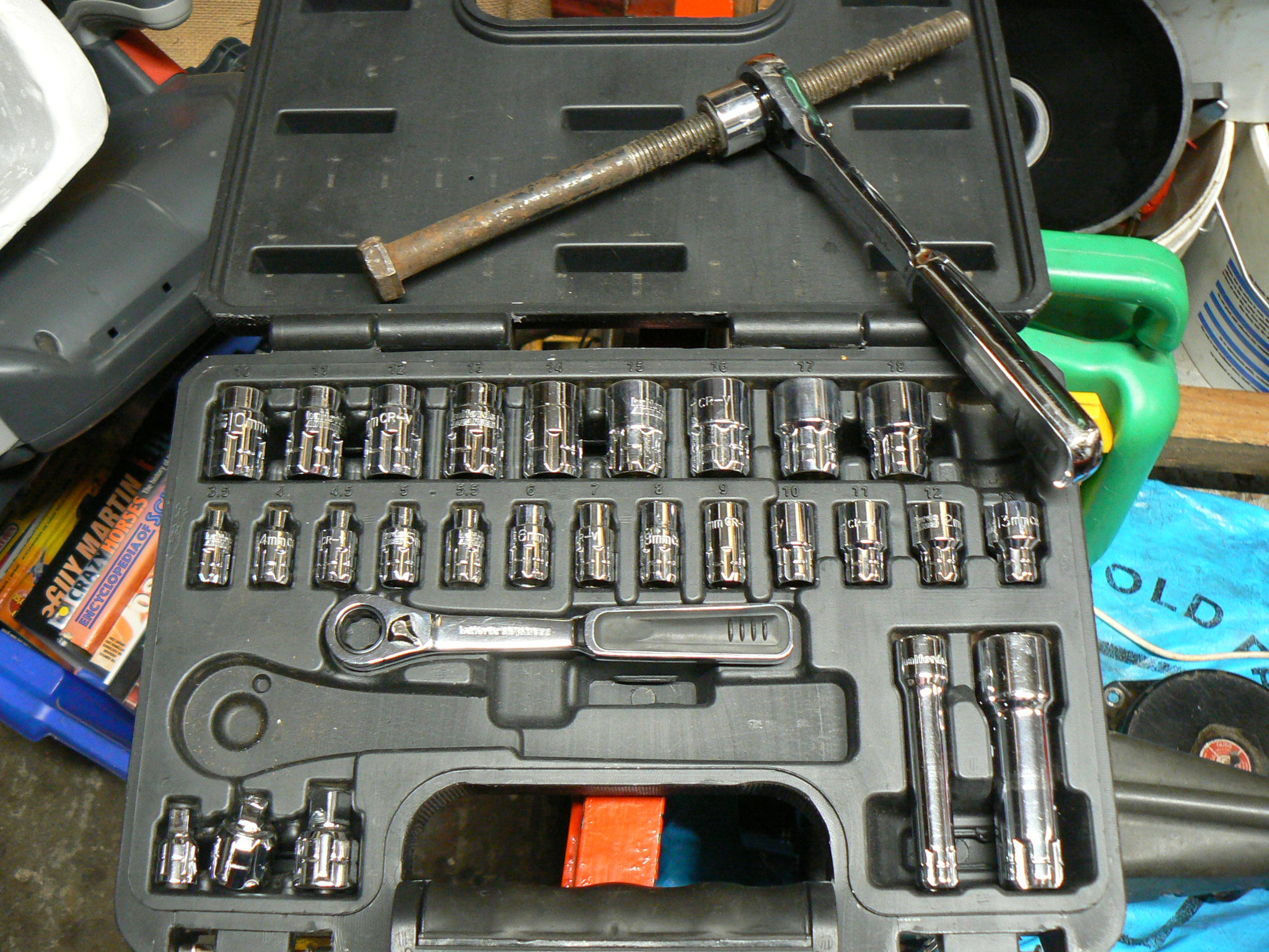

I've mentioned previously how I'm a big fan of Halfords. Their "Halfords Advance" range of tools are pretty decent. However do make sure you're buying from their "Advance" tools range - Nothing wrong with their more budget stuff compared to other budget tools, just don't expect miracles if you buy one and expect it to undo a humoungously tight fixing! Over the last 15 years or so I've bought a number of their Advance tools, most impressive has been this "go thru" socket set:
which allows use when dealing with very long threaded fixings. Used it just yesterday on the battery hold down strap bolts when fitting a new battery to daughter in law's Mazda ". An unexpected advantage of it has also been the slimness of the ratchet head/socket:

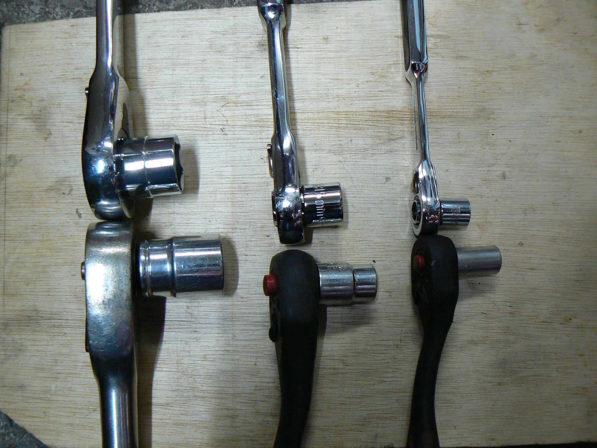

From the left the ones at the bottom are typical examples of 1/2" then 3/8" and finally 1/4" drive ratchets. Above them are the equivalents in the Go thru (American spelling) ratchet/socket assemblies. You can see how the go thru design is considerably less deep? this has been of great advantage when working on stuff like cam belts where access is limited between the front of the block and inner wing. Only criticism I can think to make is you can't buy a power bar/"T" handle for them in the UK. However the socket wall thickness is very average so probably you wouldn't choose one of these to undo "stupidly tight" fixings?

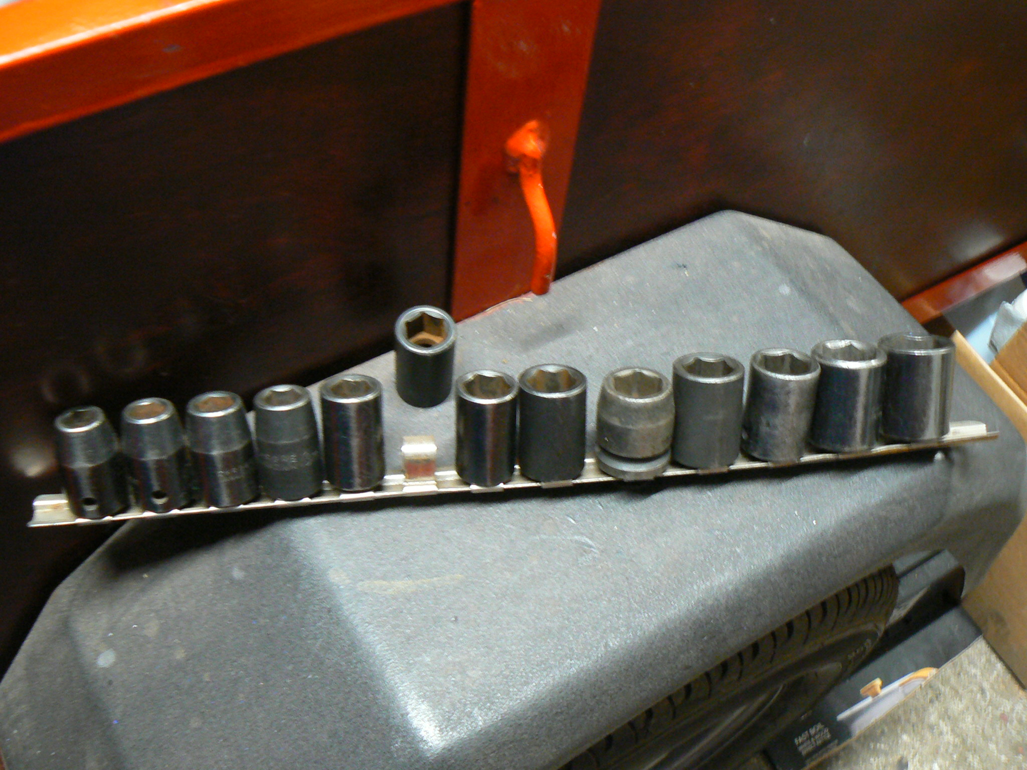

Sockets are especially easy to loose because they are small and can roll away. I can strongly recommend the "clip type" socket rails where you store the sockets on physical clips. If a socket is missing you will immediately see the clip standing out:
I'm not so keen on the flat strip magnetic type for this reason. As your tool kit builds up being able to see at a glance if there's a "gap" is very handy and saves time at the end of the day when you're tired and just want to go in and have a nice cup of tea instead of checking socket sizes to find which one it is that's missing. You could spend a good few minutes checking something like this:

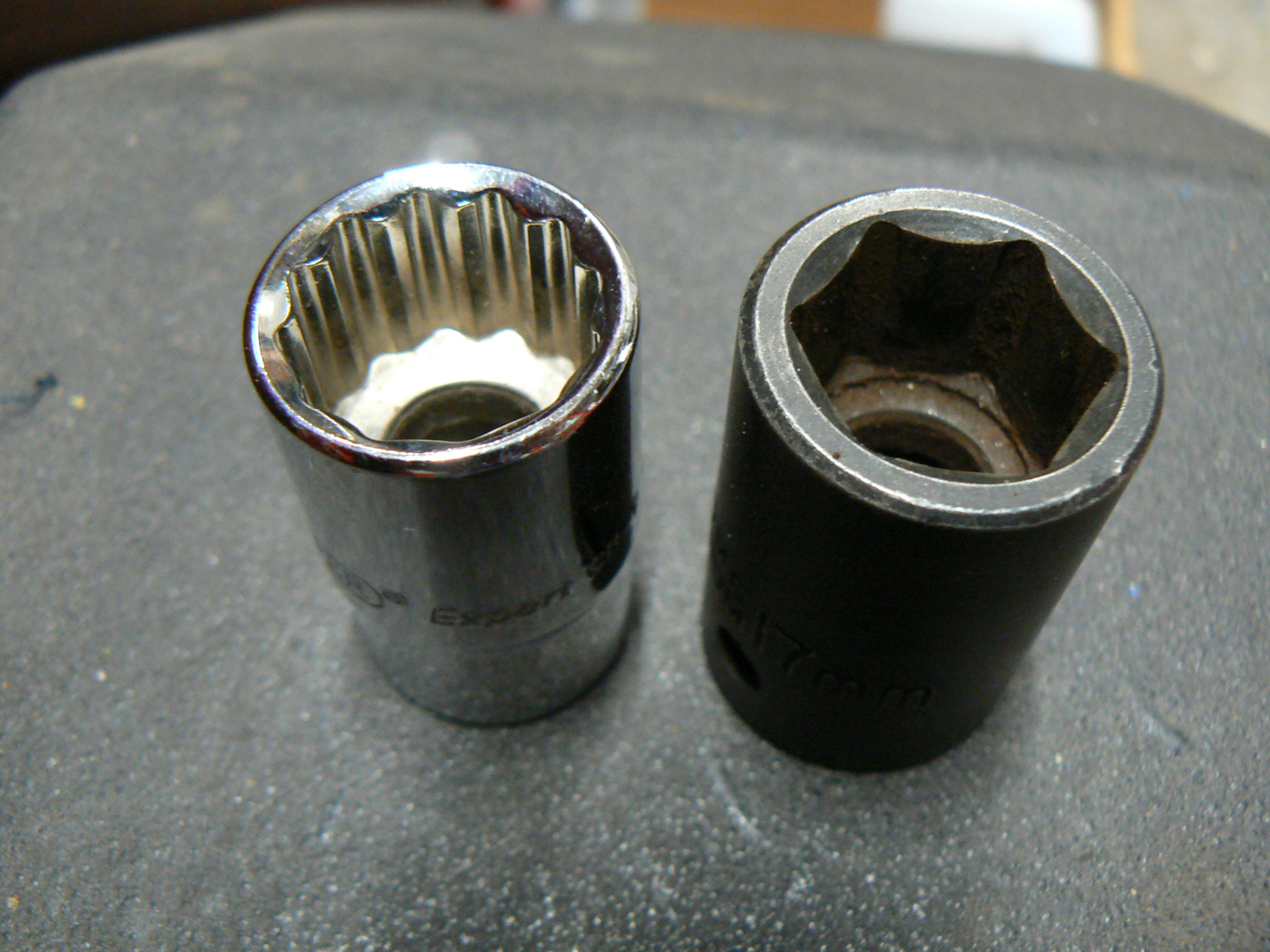

Yup, I tend to always reach for those black impact sockets first. However the much thinner sidewall of a 12 point chrome socket is sometimes needed due to clearance problems. Compare these two:
The 12 pointer on the left just doesn't have the thickness to survive a decent impact wrench's attentions. Impact sockets, like the one on the right are made of less brittle metal too. If you do use a thin wall socket on an impact gun then be very careful as it can shatter quite violently and spin off wee sharp bits of metal as it breaks up - don't want something like that in your eye! By the way, notice that both these sockets are "Wall Drive". Look very carefully at the shape and you'll notice they are not "sharp" hex (or Bi hex) shapes. The points are rounded so that the force is not applied to the very point of the Nut/bolt hex shape but rather to the flank of the hex. This greatly reduces the tendency to round of a tight fixing. Most manufacturers are now producing tools to this design but cheaper offerings may not - just something to look out for.

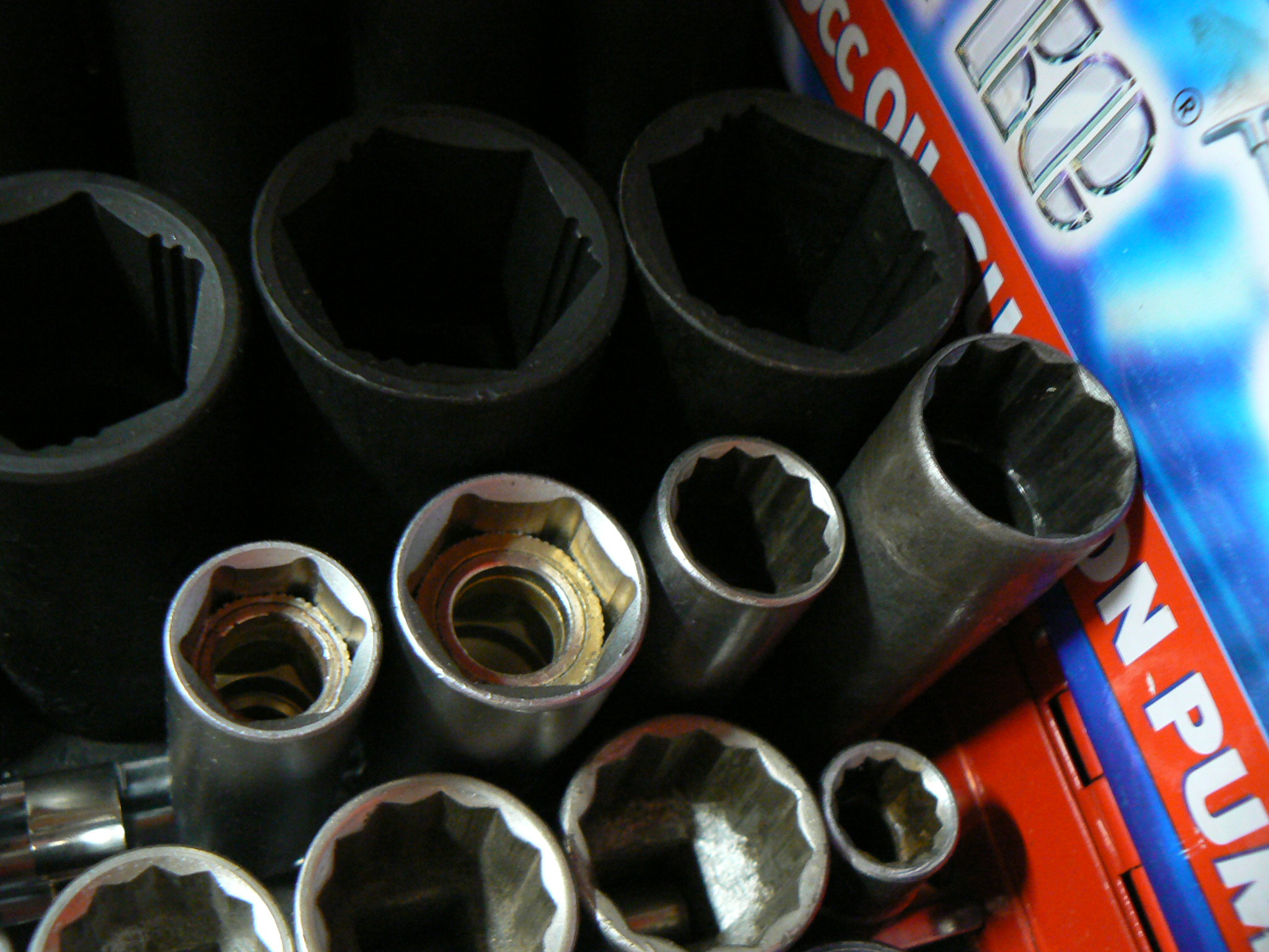

I'd had "ordinary" impact sockets for years before deciding to splash out on a set of deep ones. I already knew I wanted single hex type so started to look at the options and came across Bergen's Xi-Ion sockets. They are just like normal deep impact sockets but have some grooves running down the face of every second face (so 3 of the 6 faces) on the side which contacts the nut/bolt when applying an anticlockwise force - as you do when undoing most right hand threaded fixings:
here's a close up:
The claim is that it bites into the fixing where other designs tend to round the corners off. I found it difficult to see it working but they were deep impact sockets, from a brand name I trusted - from previous purchases - and the price was right, so I bought the "big" kit (10 to 32mm). I tell you what, they really do work. Used on normally tightened fixings they behave just as you'd expect any socket to. However when undoing - anticlockwise - an exceptionally tight/seized nut/bolt then, as it starts to round off the corners, instead of just slipping over the points and rounding it off the little grooves cut into the faces of the nut/bolt as they deform and provide much more purchase. Of course it can't perform miracles but it works much better than an ordinary socket in this sort of scenario.
I noticed them in your pictures above, I think my current set of deep sockets are bergen and they are really good, so I will have to check these out. I don't mind paying for good tools I am just not paying snap on prices.

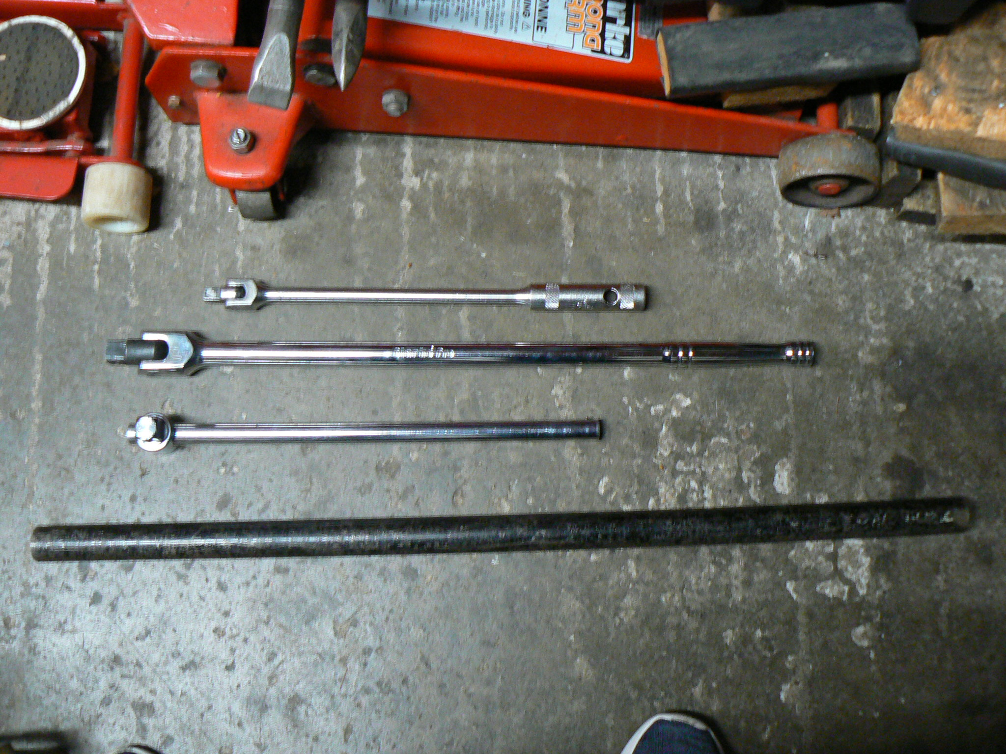

3/4 inch drive, now you're talking "muscle". Many years ago a friend tipped me off that a local elderly "one man band" workshop was shutting his doors for good and was holding a sale of his stuff that weekend for anyone in the trade who wanted to go along. So I went. Most of the stuff was heavy equipment, like his 4 poster, air compressor, etc but there was also a large 3/4 inch drive socket set which no one even bid on so I got it for a song. Most of the sockets are larger than you need on private vehicles so seldom see the light of day (but are very useful on the odd occasion you need them) but it also included a ratchet, "T" bar and 3 extensions. The "T" bar in particular has been very useful together with a piece of pipe to increase the leverage. Although I don't need to use it too often I found myself using it often enough to be worth buying a power bar to complement it:
The 1/2" bar at the top of the picture is my "trusty" old Britool, just to give you a sense of scale - it's 14" or 360mm long. Next down is the new 3/4" drive power bar and it's 2ft/600mm long. The "T" bar is 16"/400mm long but is largely redundant now I've got the bigger power bar. This gear is so heavy duty you can put the extension tube over either the "T" bar or power bar and jump up and down on the end without them hardly bending at all!
The handle of the second one down looks just like mine but the head on mine is different. Probably the same brand? I can't remember what mine actually is but I got it from machine mart for removing Range Rover wheel bolts when I had my 86 Classic. as I had completely bent the standard boot tool box wheel wrench.
I have a T-handle but almost never use it. Every time I have used them in the past I have always managed to bend the handle so I tend to stick to a good breaker bar, can't go too far wrong with that...
