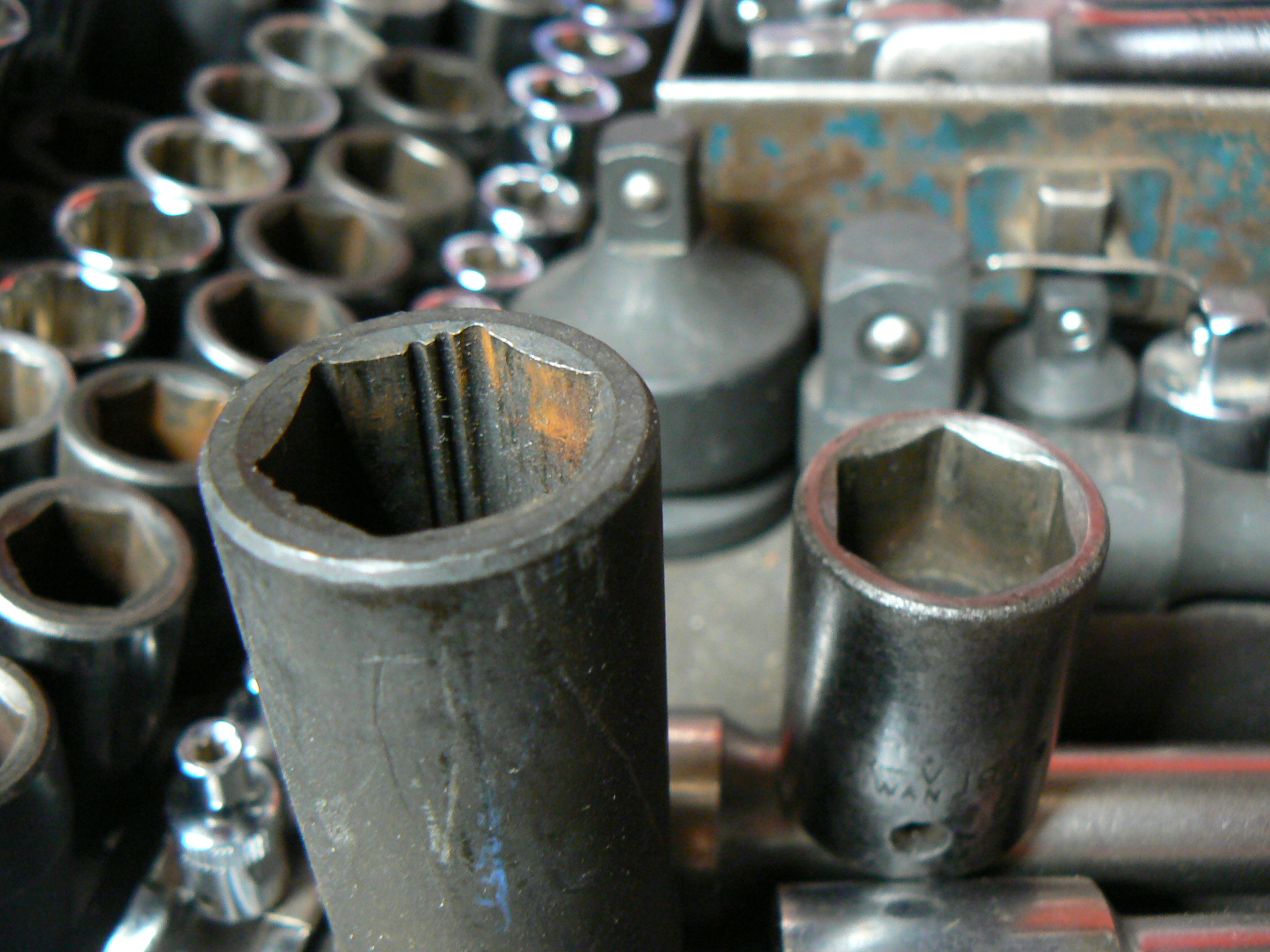

The problem is what should you buy as a basic starter? I'd still advise 1/2" drive for it's "robustness" with maybe a small 3/8" set to back it up for getting into tight corners. and I can strongly recommend Bergen/US pro's Xi-ION single hex sockets. Here's an add for a 1/2" drive set: https://berlintools.co.uk/products/bergen-20pcs-1-2-drive-6-point-shallow-xi-ion-sockets-8mm-32mm There are a number of manufacturers now making these sockets with the "grippy" slots and I can vouch for the fact they really work very well on damaged fixings. Personally I like the black "impact" sockets so I can use them with my air gun (standard chromed ones tend to break if used with impact guns) Here's a picture of a 19mm deep socket - on the left - with the slots and a normal "shallow" 19mm impact socket.
I tend to reach for the deep sockets by default.
