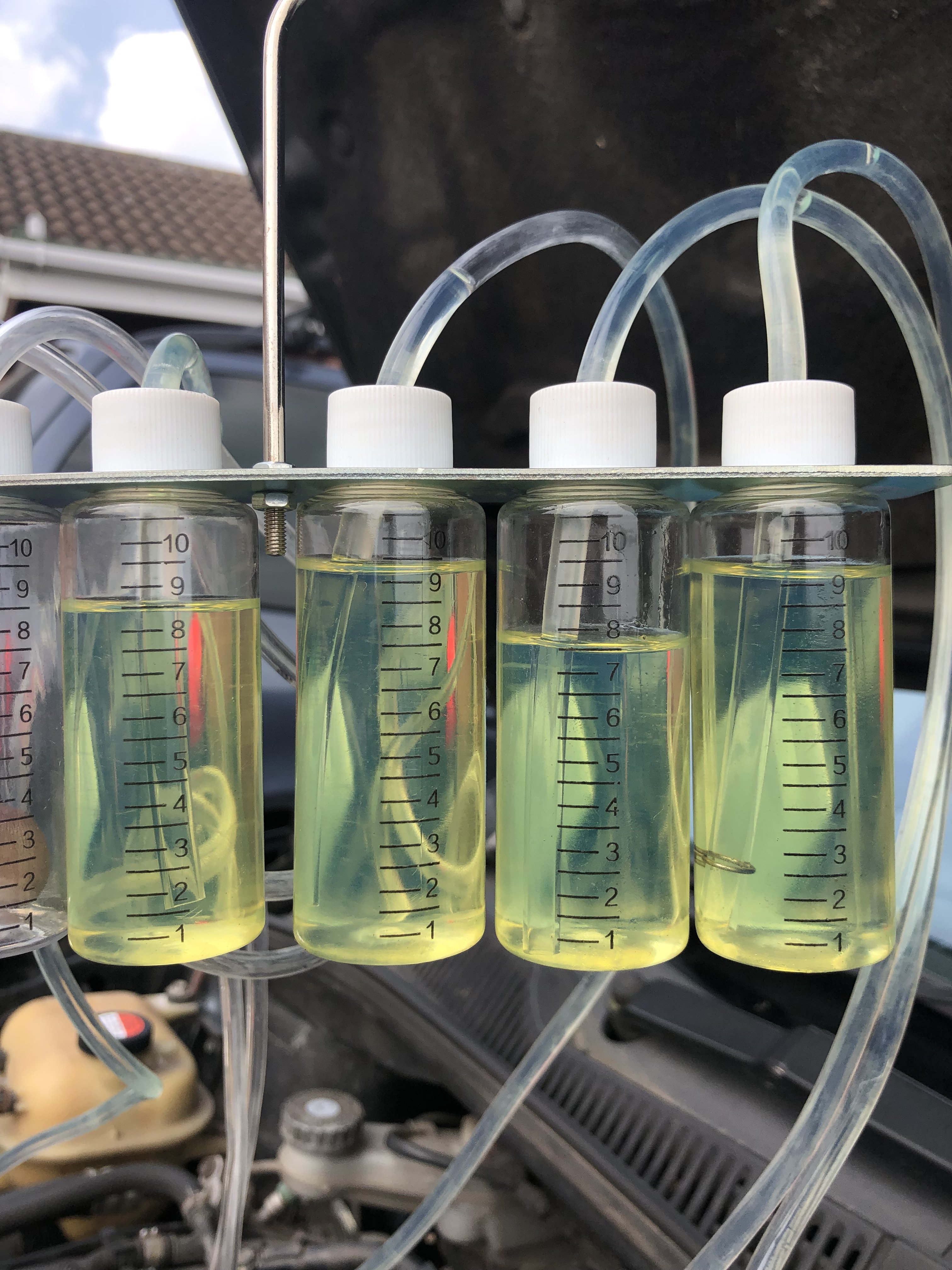

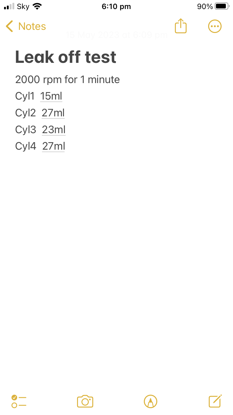

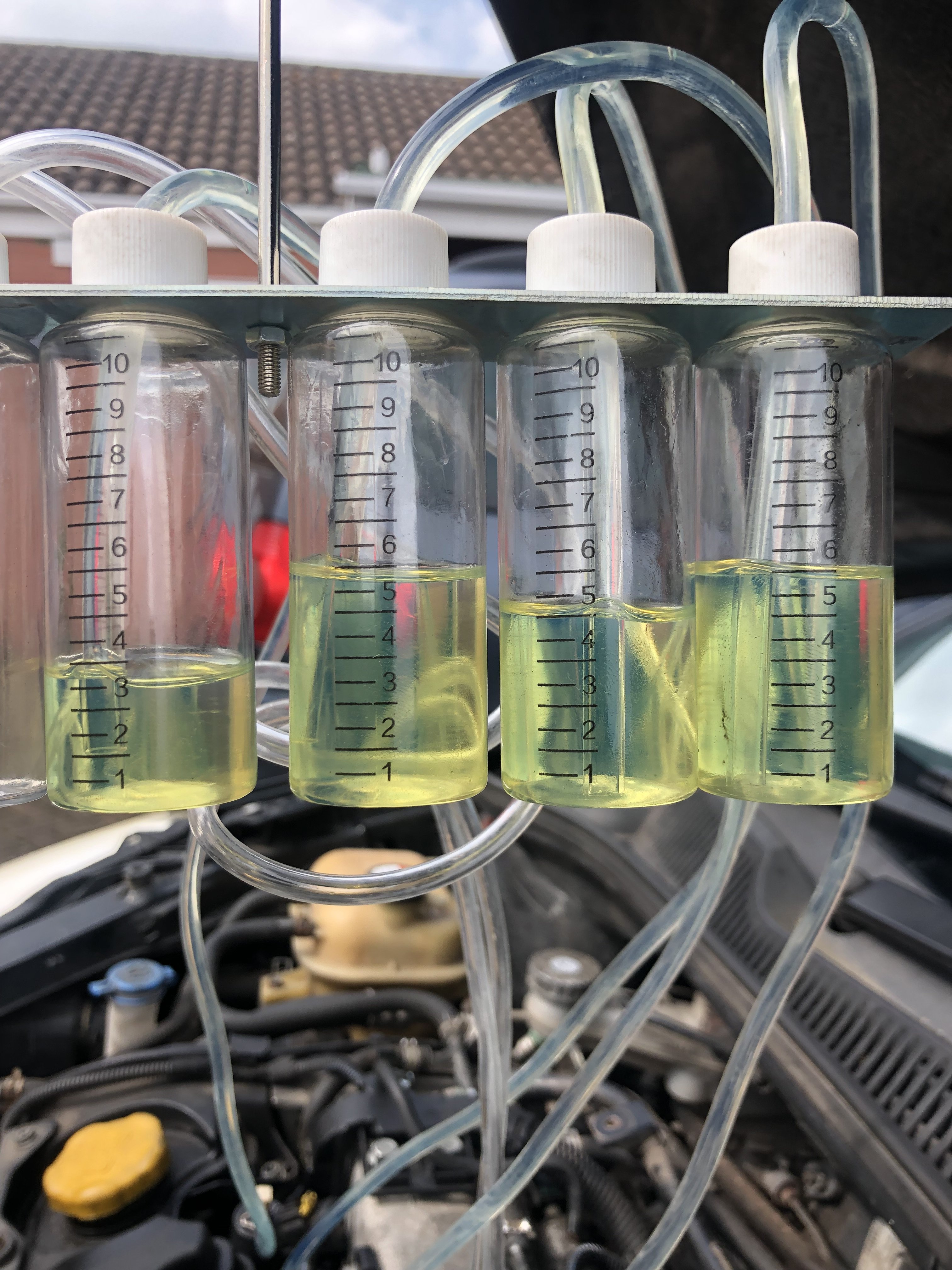

Hi just wondered if anybody can help with a starting issue on my 2007 Sedici which I believe shares the same 1.9 Multijet engine as the Doblo. First start of the day is a complete pain up the a*se, you can heat it up numerous times and it’ll churn over, almost fire but then churn over a bit more finely starting with a big puff of white smoke. Once it’s warm it starts fine but then on tickover but only when warm it’s got a funny jingly misfire (sounds like a load of morris dancers) that goes away if you rev it slightly, also if you hold it at about half throttle when stationary and it’s warm it starts to slightly misfire, drives fine though. Have attached some fuel pressure readings when running and not running to see if anybody can see anything amiss?
