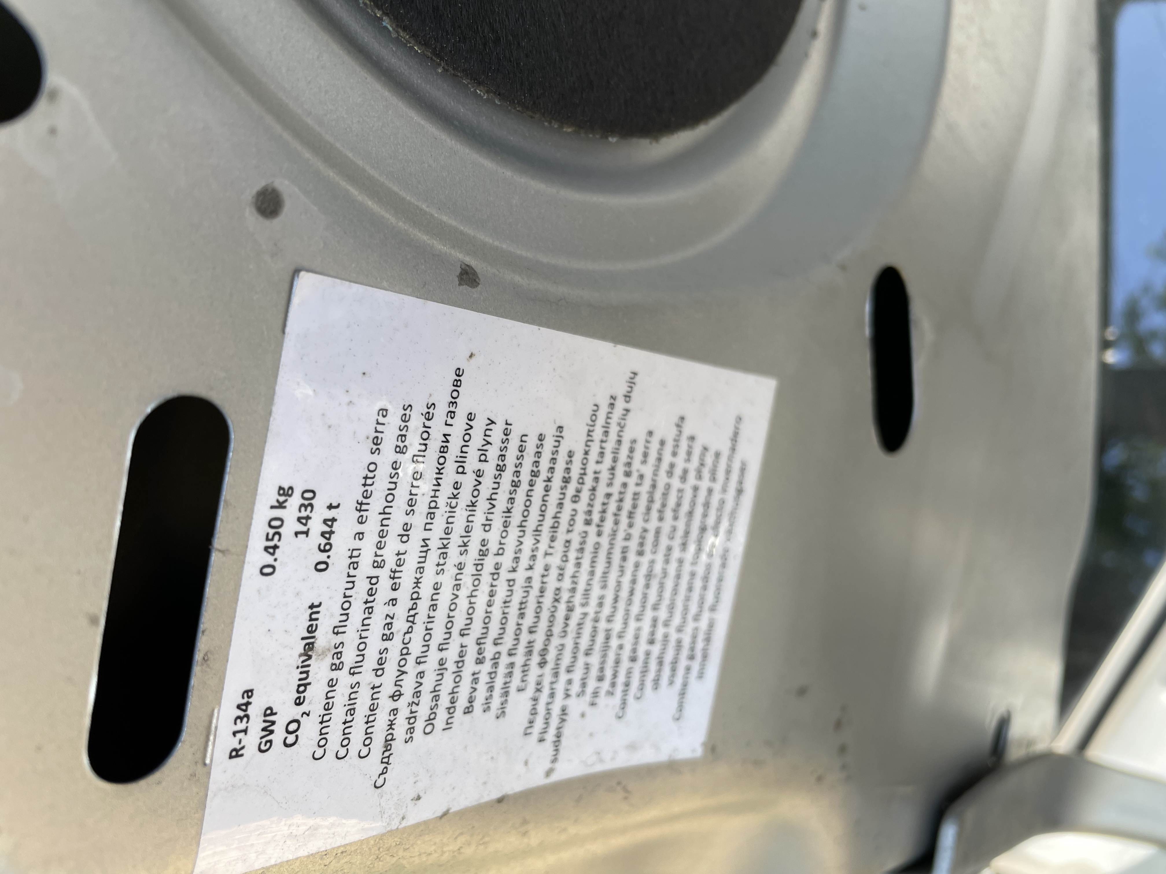

I drive a 2017 Vauxhall Combo (same as Fiat Doblo)
It was new in March 2017.
Recently I wanted to get the AC serviced.
The sticker under the bonnet says it needs gas R-134a. But my understanding is that all vehicles built after 2017 need gas HFO-1234yf.
So my question is could it be that the sticker under the bonnet is wrong, or did my van actually come with old style R-134a gas?

Sorry contact vauxhall dealer and ask build date and confirm which ac gas used.

Thanks for your replies Gents
Van was made nov 16, hence r-134a gas.
I’m glad I didn’t trust Kwik-fit website and give them £129 for regen. Quite pleased to need to buy the cheaper old stuff..!
