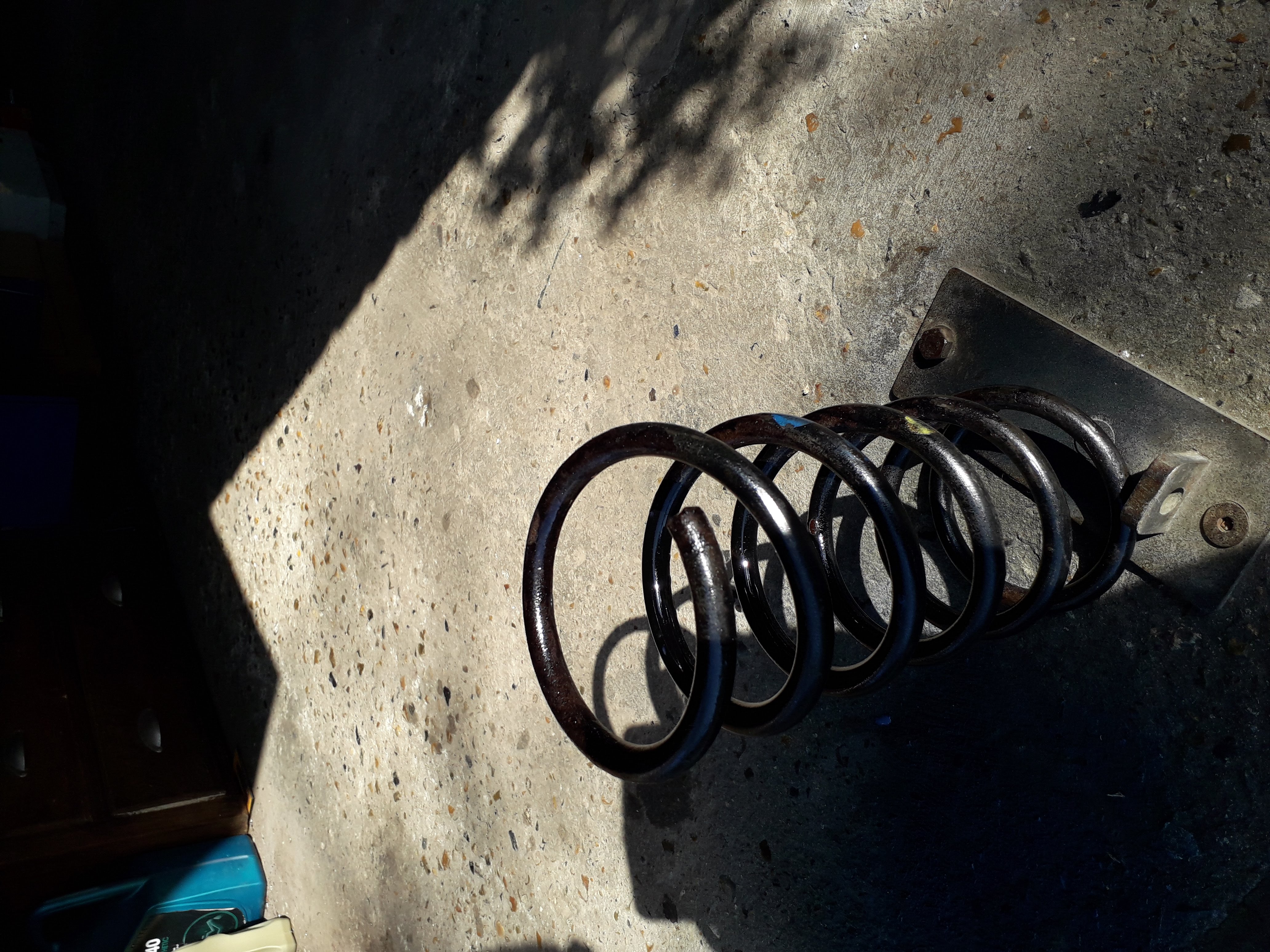

All Becky's springs were pretty "crusty". The front ones I renewed when I did the struts/top mounts/etc last year but the rears are looking rather sorry for themselves.
Although she passed her MOT recently with no advisories, I'm considering fitting new ones when I do the axle. I don't like the way the spring bears directly on the metal of the pan but maybe if i just "swamp" it, after I've used the Dinitrol, with something like waxoyl (got half a tin left over from last time I used it) it'll stop the rust getting going again.

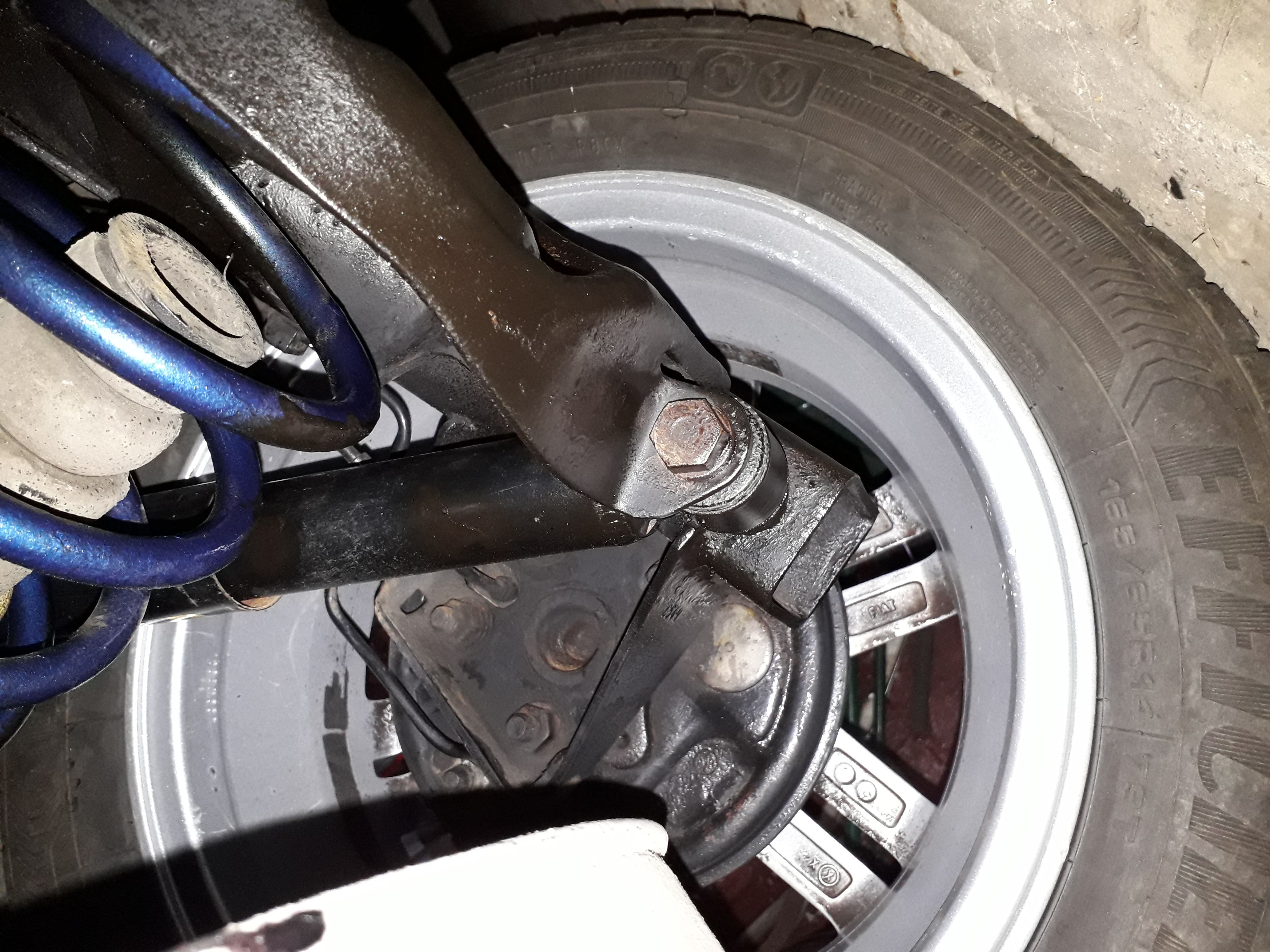

few photos of the results. Looks like I have missed some bits but the weld that fail are all treated. The brown stuff is the underbody wax. The back of the brakes is the rust encapsulater spray as is the spring in black. I Hammerited the springs. Its not the right stuff but they look fine now....

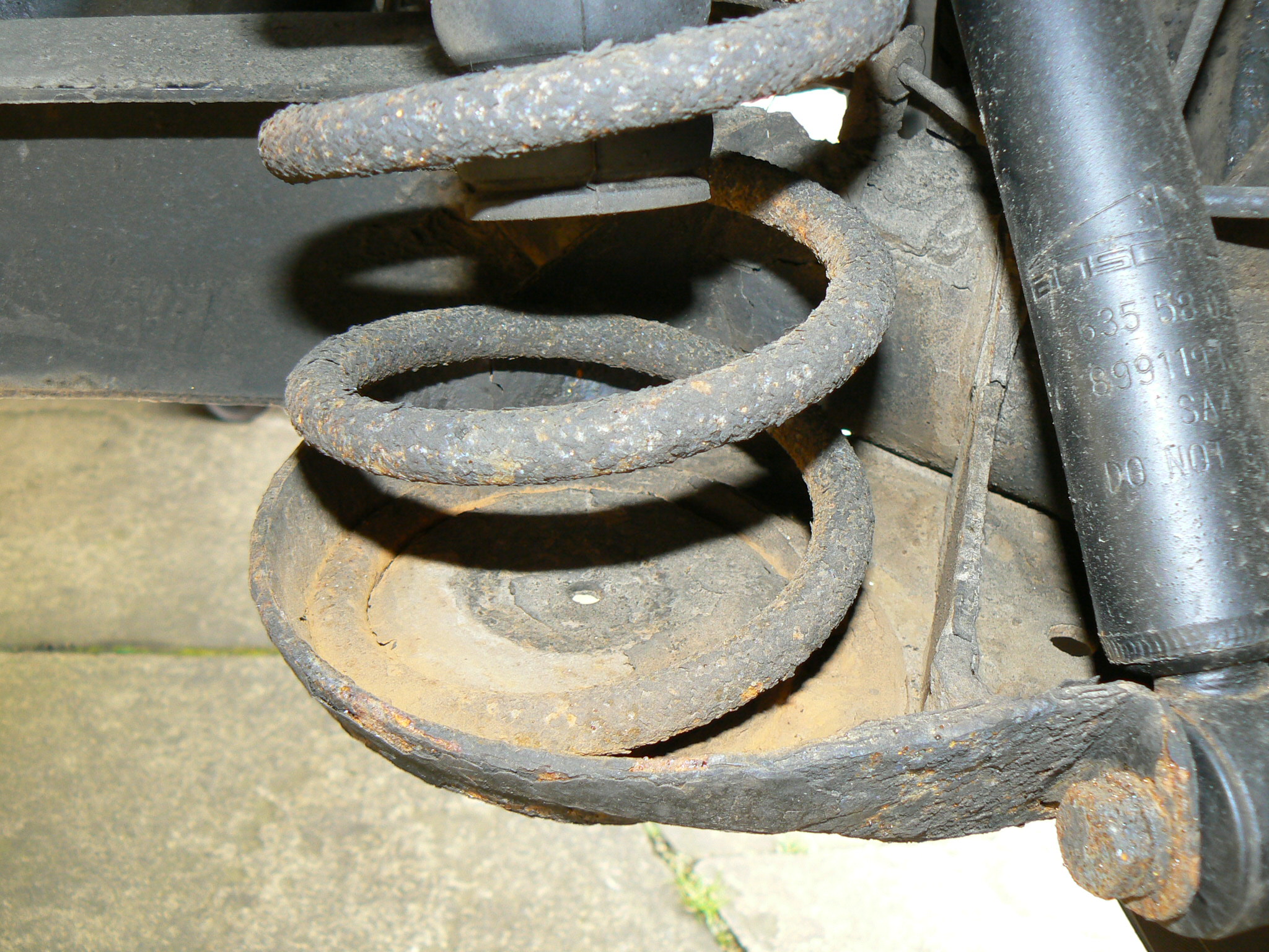

The spring pan failure point is a vertical band about 20mm wide, about 20mm inboard of the weld. I believe it's stress-corrosion that speeds up the decay.
Weld repairs do not need to go all around the spring pan, but do need to start at the swing arm weld and end into the curve. Basically go well past the high stress point so the weld itself does not become a stress raiser that cracks or rusts rapidly.
