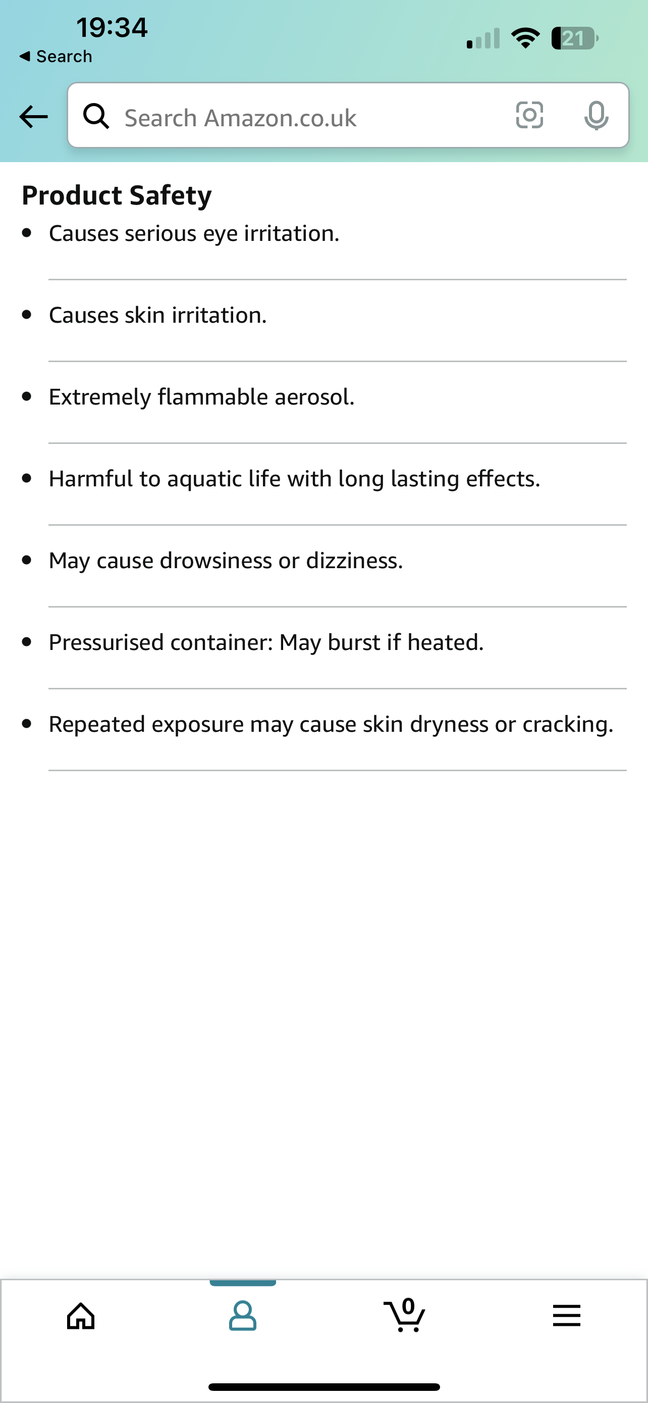

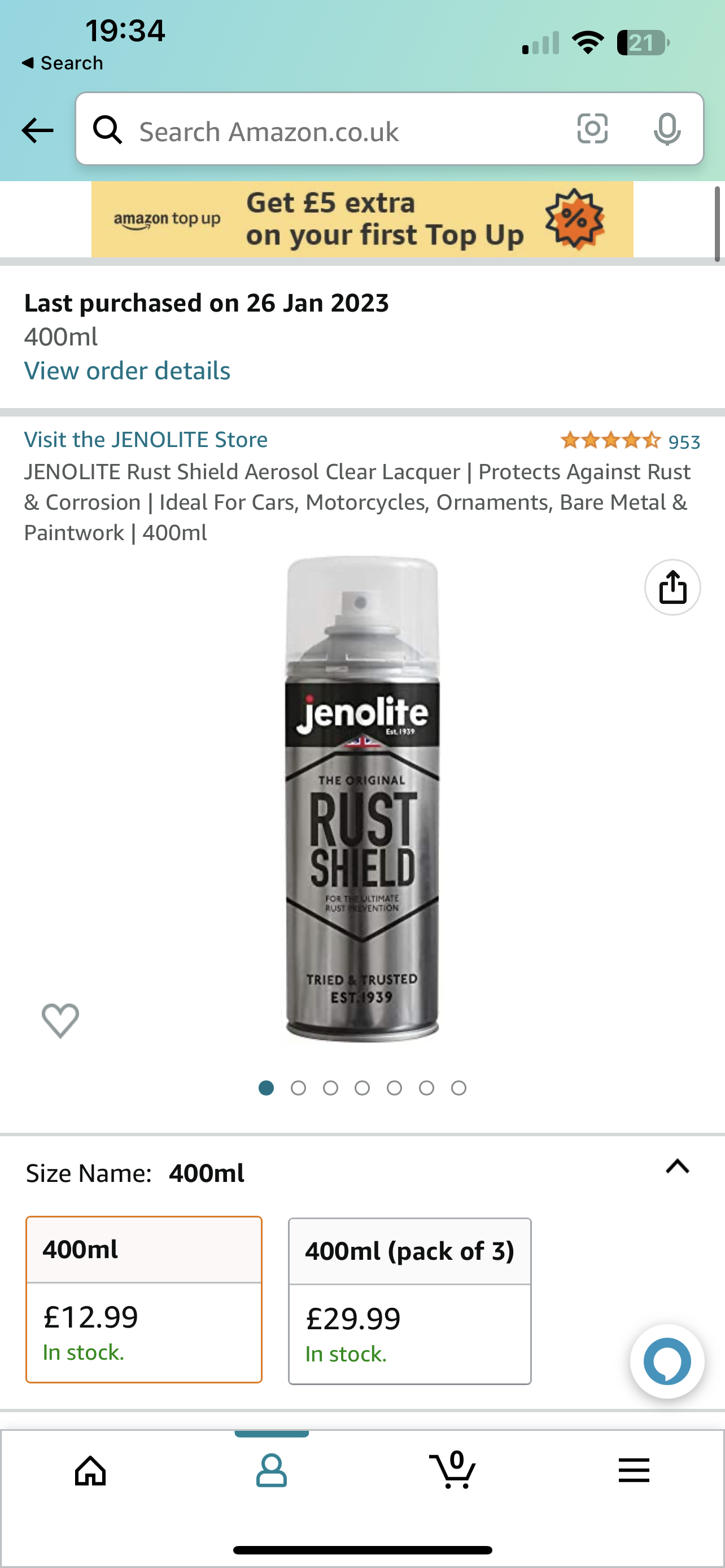

Hi everyone just have a quick question regarding preventing rust and what measures to take. Luckily my panda has no rust on the bodywork / wheel arches. Was looking on Amazon and bought this stuff yesterday. Was wondering if anyone has used this ?
Is it safe to spray under the car and around the wheel arches although it’s showing flammable?

I'm sure there will be different opinions on the 'best' rustproofing treatment as people have personal preferences. I generally prefer Dinitrol products as I find them effective and easy to use but that is just my opinion! I'm sure this Jenolite product will be fine, particularly as you are using it as a protective shield rather than trying to treat serious rust. Many of these aerosol products will carry a warning about being flammable but should be no problem if you avoid treating anything hot or near a naked flame.
Lanoguard seems to be the latest idea. It's sheep's wool wax with a solvent for spraying. If there's any rust under the paint that has to be fully stripped back and exposed. Treatments like this will fully protect the metal. Waxoyl used to be the favourite but I've not been impressed. Over time, dries up and shrinks away from the surface its supposed to be protecting.
