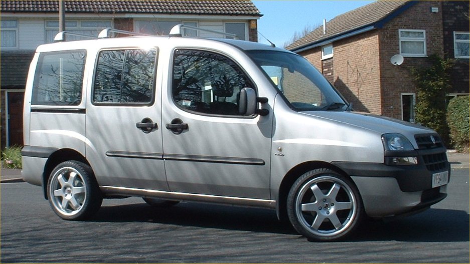

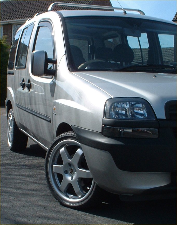

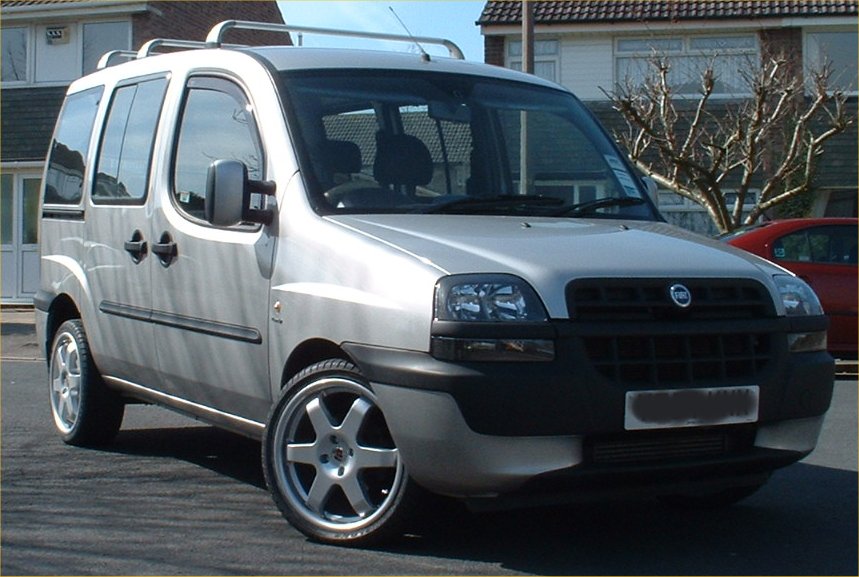

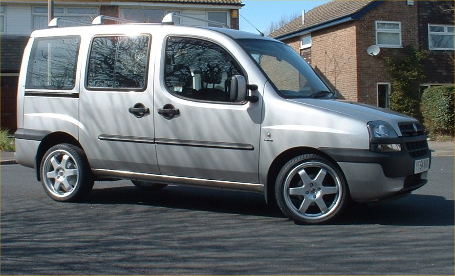

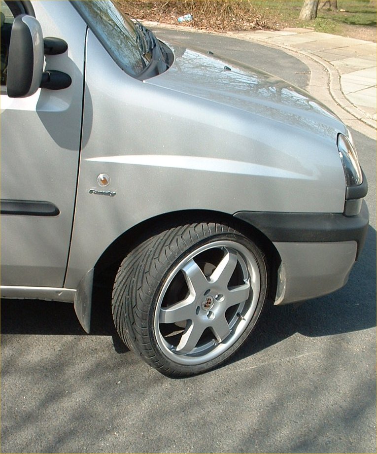

They are now fiitted didn't need spacers.. .. photos "attached" , you also might notice the wind deflectors which i purchased via the web from germany.... just an A bar to be fitted before summer.. then its finished...
tech data : wheel 17 inch, 205/40 17 tyres offset ET35 PCD 98.
As an after thought the tyres could have been 205/50-55's but I'll do that at the next tyre change.
The cost inc locking wheel nuts / chrome valves / delivery = £389.00 Beat that one..

Really nice mate, well impressed! Let us know how you get on with tyre wear and such, but I must say seeing those has made me change my mind about alloys for the doblo, though I'd probably go a size smaller to try and give me some more rubber to play with.
Hope they work well for you and thanks for the pics :)
