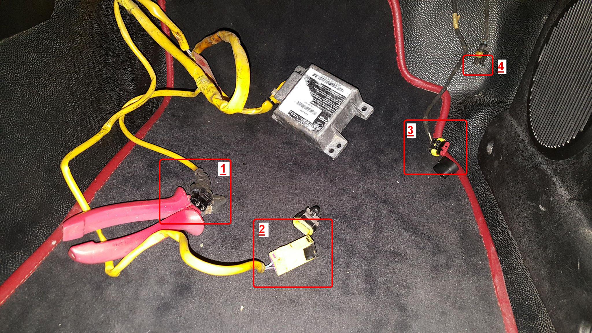

In which port do we have to connect, so that you can interact with the airbag module?
The dealership, connected to number 3, and could not have interaction with the module, they said that either it does not have power or the unit is faulty.
Another garage connected to number 1, but didnt had airbag software, for barchetta. (Are there any other cars, that use the same unit?)
Any ideas?

TSAF:
1 is the airbag module test lead
2 is the seatbelt pretensioner connector
3 is the engine ECU test lead
4 - I never figured what that is, possibly some aircon connector.
The fiat 3-pin connector is not self powering so you need to take power from the battery, or most easily from the cigarette lighter.
So what you need is these: a fiat 3-pin to obd2 adapter, a VAG/KKL type OBD2 cable (with or without the switch) and a cigarette lighter cable with crocodile clips or similar to get the 12V and GND from the battery.
You need the cable with the switch if you have a barchetta with the universal OBD2 connector. In your case (pre-2001 car) you have separate connectors for each module, so always keep the switch in "engine" position if you have the switch.
Plug the cigarette lighter adapter, connect the crocodile clips to the clips in the 3-pin adapters (be careful not to short the 12V to frame, use tape for protection for example). Connect 3-pin to module and KKL cable between adapter and laptop.

The hard top window heater connection is over the other side behind the drivers seat. So item 4 I don't know, but possibly is the Aircon connection as suggested.
Item 2 is the plug for the passenger airbag, that's fitted in place of the glove box in the dash. Connected to that plug is the resistor fitted when no airbag is in place.
Isn't #4 the plain-and-simple 12V for hardtop window heater? I don't have aircon, but #4 is still there.
No, the number 2 plug has the resistor, if you have the glove box.The spare wire (No2) will have the resistor. Mine was fastened to the heater box with a clip. Number 4 plug has nothing connected.
Dave M. When you say “resistor is fitted when airbag is not in place “ do you mean plugged into number 4, because mine has nothing plugged in and the airbag light is always on?:confused:
