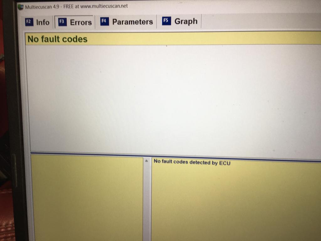

Success!! :)
All faults cleared and warning lights extinguished.
I'll set out the process that worked for me-
Turn ignition off and key out - wait 15mins
Disconnect battery and turn on headlights!
Wait an hour
Disconnect airbags
(at this point I also removed the seats to determine if I have pretensioners - I do!)
Check and Clean all connectors
Spray them with contact cleaner
Re-connect - ensure they are all fully home.
My car has a passenger airbag so at this point I turned it off.
Connect the 3 pin lead to ecu and to the laptop
Turn ignition on
Open MES
Click on Connect
Then Clear errors - at this point my errors all cleared.
Disconnect lead to ecu
Start engine to confirm.
Turn engine off and remove keys
Turn passenger airbag back on
Start engine to confirm again
Thank you to s130 and everyone else who helped me :)
