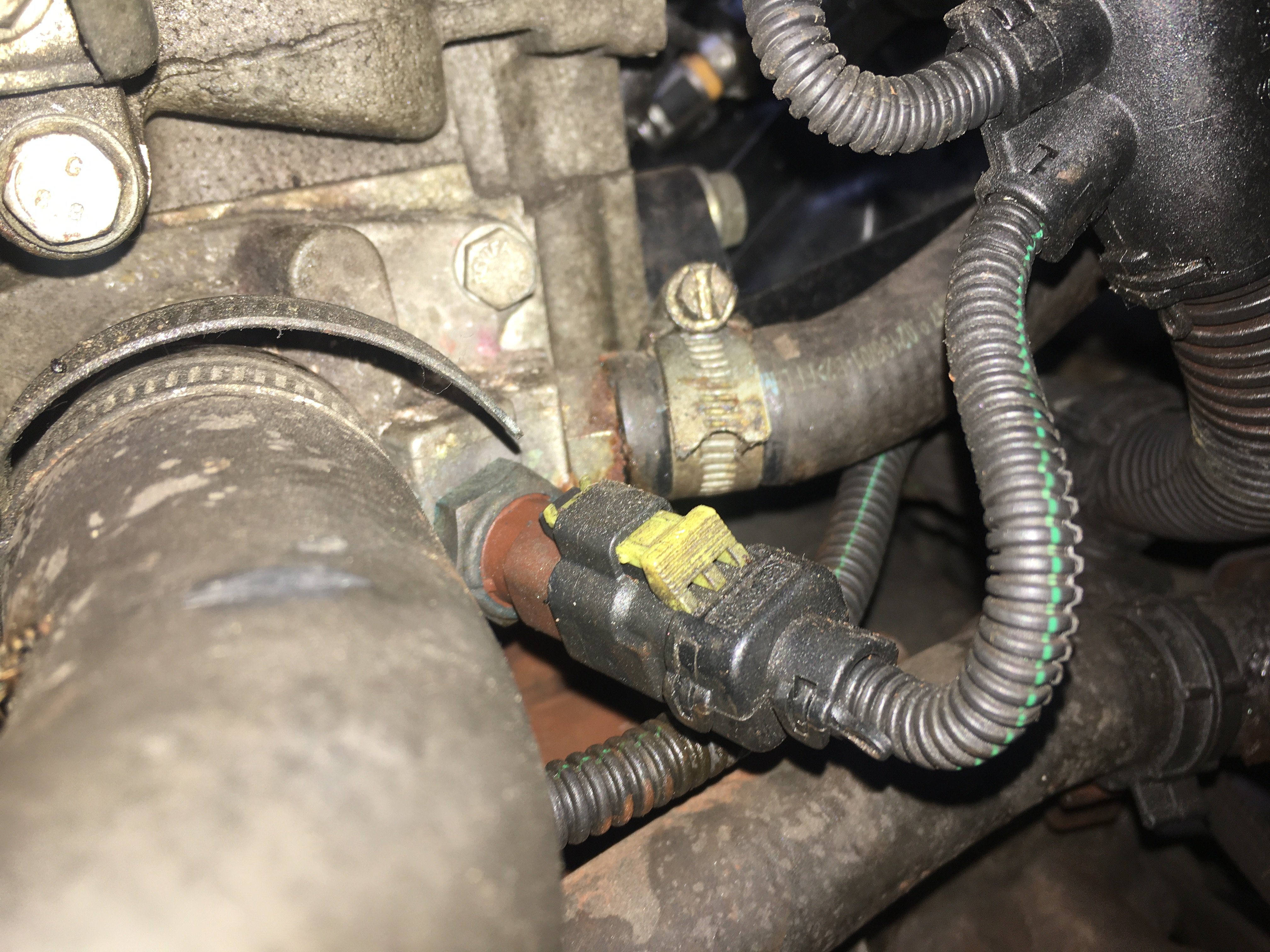

Doesn’t your eco have a combo thermostat and temperature sensor on the right of the the cylinder head like my 2010 eco
This is mine not as obvious as this as take with a flash but you can see the electrical connector for the sensor on the thermostat housing

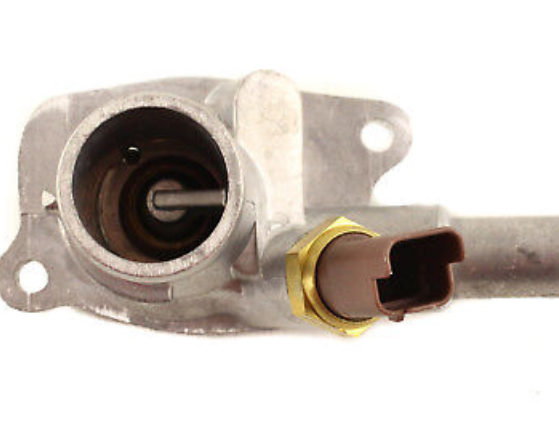

Here what my part looks like on eBay
Photo somehow at the bottom

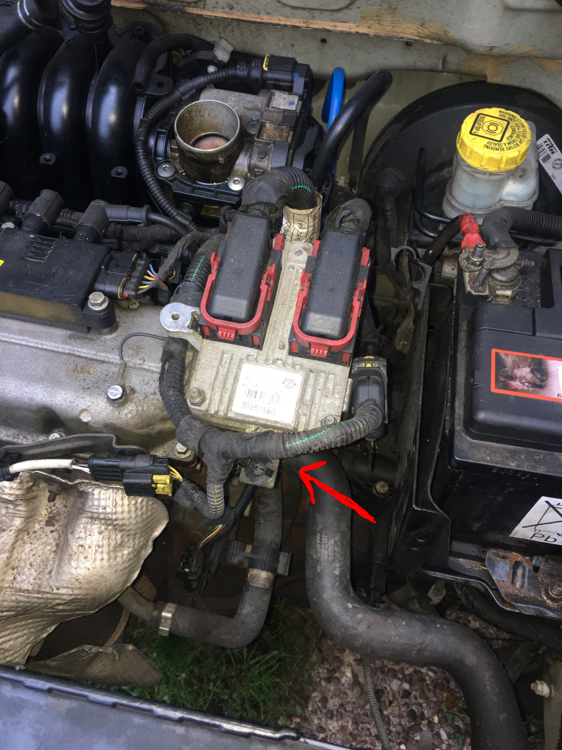

It’s hidden under here
Just grab this like this
I don't believe so.

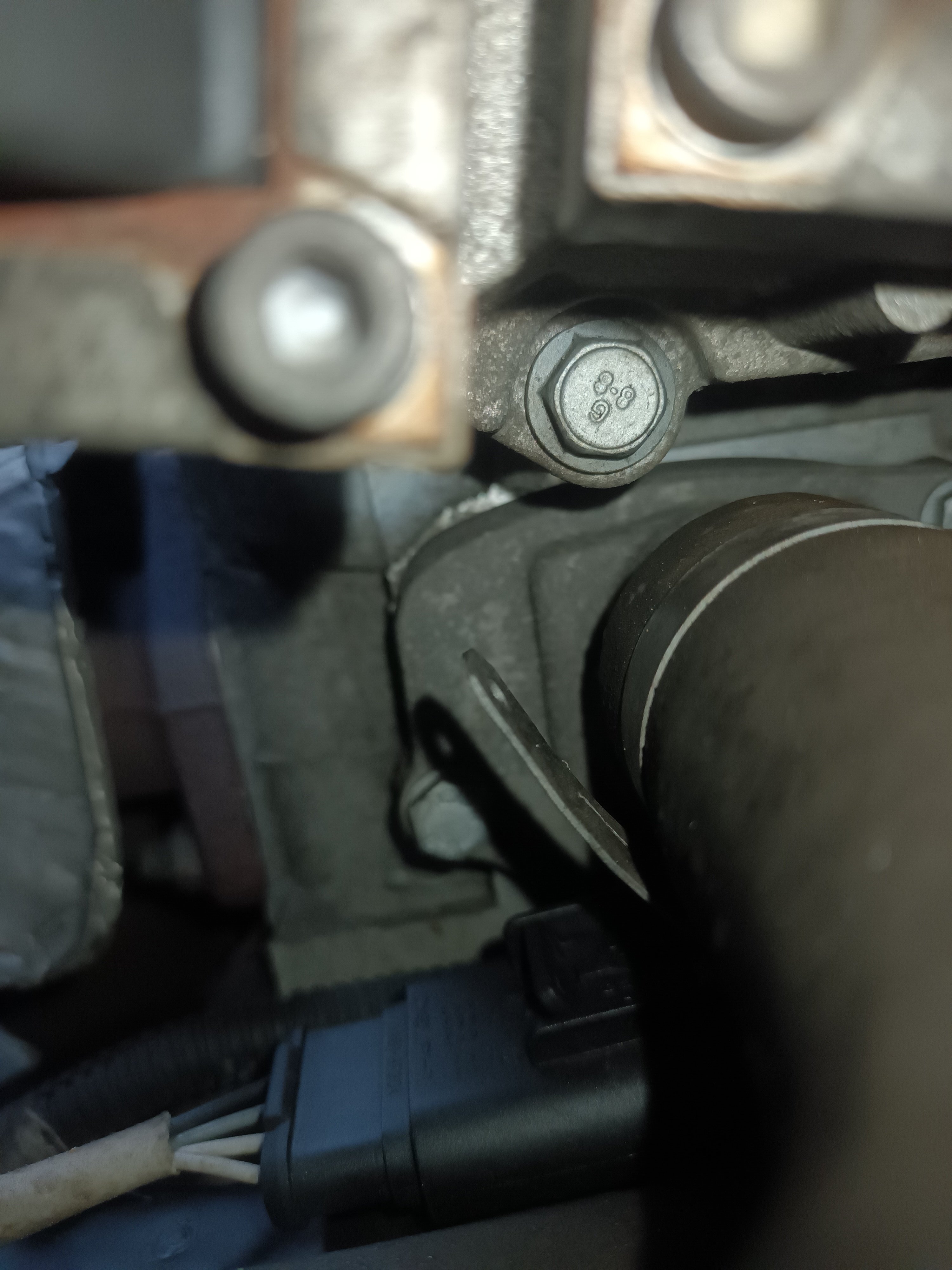

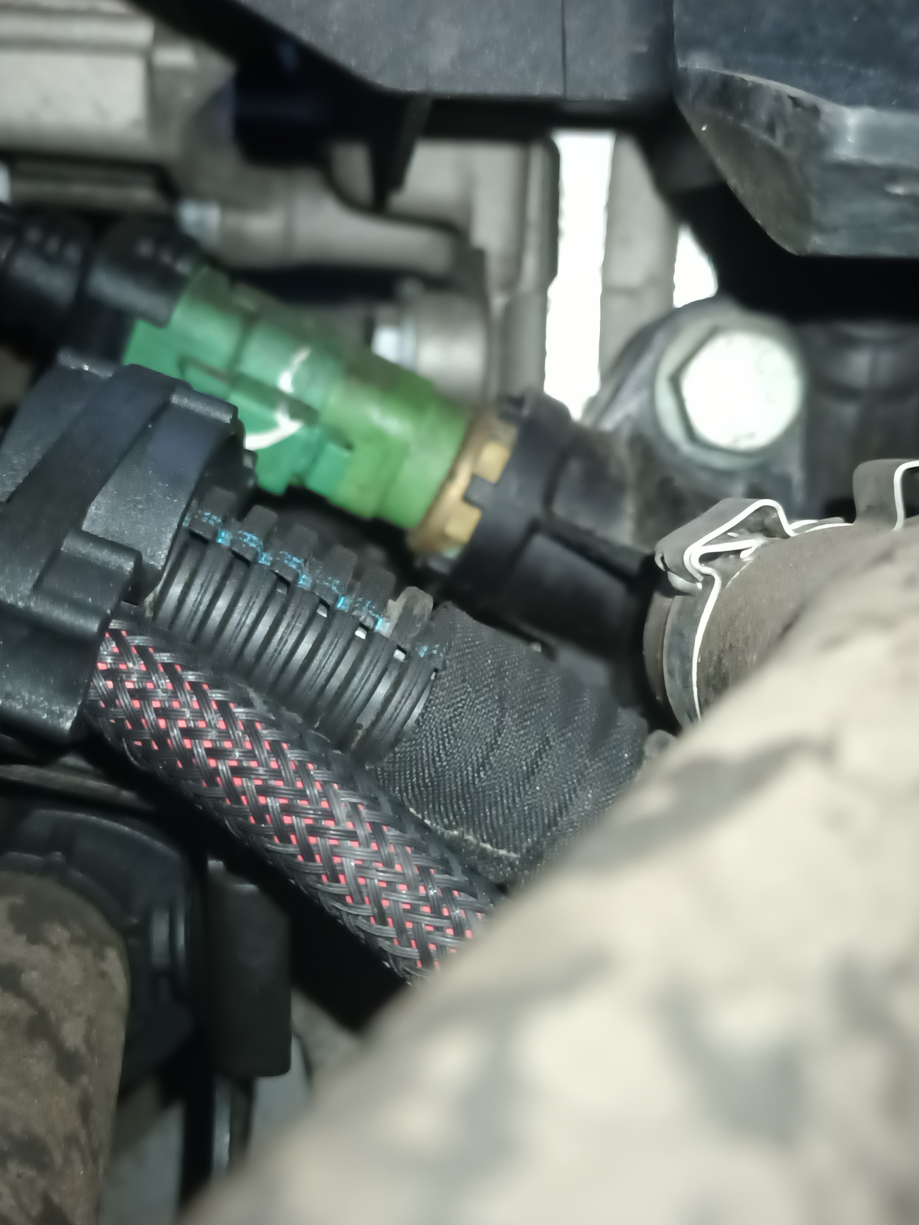

Here's a couple of photos, I can't get in properly...
My thermostat I presume...
My heat sensor I presume?
