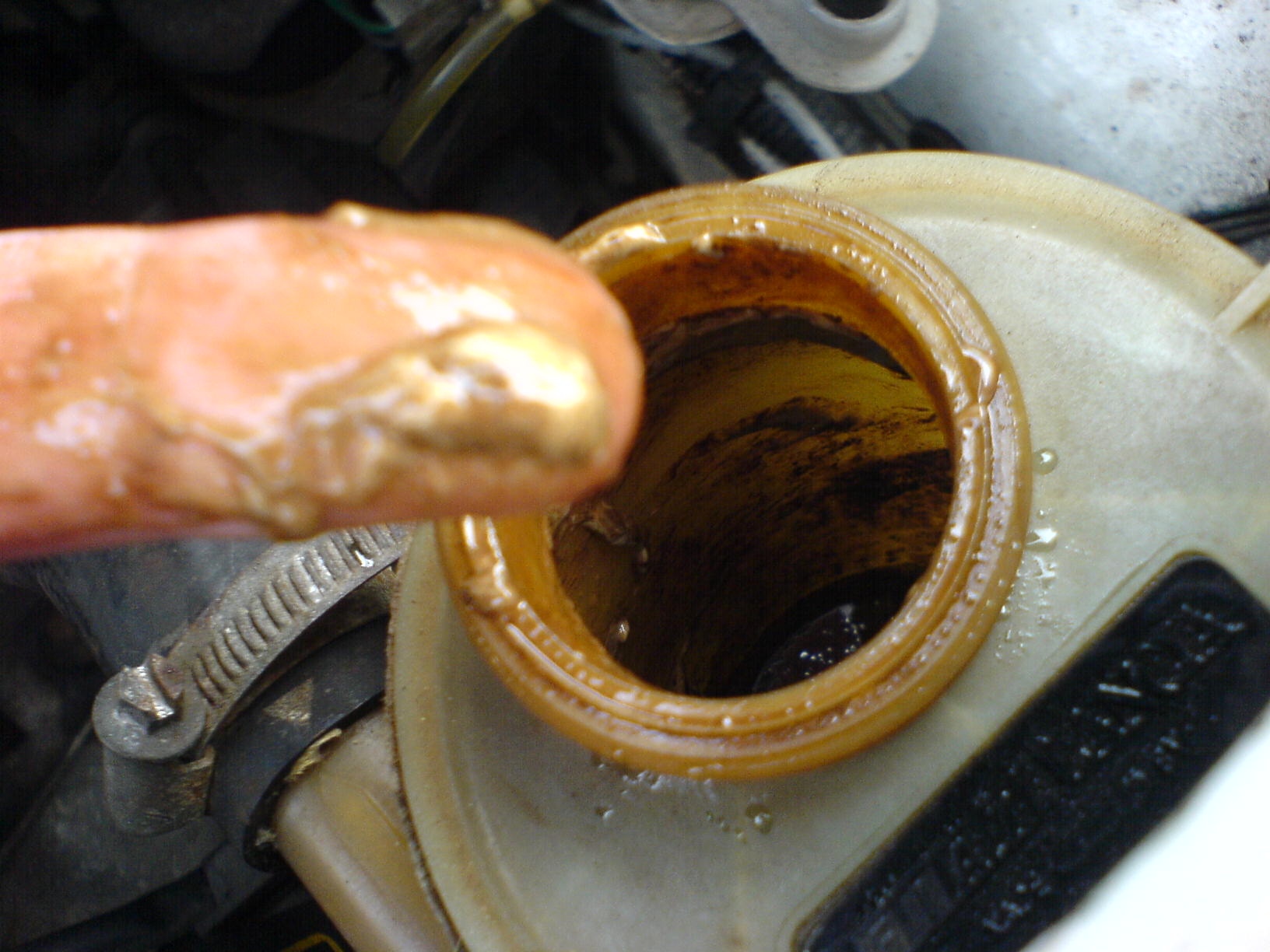

Usually overheating with pandas is a sign of a busted head gasket.
Is it using water/oil?
Does the container that holds the coolant look like this?
or do you have brown mucky mayo round the filler cap?
