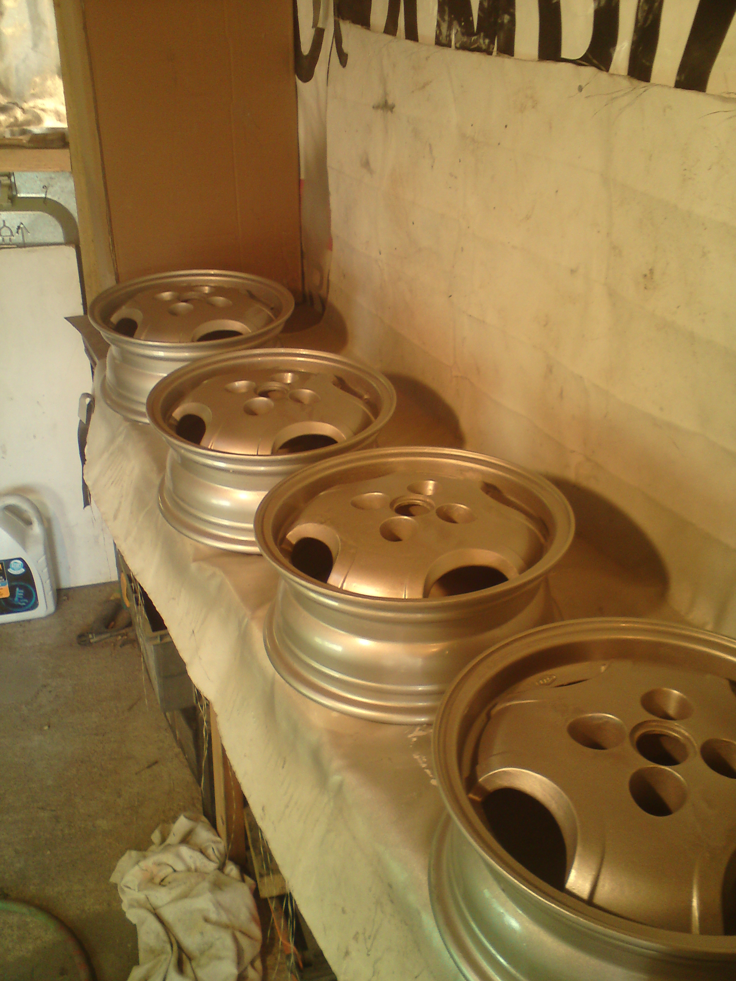

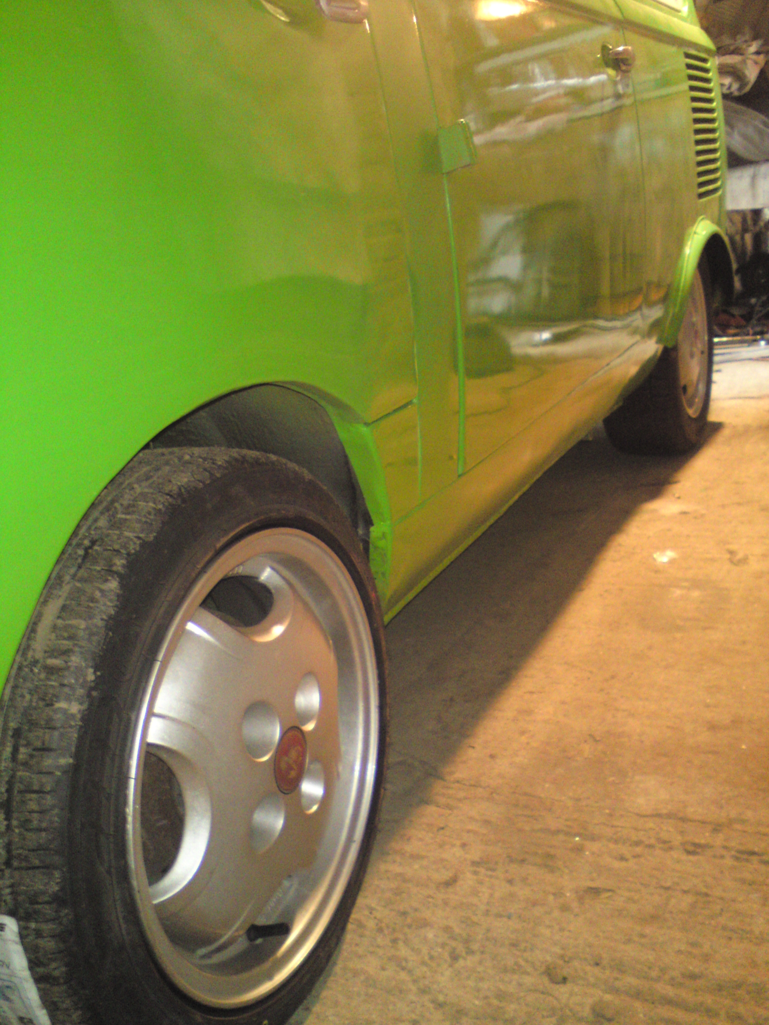

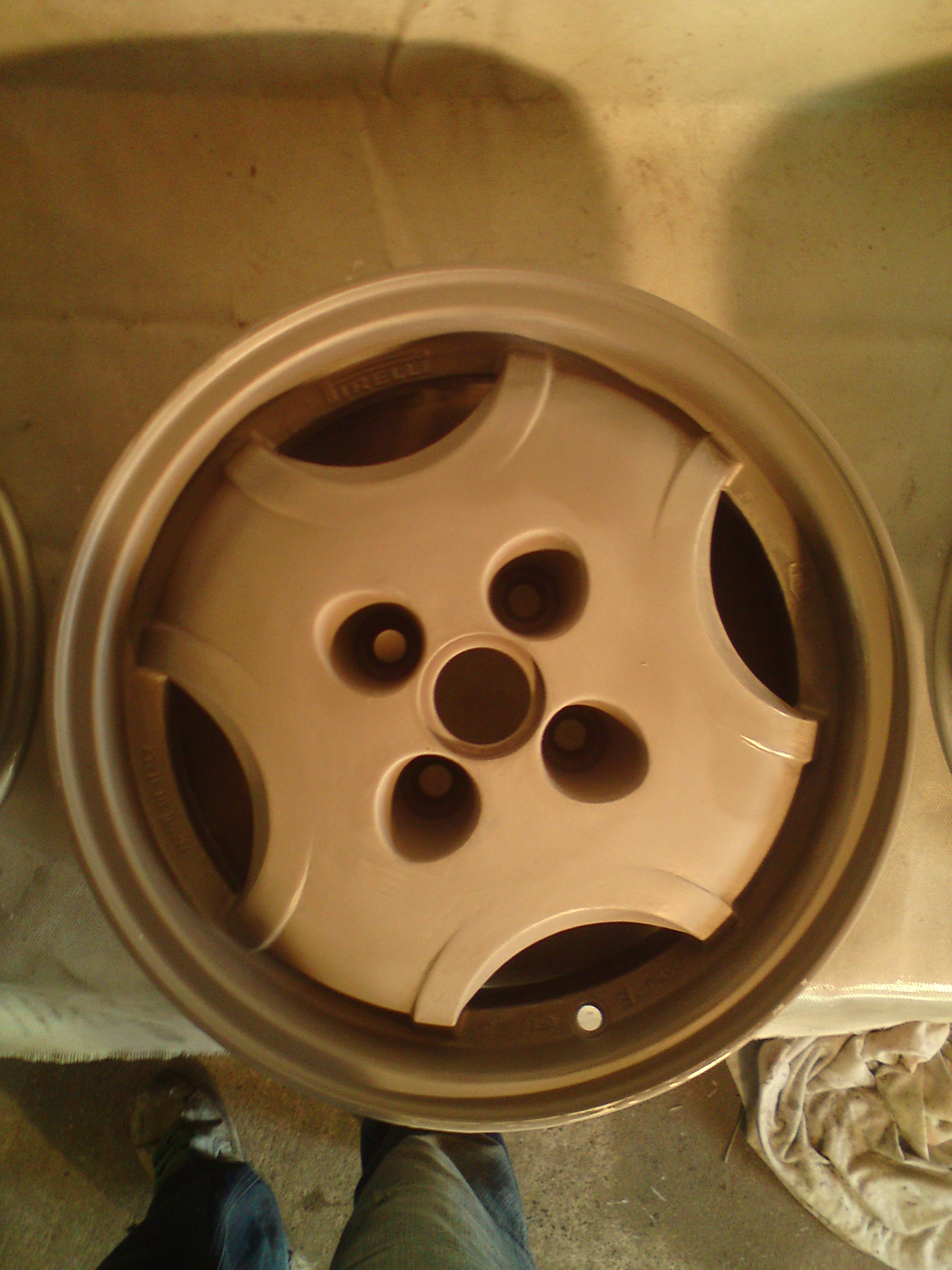

Prepped and sprayed my Strada wheels, then fitted 155/55/14 on the fronts and 185/65/14 on the rears.

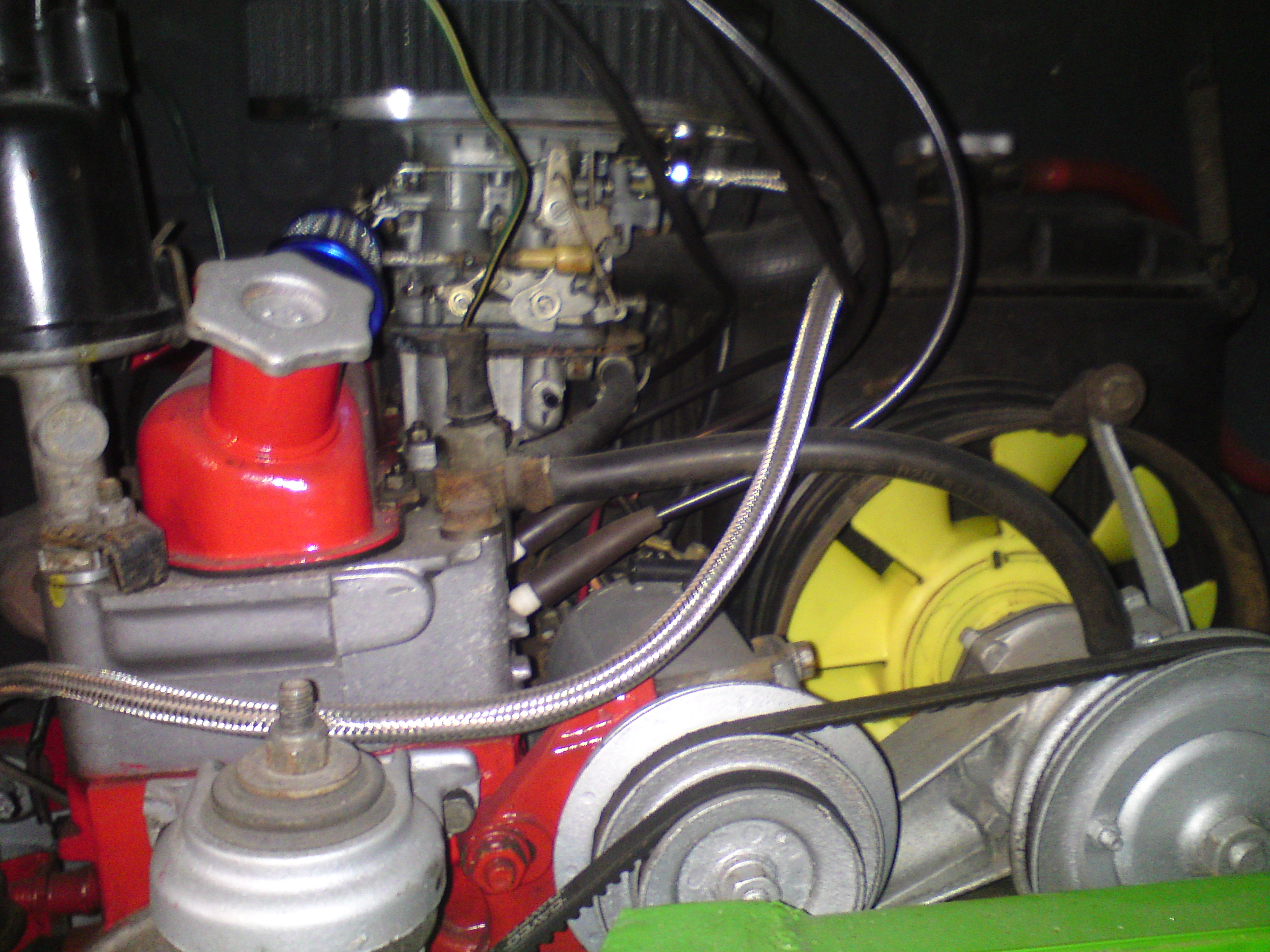

Found an old K&N air filter that I have had in the garage I just welded an adaptor plate so it would fit then made a gasket for it.

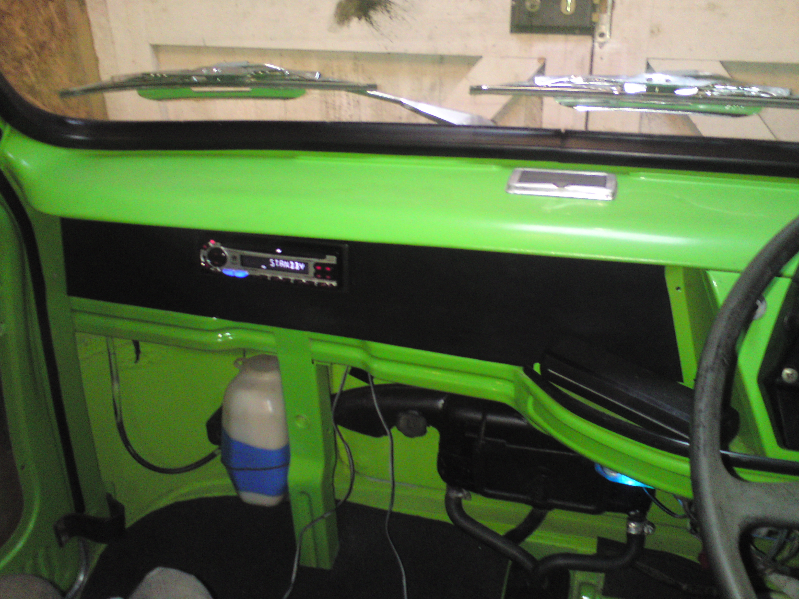

Dashboard made from mdf and covered in vinyl ( doing the doorcard this week )

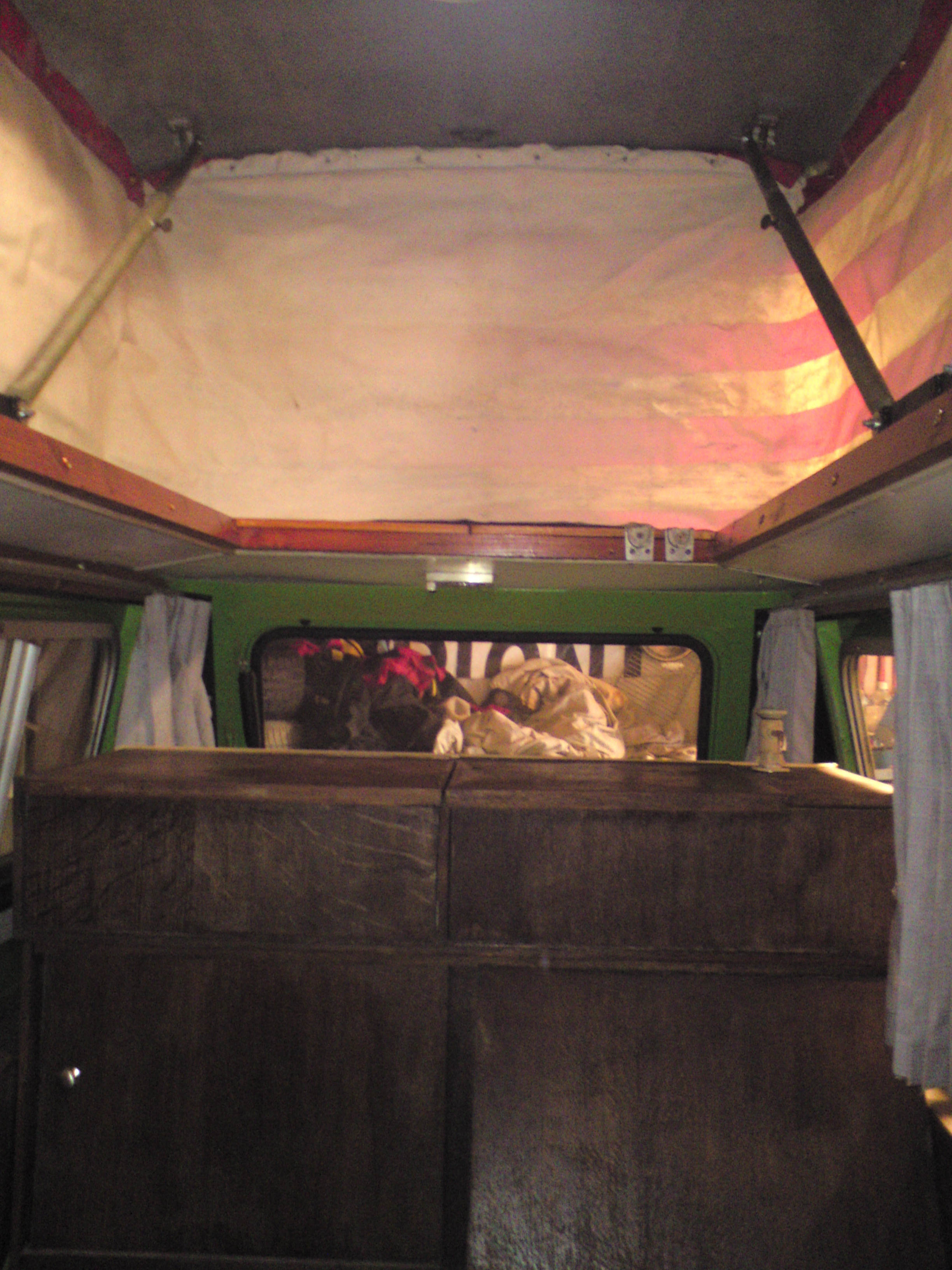

Got my boy to help out by painting the wood I got for finishing the roof aperture, along with re-fitting the restored interior.

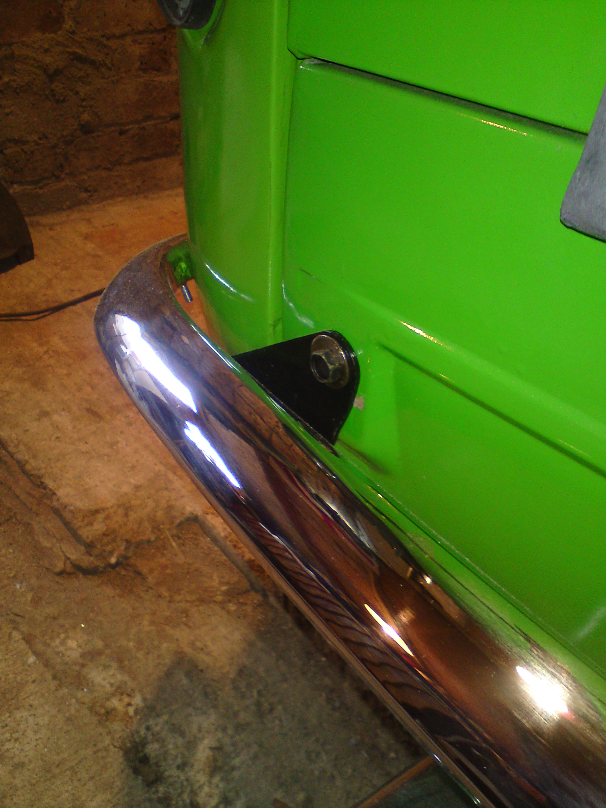

Bullet mirrors and new side repeaters, then the bumpers that are from a mini ( £35 delivered ) because I don't want to pay £200 plus to get originals from Italy!

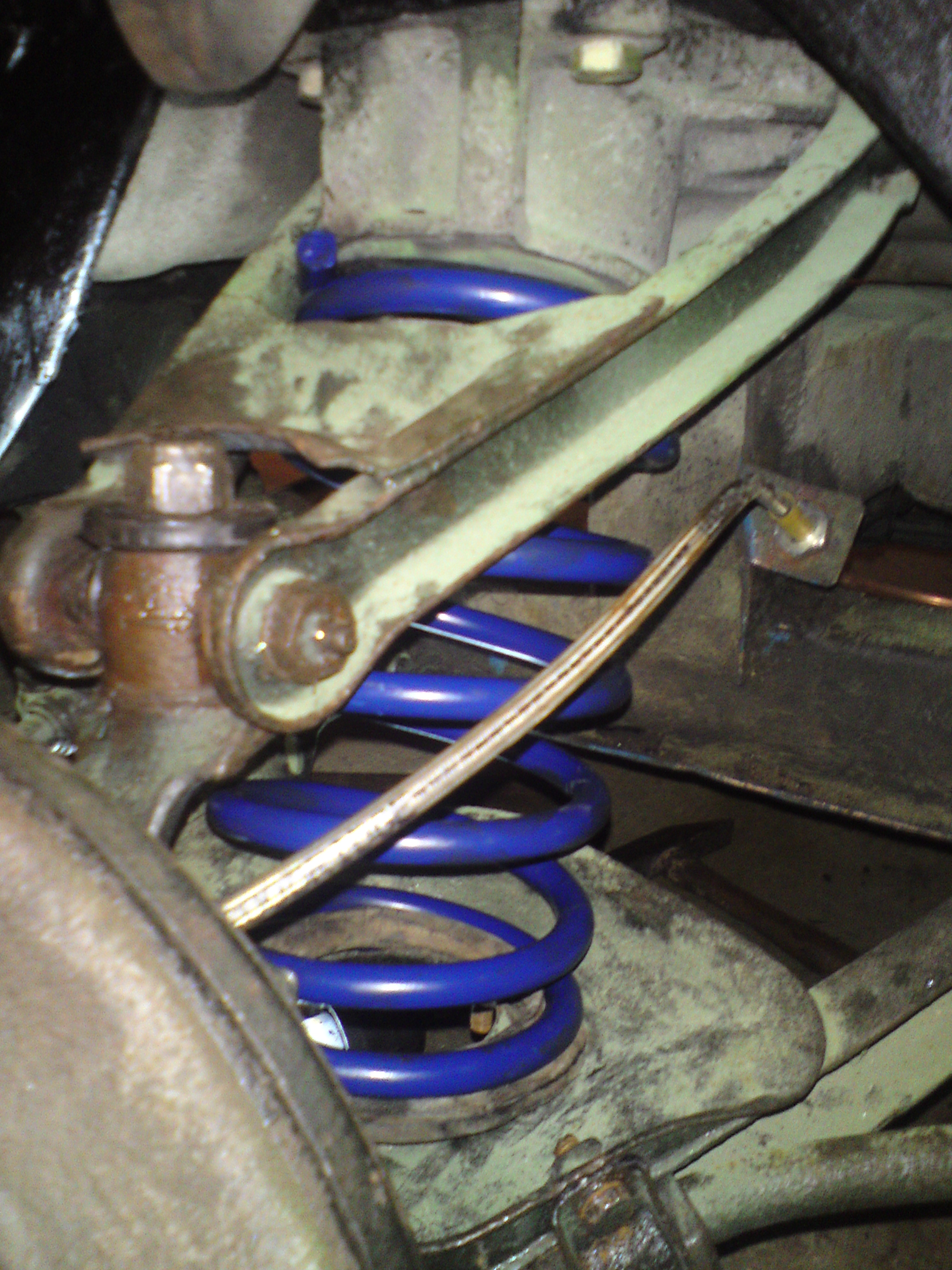

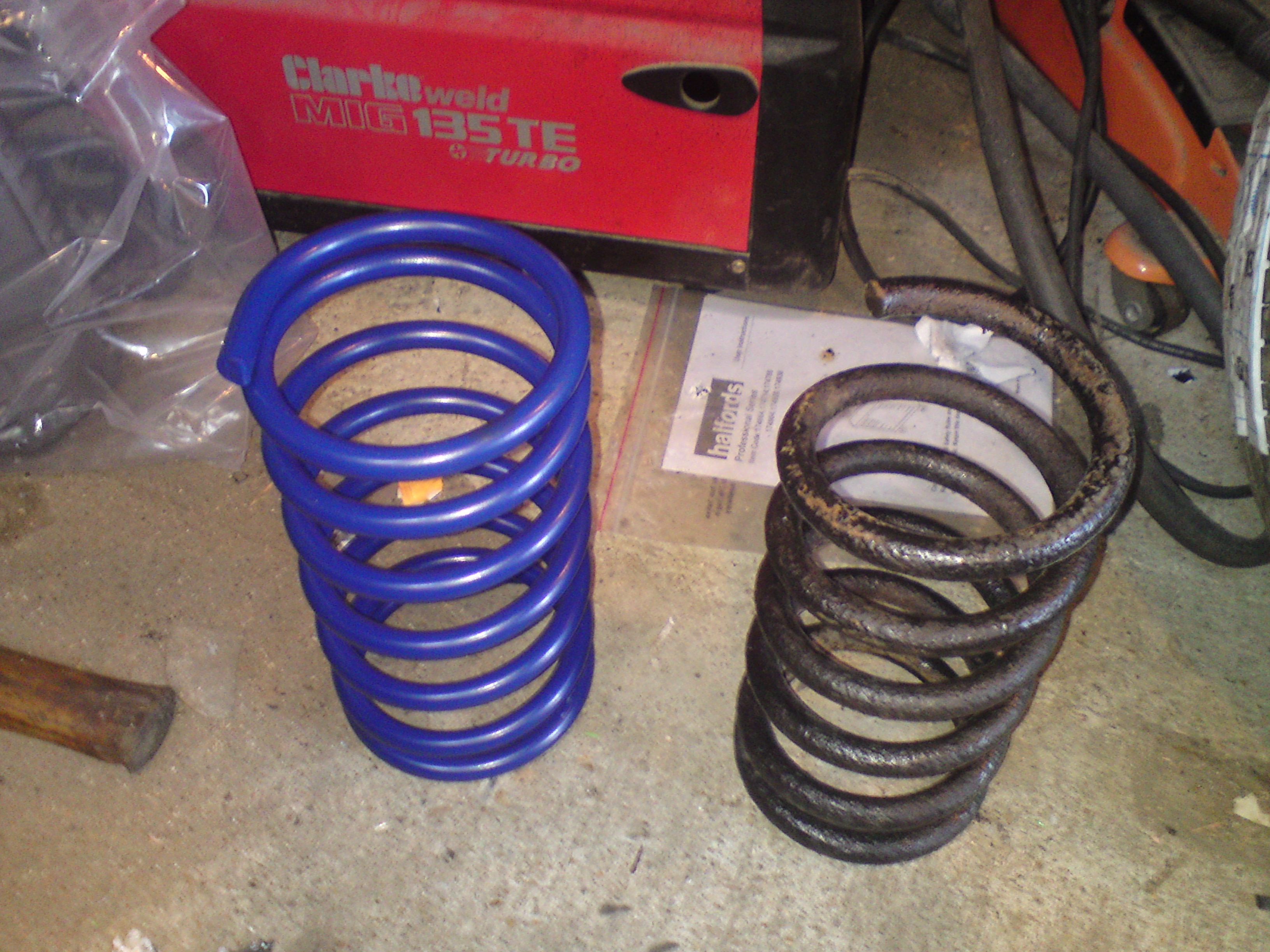

First thing that I have done is a full rebuild of the front trunnions i bought a rebuild kit off Italian ebay for a fraction of the price I was quoted from ricambio so was happy with that. also I cant remember if I showed it in the thread but I rather foolishly decided to cut the springs to lower the van and after I did that they didn't sit very well (first and last time I will ever cut springs!!) so after some detective work I found some new lowered springs off a MK2 escort!
