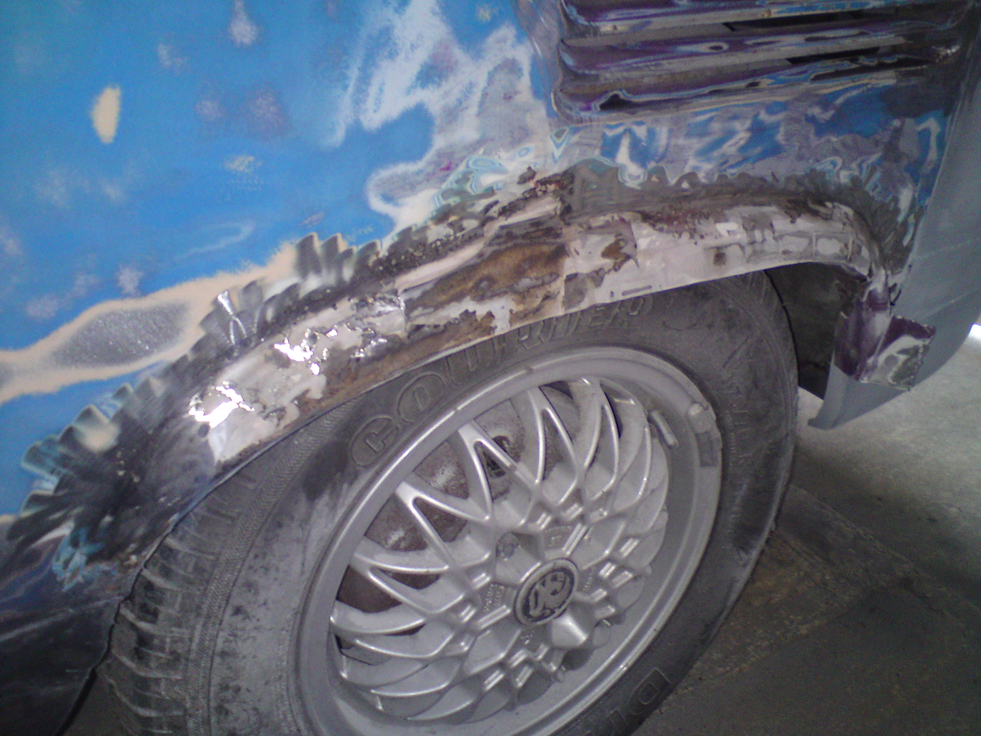

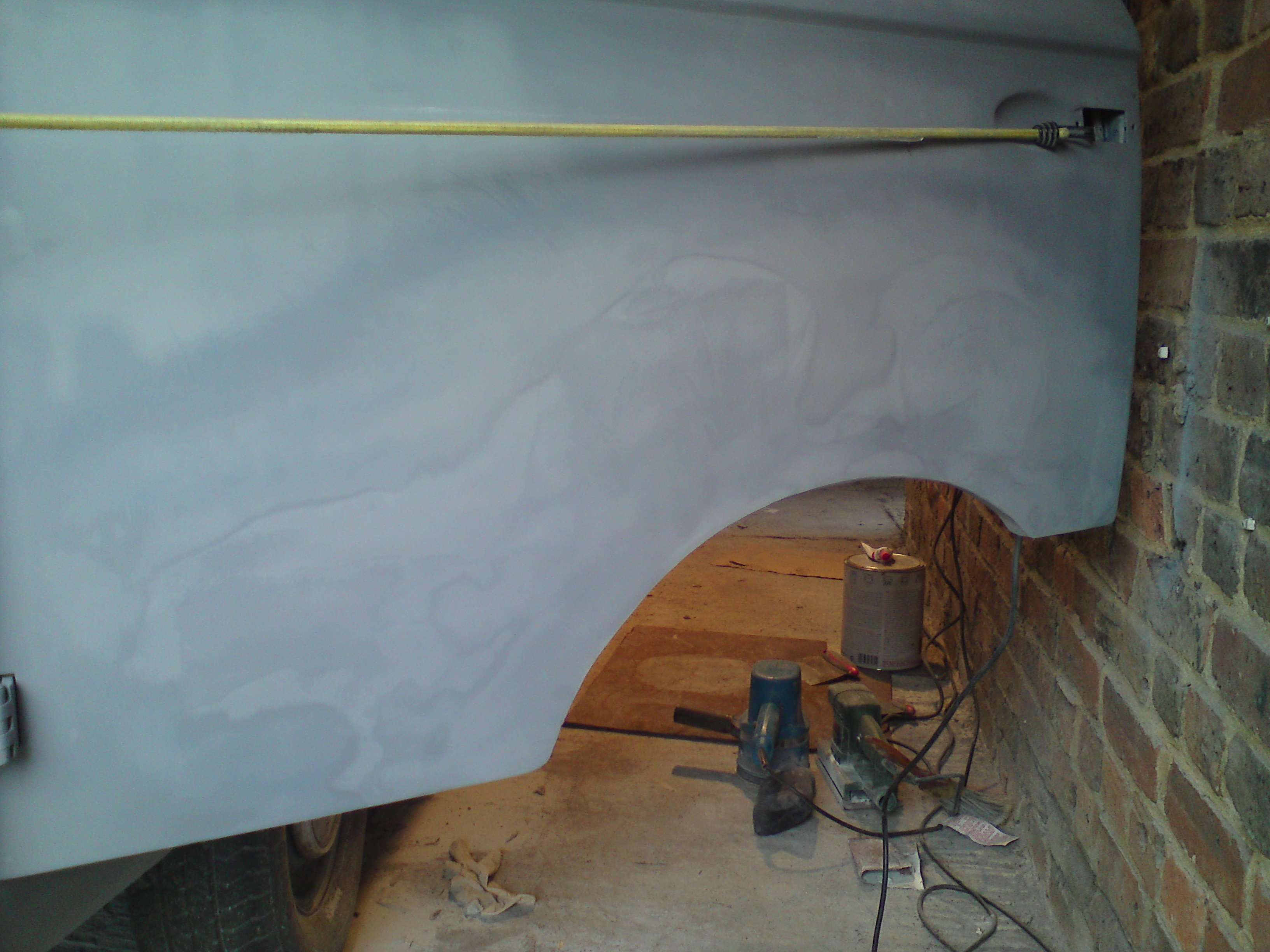

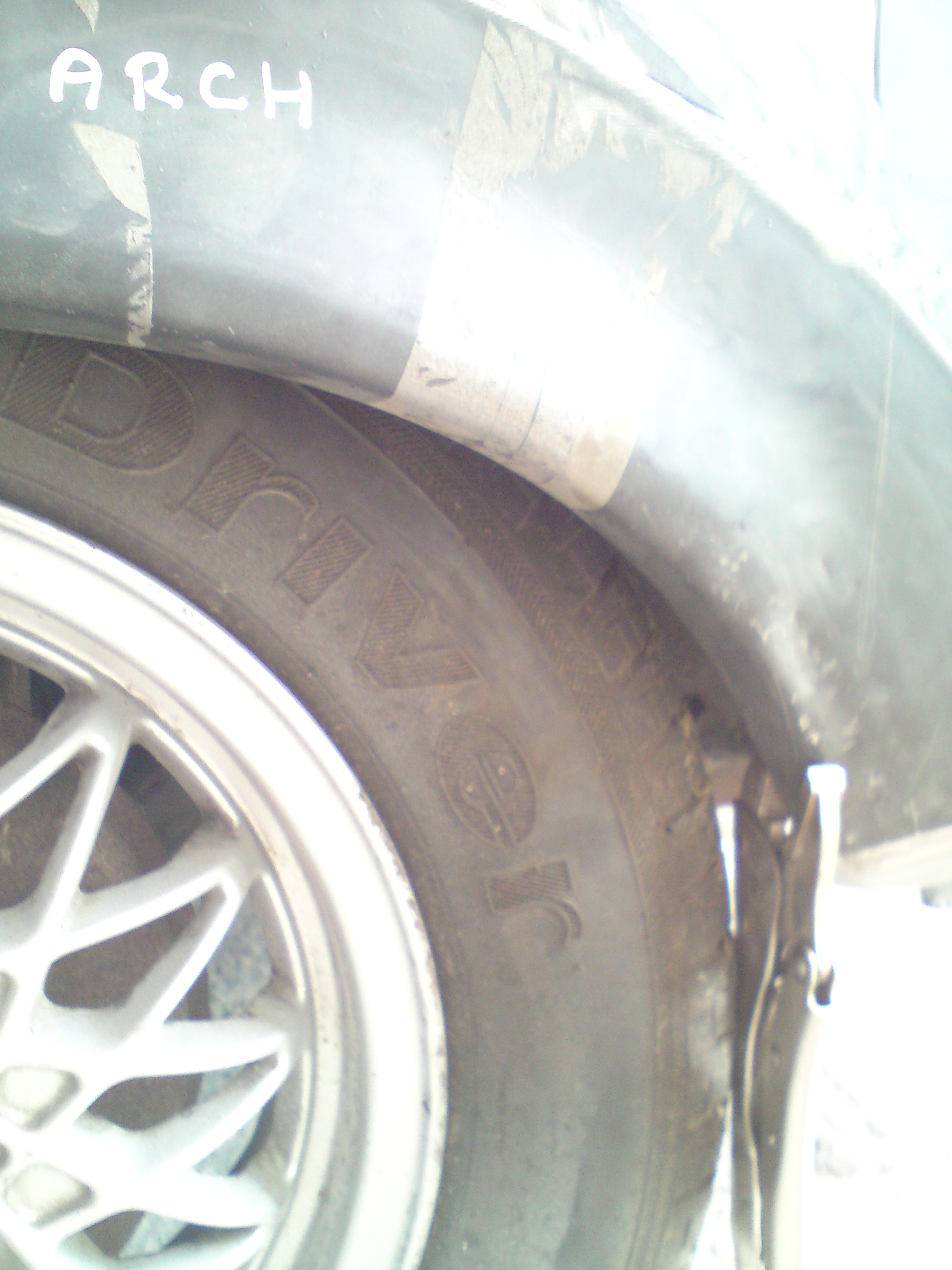

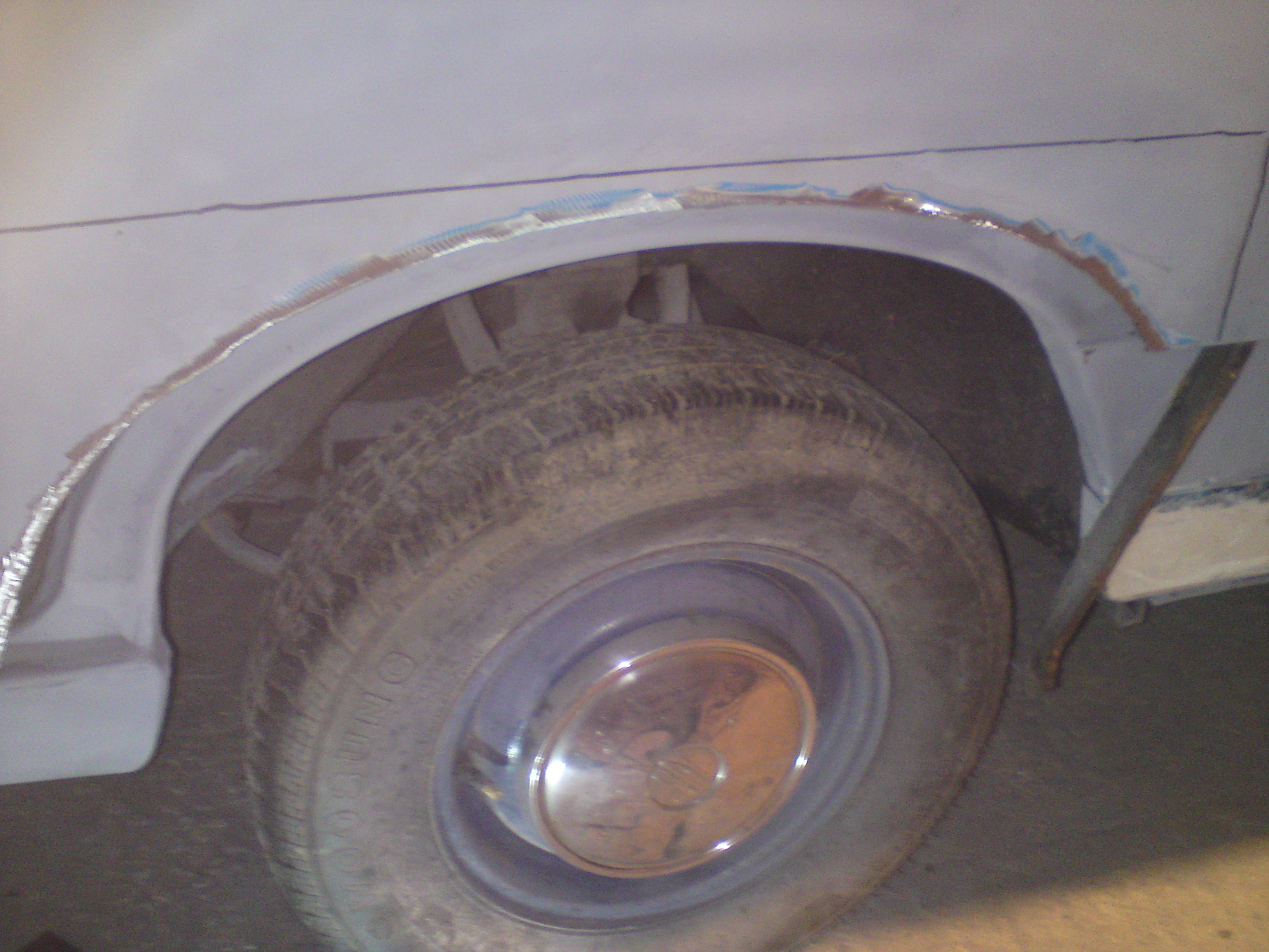

Well after much searching for rear arches i found what i thought would be a good match for profile and size as the orginals. Was not a perfect match, but more than happy with the end result(y).

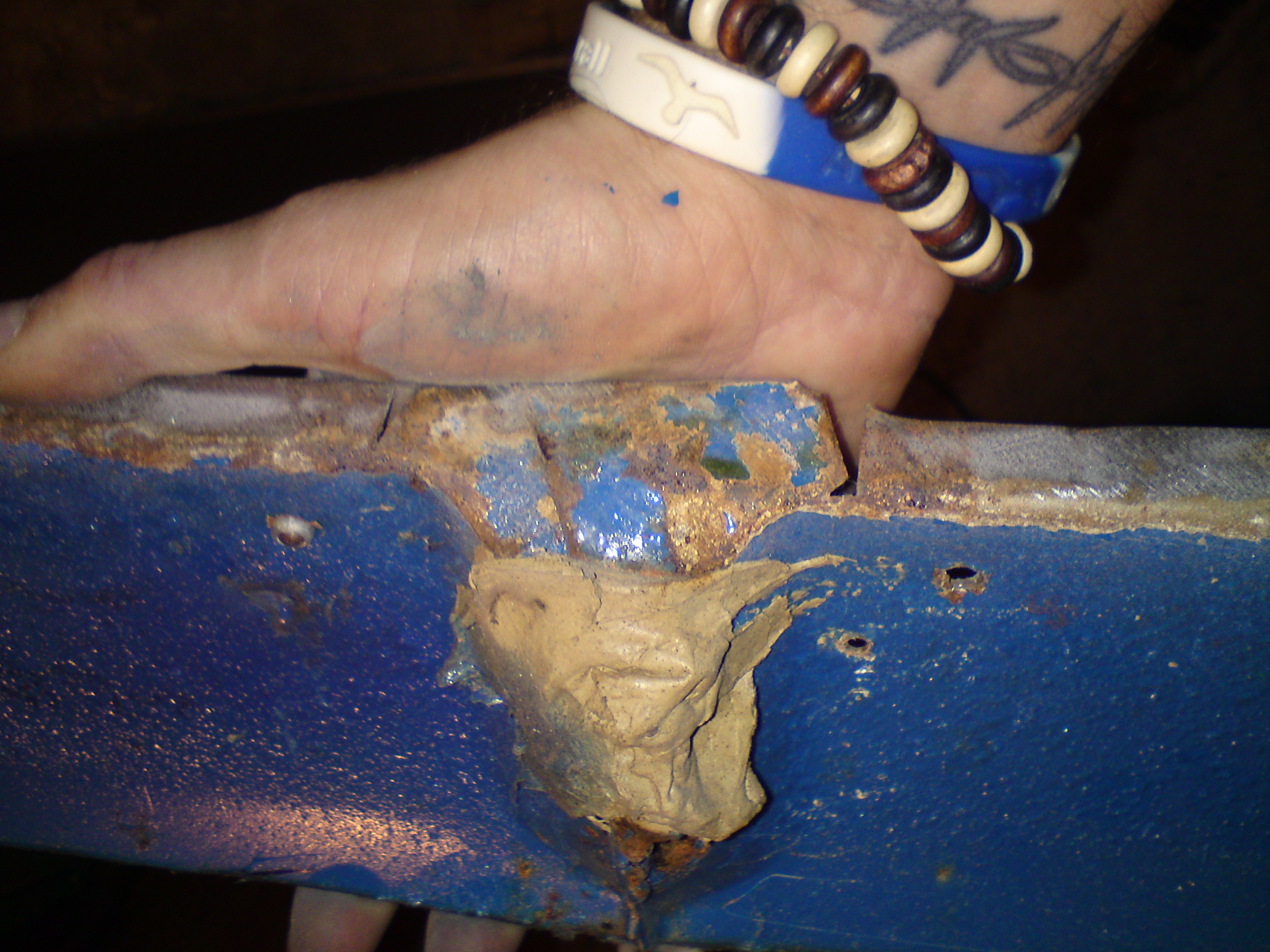

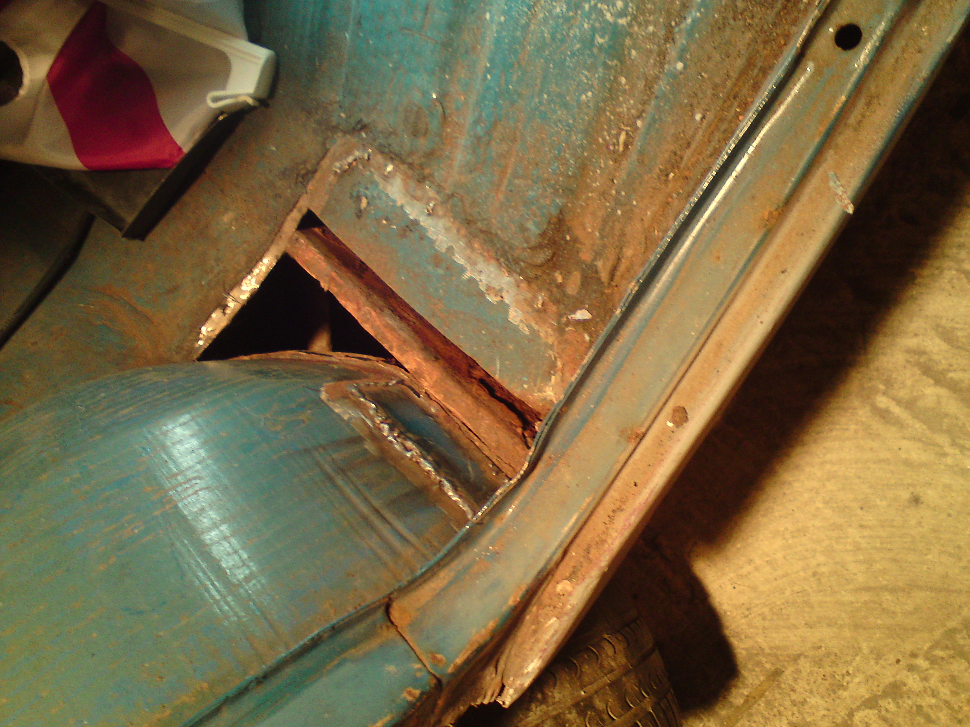

I also had a go at sorting out the very rusty area above the side door, looks like lots of water had got into this area and the rust had really taken hold, still need to grind down the welds and have a general tidy up but its no longer rusty!

And yes the rear arches are from a MK2 FORD CAPRI!!!! LOL.

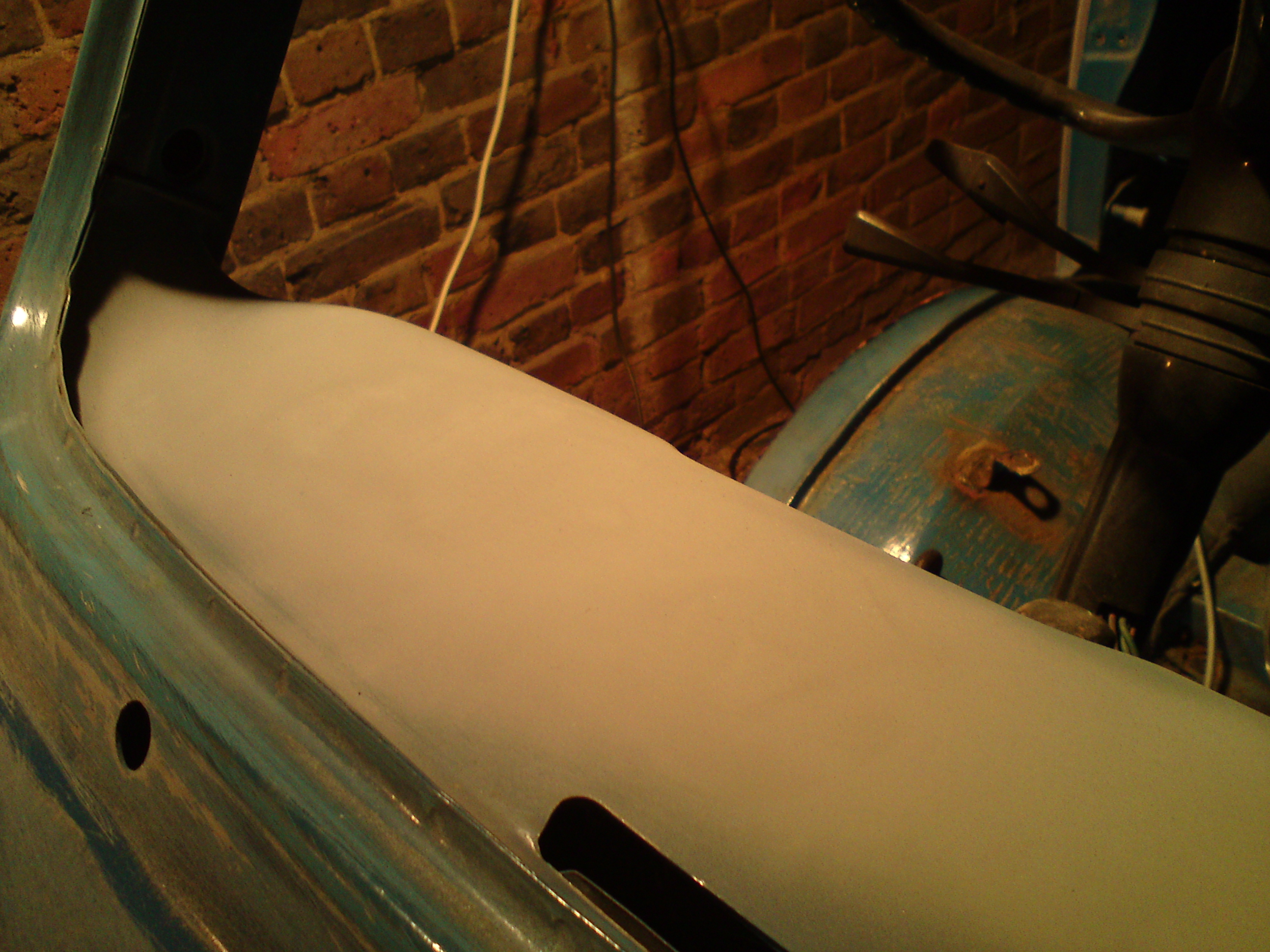

Now the van is completely stripped i have been seriously been thinking of changing the colour, i know it would involve alot more work but im tempted, to help make my mind up i decided to spray the front of the van to see if i like the blue...
The more i look at the blue and the fact that i want it to look as standard as possible (not counting lowering and a nice set of 13's) the more i like it! What do YOU think?

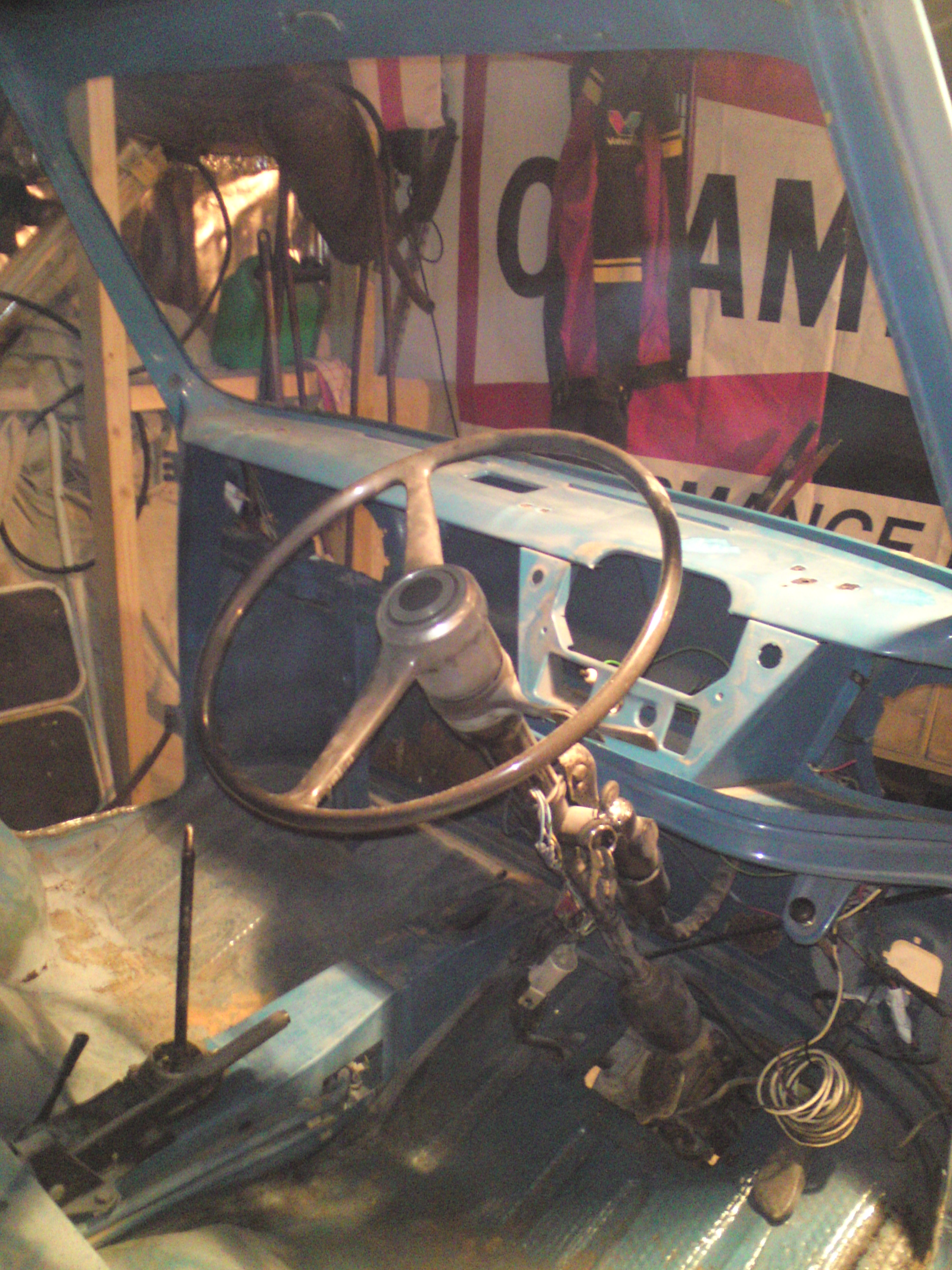

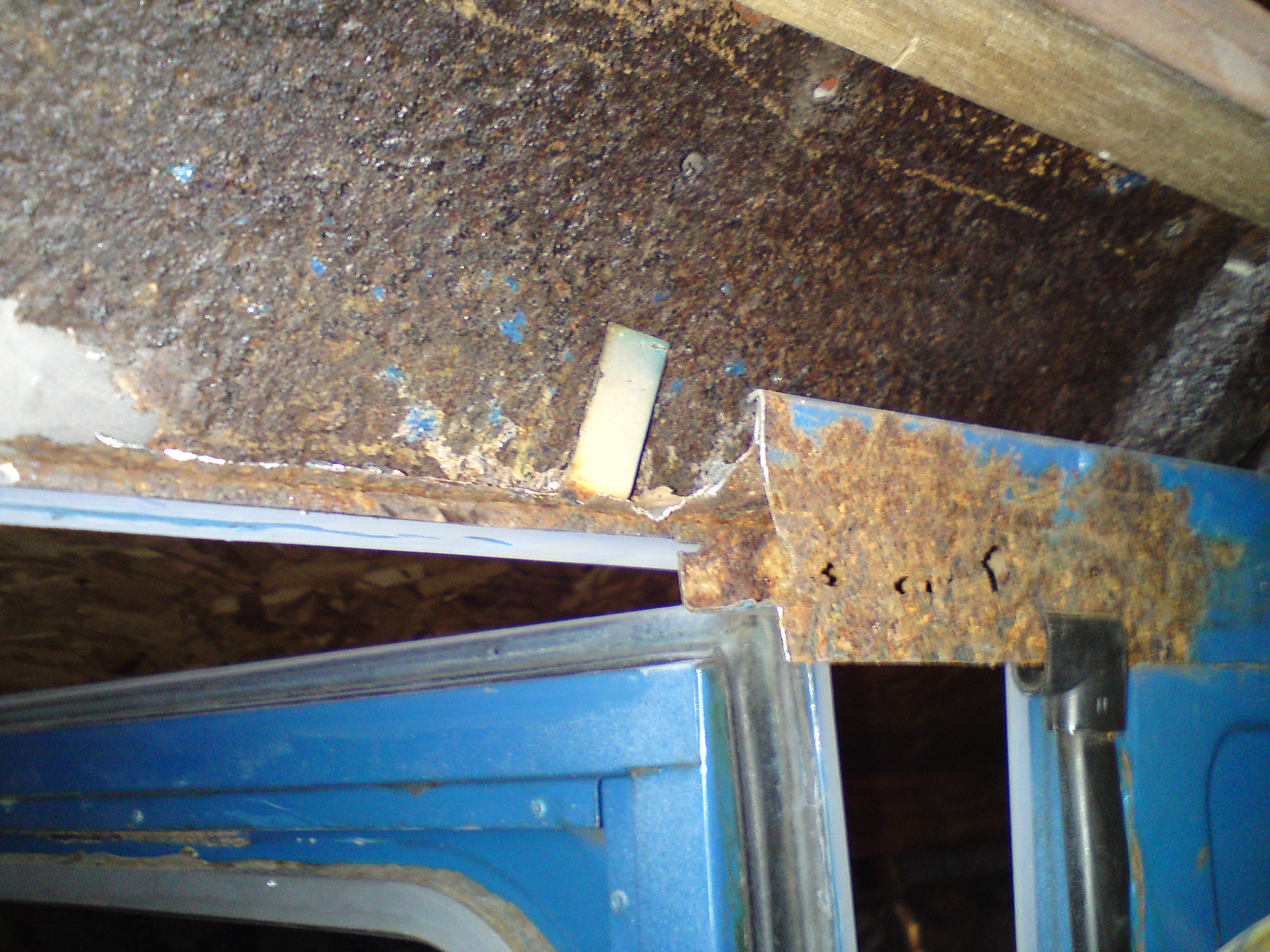

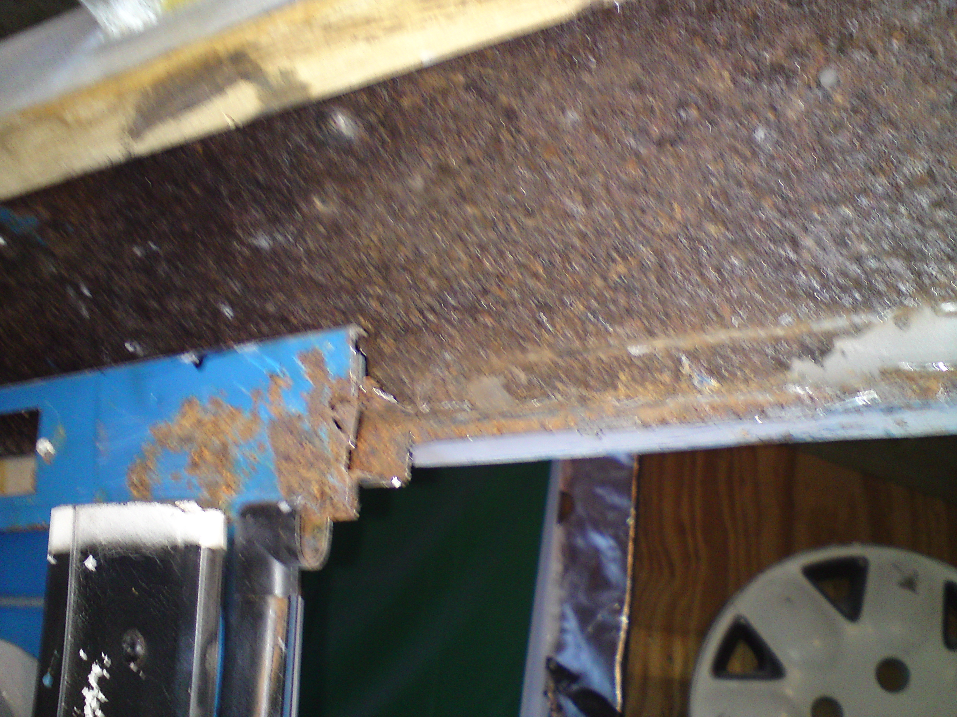

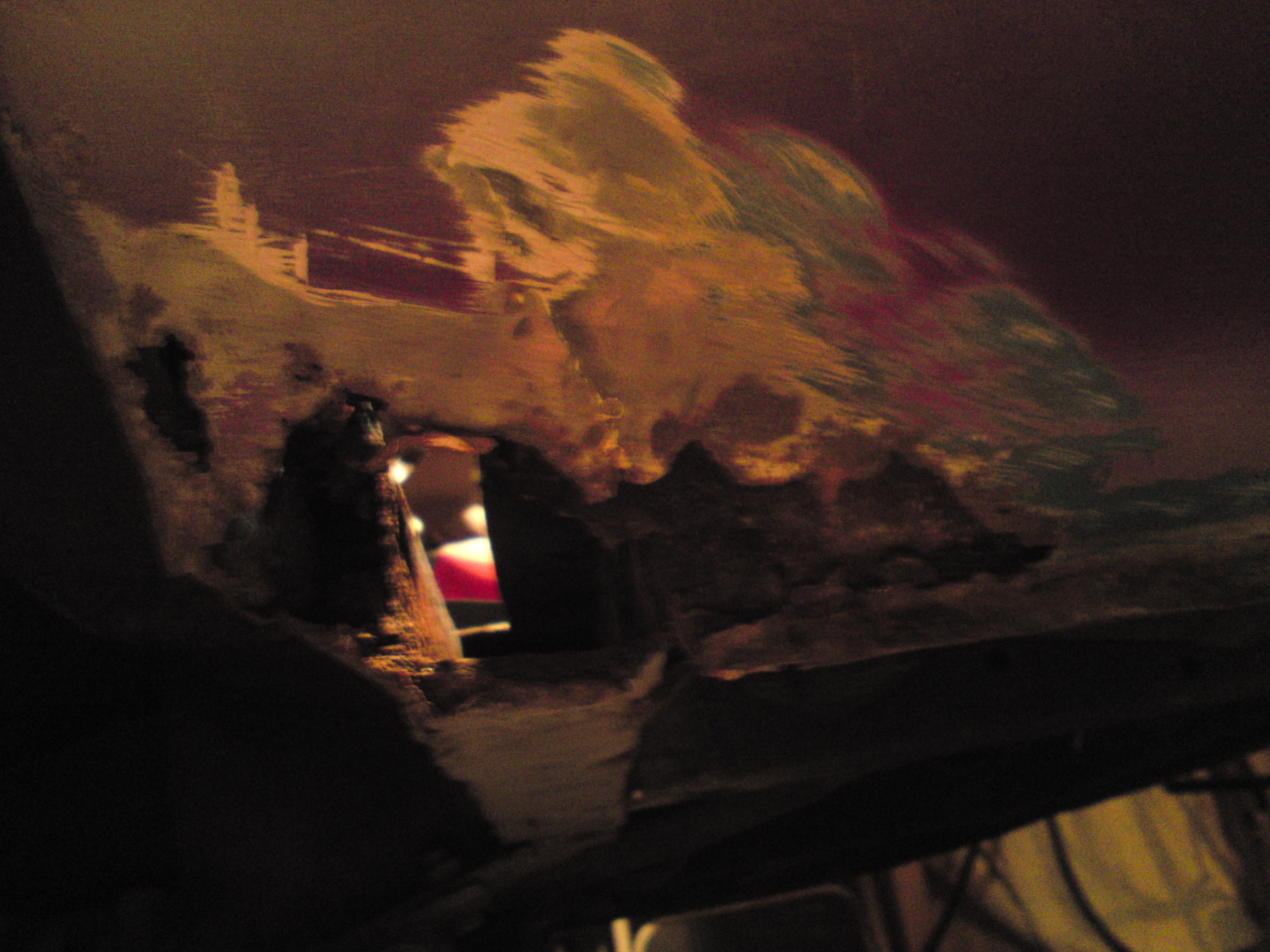

Right been busy with the van and have decided that to do the job properly i need to completely strip it! The engine is out, the doors are off and the windscreen is out. The main reason for this is that i have decided to change the colour and want it to look right and not bodged. I also done some back tracking and cut out my previous roof sections that i had welded in because i wasnt happy with leaving the old rusty metal behind them. and i am now considering making the van more of a day van without the camping interior or pop top( sacrilege i know ) , A good friend of mine is a car trimmer and he could make me a full length webasto sunroof like you see on some VW's.
Anyway heres some photosof the van as of yesterday.

Thr roof repair panel is from a vw bay window camper and has almost the same profile and fits like a glove!
Finally found to front lower panel that i needed so fitted it today along with some floor repairs.

I now only need the front wheel arch and the other roof section to weld on then the welding is all done apart from a couple of patches underneath!

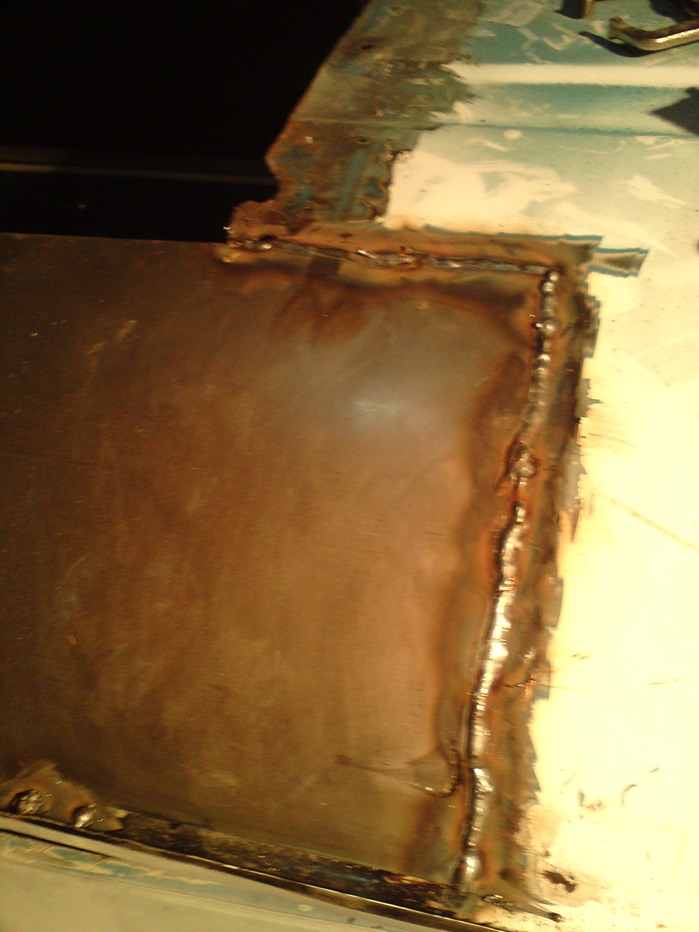

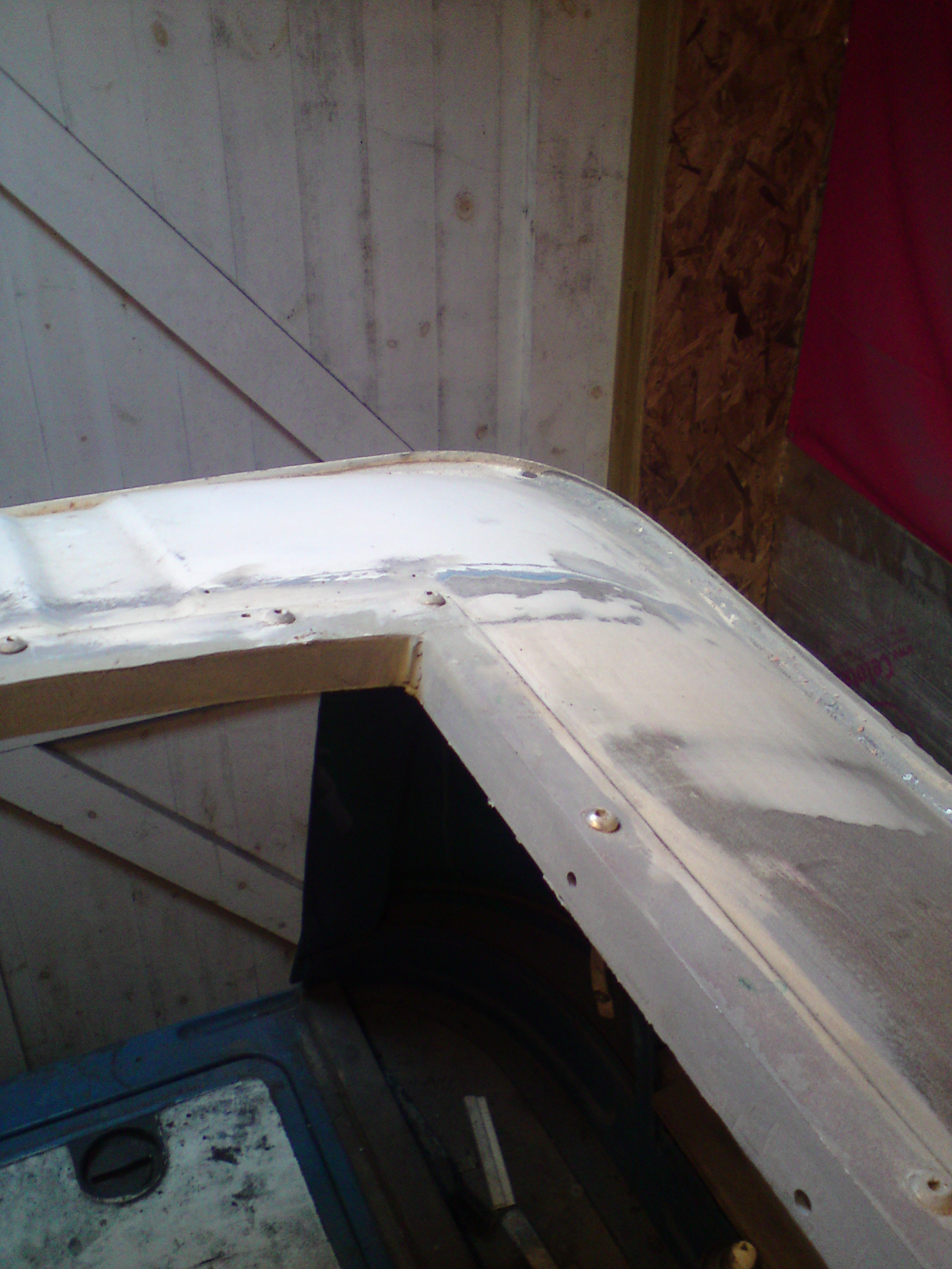

Hello little update, i have finaly finished fabricating the roof (y)
I am happy now that there is no rust on the roof and that it is strong and ready for the rag top sunroof, which will be fitted after the van is sprayed.
