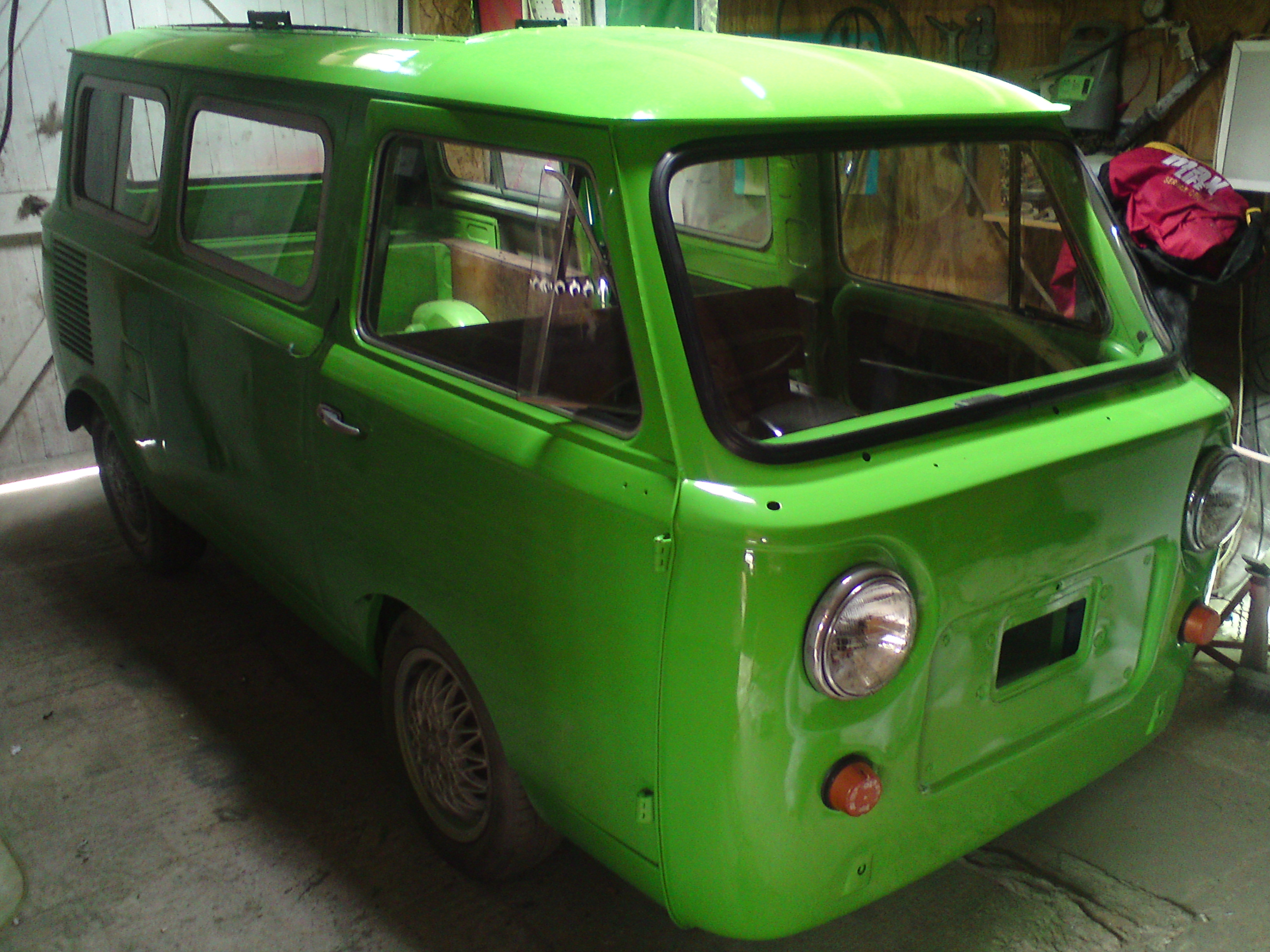

850T 850t restoration

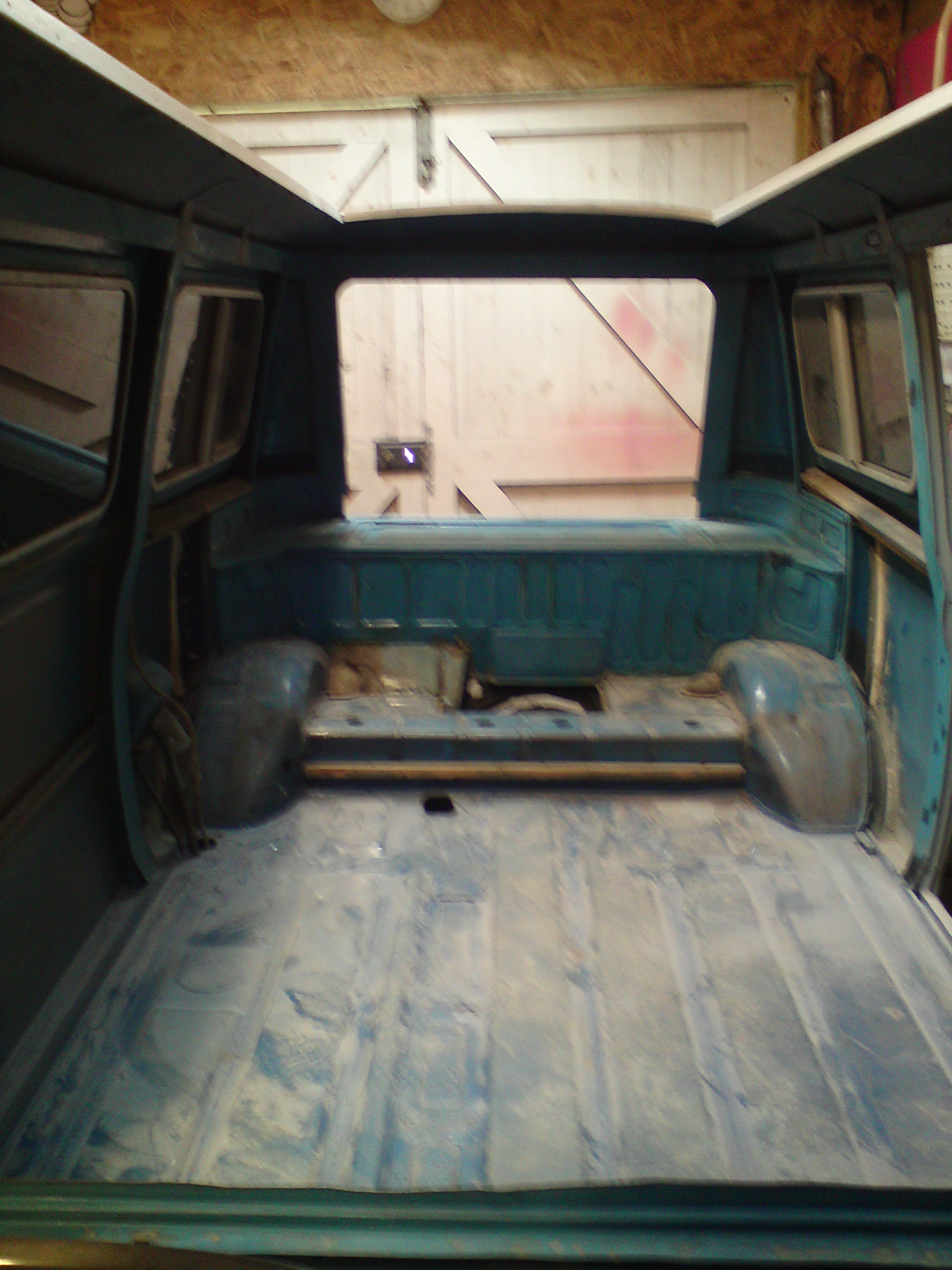

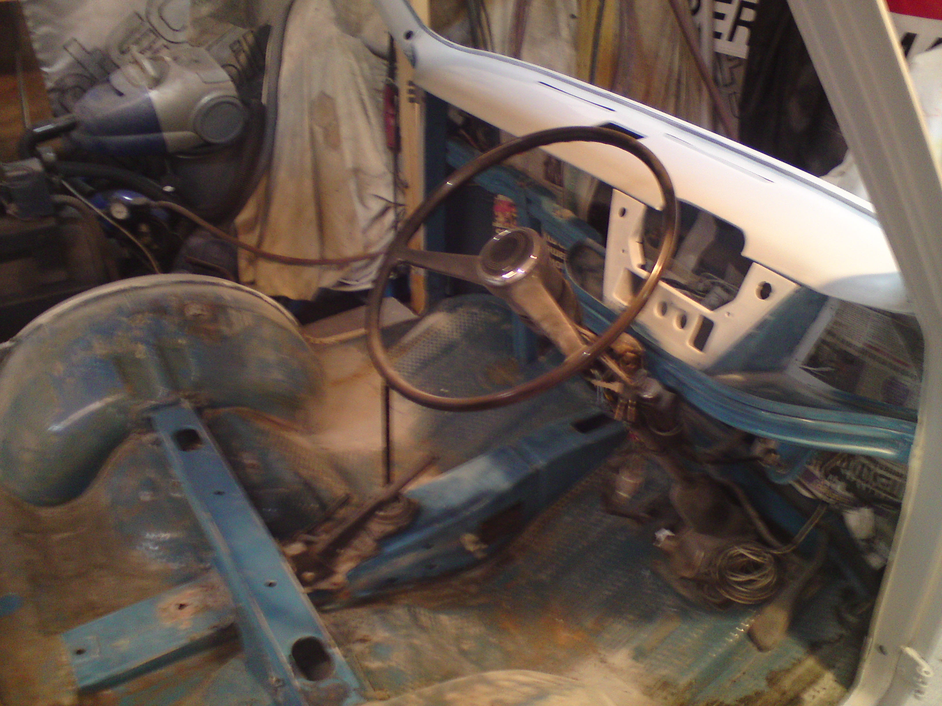

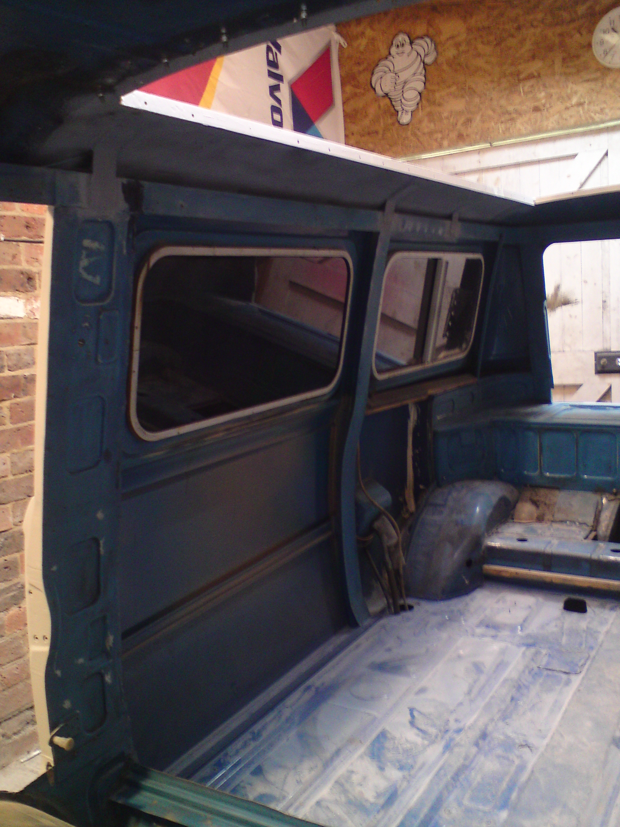

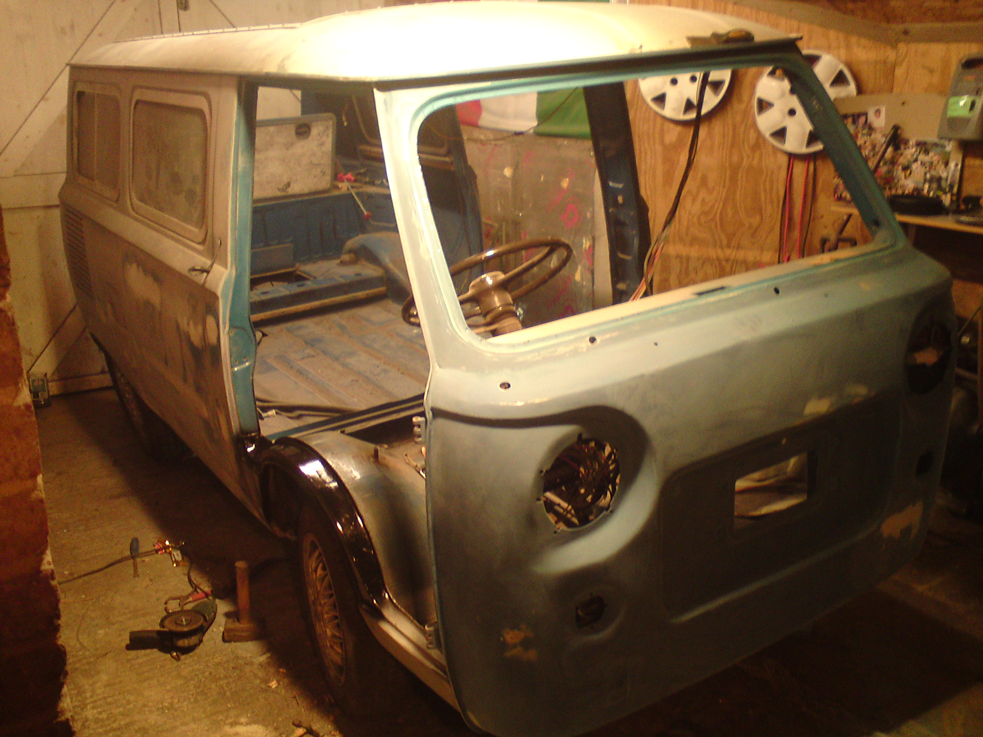

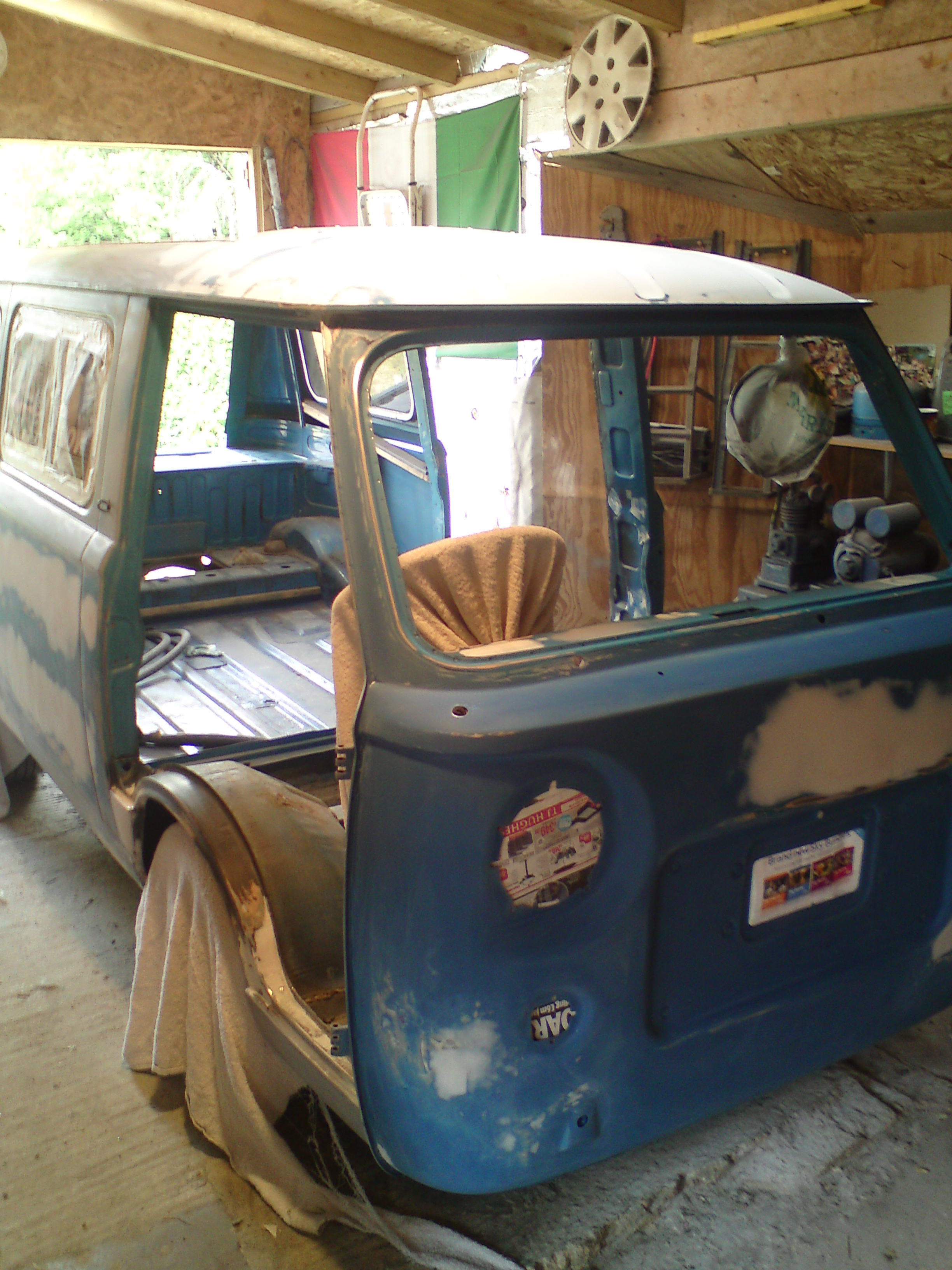

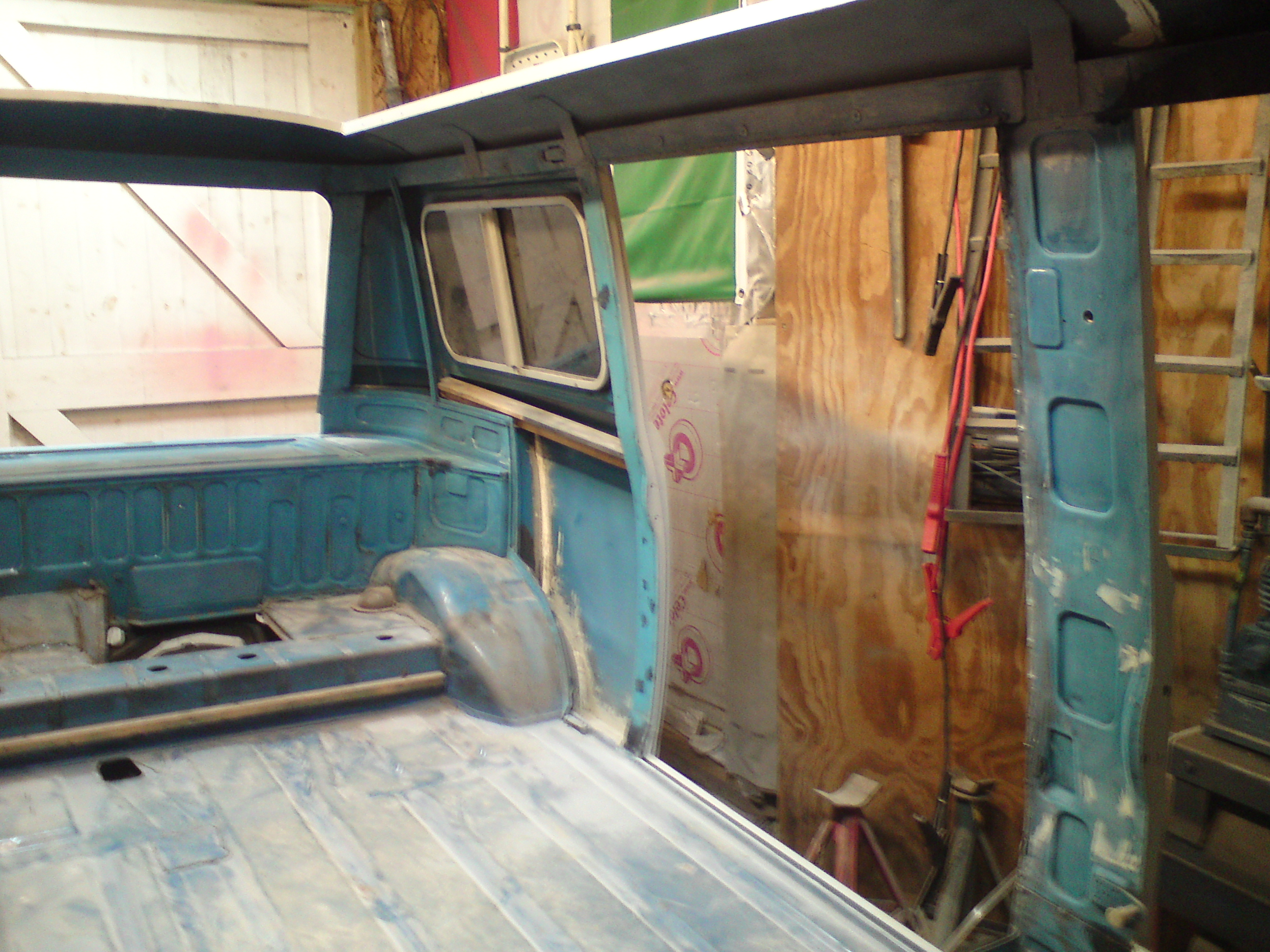

thought id start my own thread on my van restoration, lots to do and only a few hours in the evening to do work on the van so might take a while to finish...

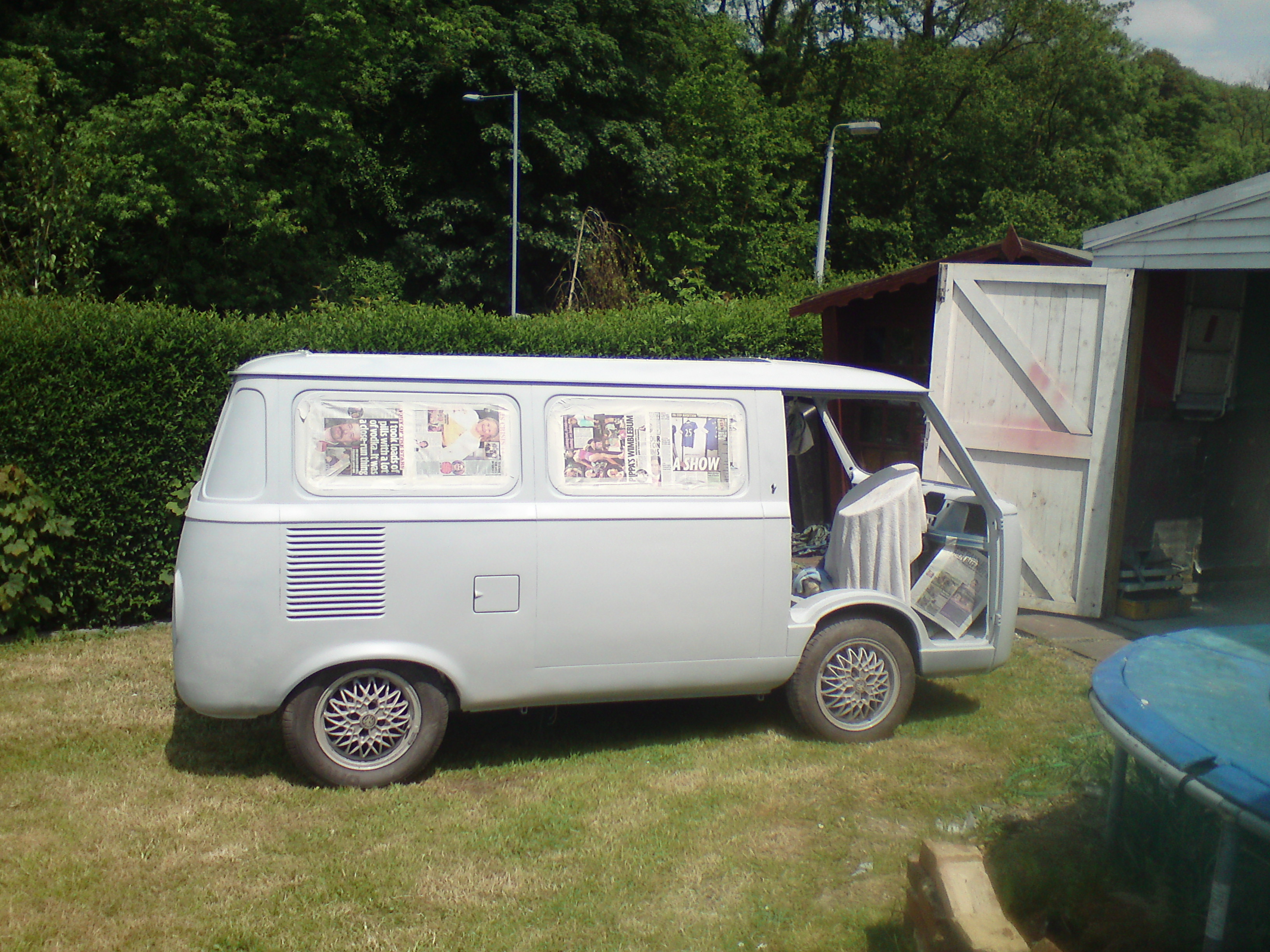

these were taken about two weeks ago when i first got her home.

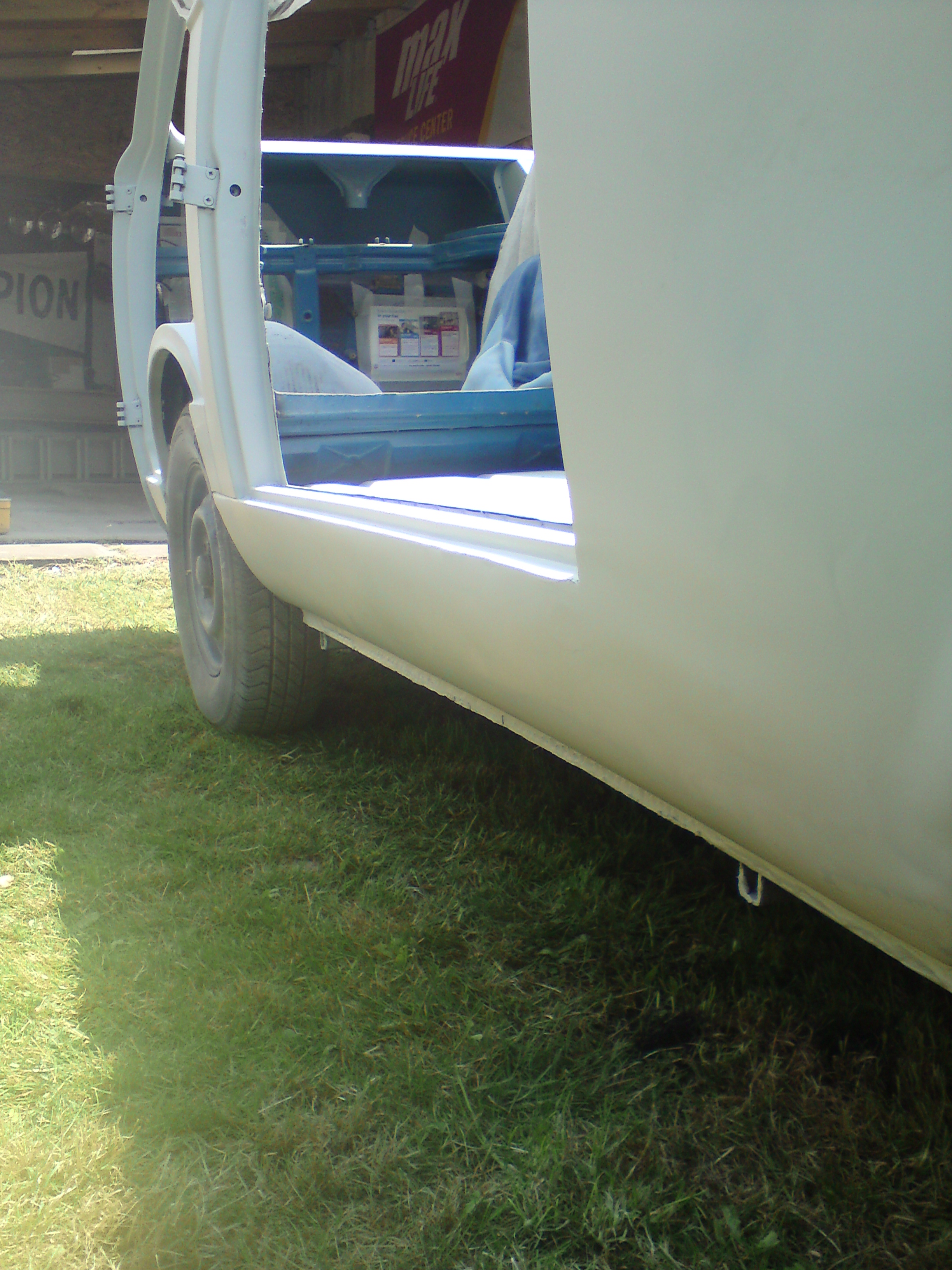

I have got all my panels from italian ebay, the price can vary so dont buy the first one you see, think i paid about £55 each side which is not to bad if you take into account the postage. Is there any other panels you need?

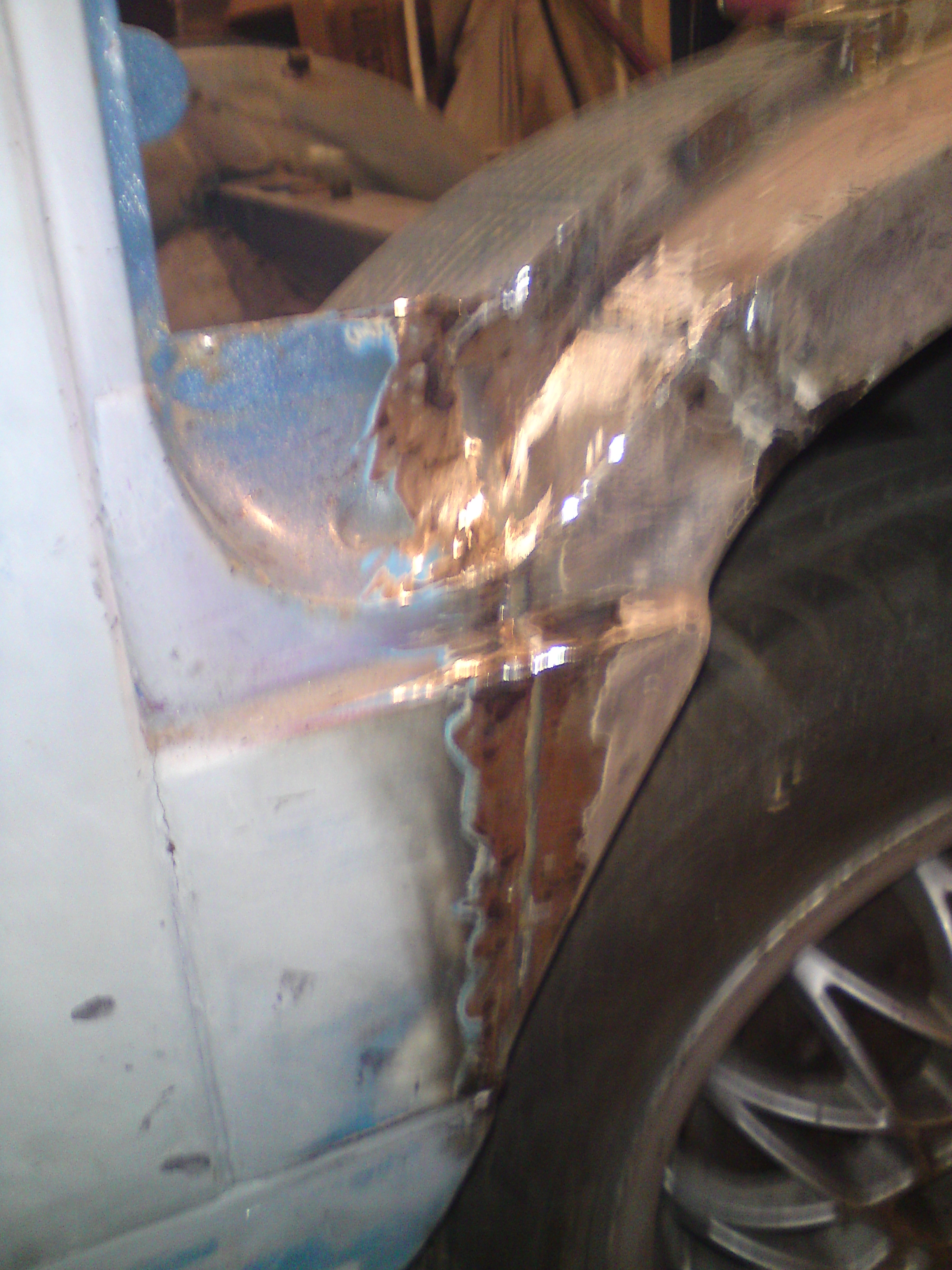

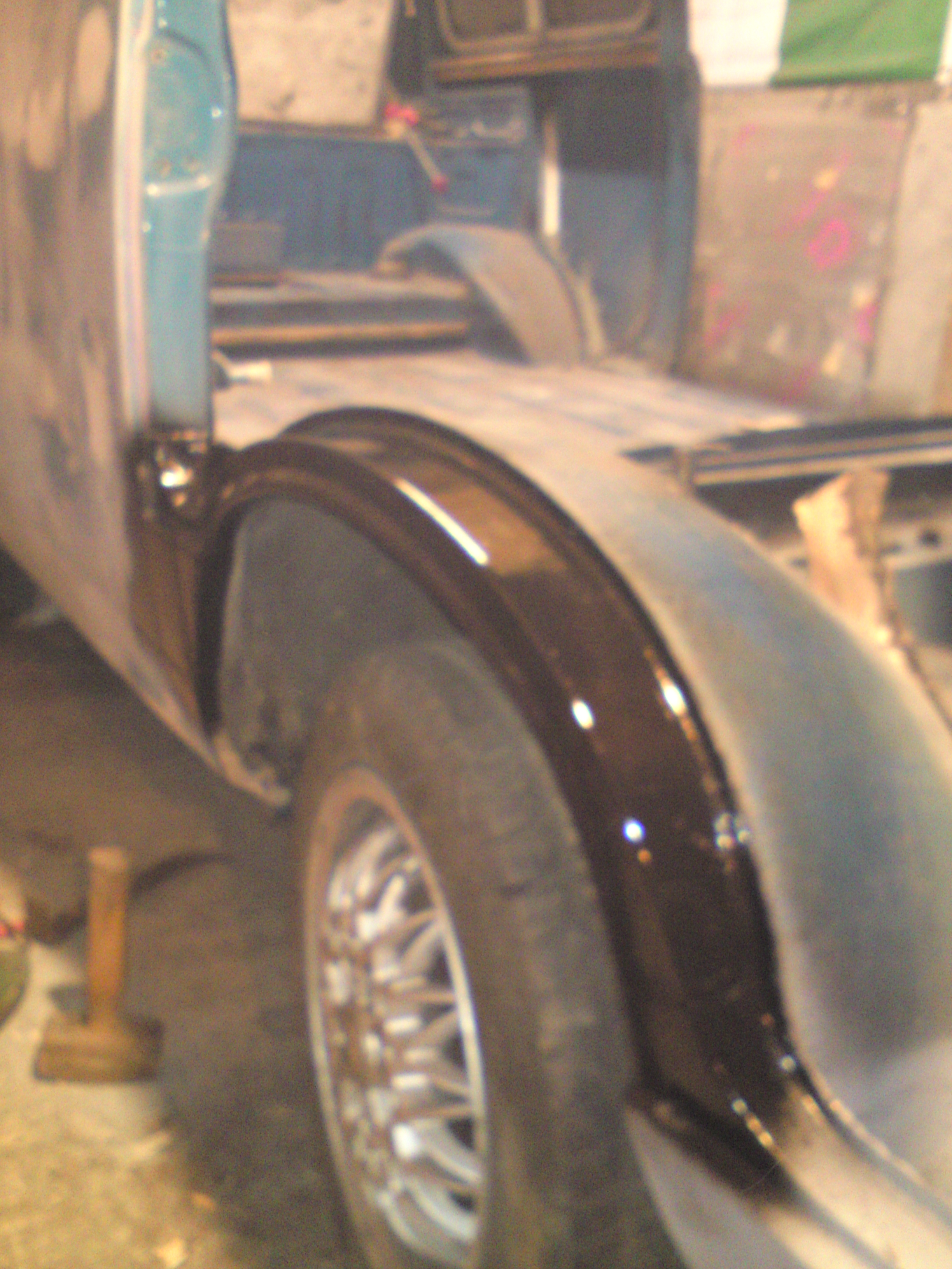

Well after seeing the other 850T that has been dicovered i thought i would do a little update.

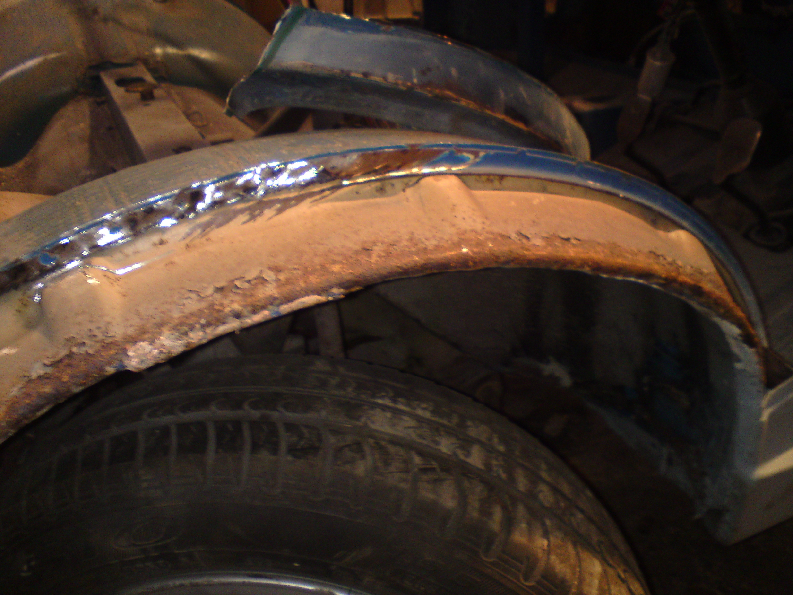

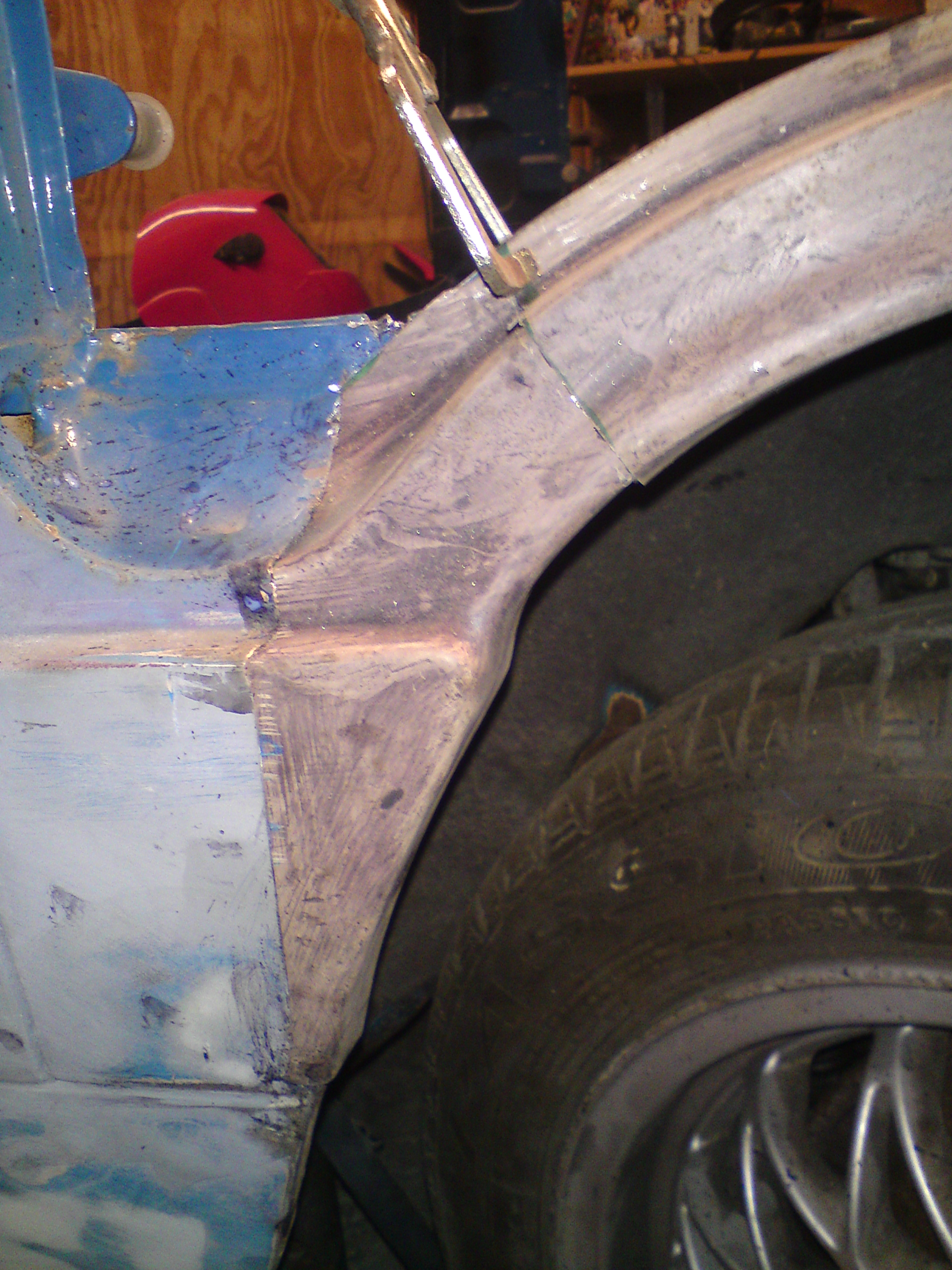

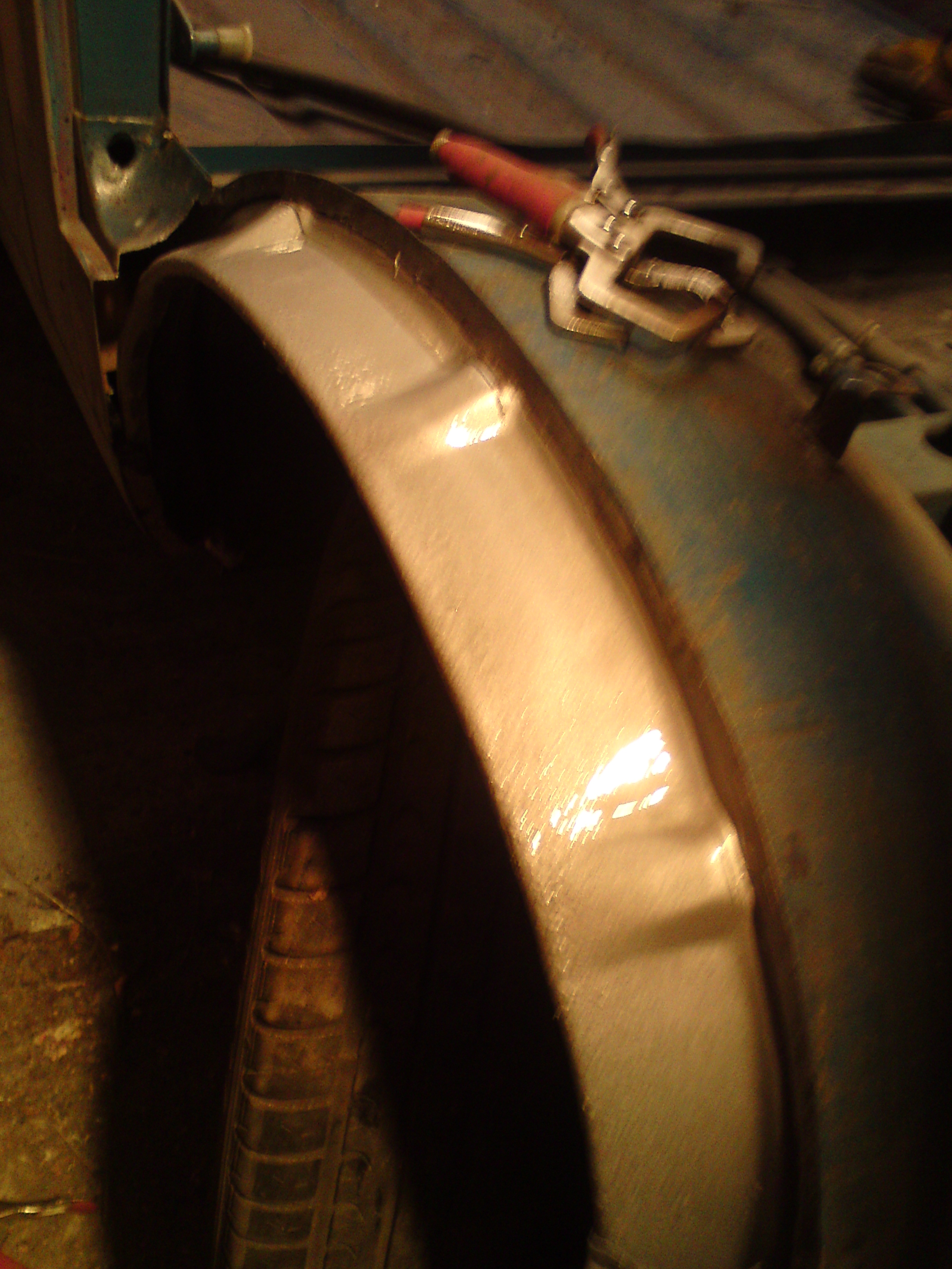

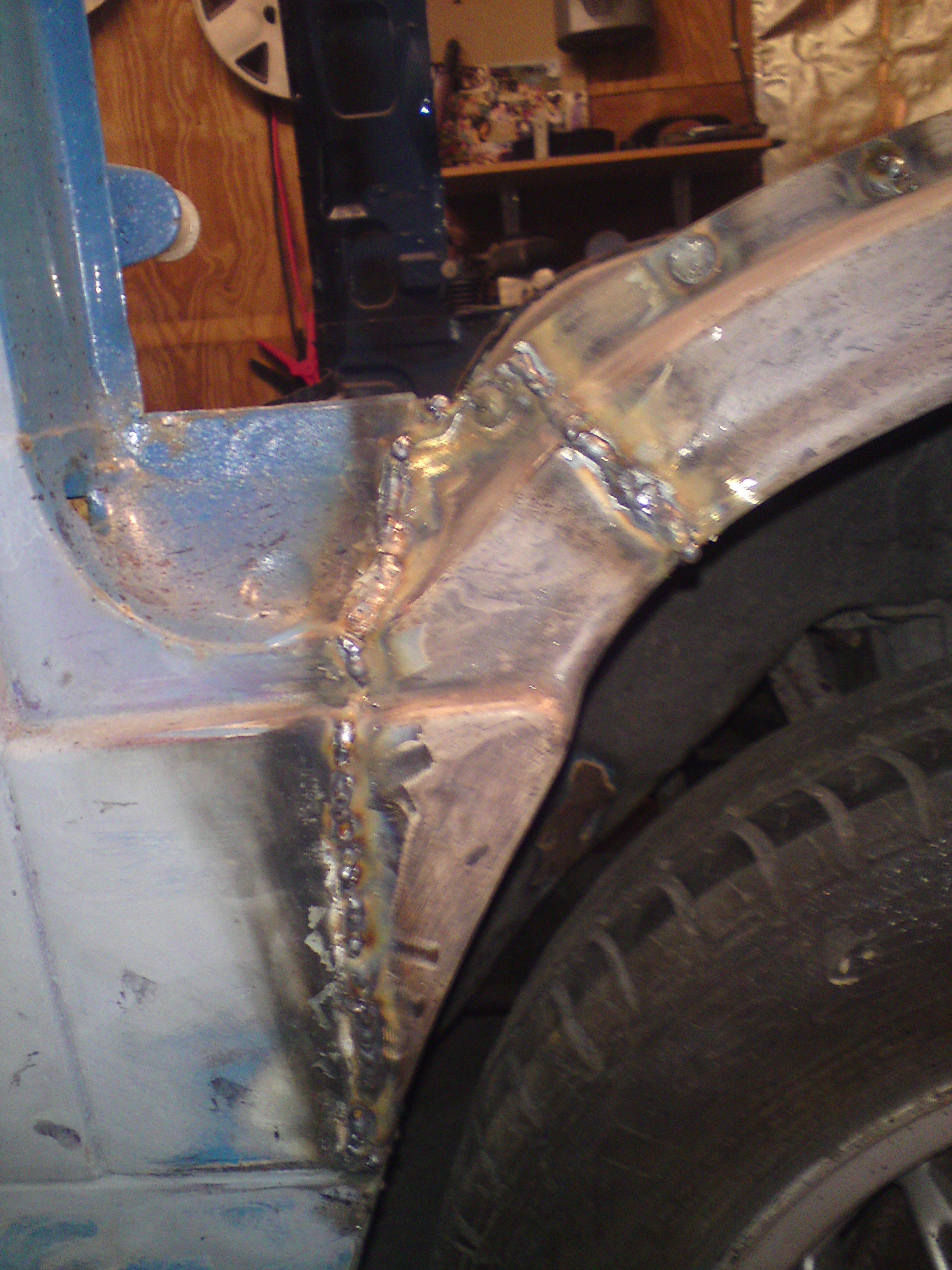

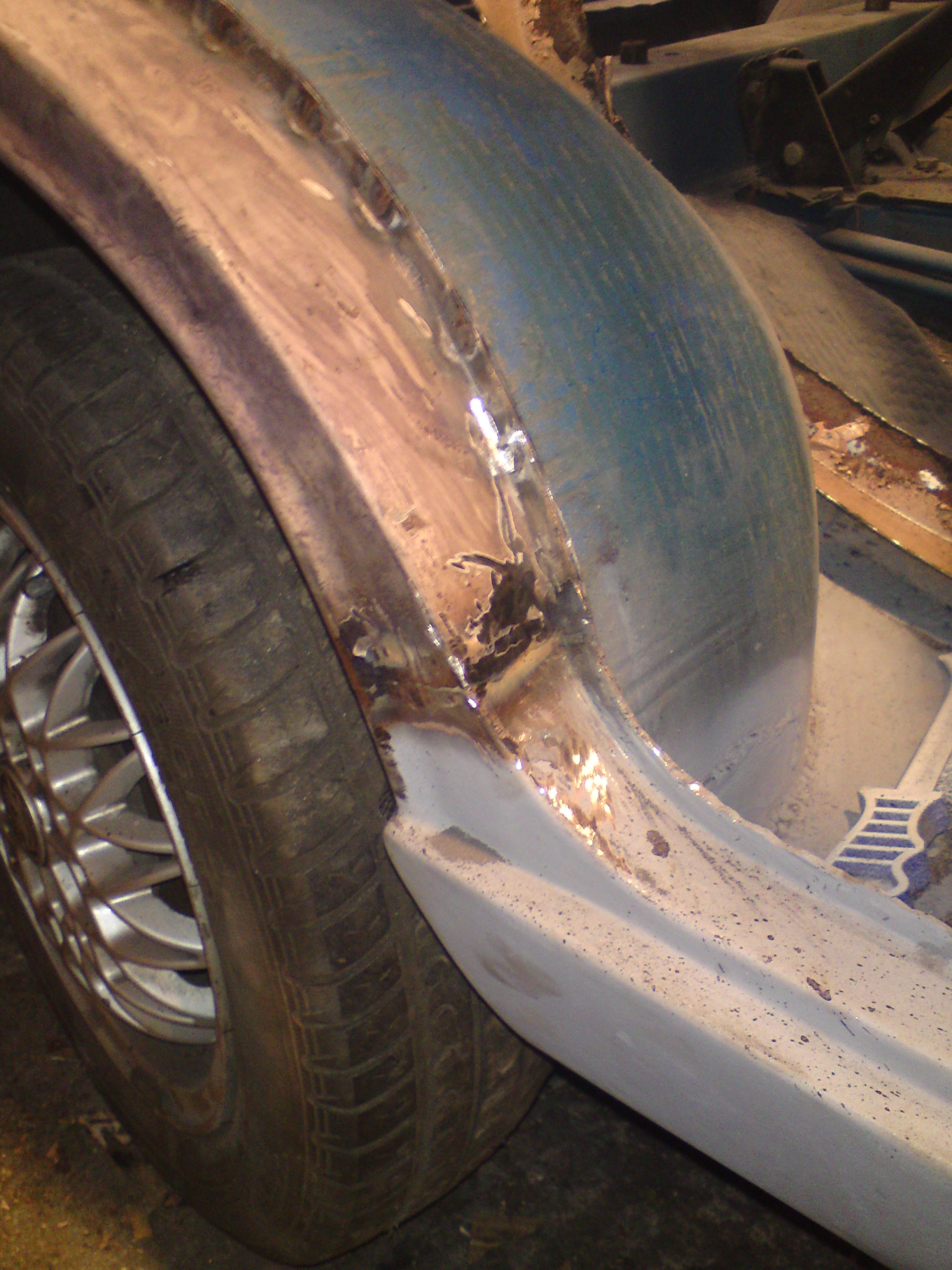

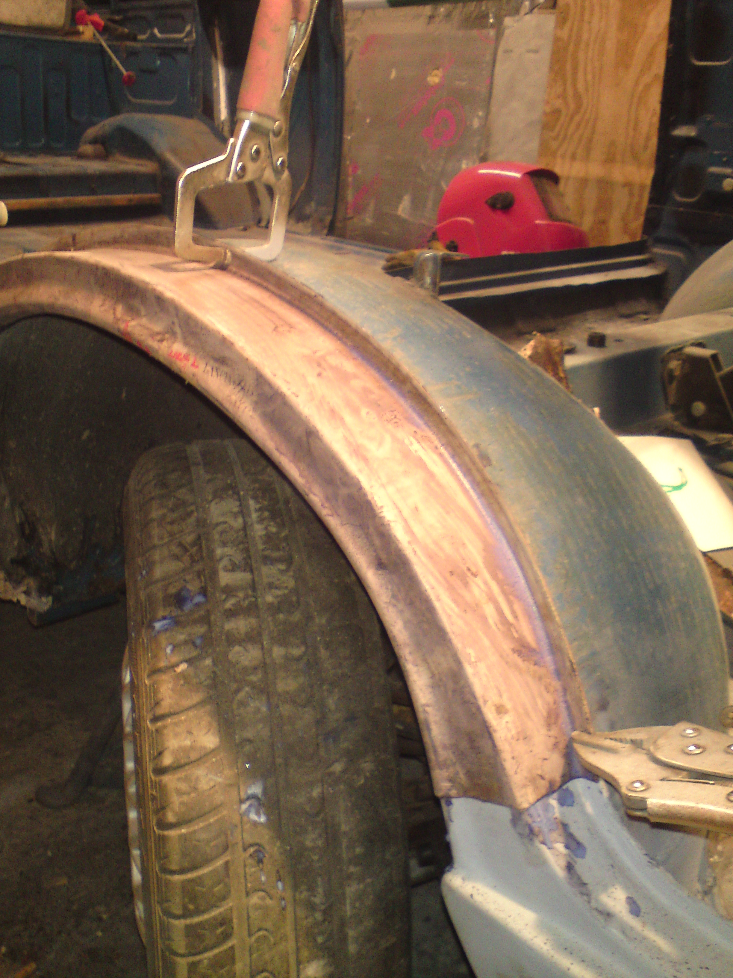

The last panel is on and all the welding is finally finished! all the inner wheel arches are treated and undersealed, and i am currently working on doing the same to the rest of the underside soon....

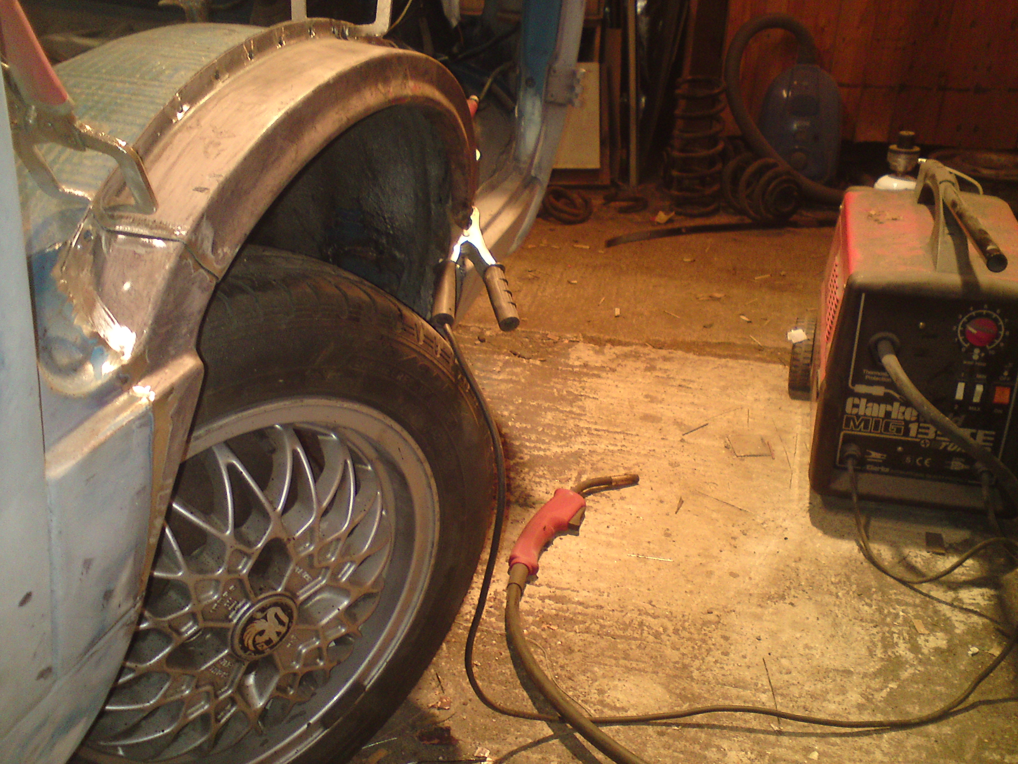

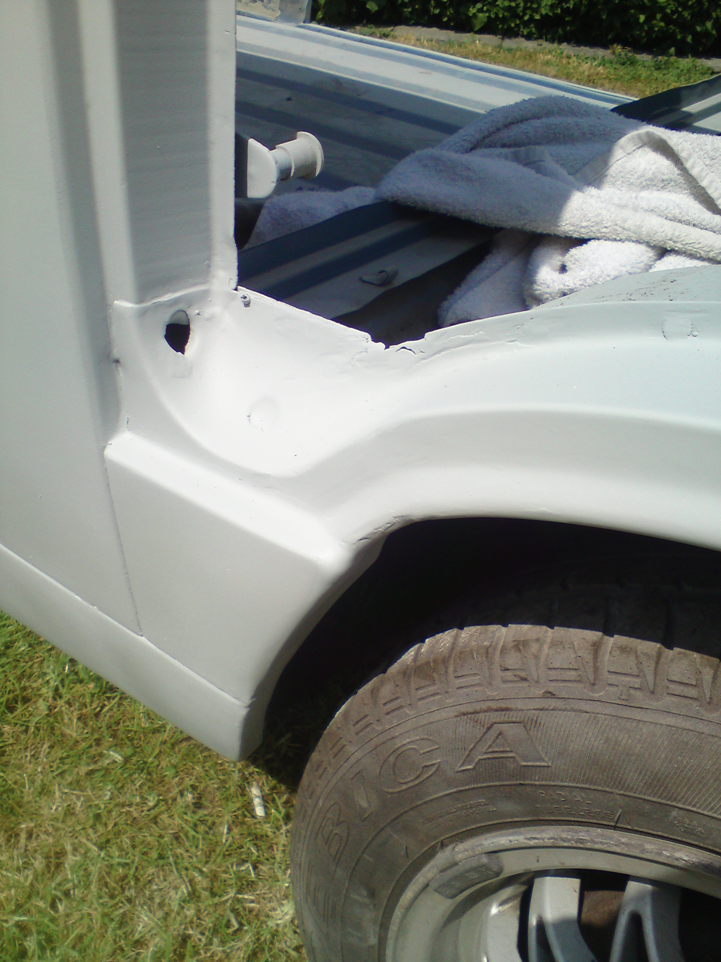

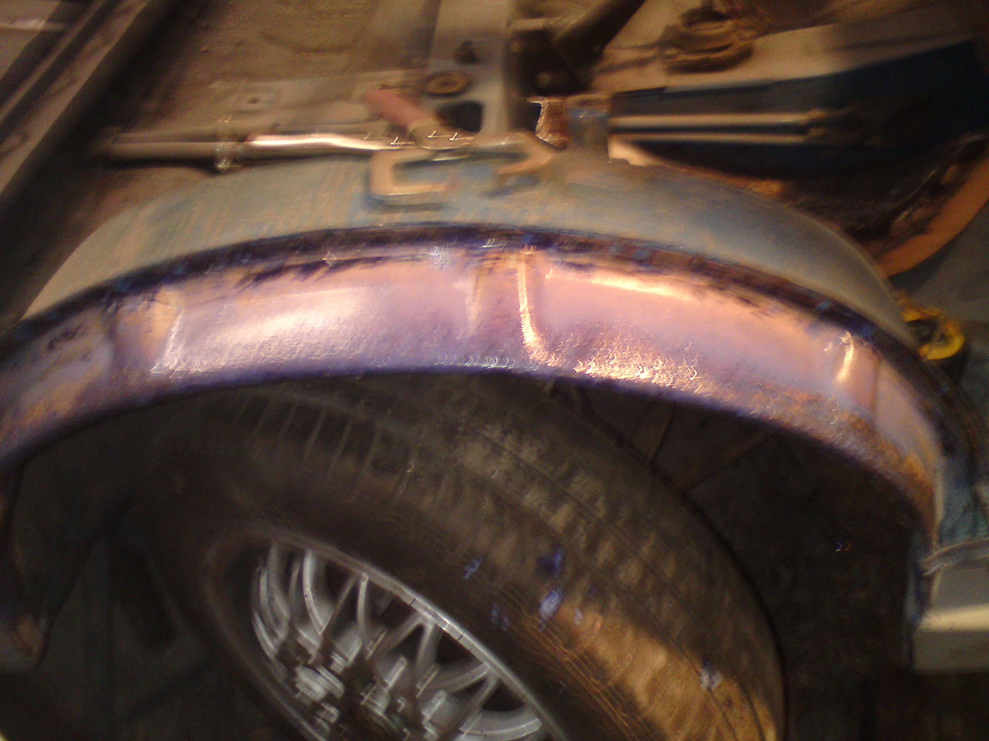

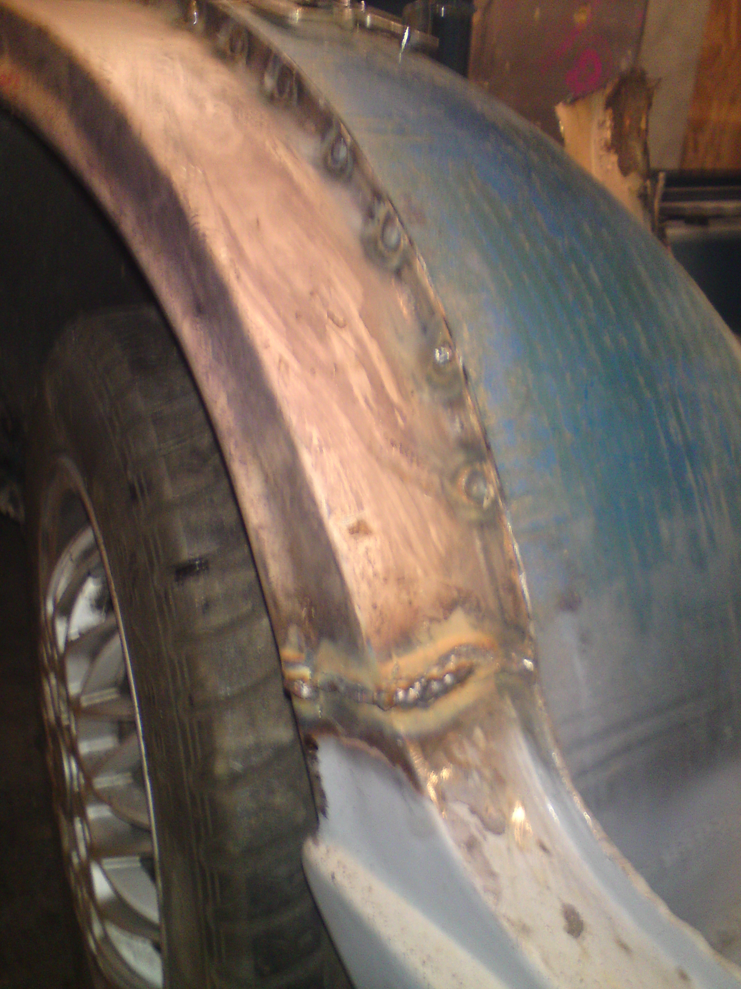

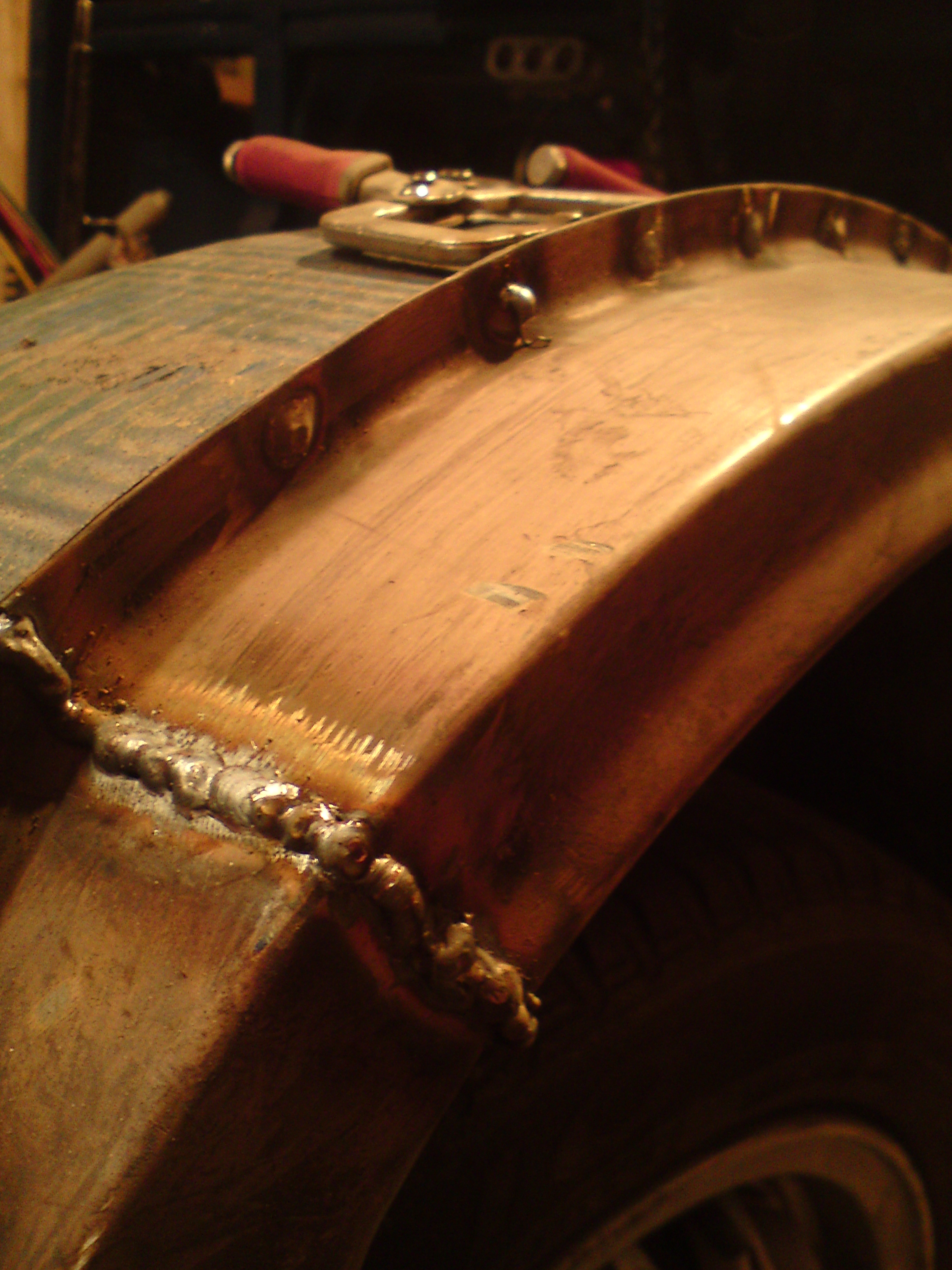

For some strange reason the arch was shorter than the original, so i had to cut it twice and weld it on like this.

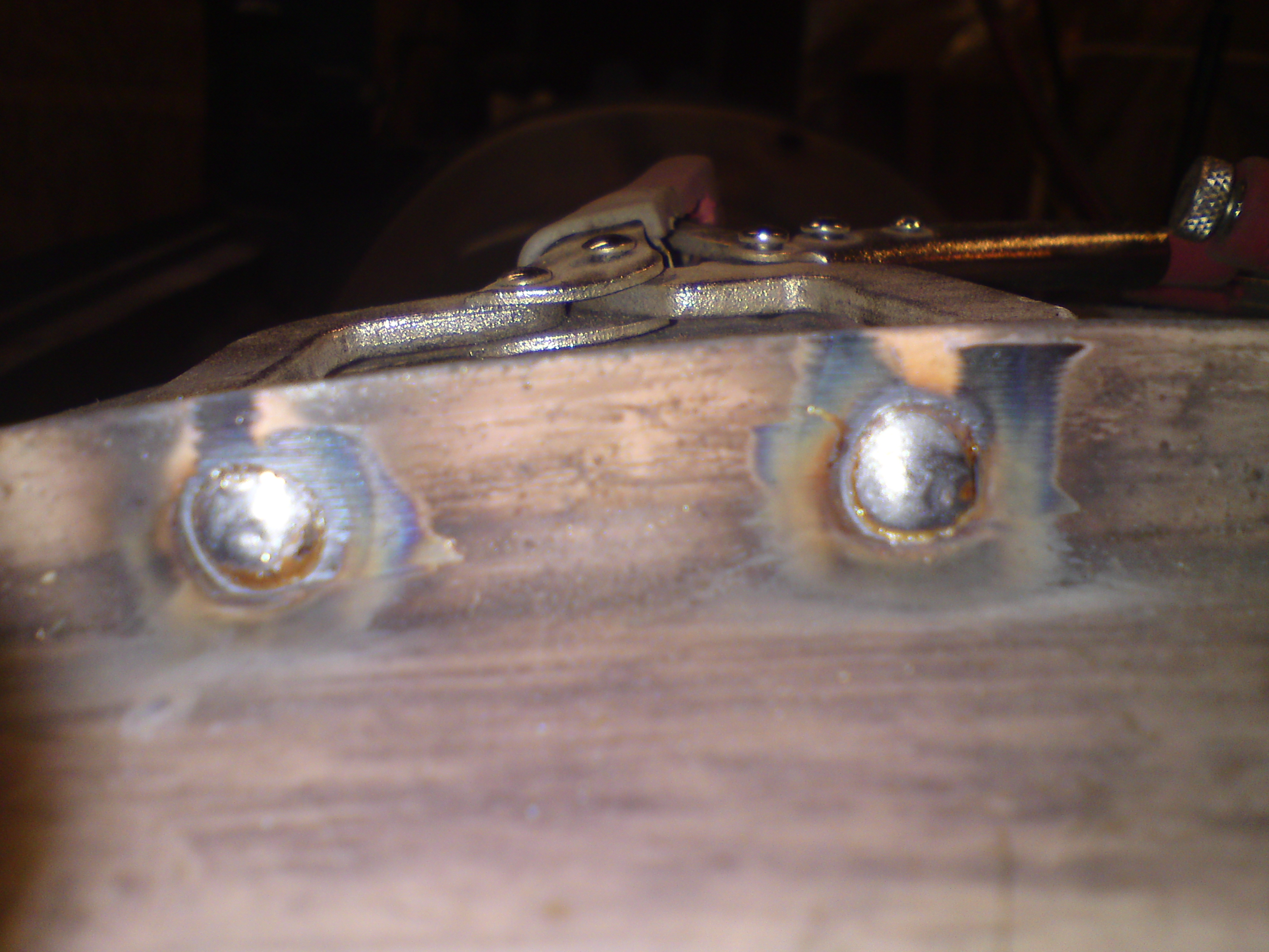

I am finaly getting the hang of plug welding now...

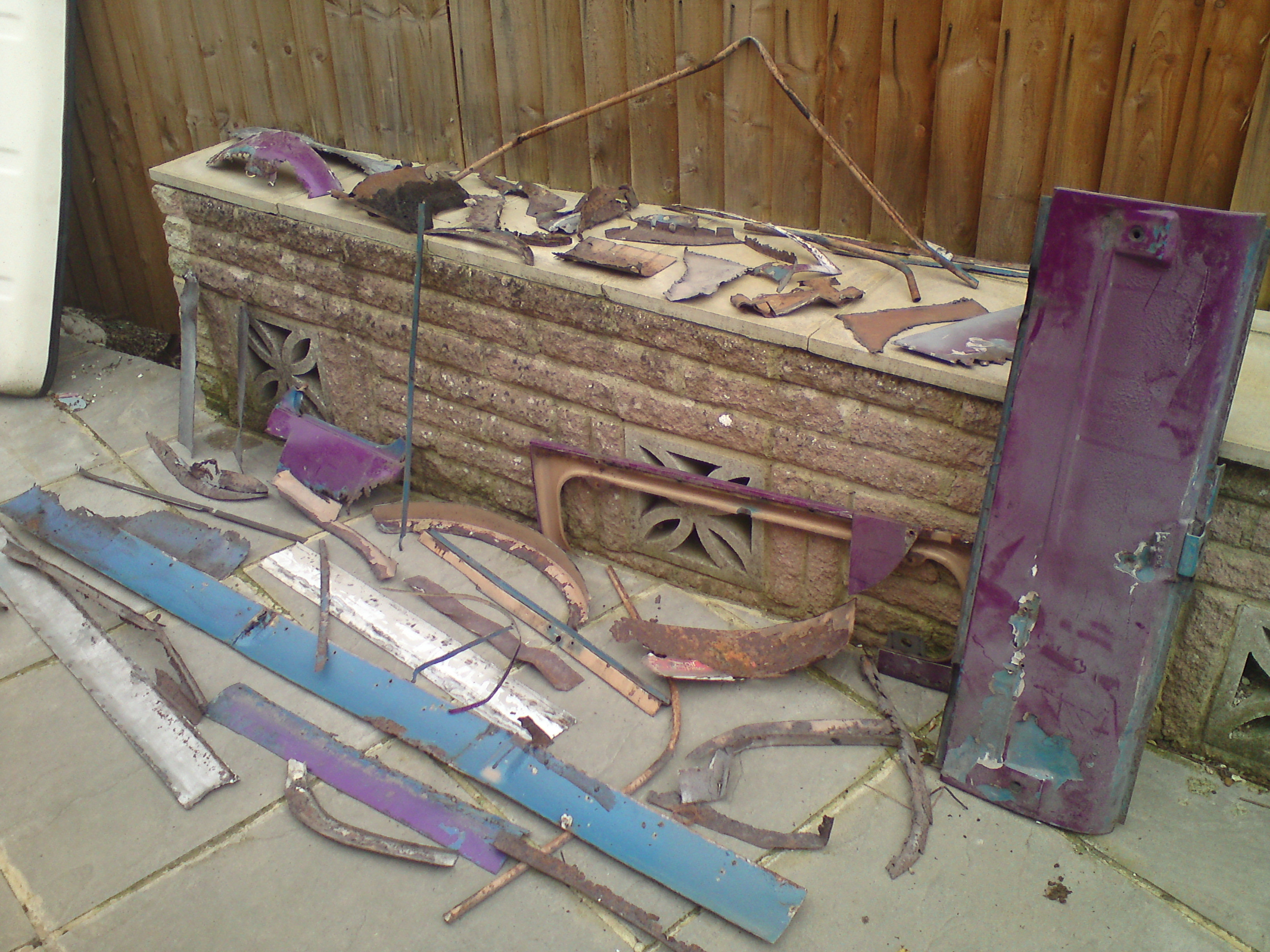

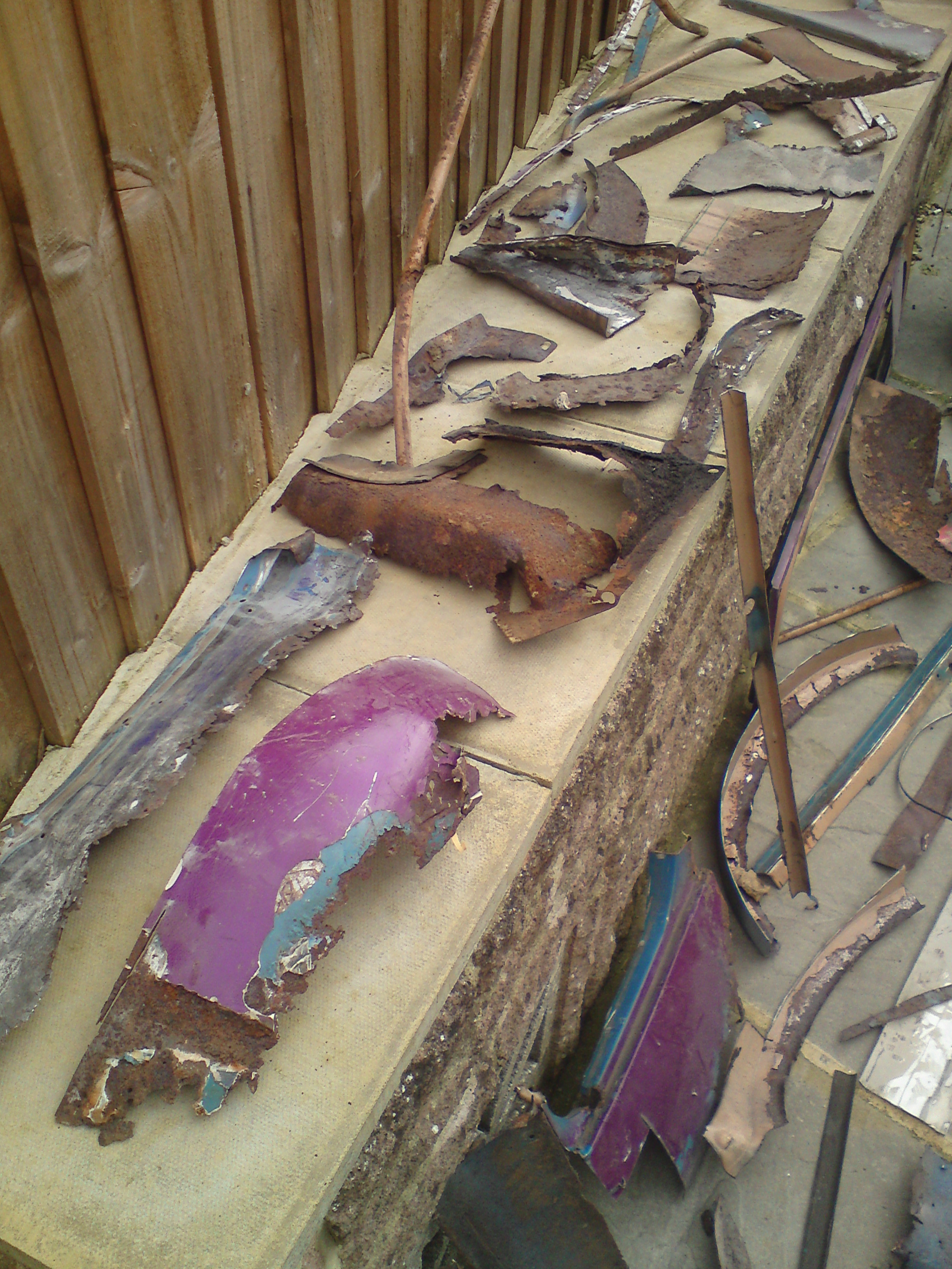

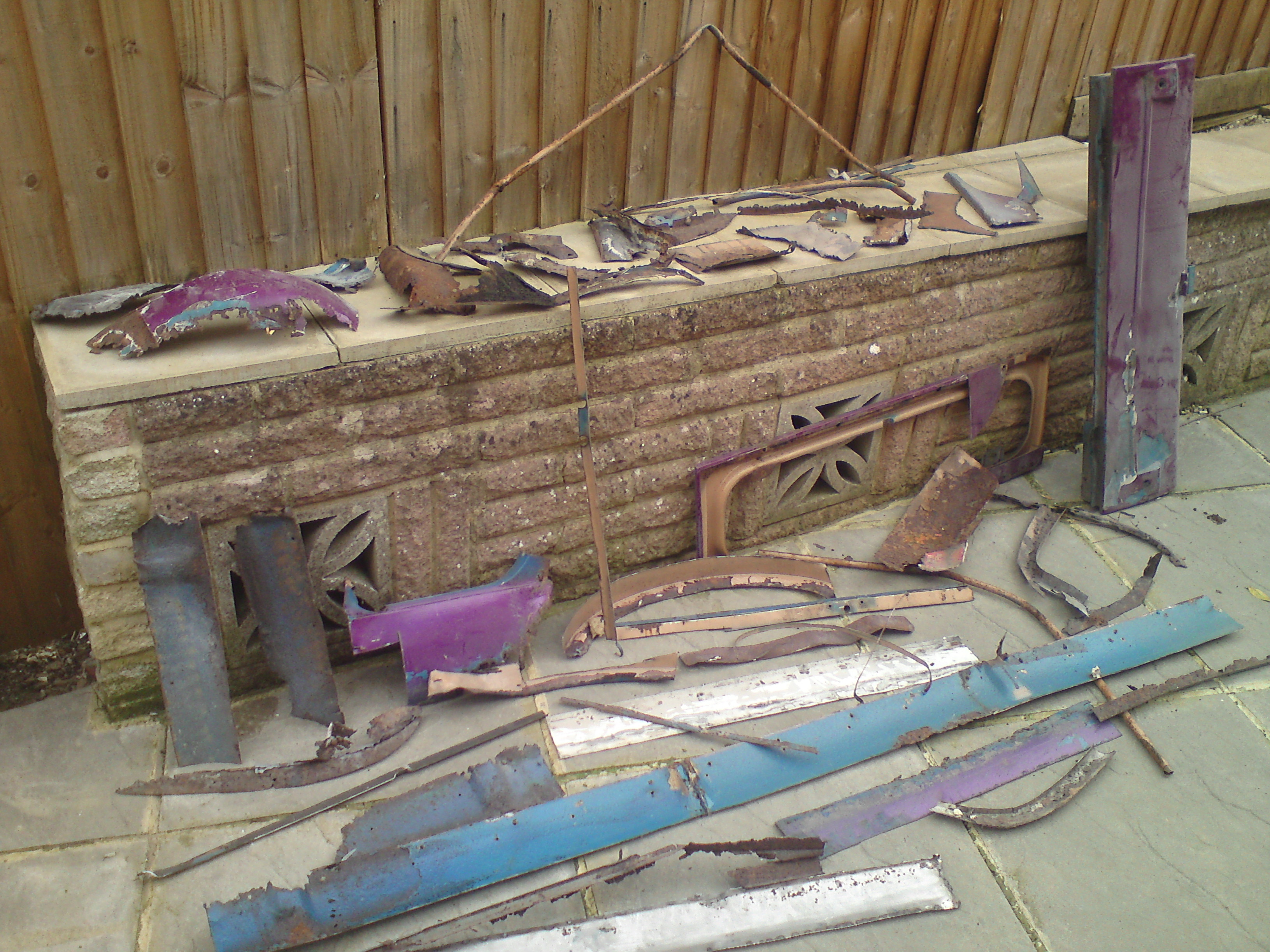

Here is some of the rusty metal that i have removed from the van :eek:, there was more but it was binned when i had a good tidy of the garage.

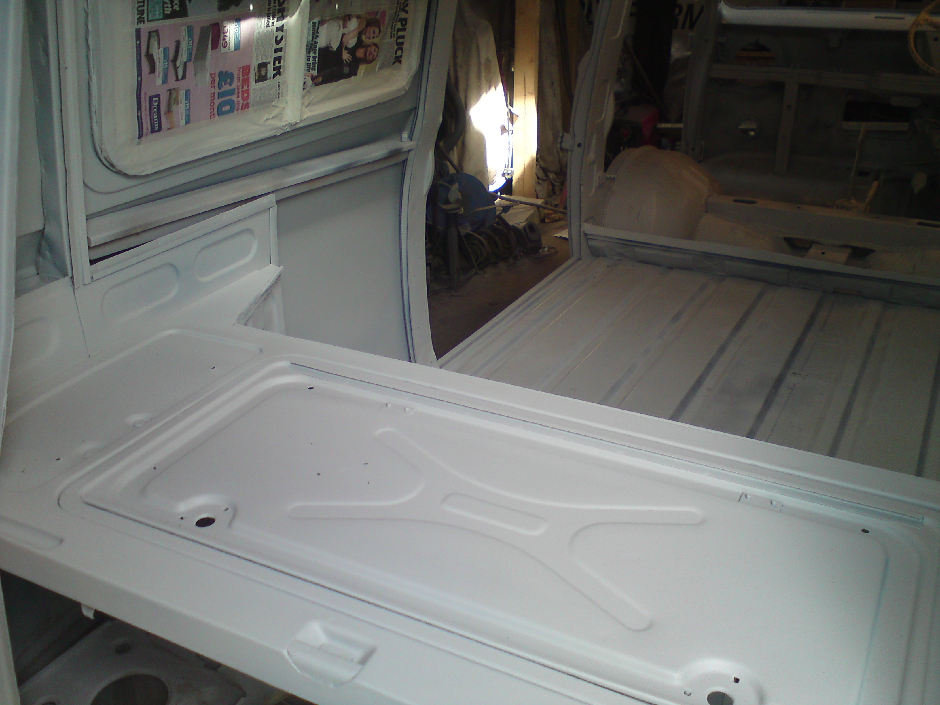

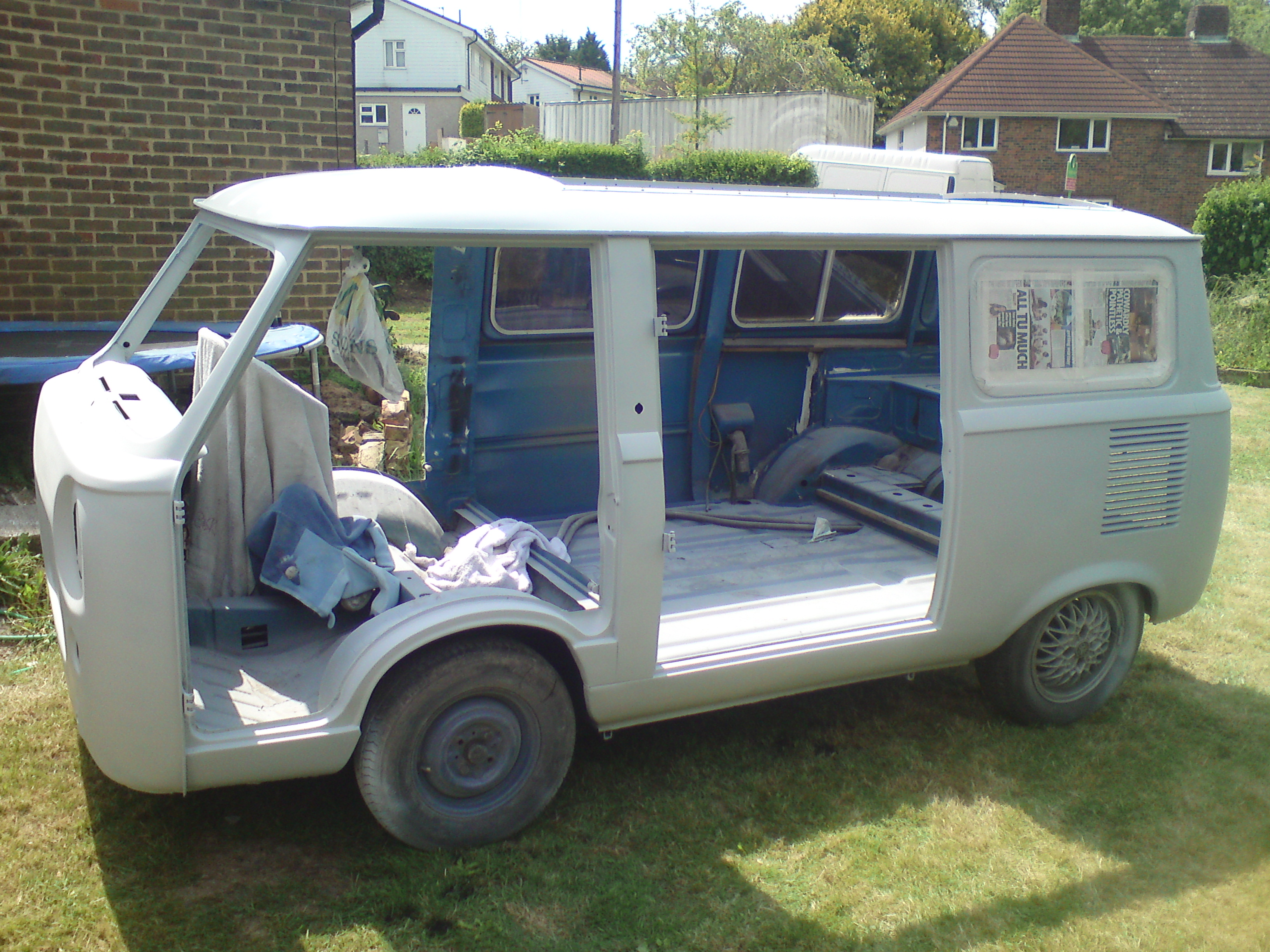

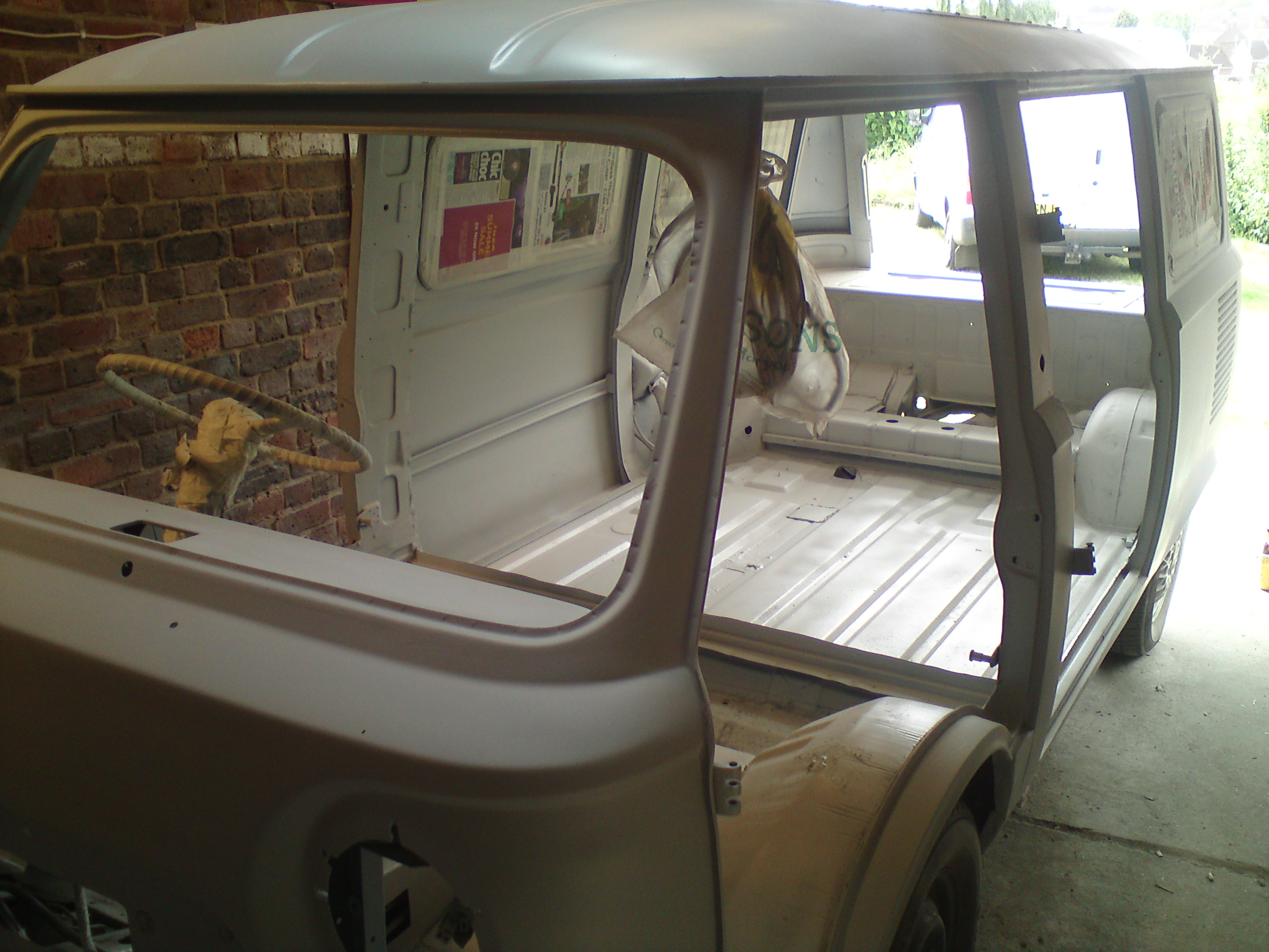

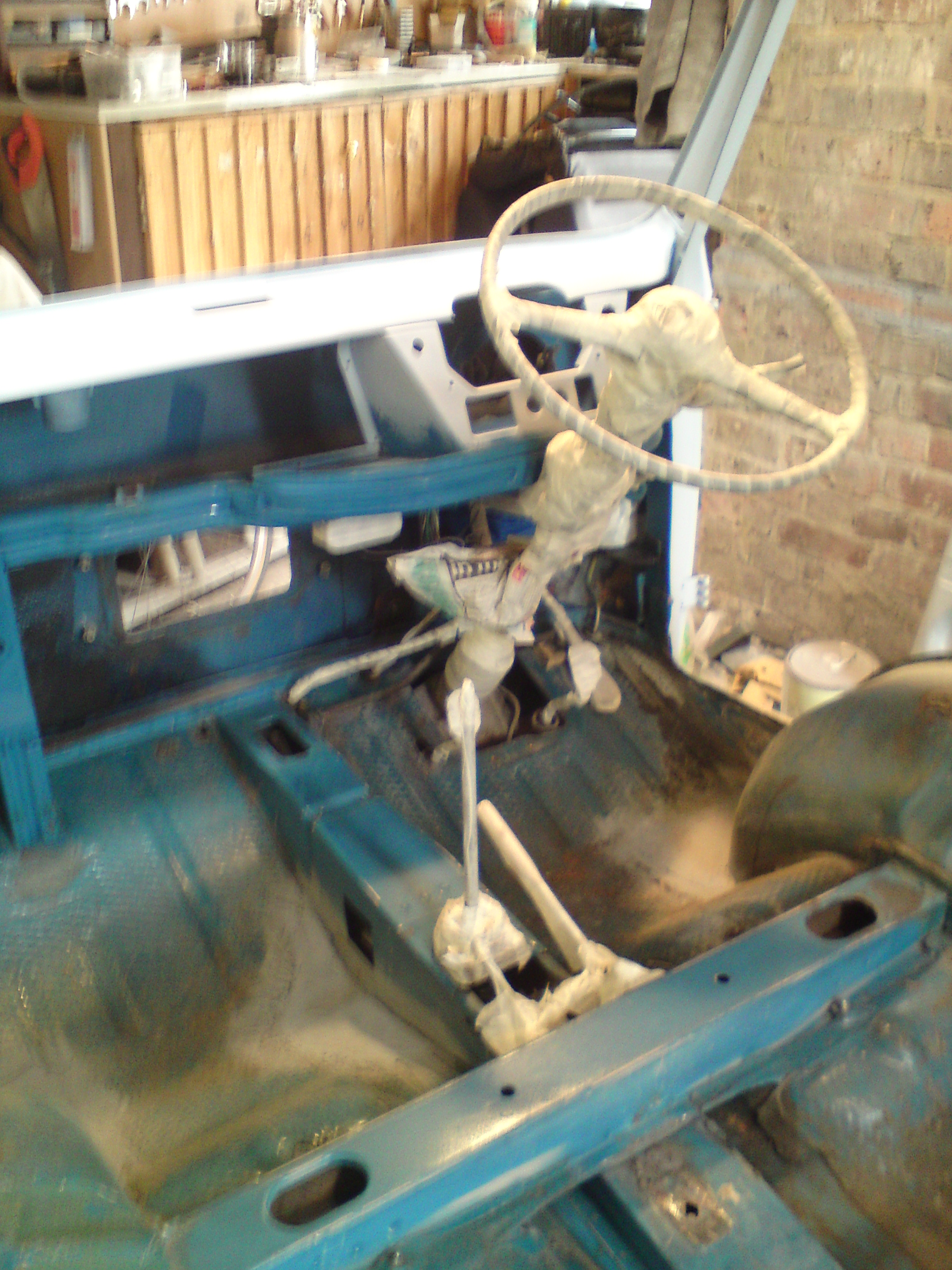

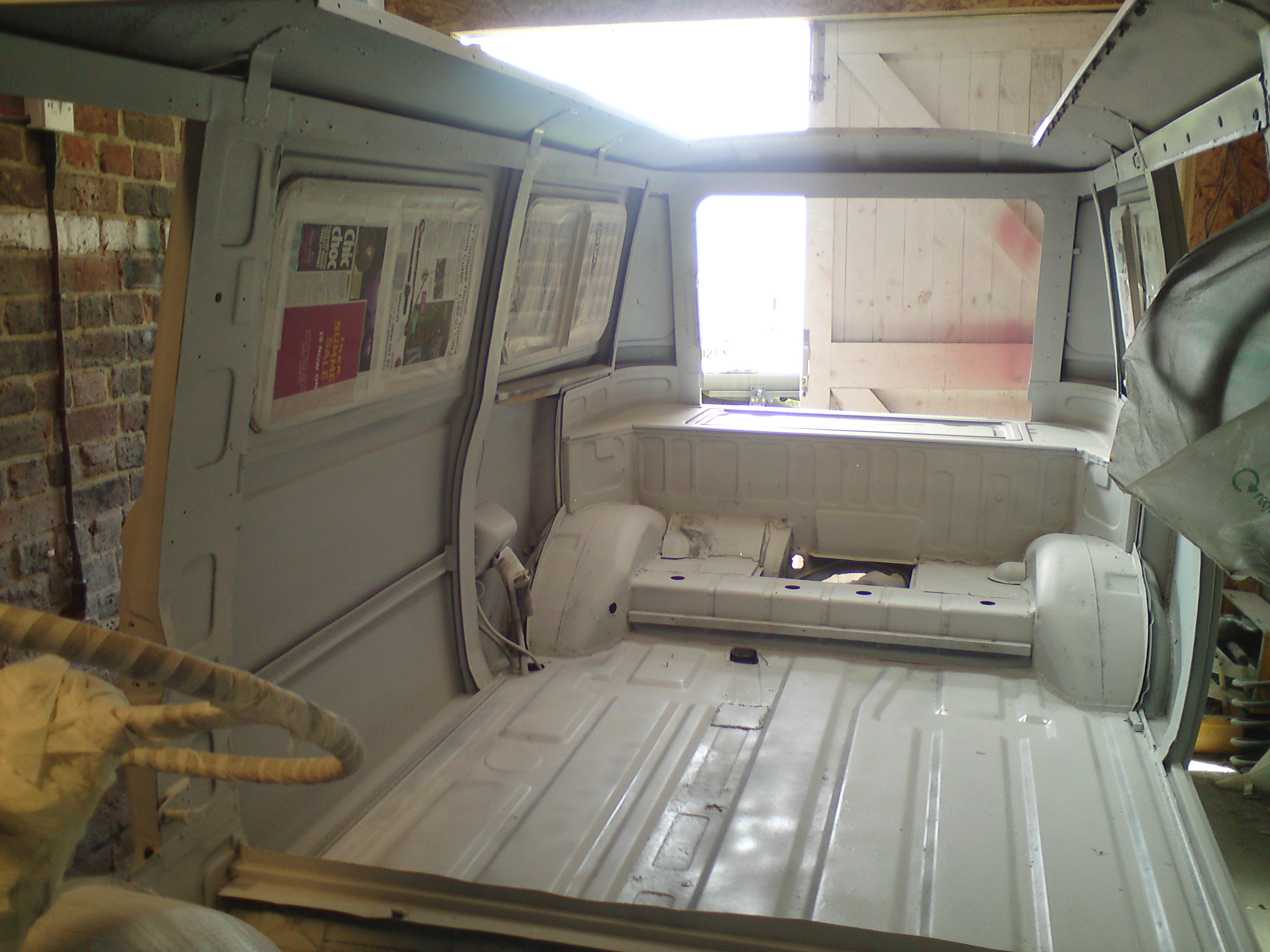

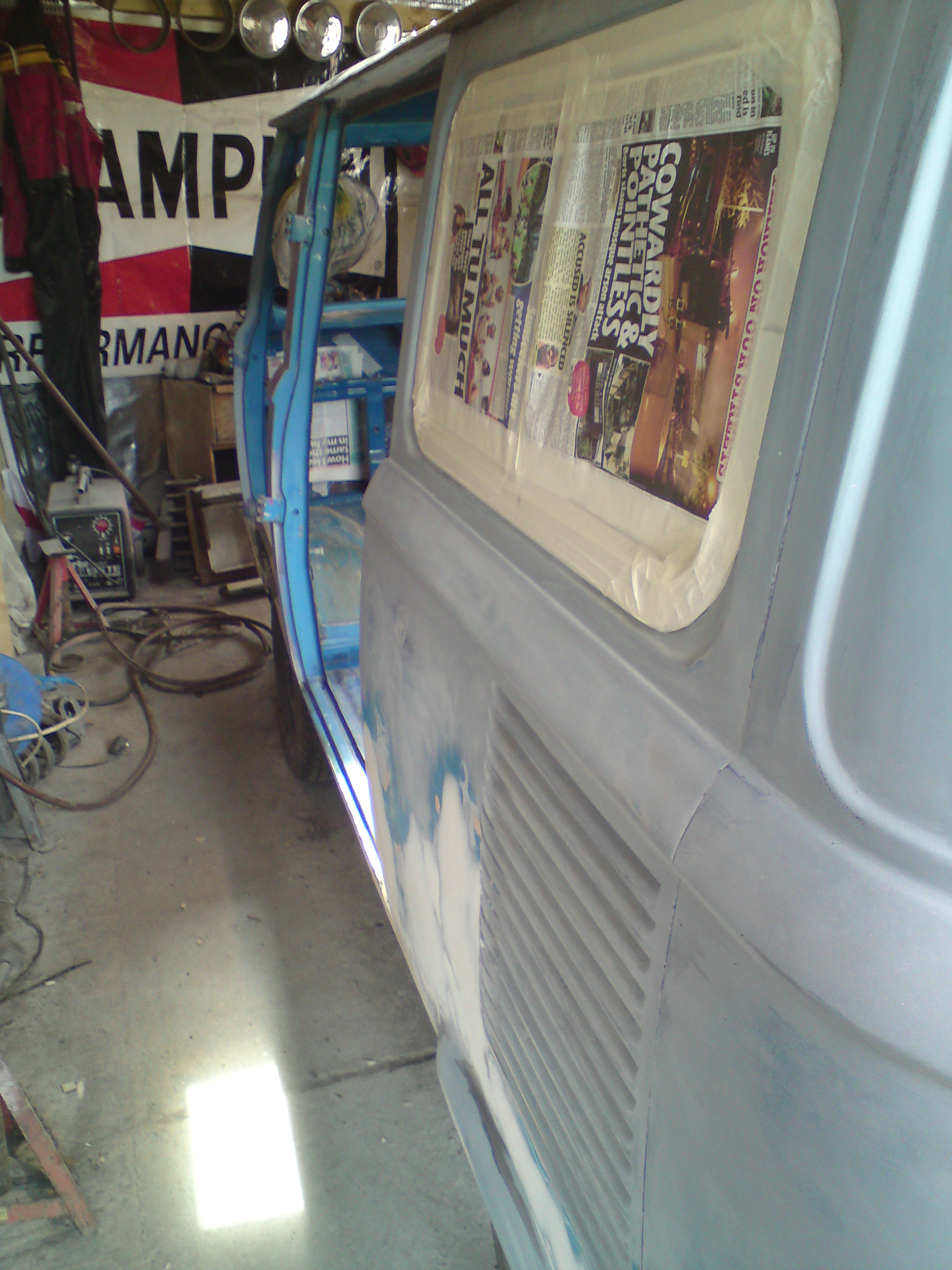

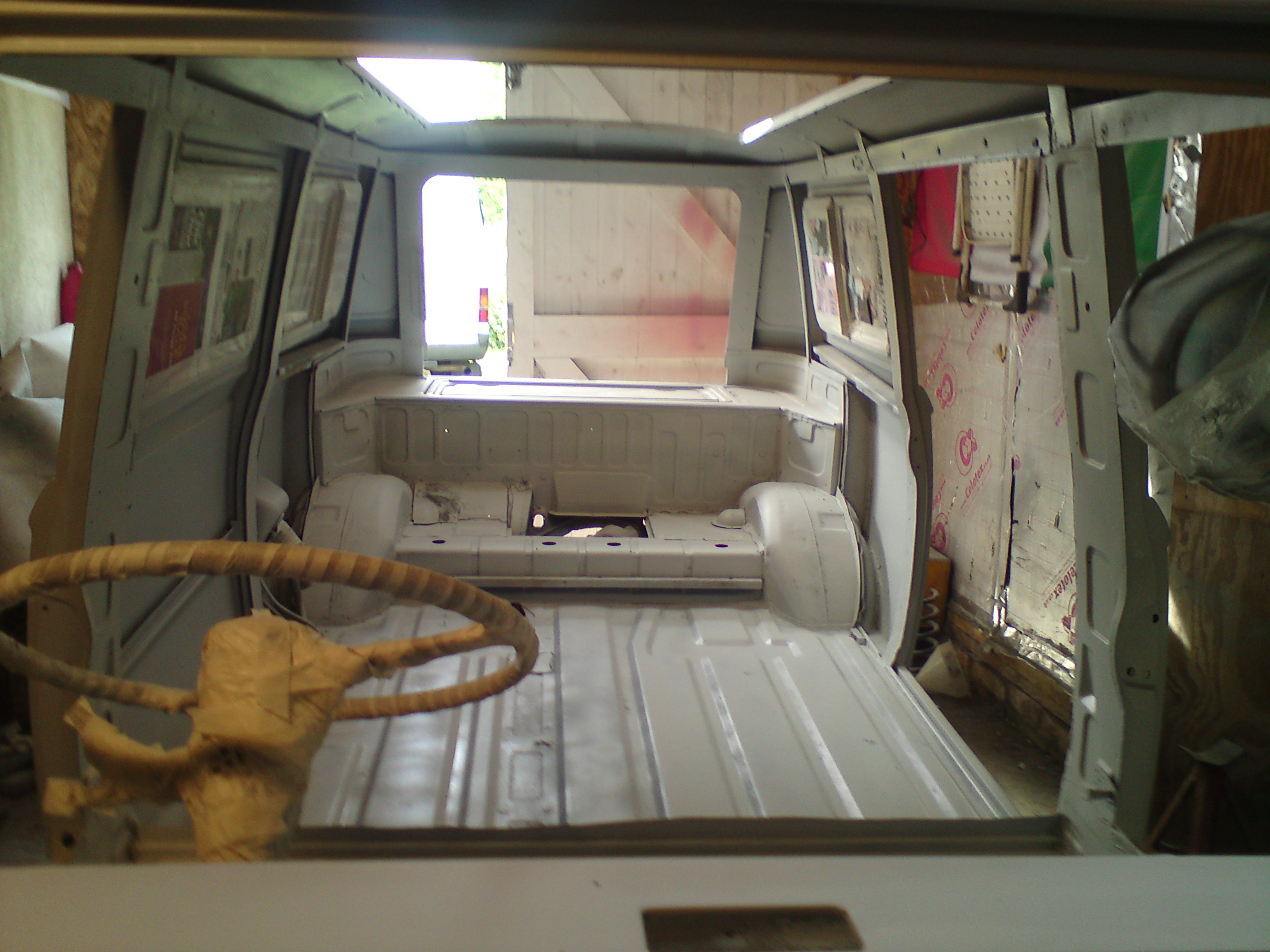

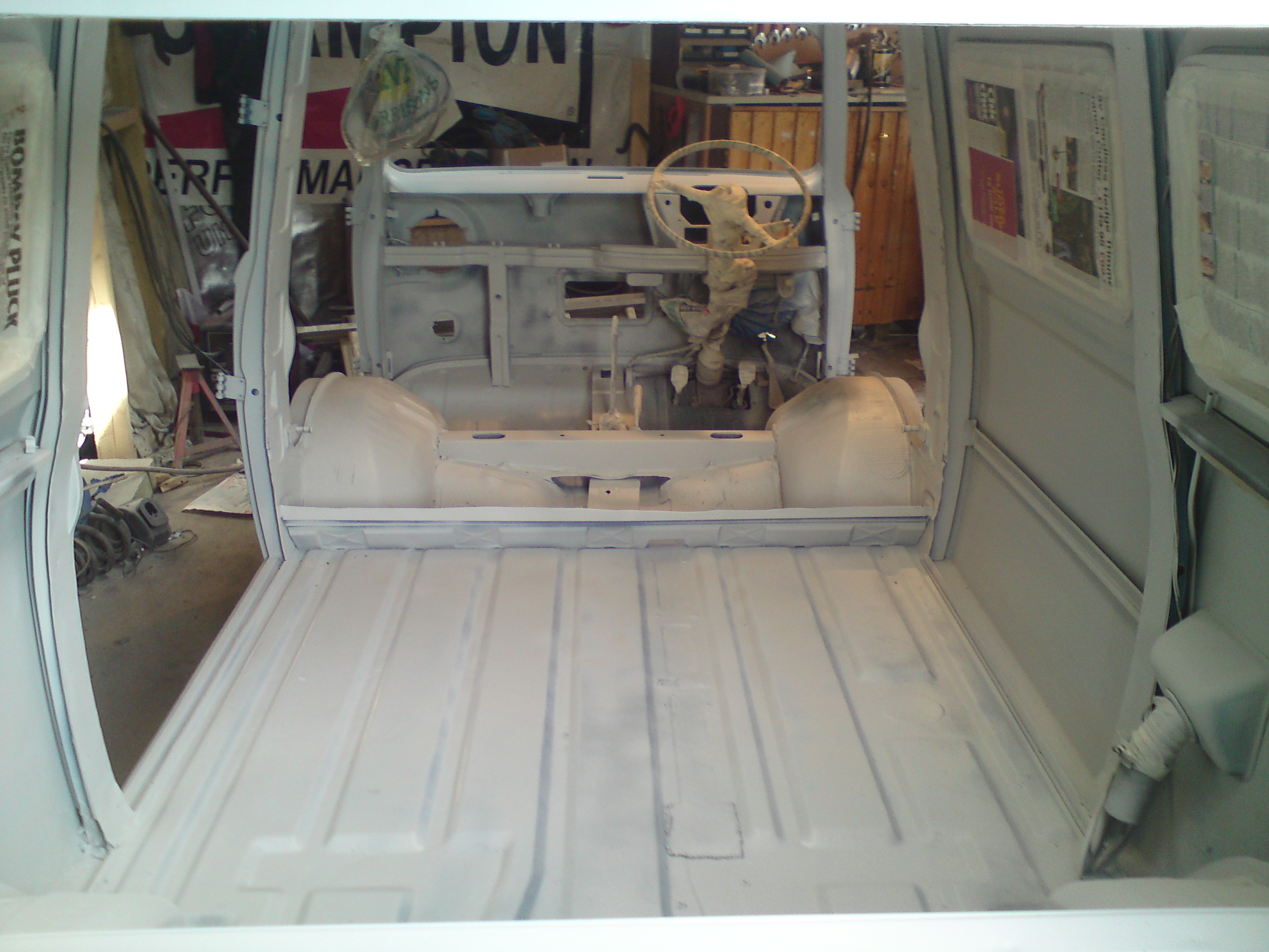

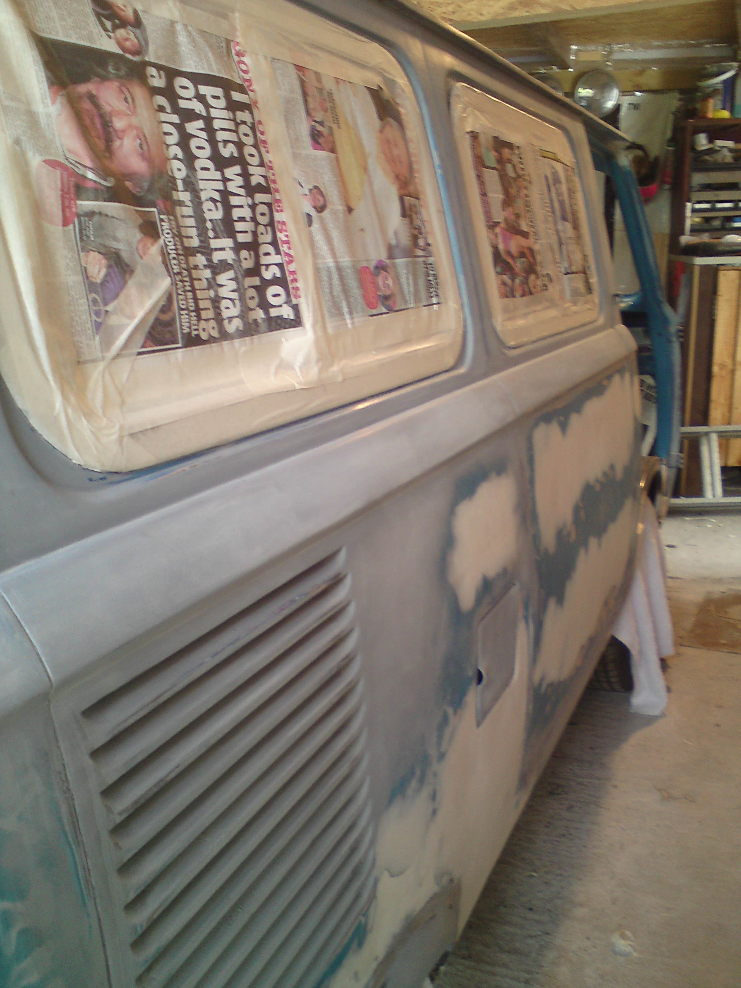

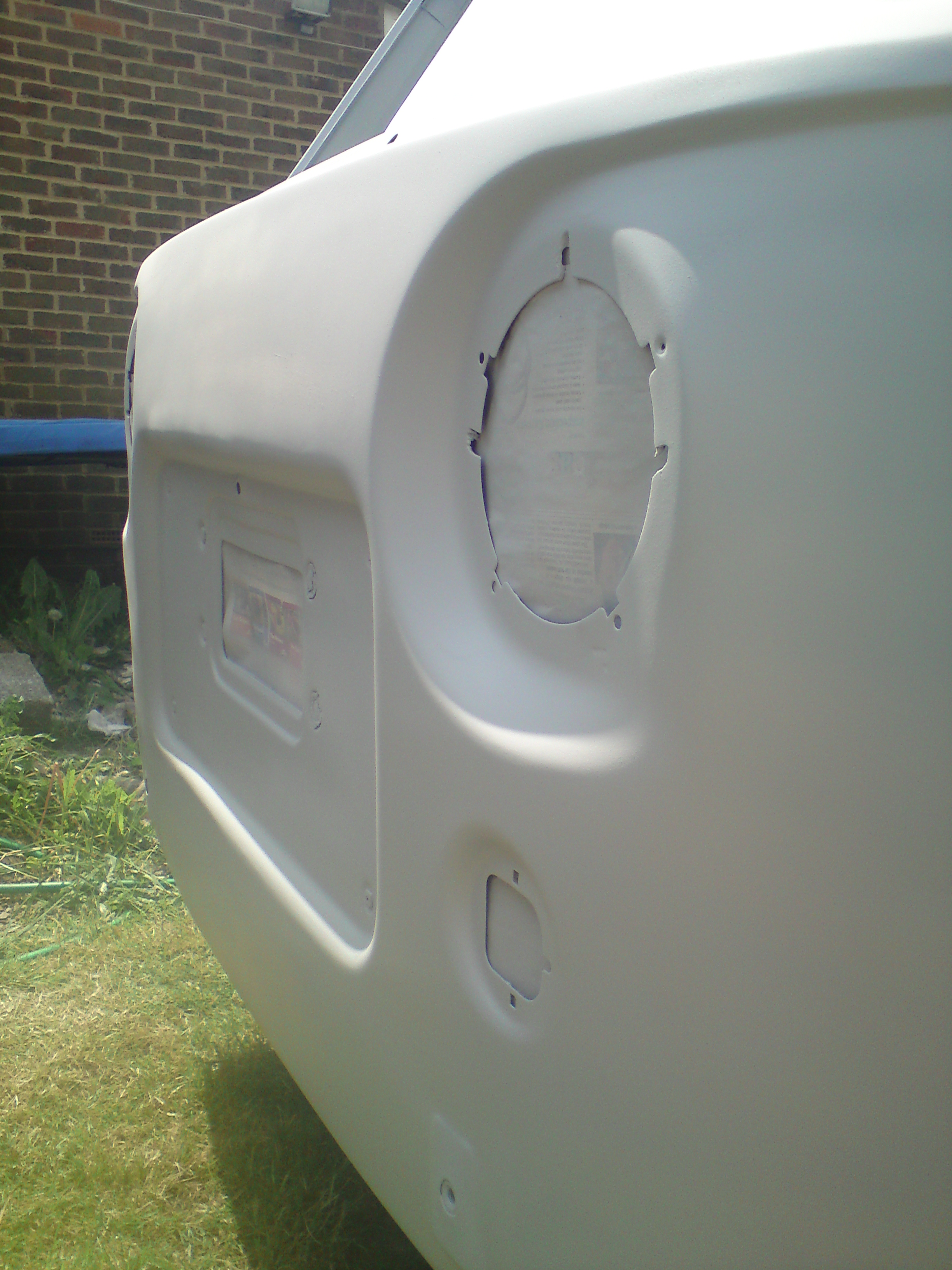

Been hard at it with the prepping of the bodywork, lots of fine filling done and the van is almost ready for paint!
i am hopeing to have the paintwork finished in 2 weeks, as i have a week of work. the paint has been ordered just waiting for the weather to warm up a little bit then i will crack on.

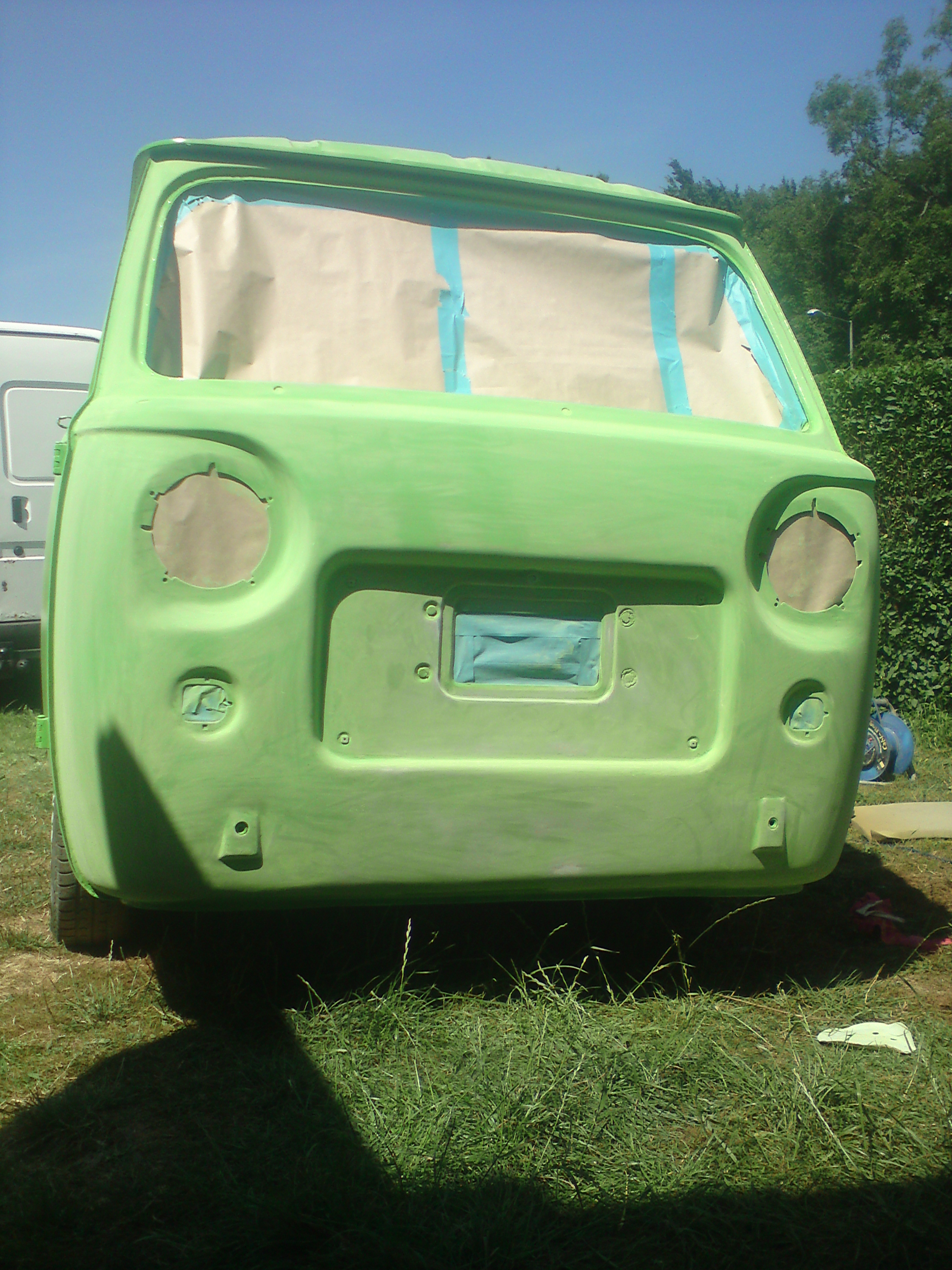

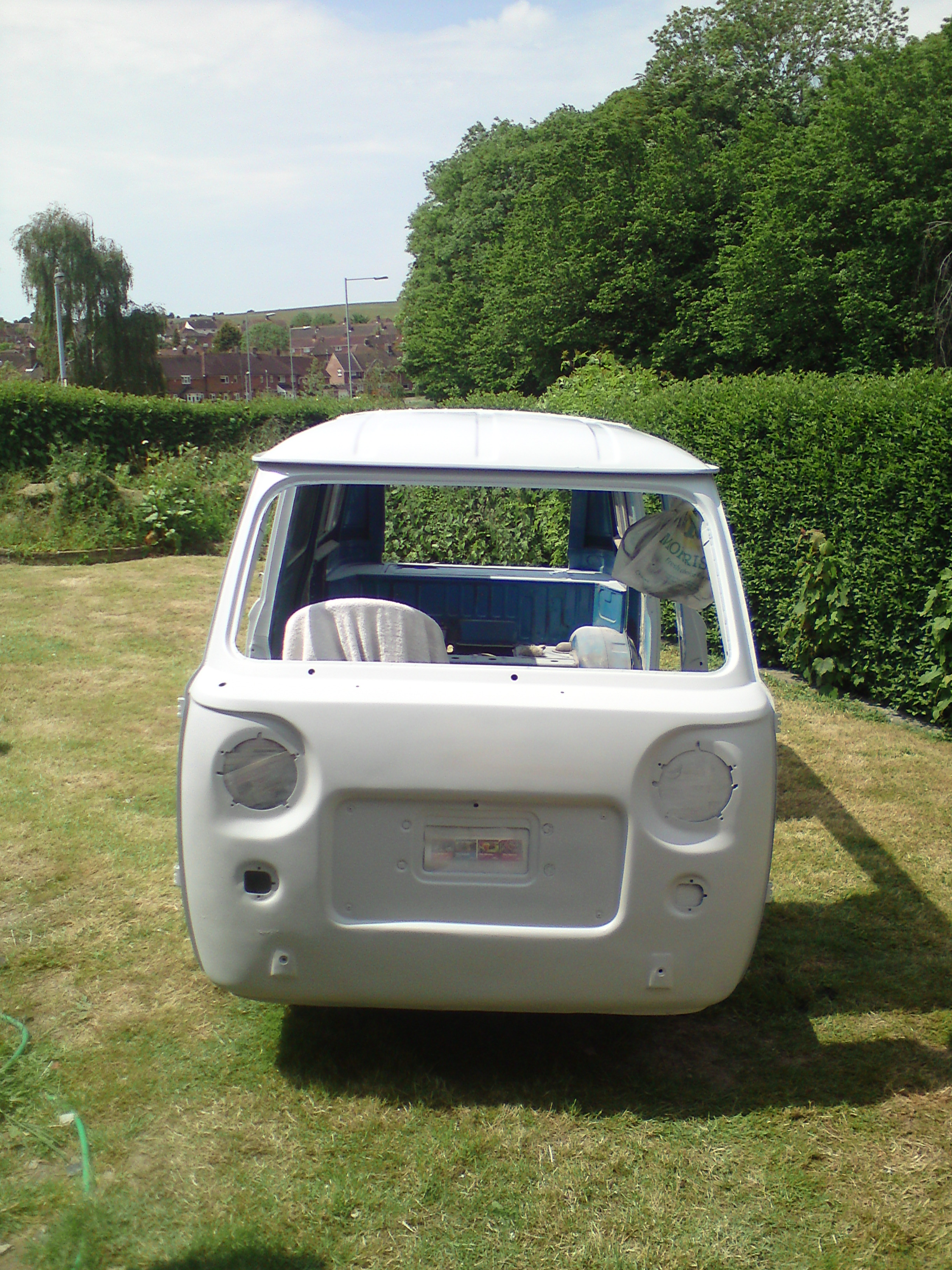

Well have some good news the van is finally sprayed!!!

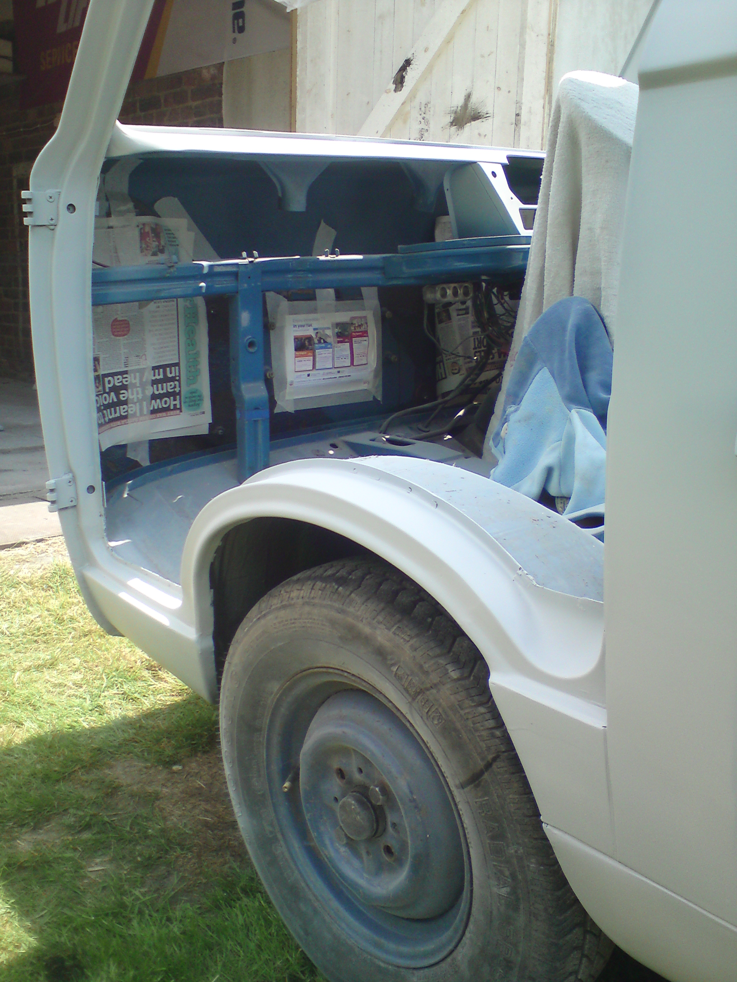

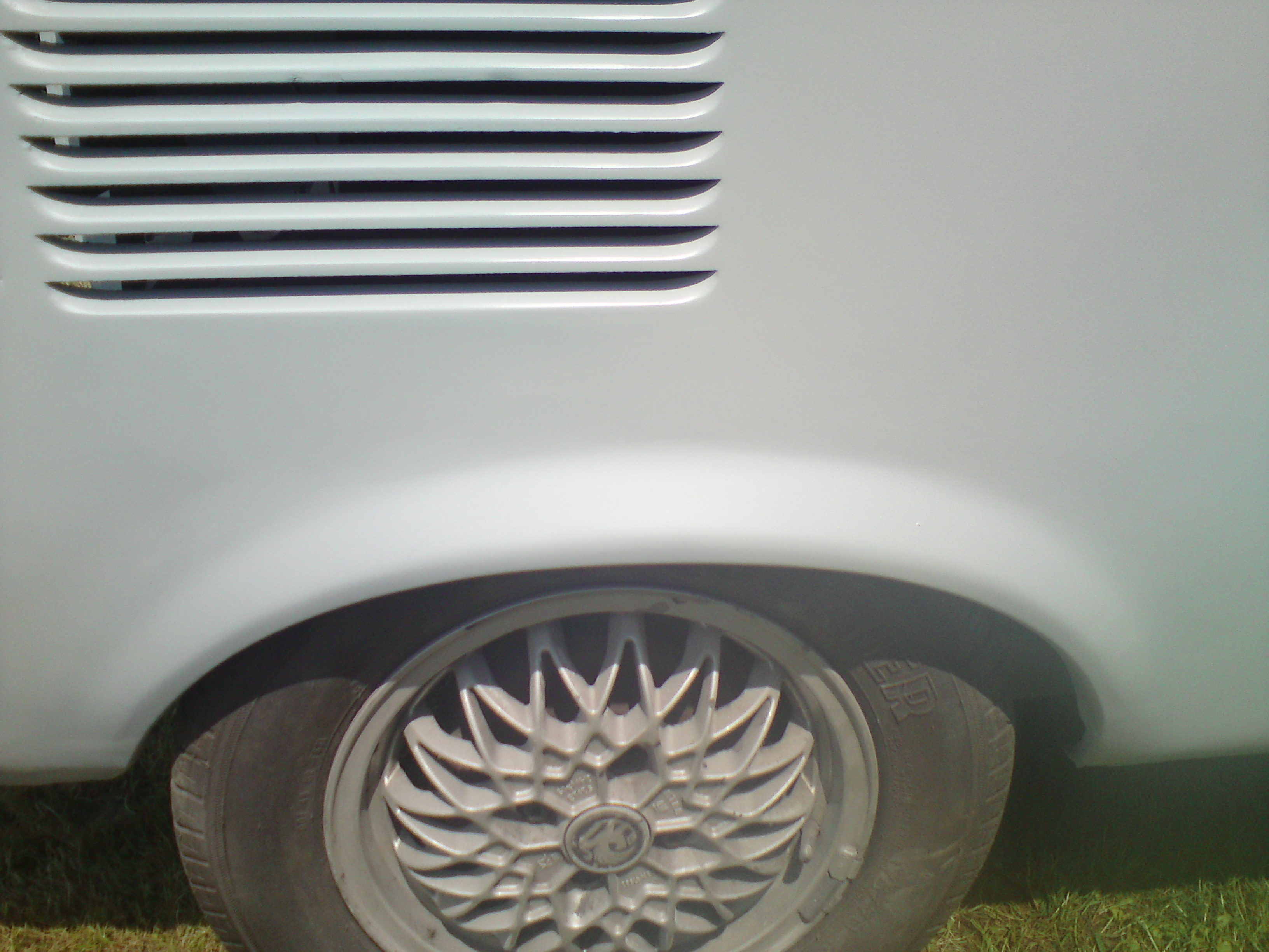

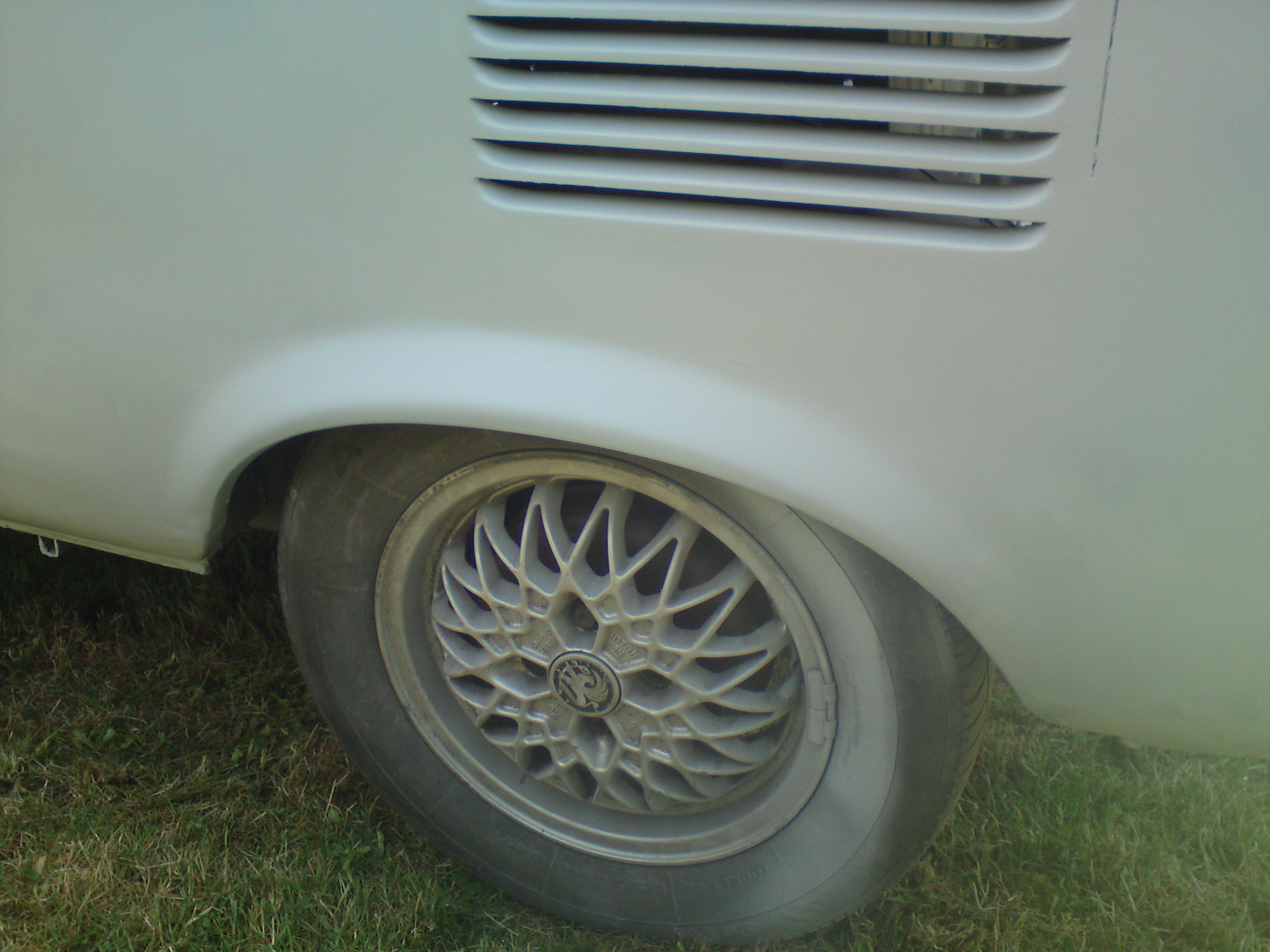

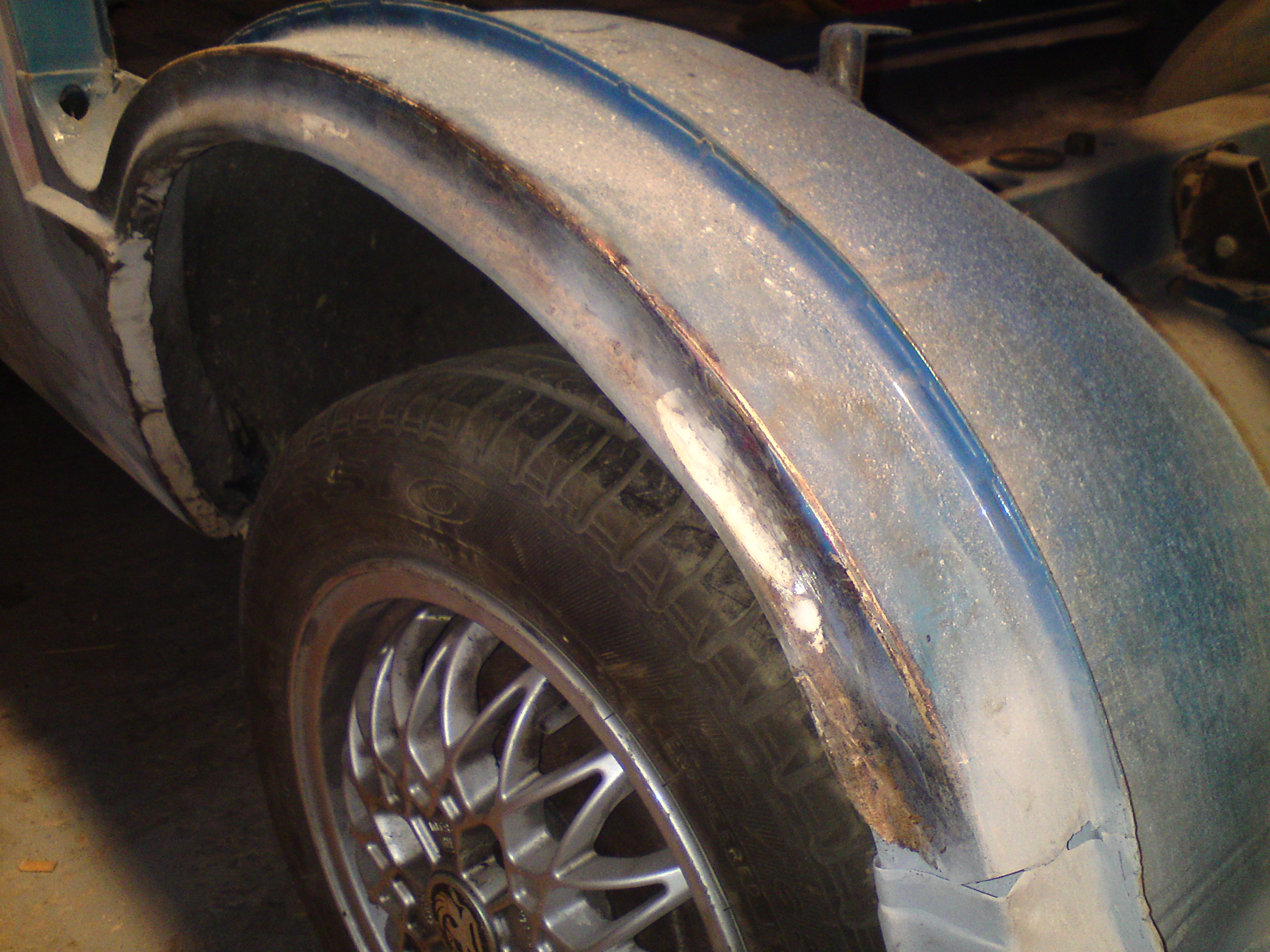

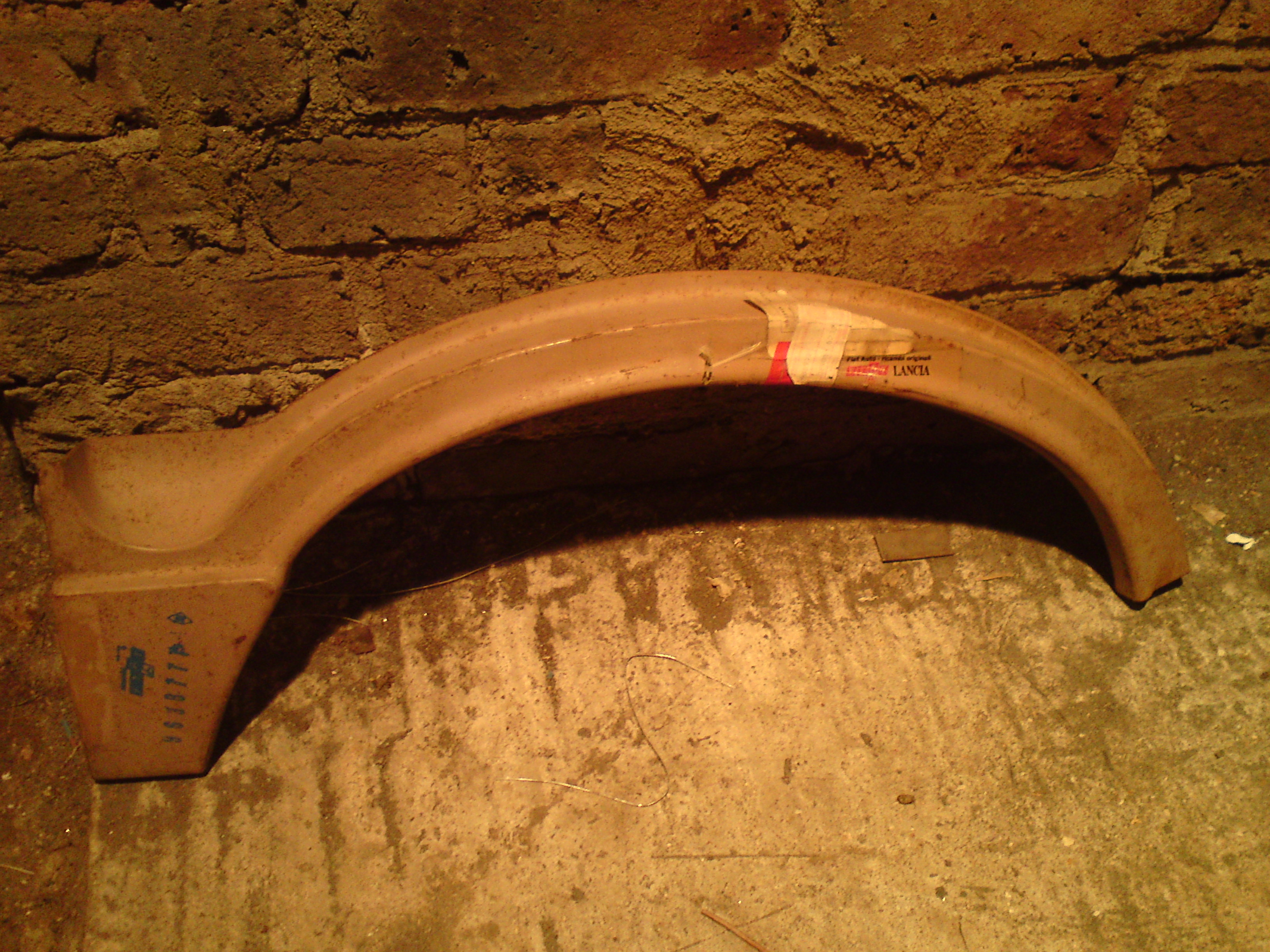

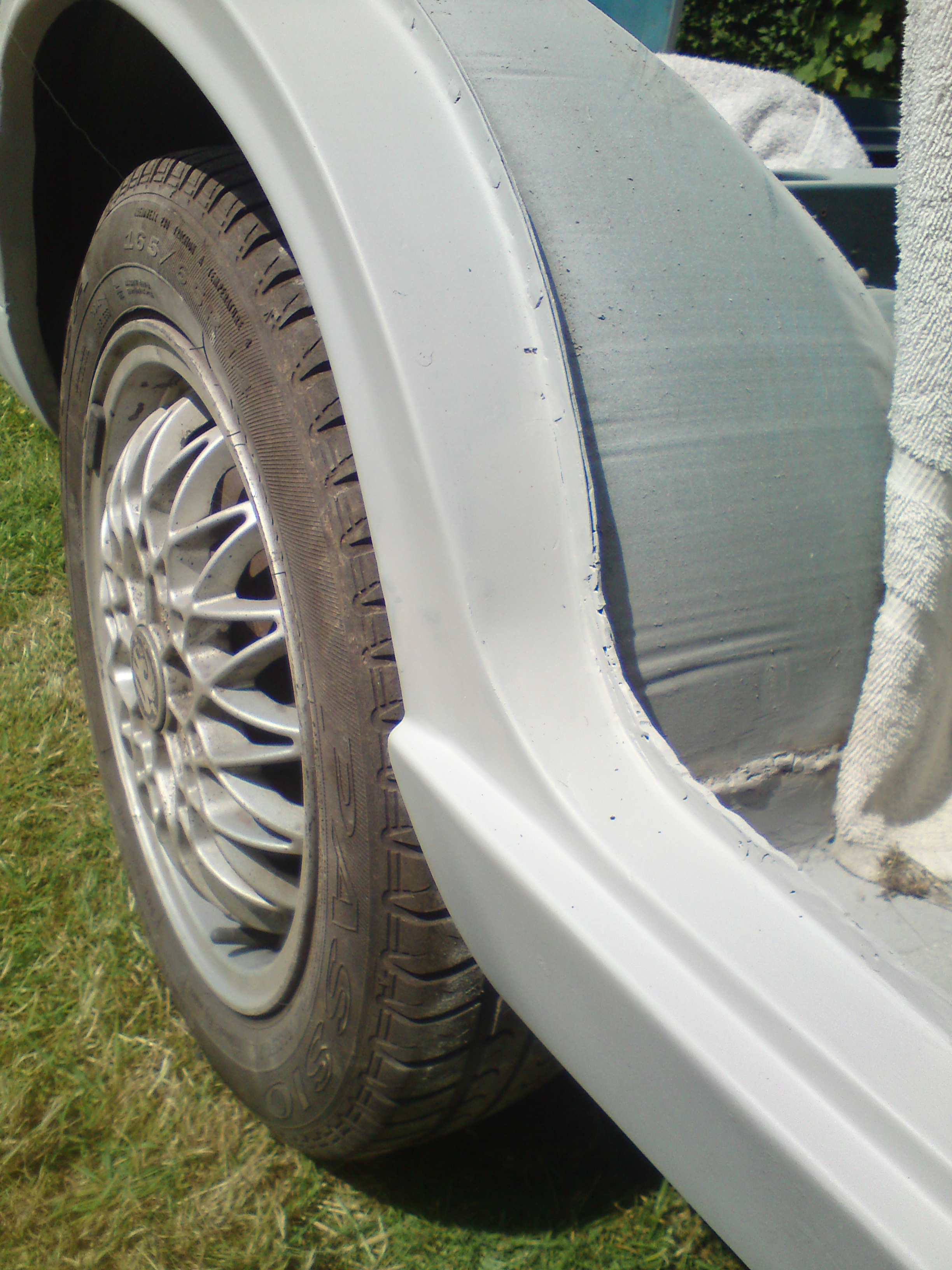

But before I could give the van its final prep and primer ( with the doors on ) I had decided to change the rear arches! was not happy with doing this but the capri arches were just to narrow and seriously limited my options for wheels in the future. I opted to use group 2 mini arches as they seemed a good fit and didnt cost too much.
Oh and I had a little bit of a problem half way through the spray job, I twisted my knee and had to do the last coat of paint with the aid of a knee brace and a crutch... not very easy but had no choice as I did not fancy flatting off the paint and re-doing the last couple of coats!
These are the new arches, not 100% sure on them atm, but they are growing on me.
Doors primed ready for fitting.
Doors fitted and 3rd and last coat of primer.
And here is my temporary boot support lol

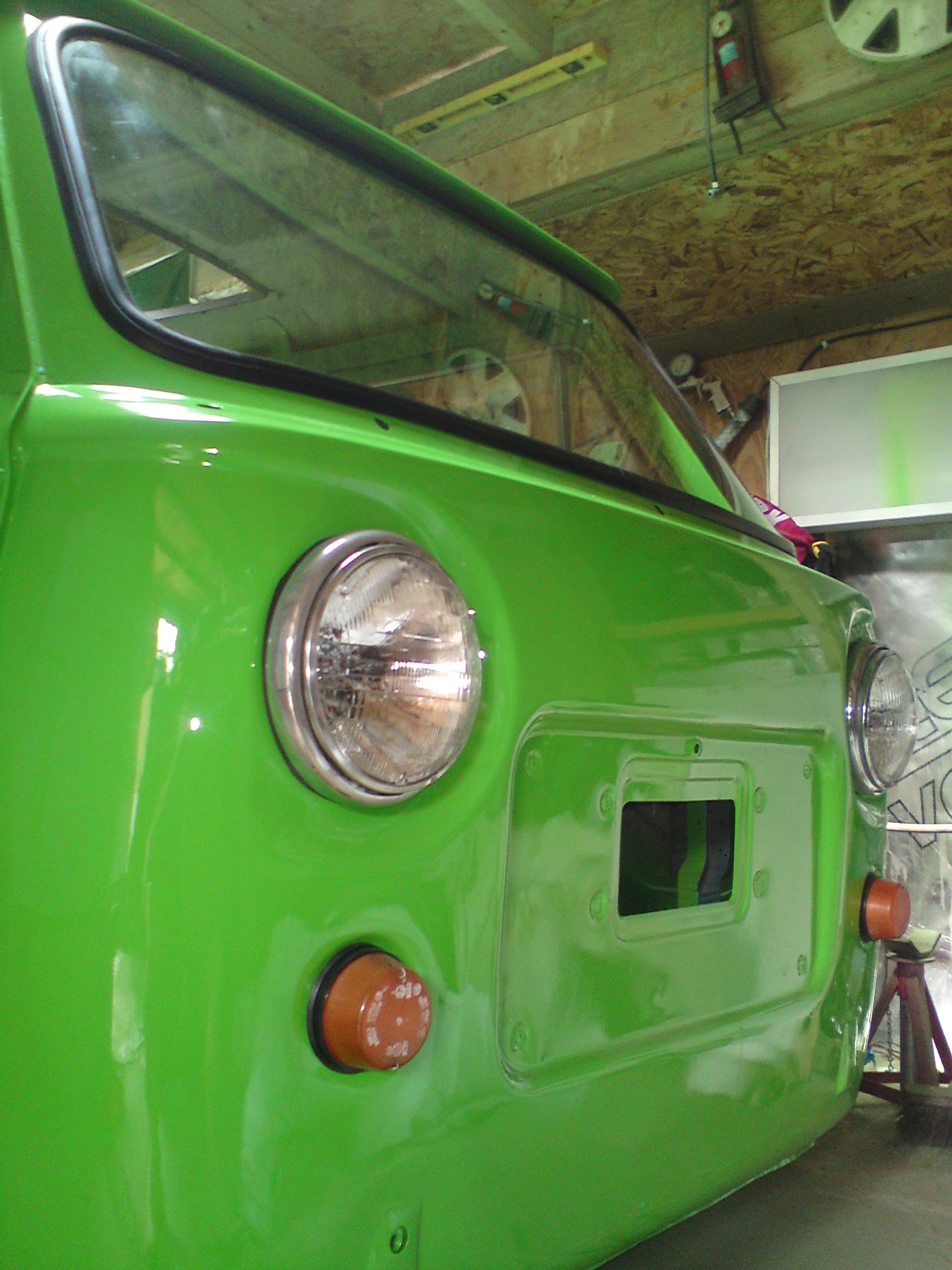

And here is the colour that I chose in the end...
Well there you go its certainly bright! I almost did the two tone brown and beige even bought the paint, but in the end I wanted something loud! and thats what I think I have ended up with lol.
Like I said the last coat was put on while I was in quite alot of pain, but I NEEDED to be finished and (although I need to see it in the daylight ) I am more than happy with the colour and the spray job.

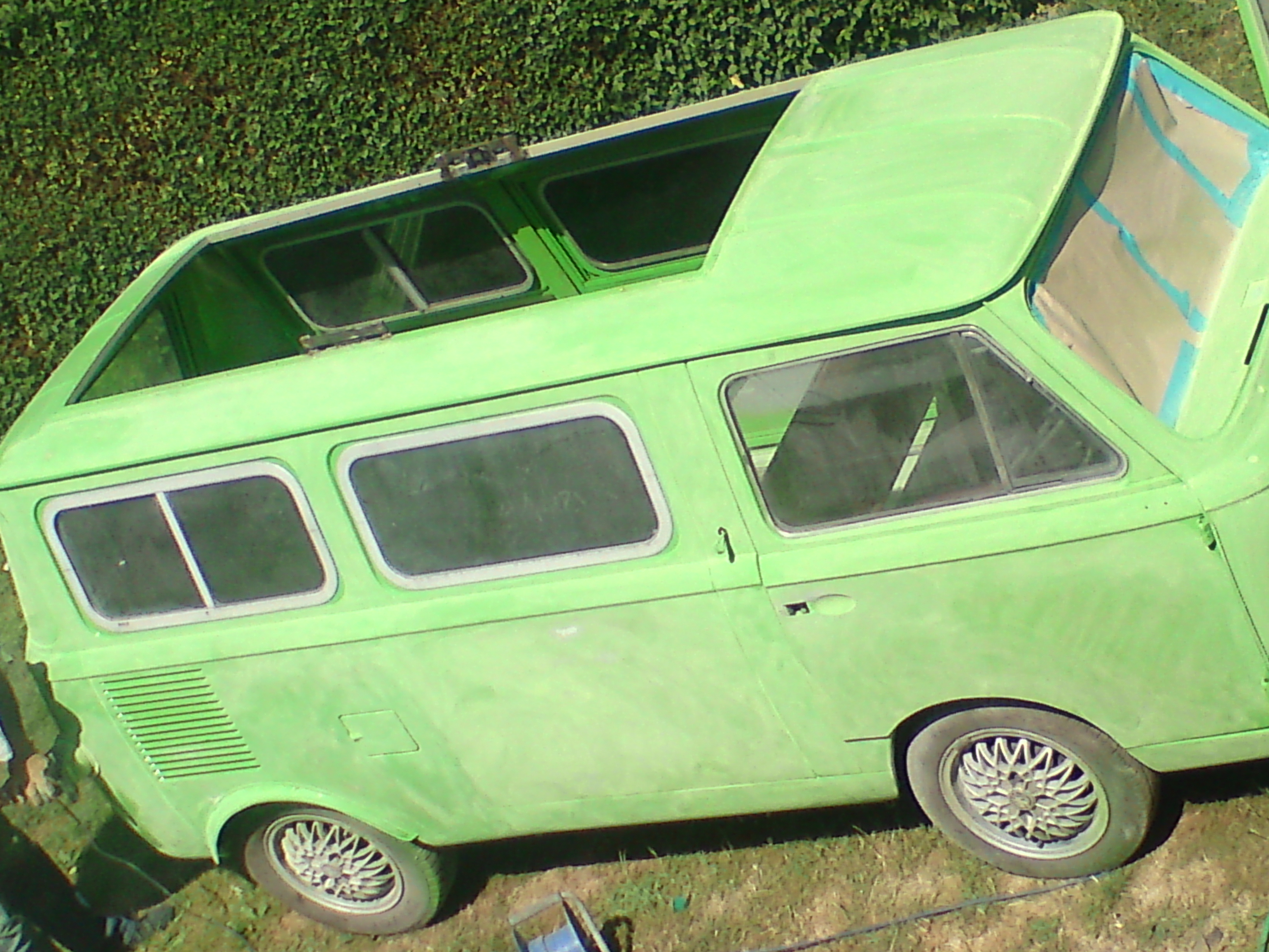

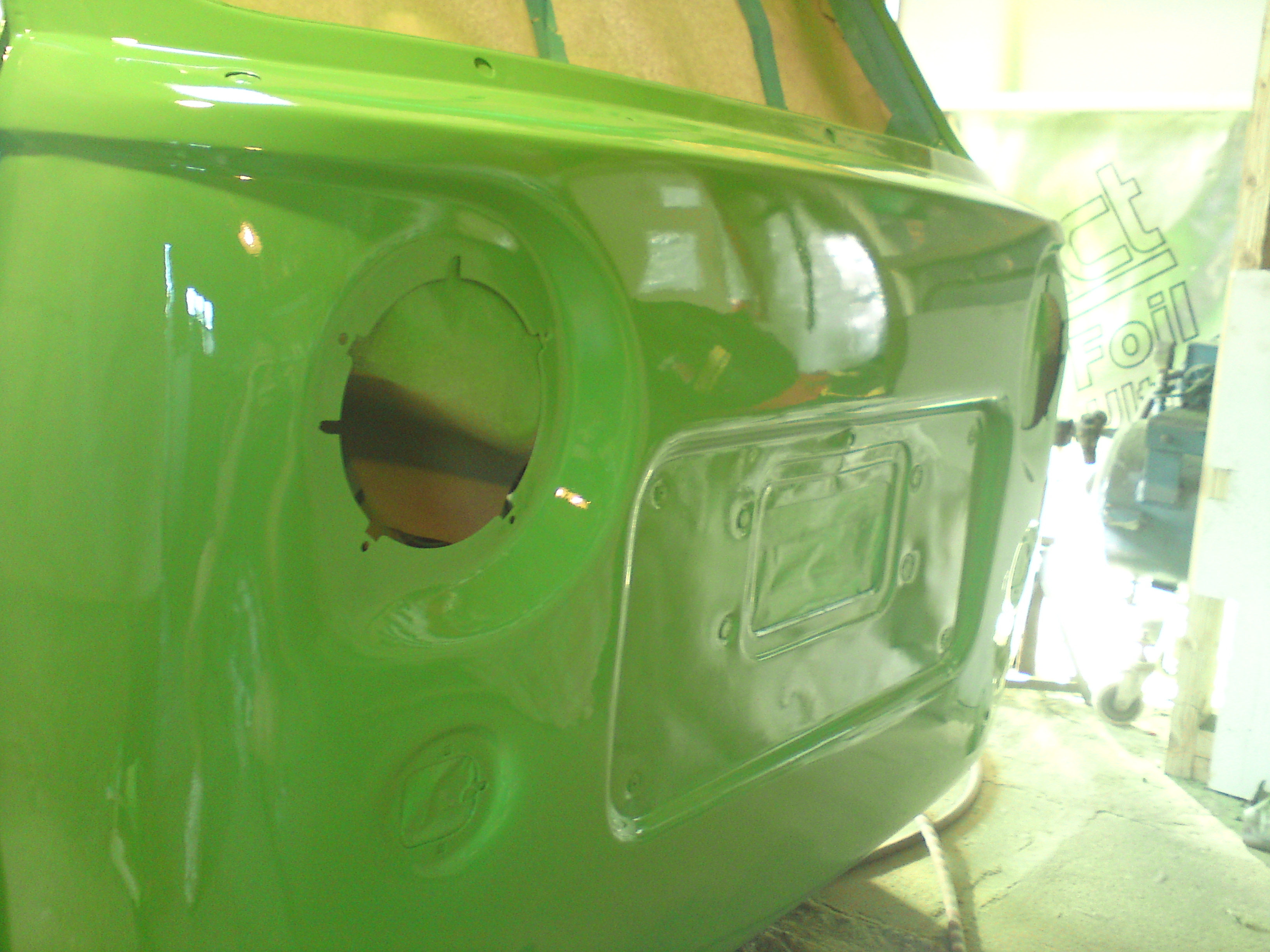

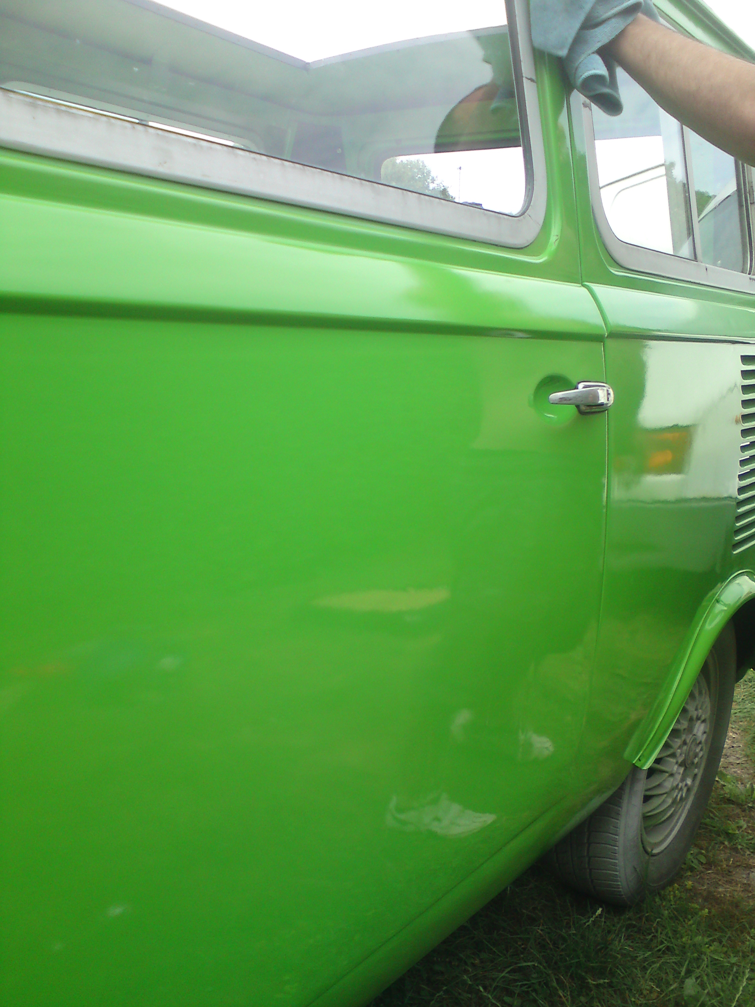

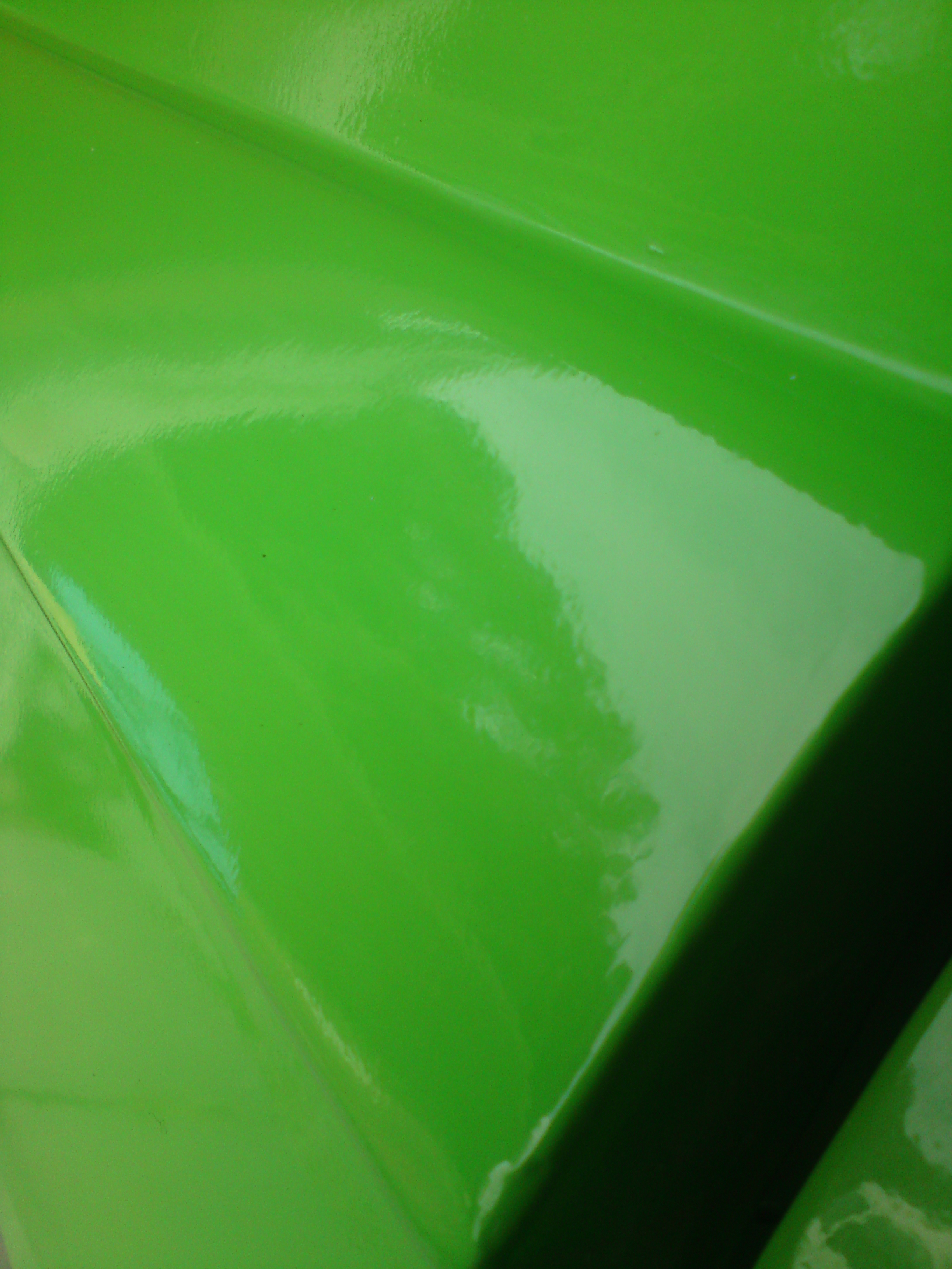

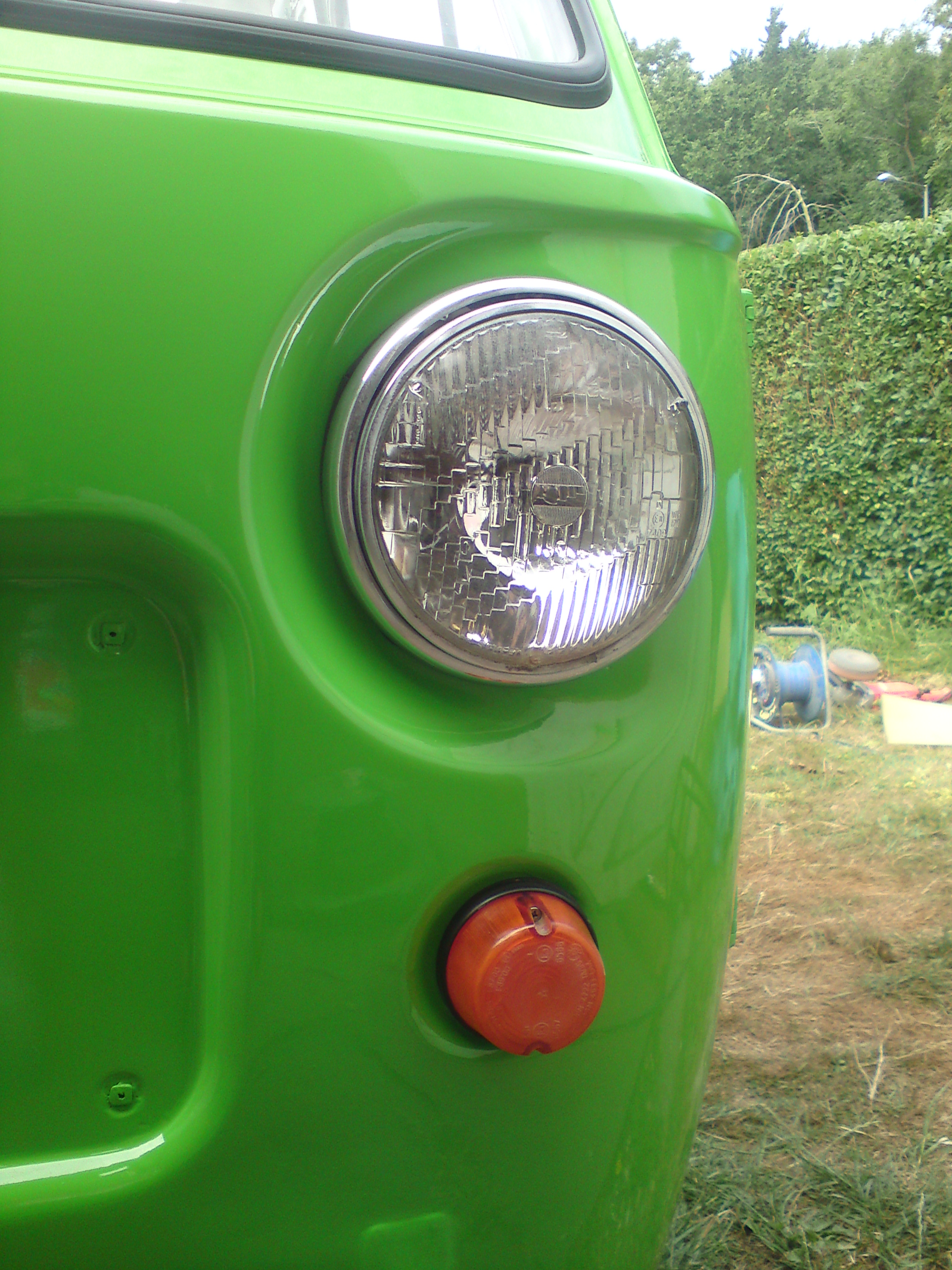

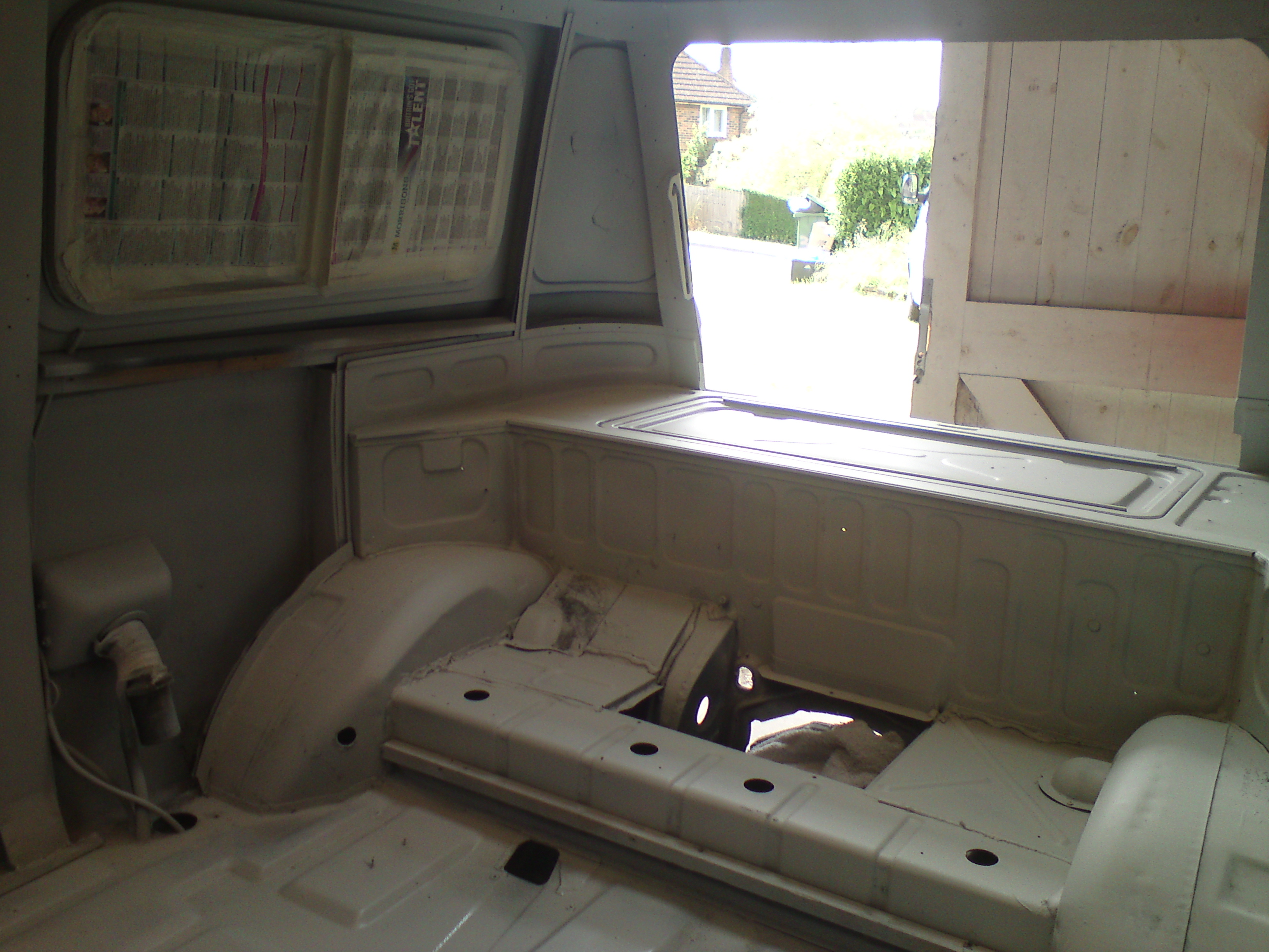

Hello little bit of an update on the van, I decided after seeing the van out in the sun that I was not happy with the finish of the paint, so spent one of the hottest days of the year flatting back and prepping again ready for another crack at getting a better finish. (y)
The last one shows that I managed to get a lot better finish the second time round, its not perfect but for a job done in a small dusty garage with a compressor that's older than me it will do! got my friend coming to polish it up over the weekend so that will hopefully be the last of the paint work.

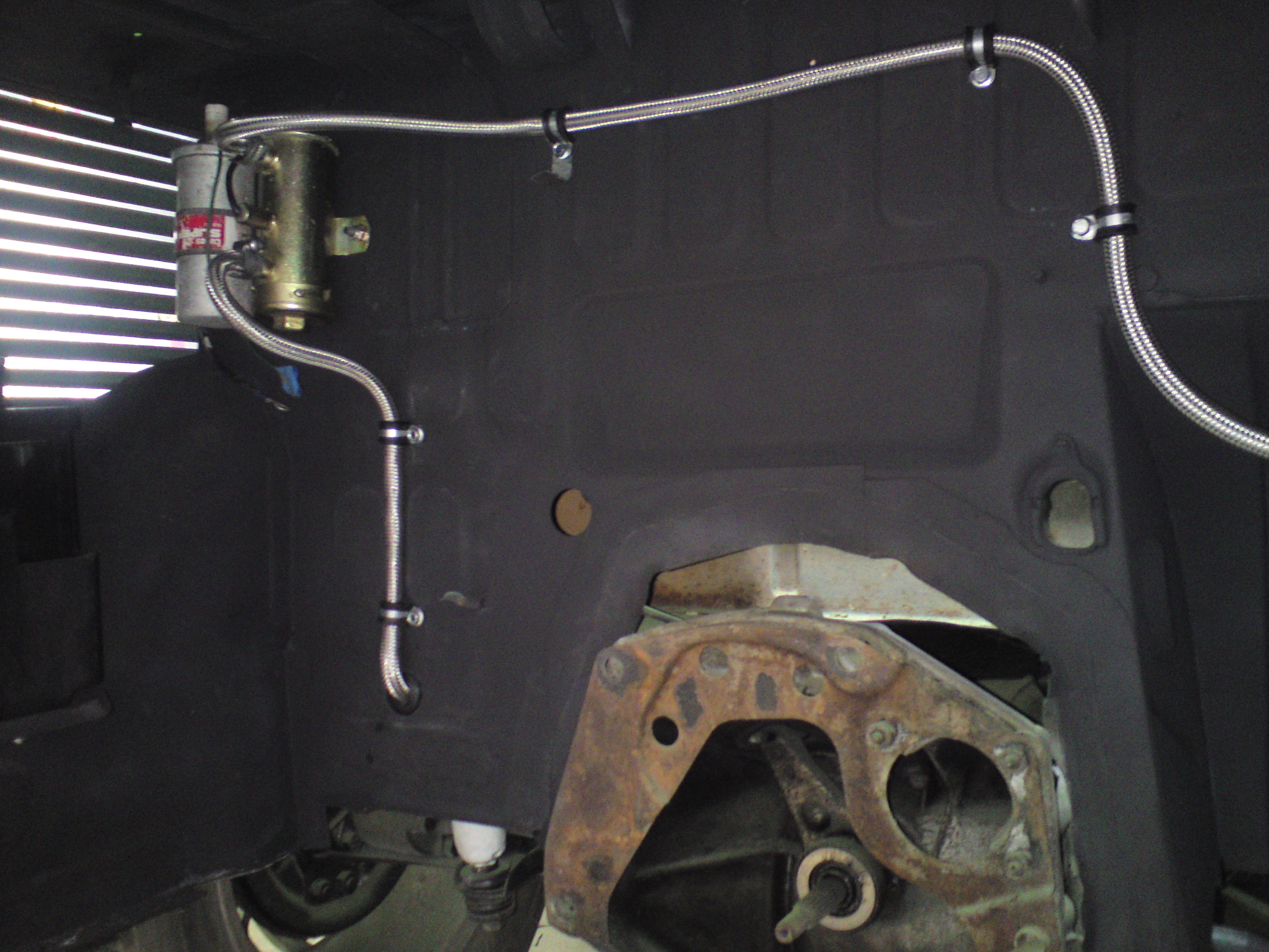

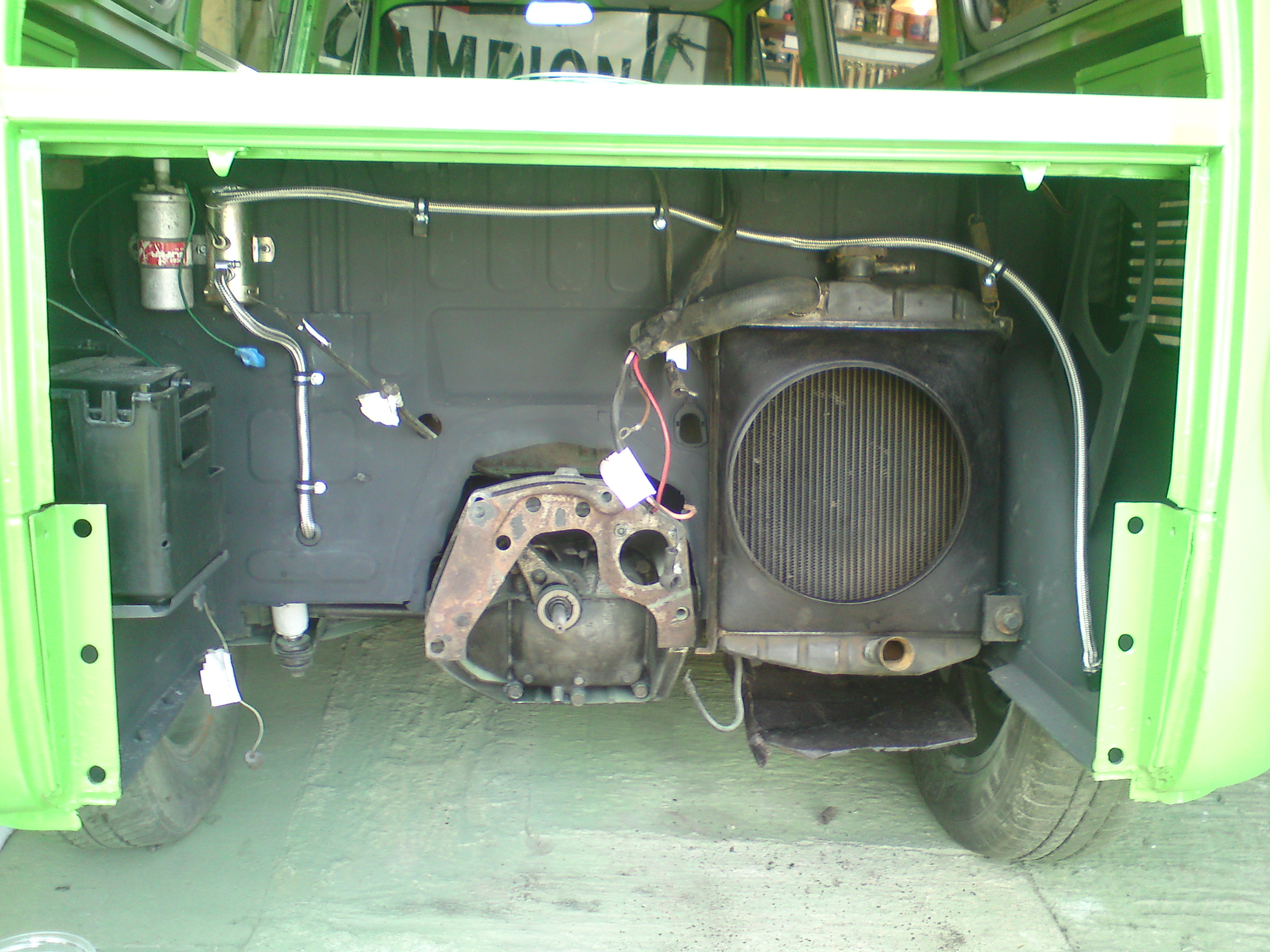

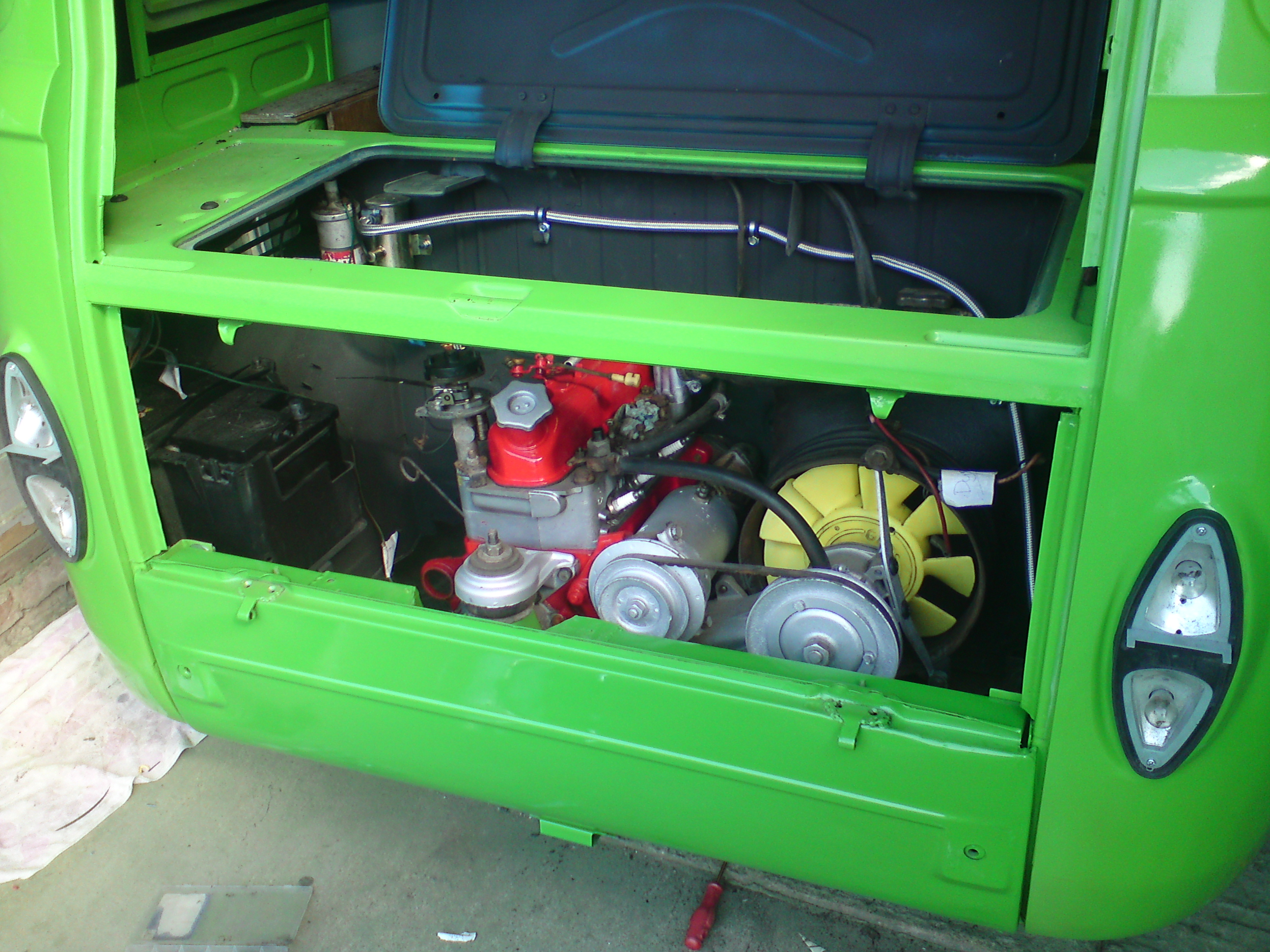

I have also painted the engine bay black and started fitting little bits back on, which I am really enjoying after all the welding and messy jobs.
Electric fuel pump with the coil + braided hoses and battery box from a ford puma! it is starting to look nice and tidy.

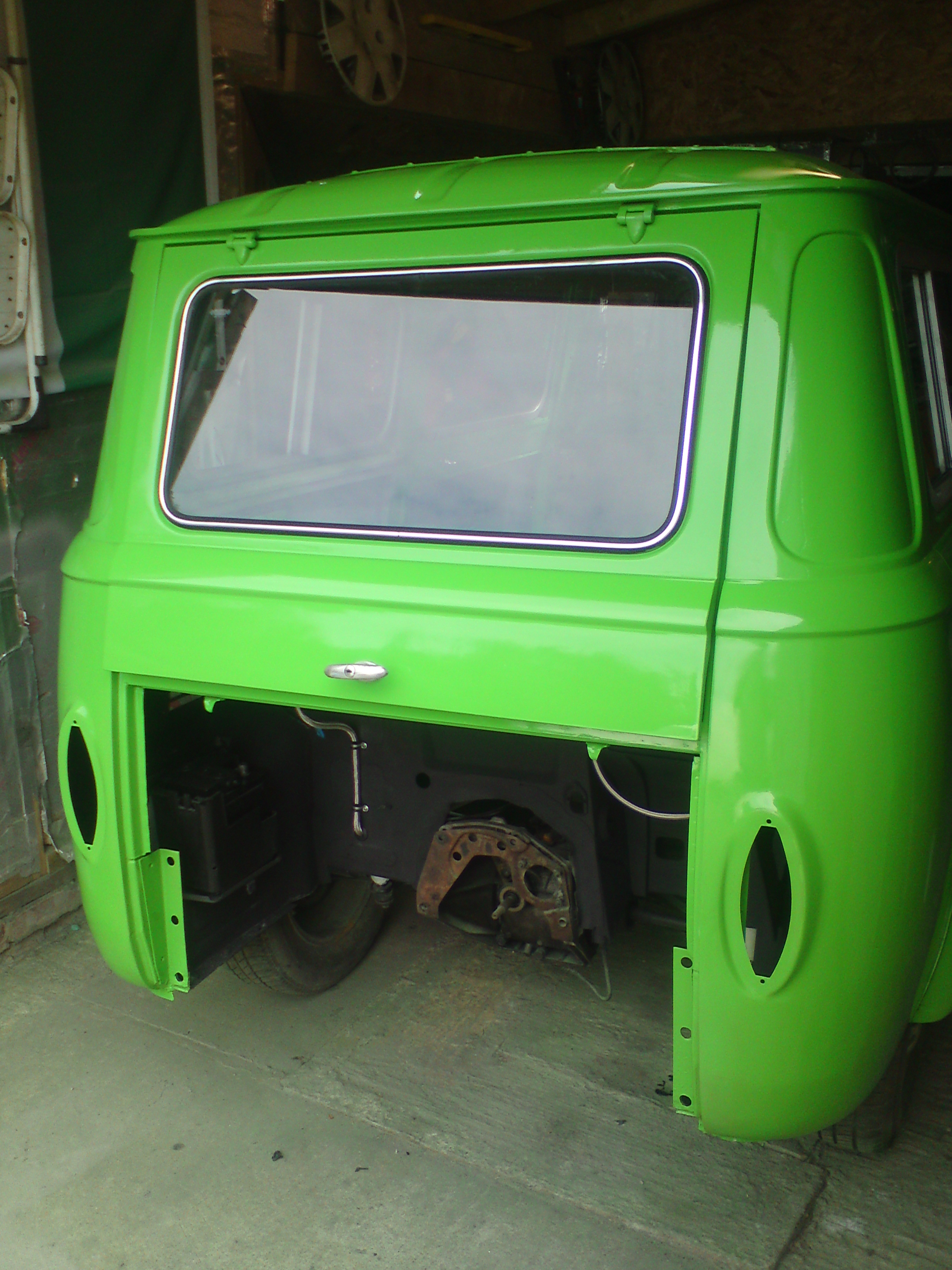

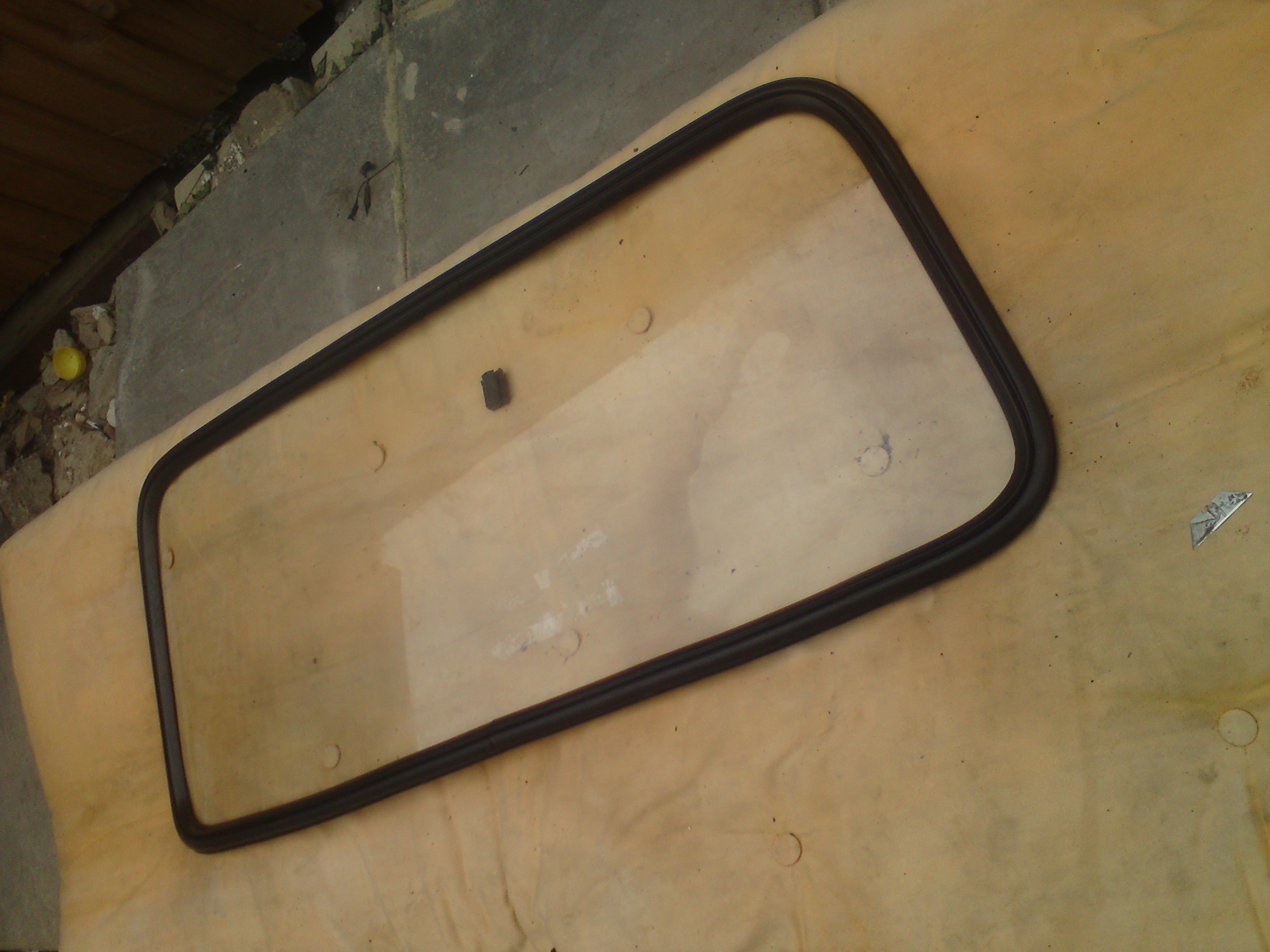

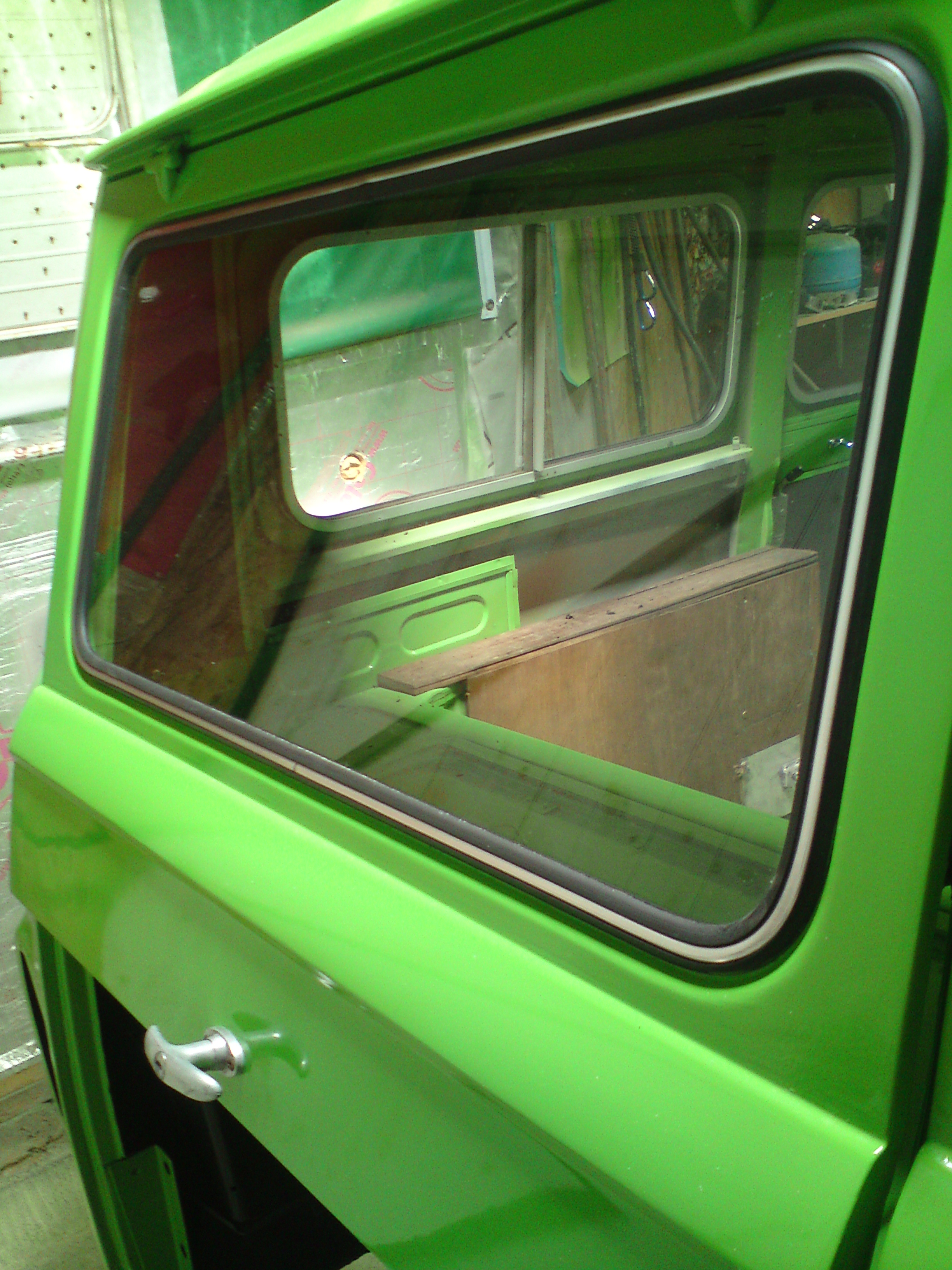

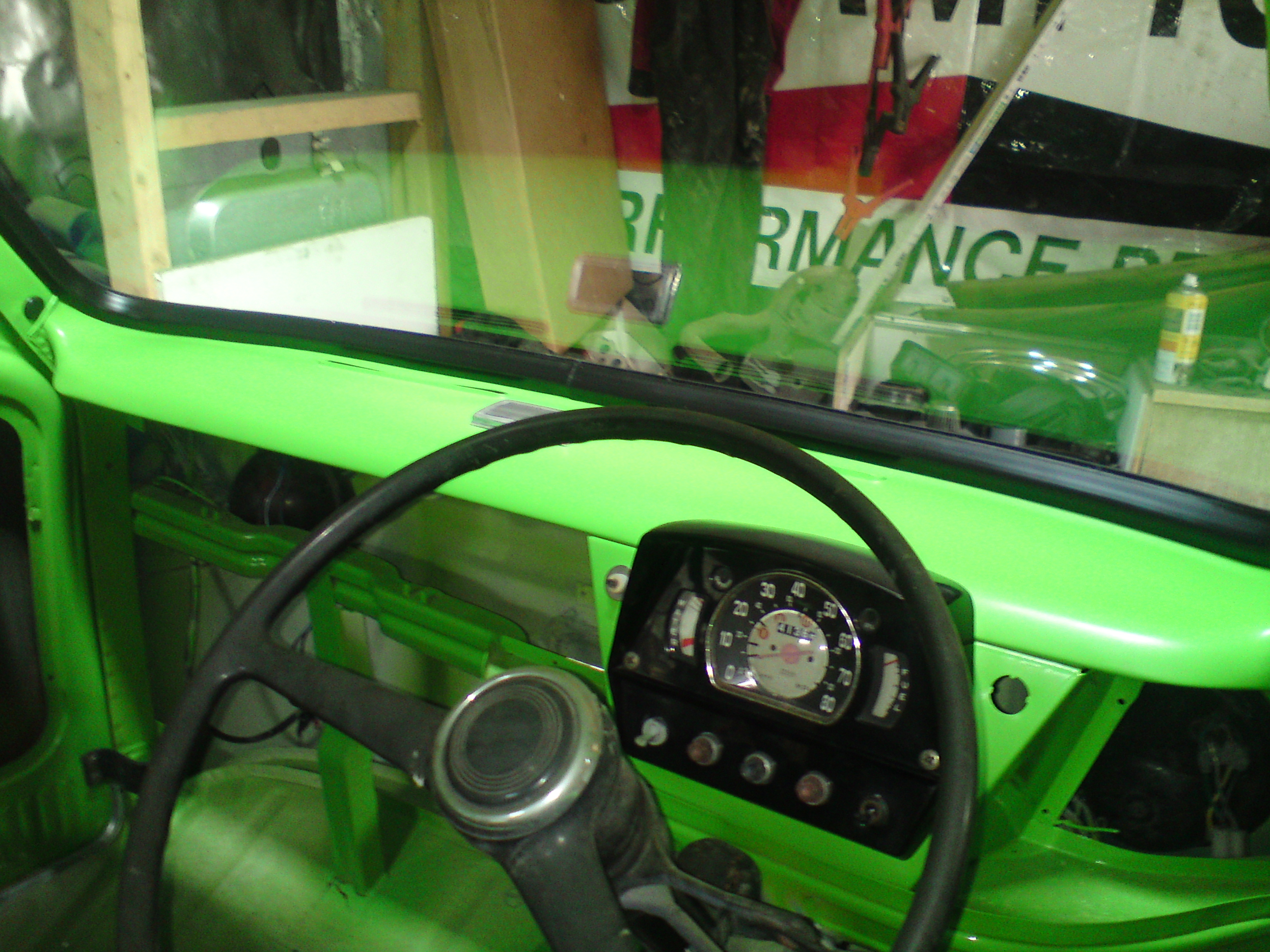

Been dreading this job! had to get a universal seal and struggle like hell to fit the window.
Took me and my friend 2 hours of head scratching and tea drinking but we got there in the end.
New chrome filling strip for the back window.

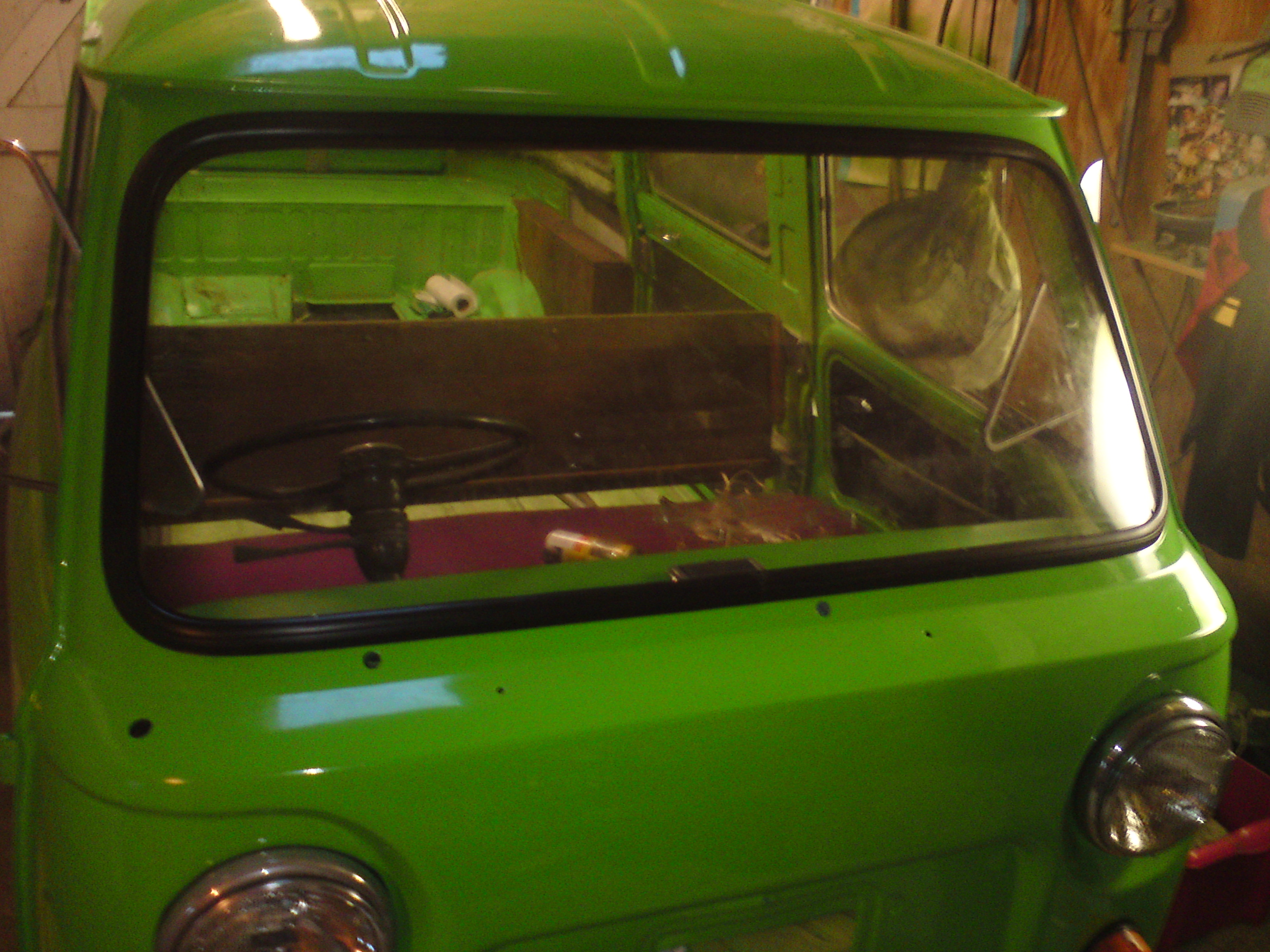

And 'Roxy' now has her face back on!!!
Door locks, dash instrument panel, door trim all back on, and I have got rid of that limo black window tint.
So over the next week I will carry on refitting all the boxes of bits that I have, the engine should hopefully be in in a couple of weeks time :D.

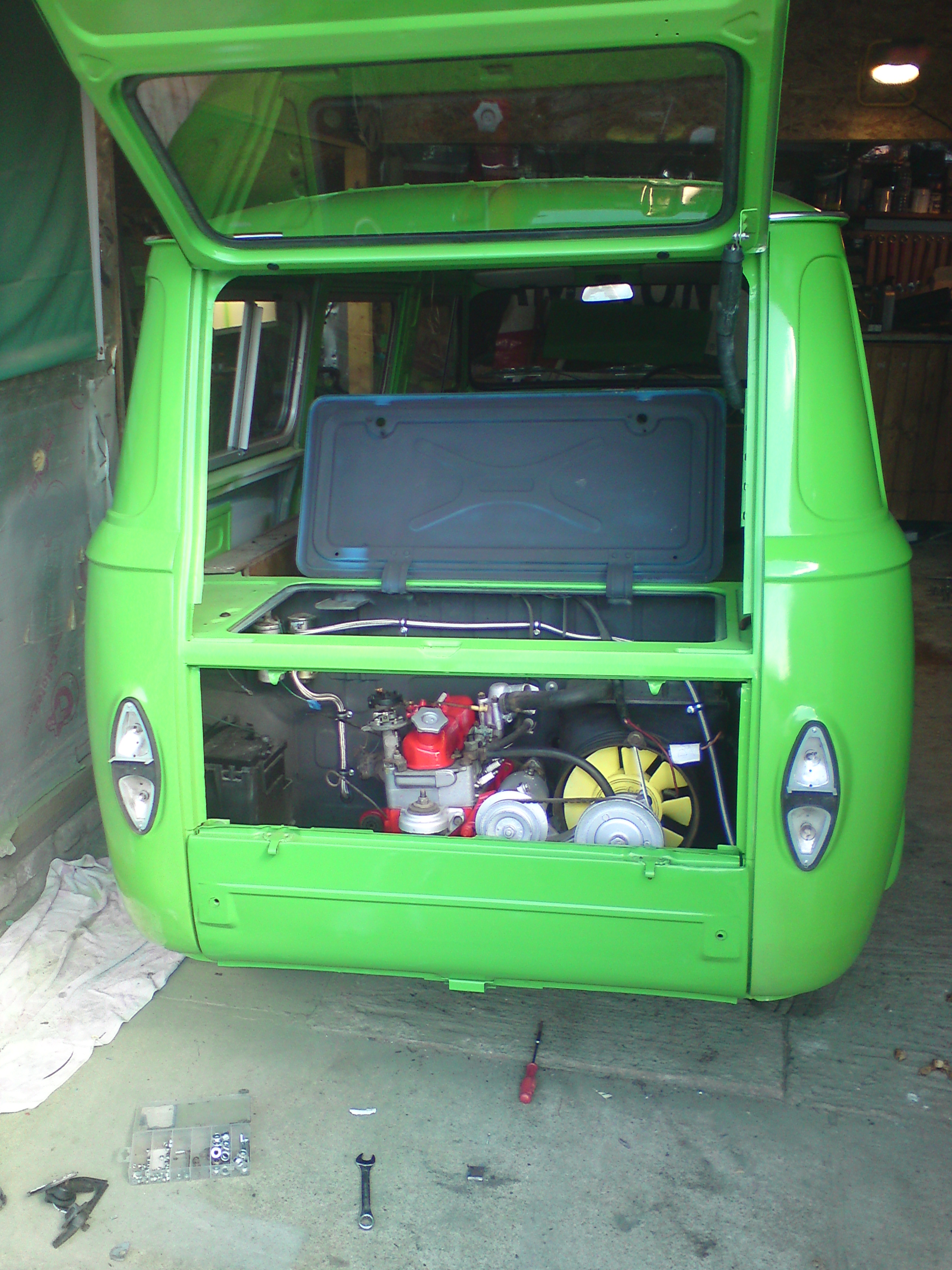

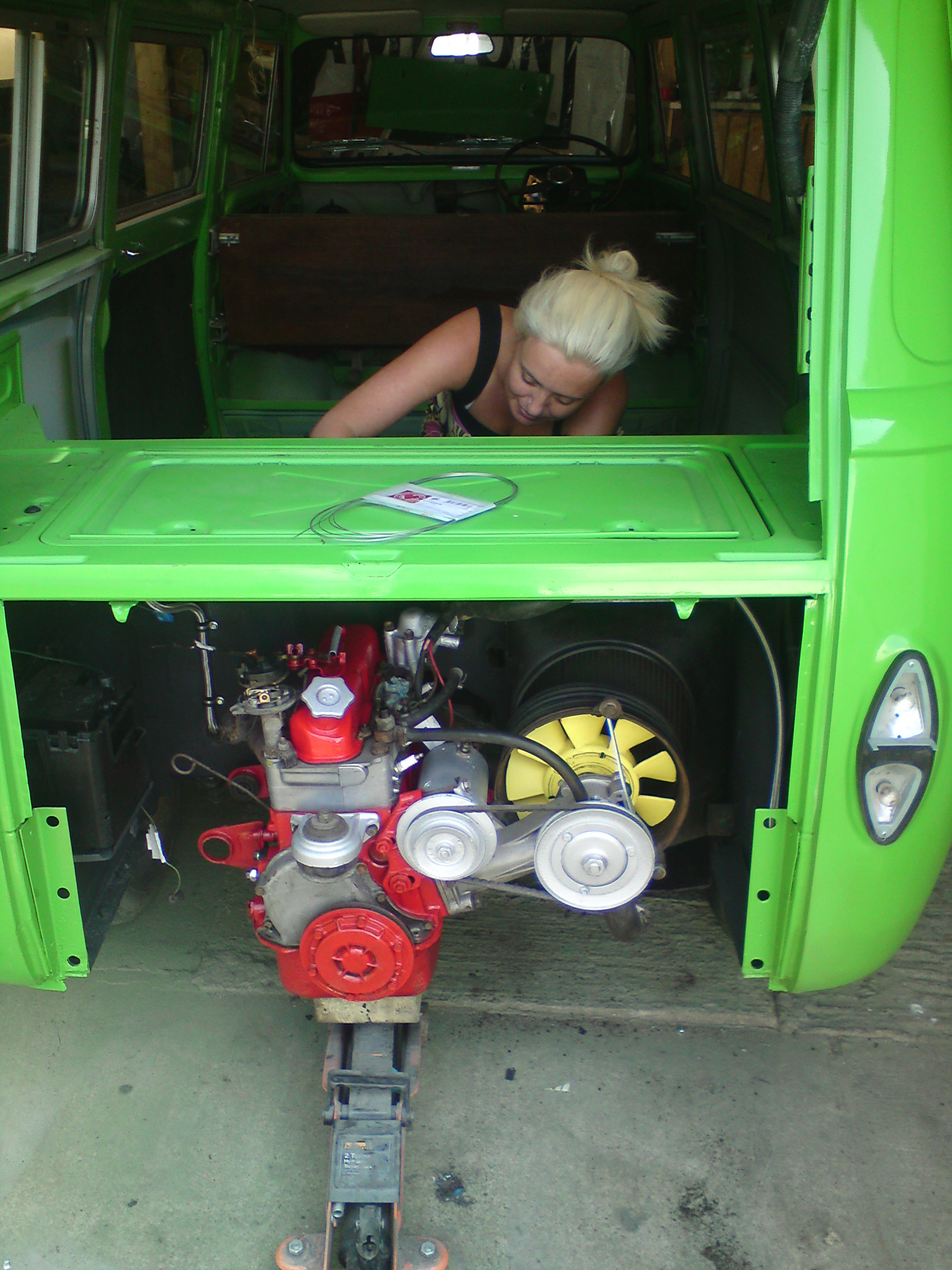

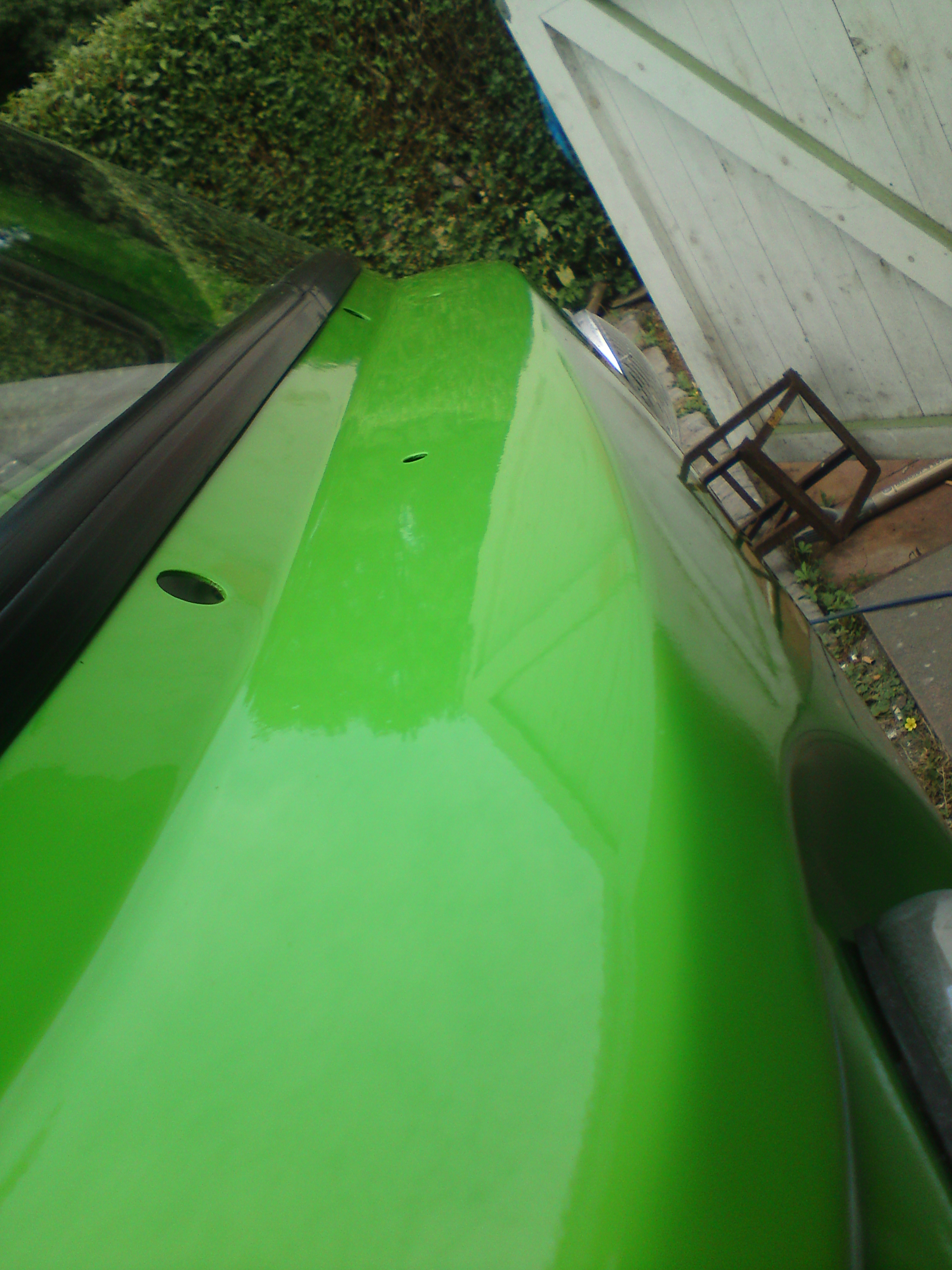

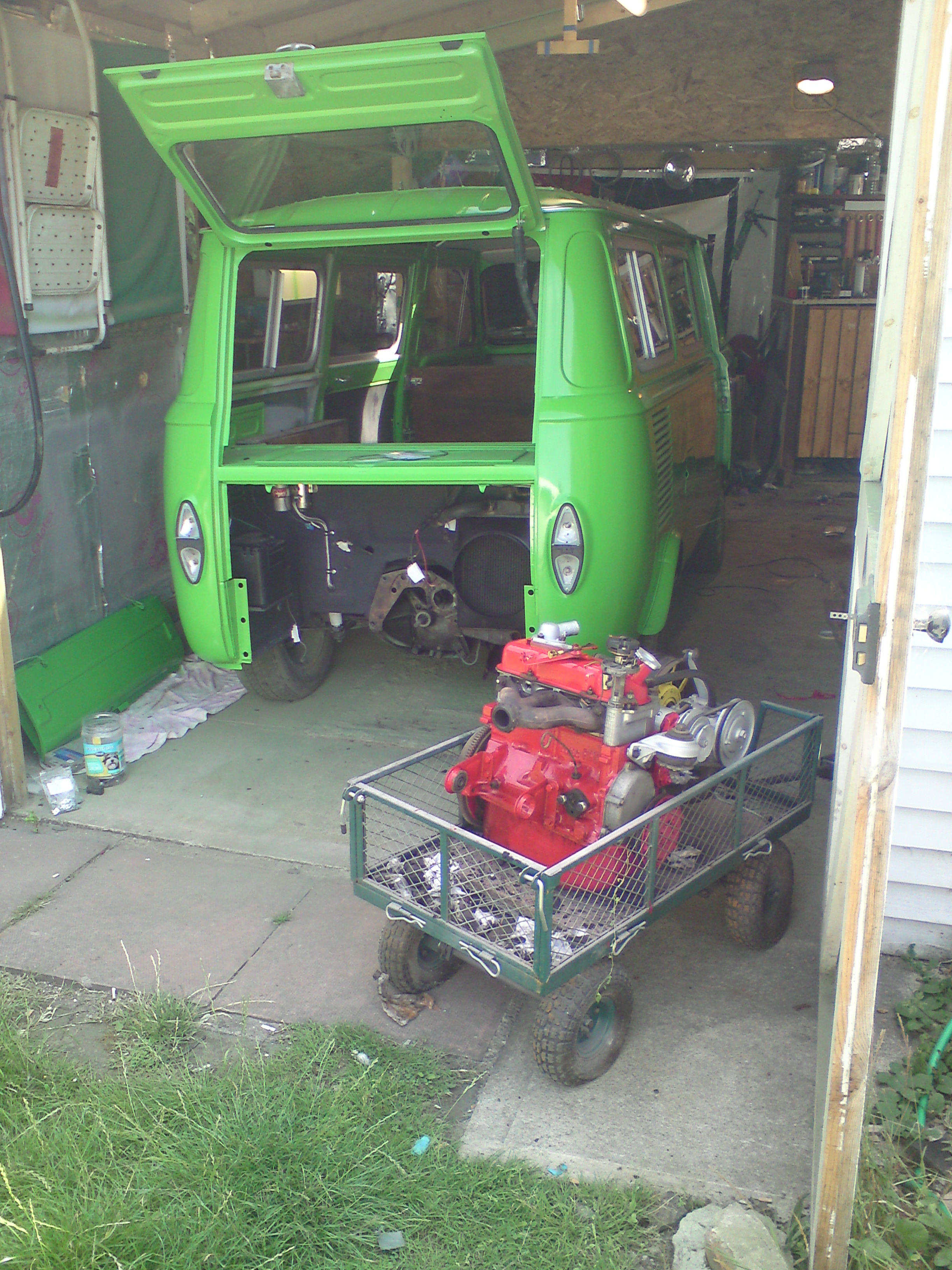

A bit more progress with the van, I have had the van polished and after the day spent with the mop I am finally happy with the paint! Also the engine is now in too! and I have also been busy refitting the wiring loom. there are a few issues to sort out with lights ect but I am finding that most are down to bad earths.
Anyway here are some more photos.
Like I said I am really happy now with the shine the van has now.

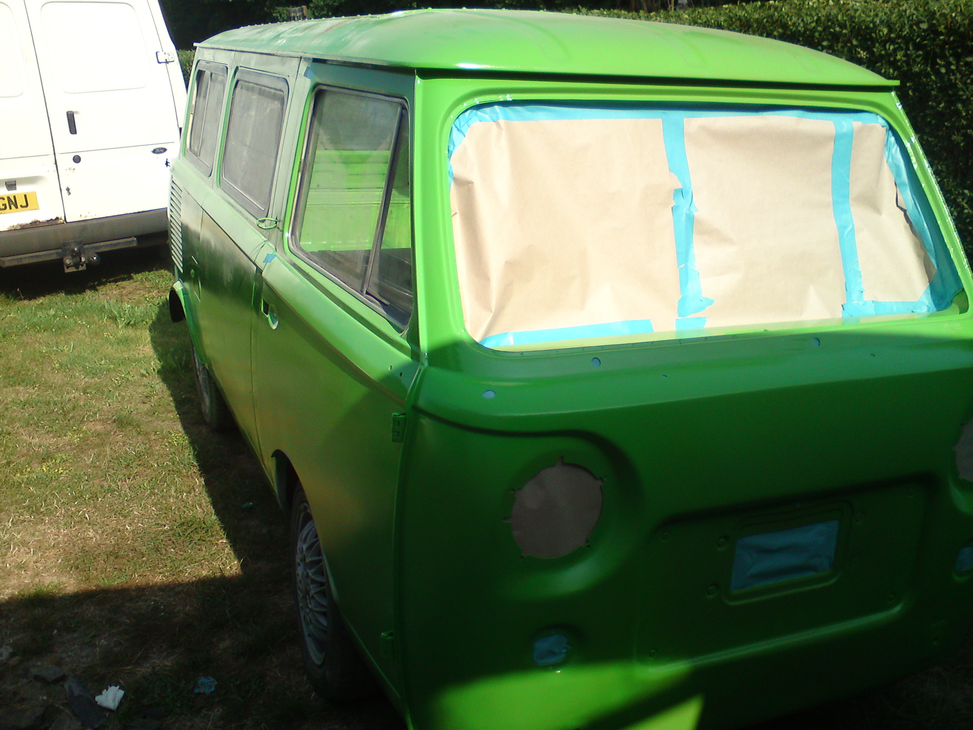

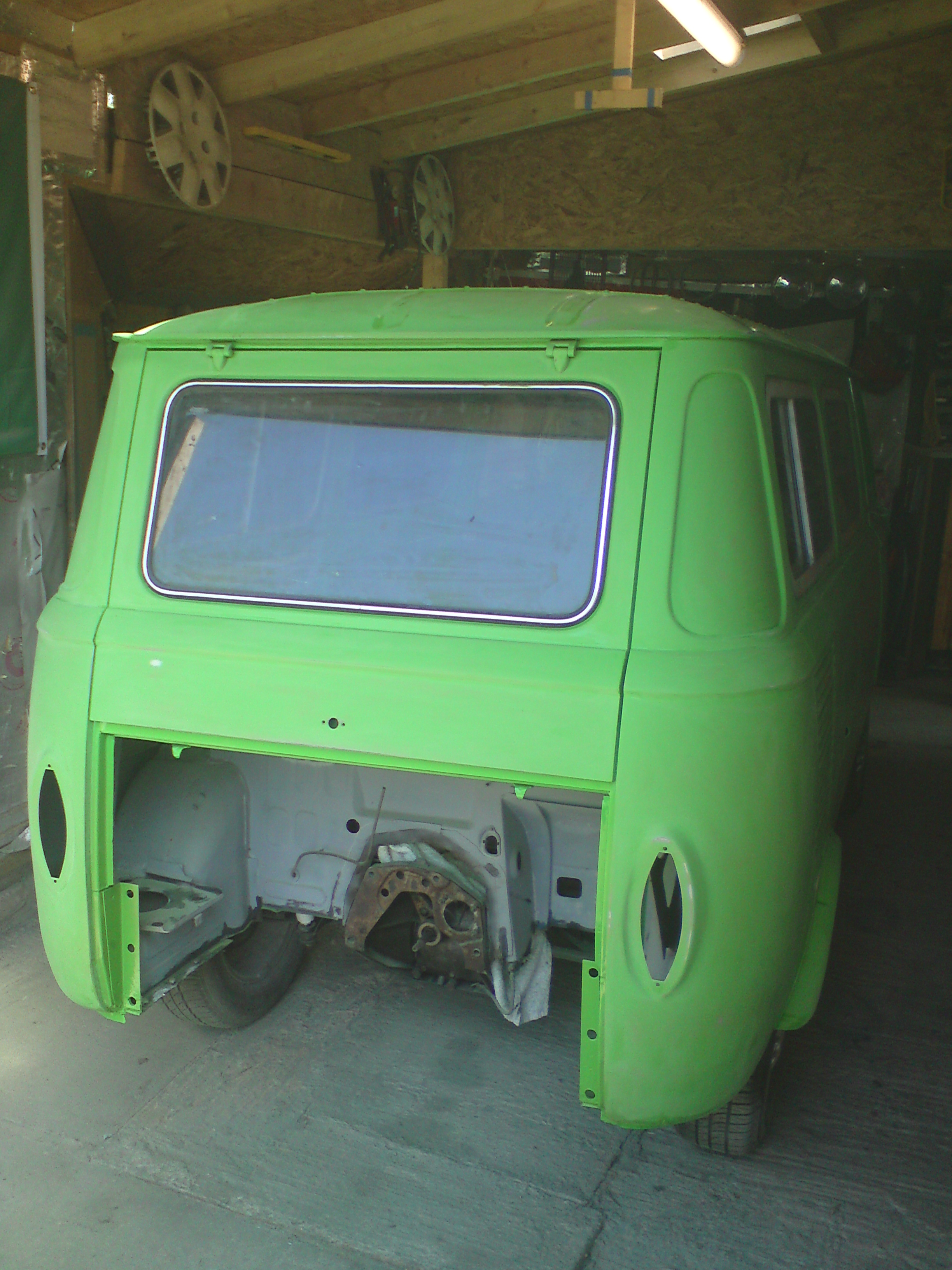

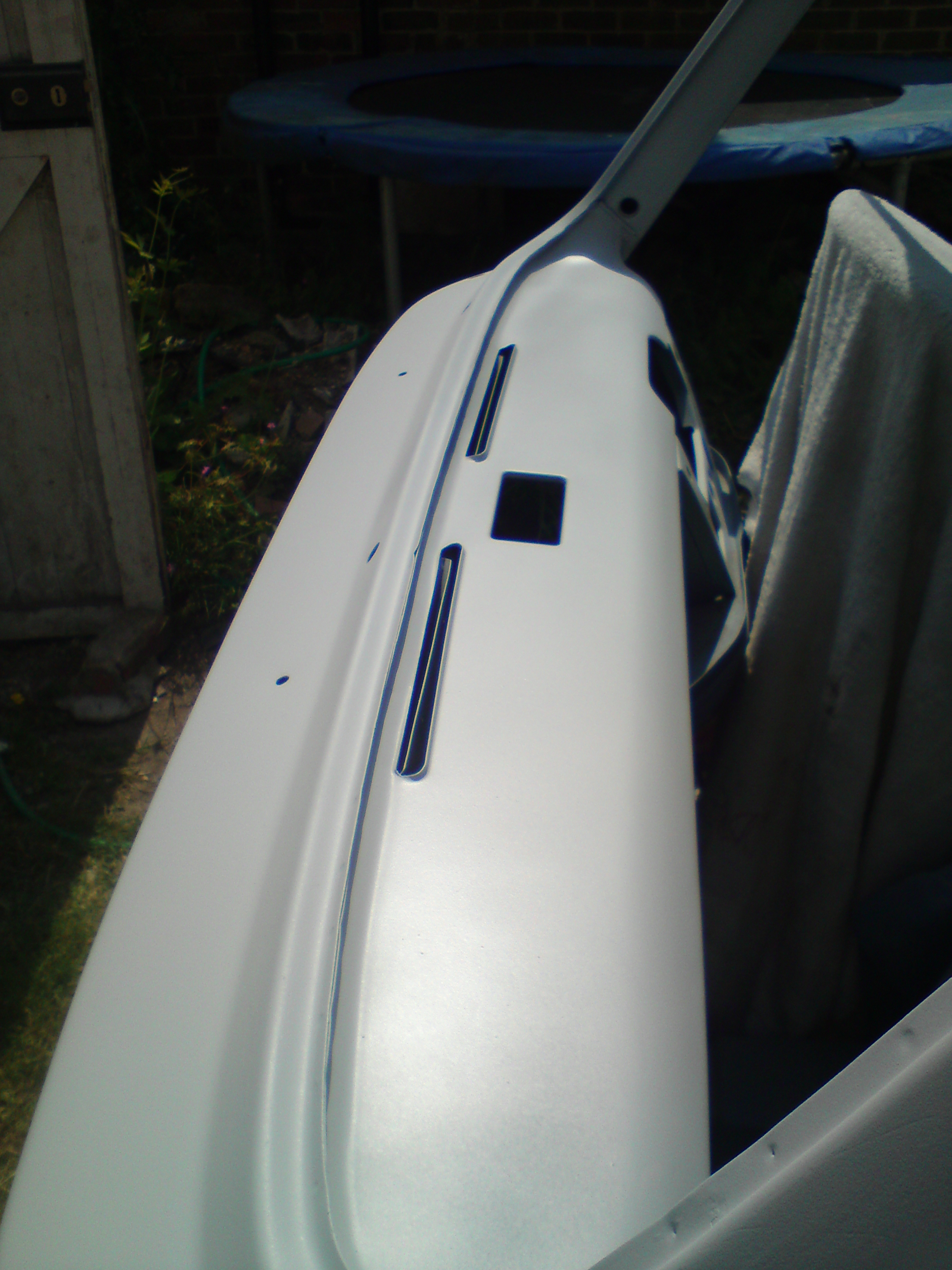

Painting the rear panel and boot.
My wife getting her hands dirty!

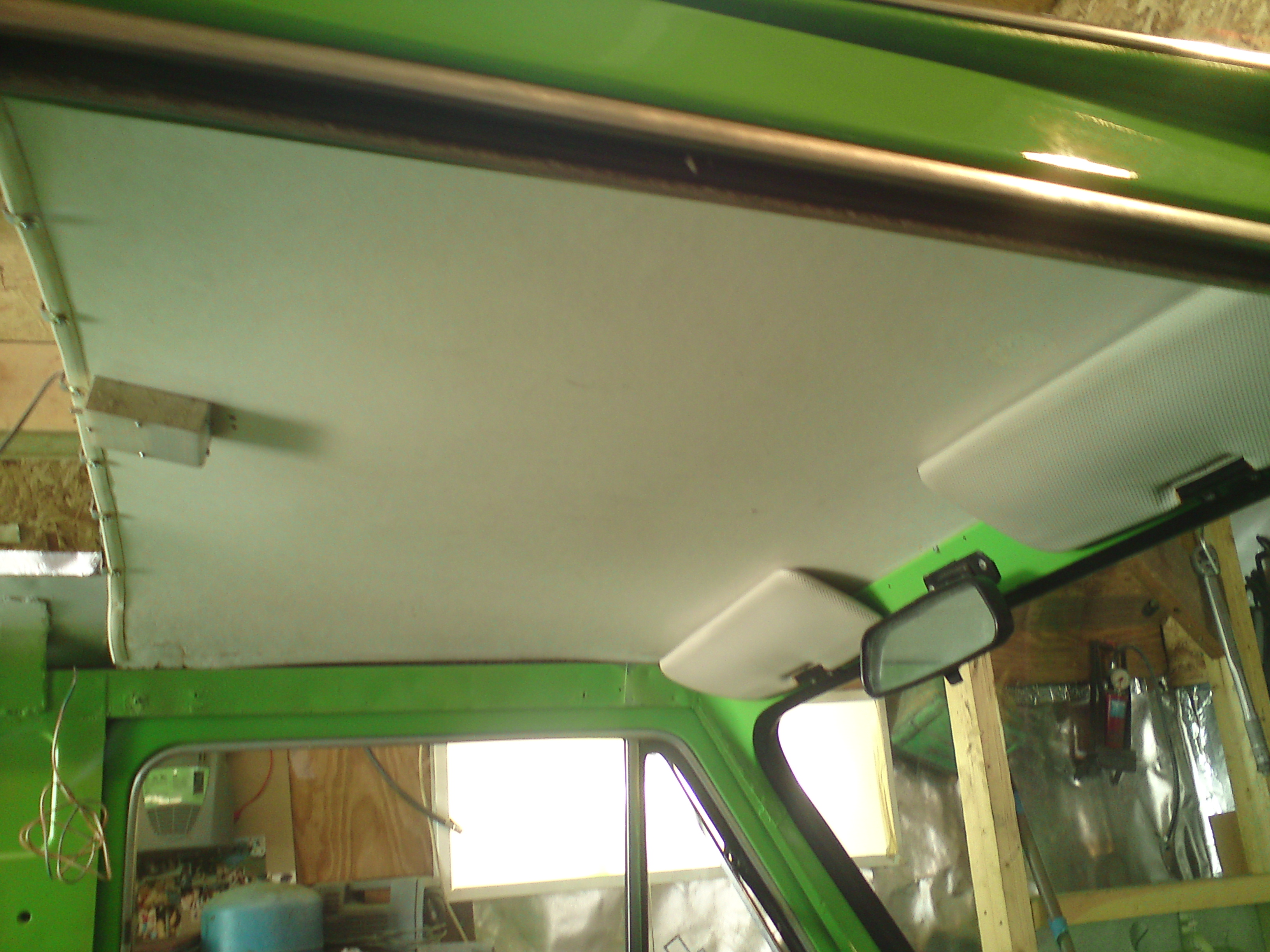

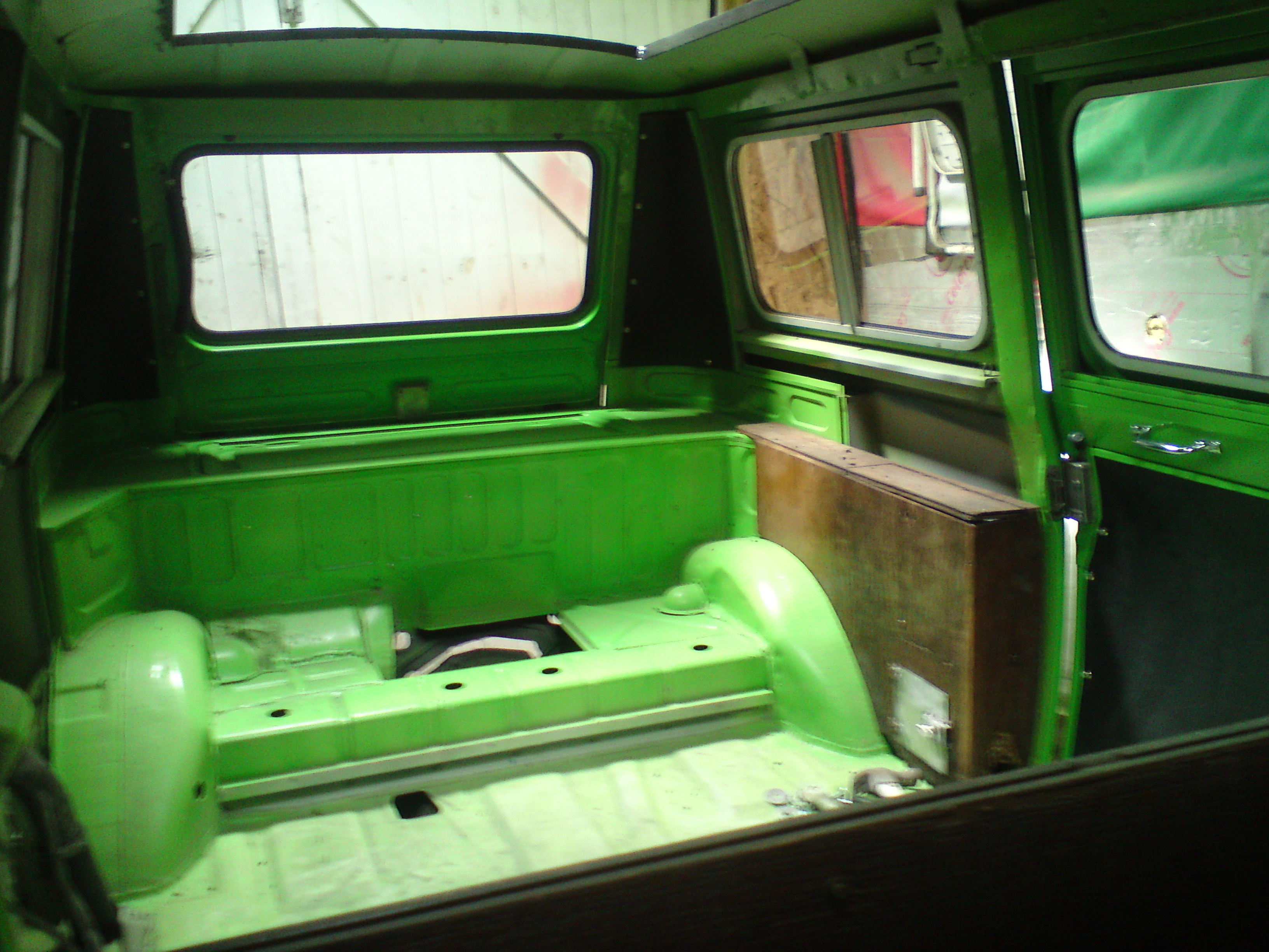

Here is the front headliner back in.

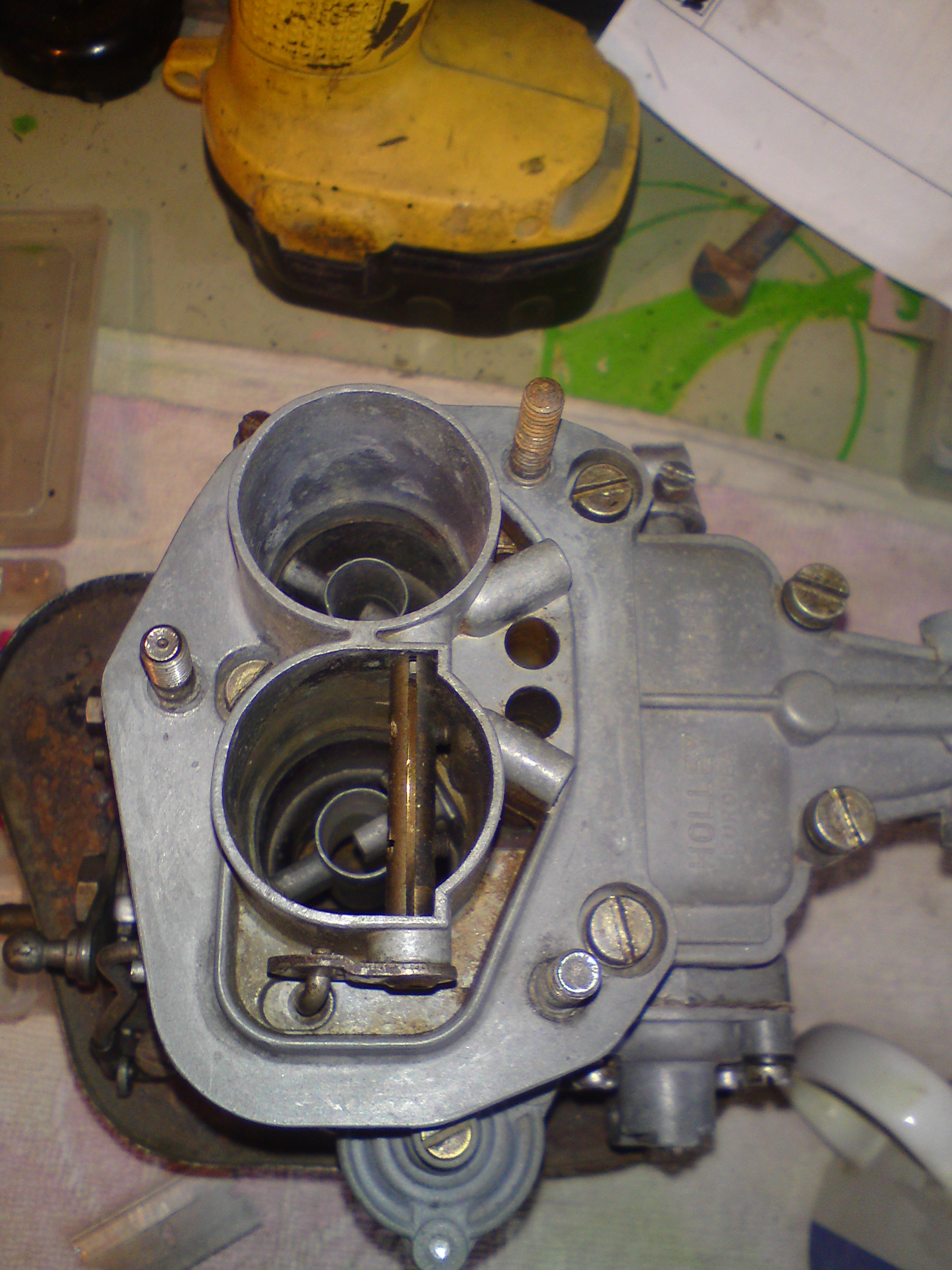

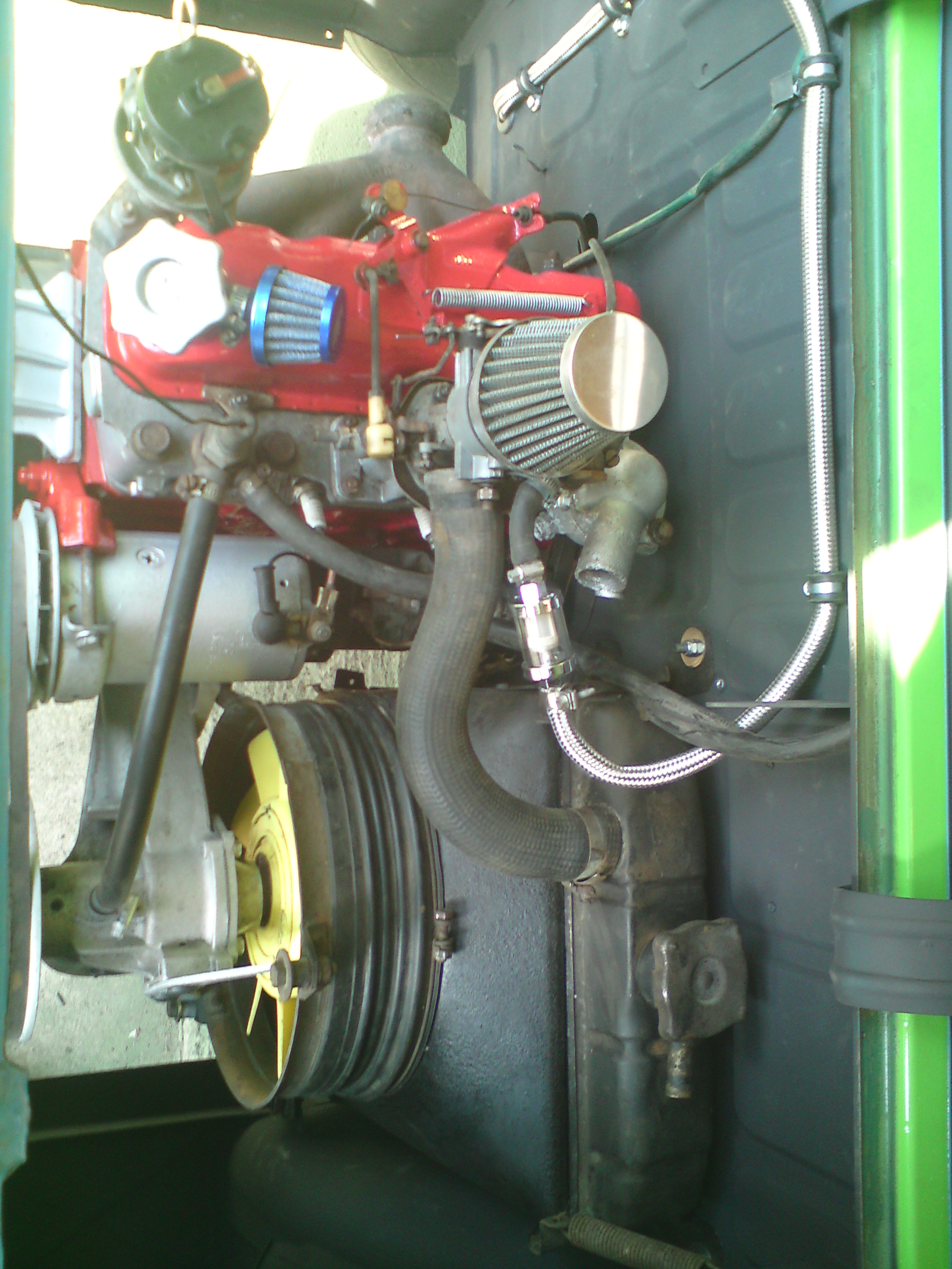

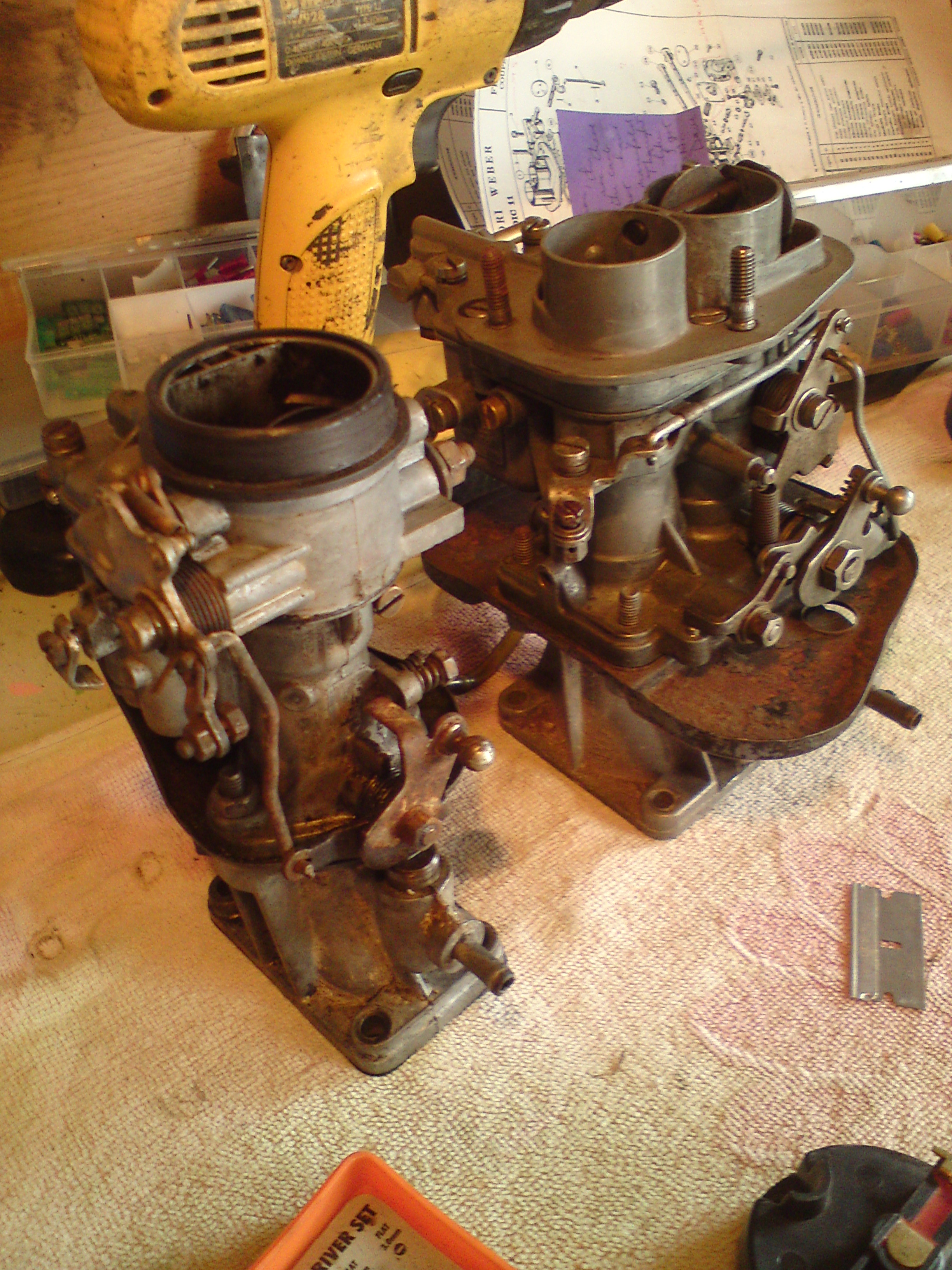

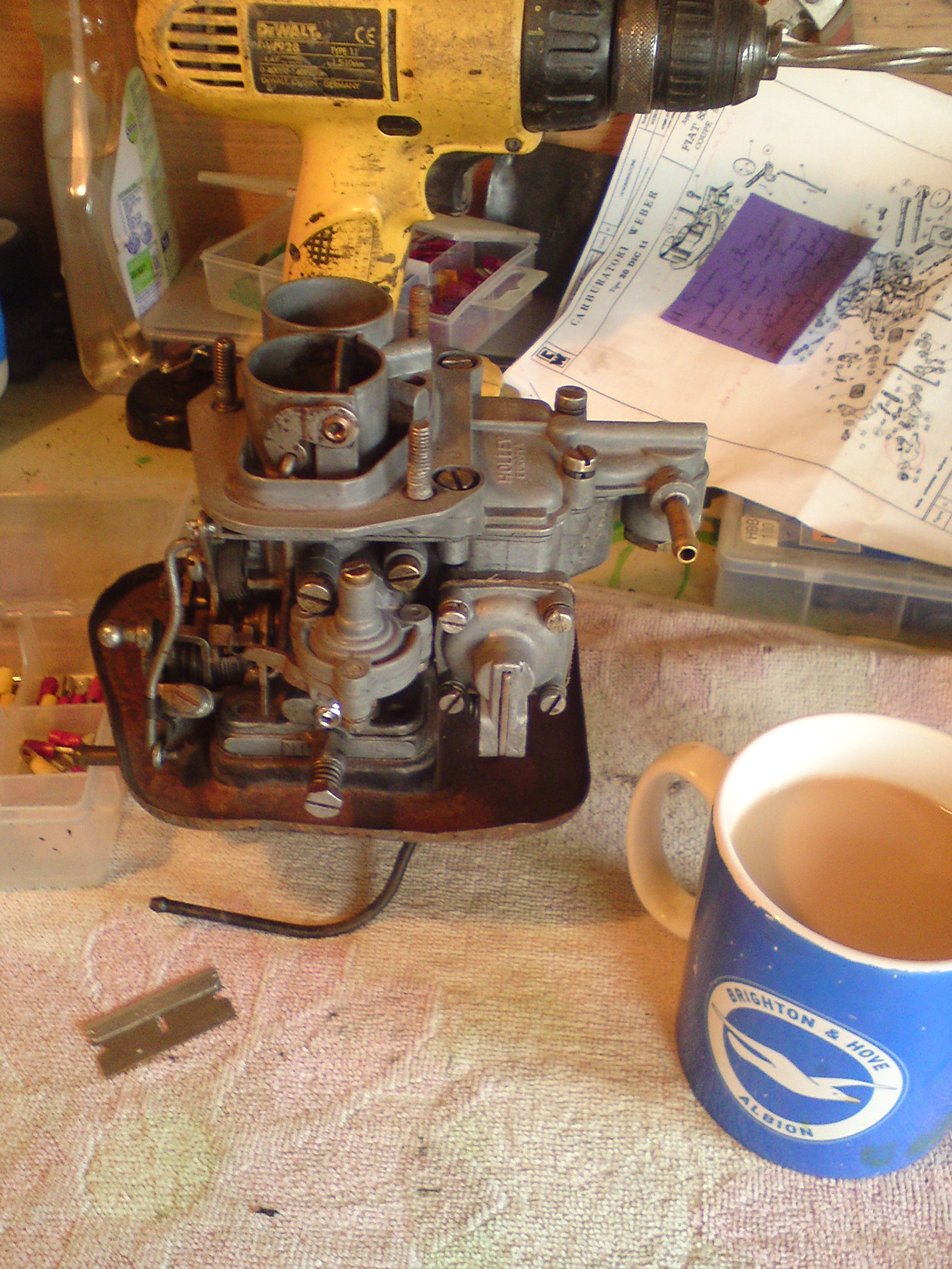

Not a lot of progress I am afraid, have spent the last week trying everything to get the engine running (which it was before it came out) but with no luck. I have spark, fuel, good compression and the timing is how it should be.
I have also replaced the points, condenser, rotor, dizzy cap, coil and it has new HT leads :confused:.
But I am not too worried because I have a sneaky feeling that it is the carb... so this was delivery yesterday :devil:.
Its a twin choke weber 30dic, which was fitted to the 850 spider, and from the prices that they go for must be quite rare! just got to wait for an intake manifold gasket to turn up and I will have another go at starting the engine.
Finally the engine is running! After fitting the new carb and checking EVERYTHING she sputtered into life. need to tune it to get it running smooth, but 10:45 at night is not the time for that ( its very load with the exhaust I have fitted ) so tomorrow I will be able to drive the van out the garage for the first time in about 8 months... can not wait!!! :D
