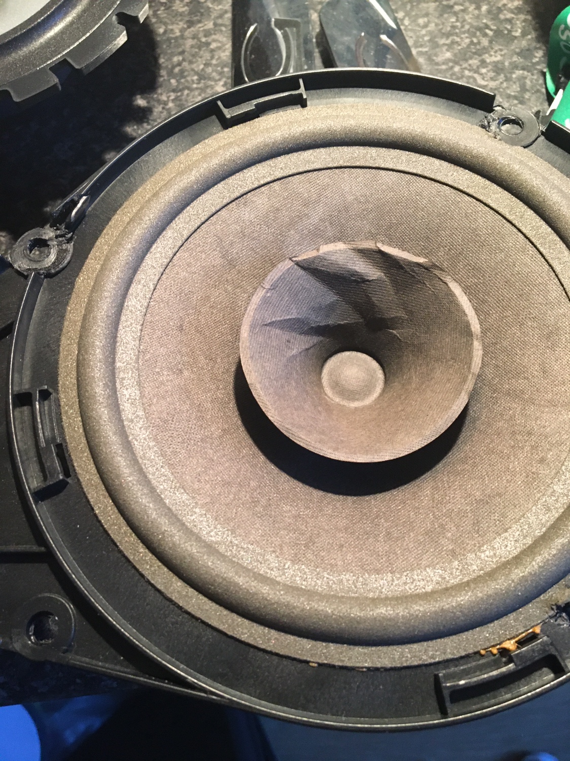

Well I’m half way there!! Took me a while to drill out the 3 rivets Jesus it was not easy!! Didn’t help that the drill bits were not as good as I thought they would be
Or maybe my drill not powerful enough
Did both rear quarter speakers and a healthy amount of sound deadening added
Tomorrow it’s the door speakers & tweeters and thankfully they are a lot easier [emoji23]
I’ve noticed the improvement already sound is crisper & no crackled bass!! It’s no wonder when you see the factory speakers!

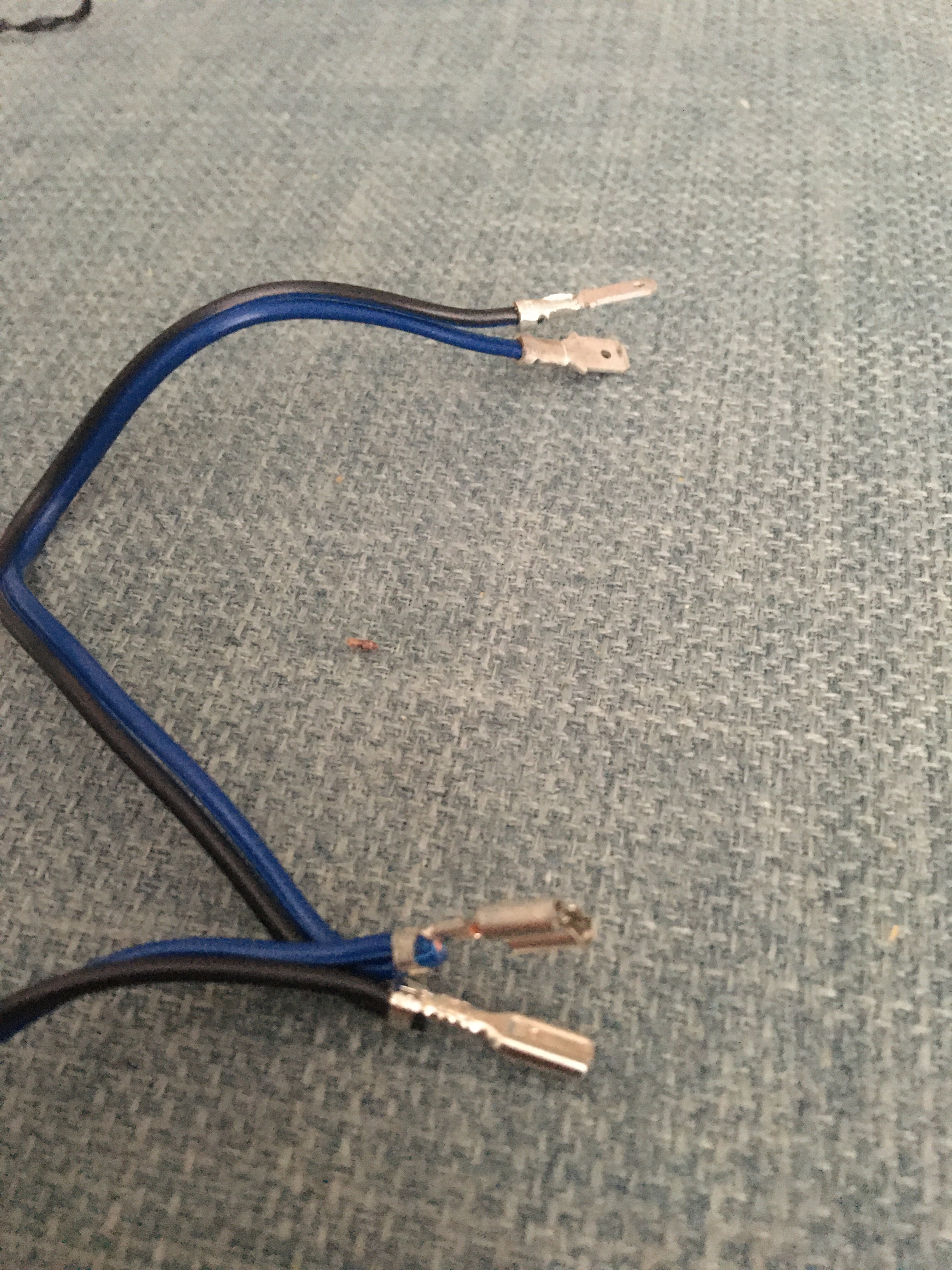

May not be able to install the tweeters as the wiring is completely different to the factory ones these have plugs & the new ones don’t!
Not the end of the world as the factory tweets aren’t too bad!
I get you now! Yup I did it right thank god [emoji23] just finished both doors and everything is back in place .... the sound is soooo much better!!
I'd there any length of cable on the old tweeter connector you could cut them off and solder them to the new ones

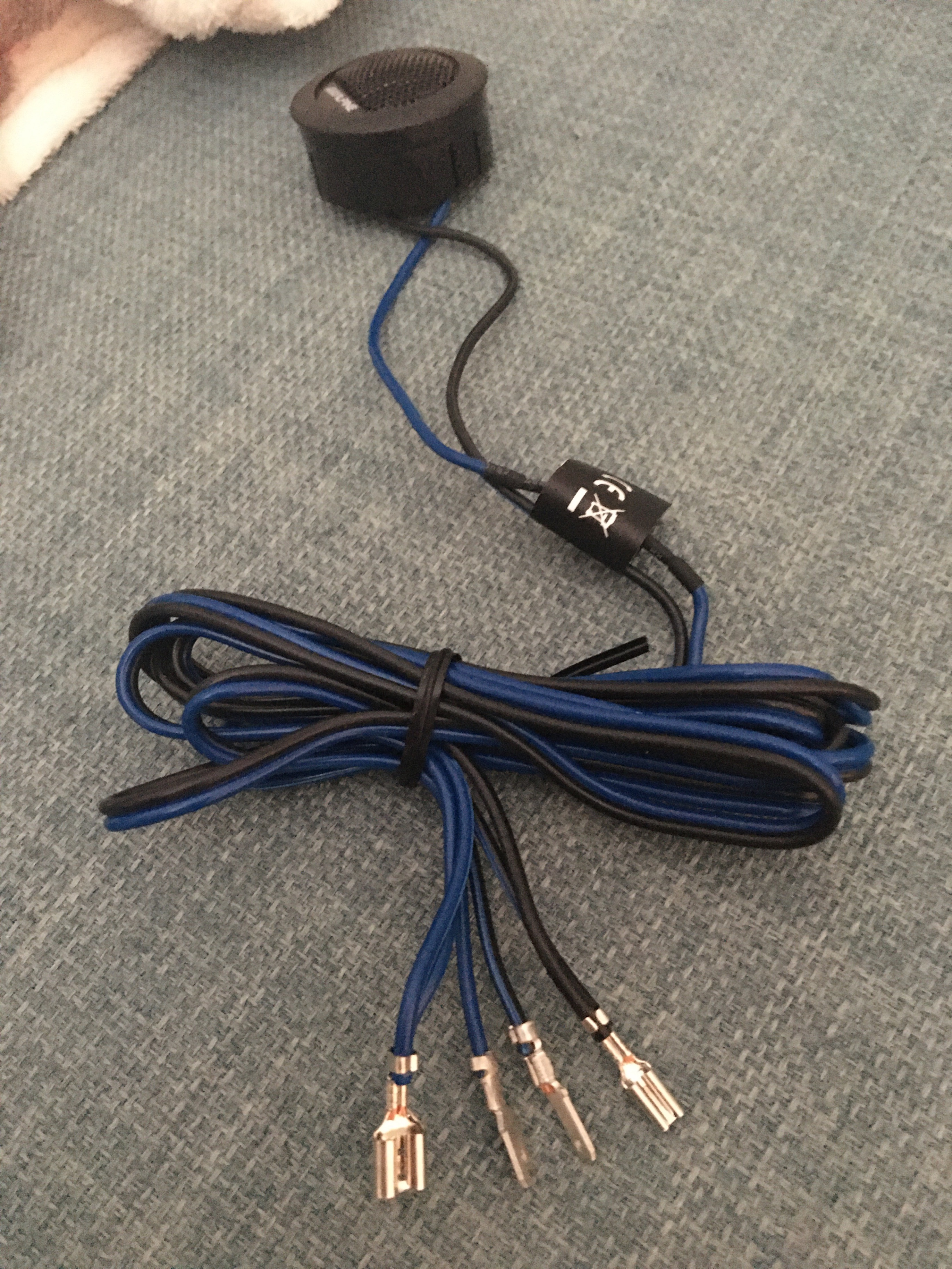

I’m confused by the connections on the new ones there’s 2 wires on the factory tweeters but 4 on the new??View attachment 209105
While the mounting adaptors in the set might be exclusive to FIAT the speakers themselves appear to be 'universal' and include a tweeter for those cars that may not already have them.
The two male spade lugs would then go into the speaker supply lugs, the two female lugs into the speaker itself and the tweeter piggybacks feed through the door into the pillar the thence to wherever you want to mount the tweeters. As Chris suggests, you might be best to splice the new tweeters into the existing FIAT tweeter supply leads.
But are the new tweeters the same shape and size as the old? I'd be inclined to just stick with the old tweeters but that's because I'm an ageing headbanger and I can't hear the tweeters anyway.

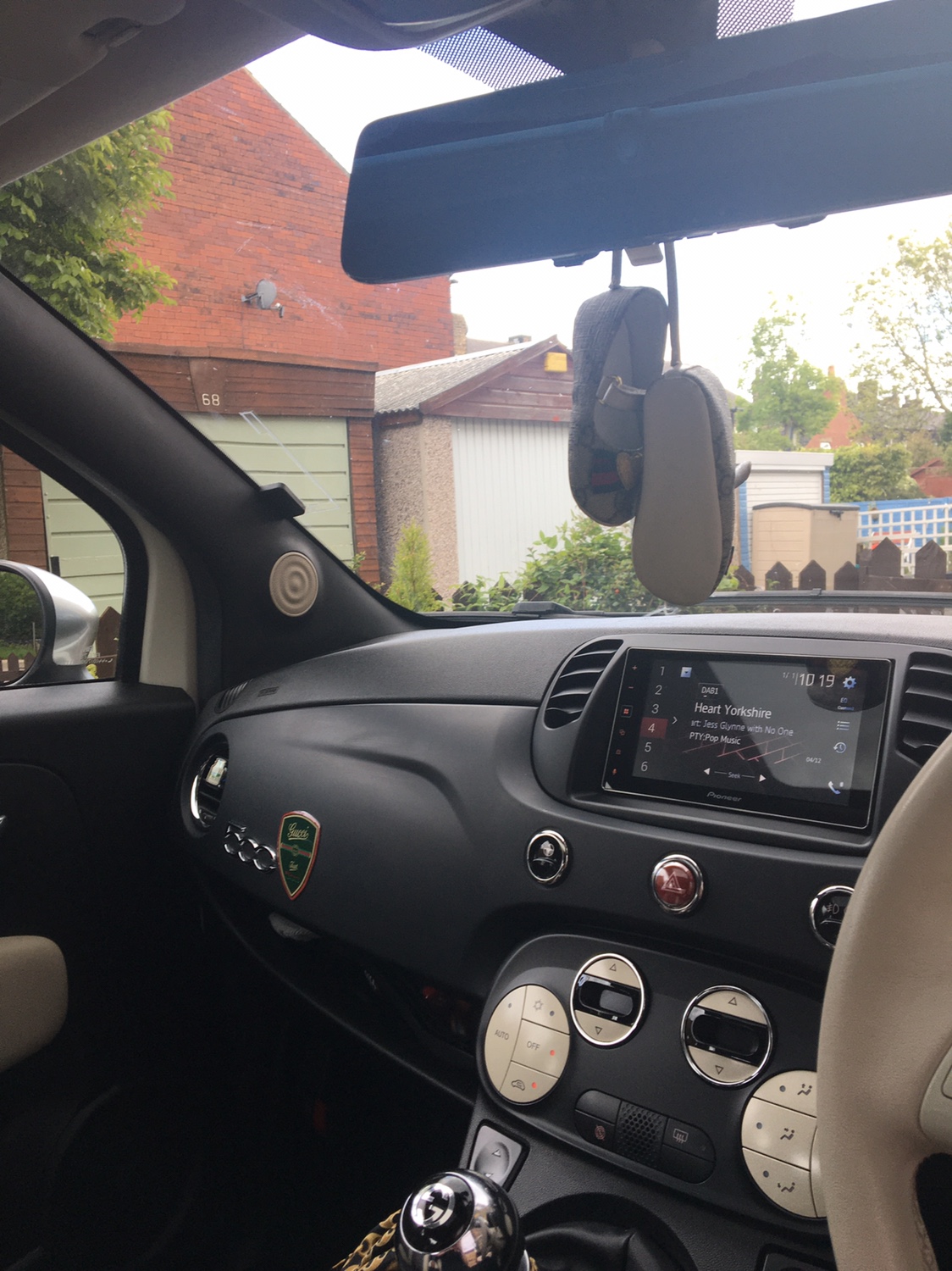

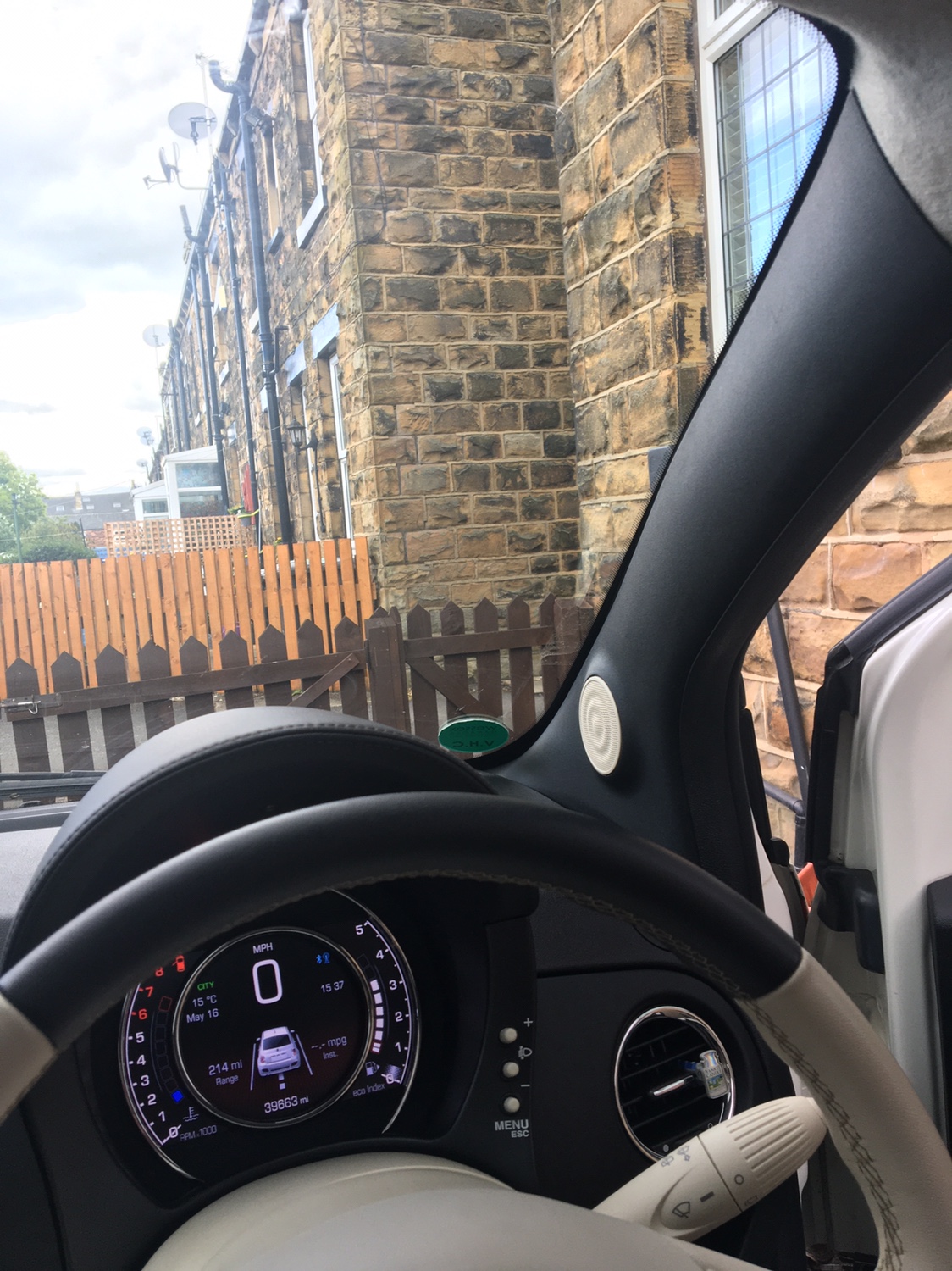

All done! Thanks to everyone esp John202020 tweets fitted and everything working great [emoji1320] I also swapped my cream pillars for matte black but retaining the cream tweet covers ...... well happy [emoji2] I had to cut & solder as John suggested IMG_4312.JPGIMG_4315.JPG
