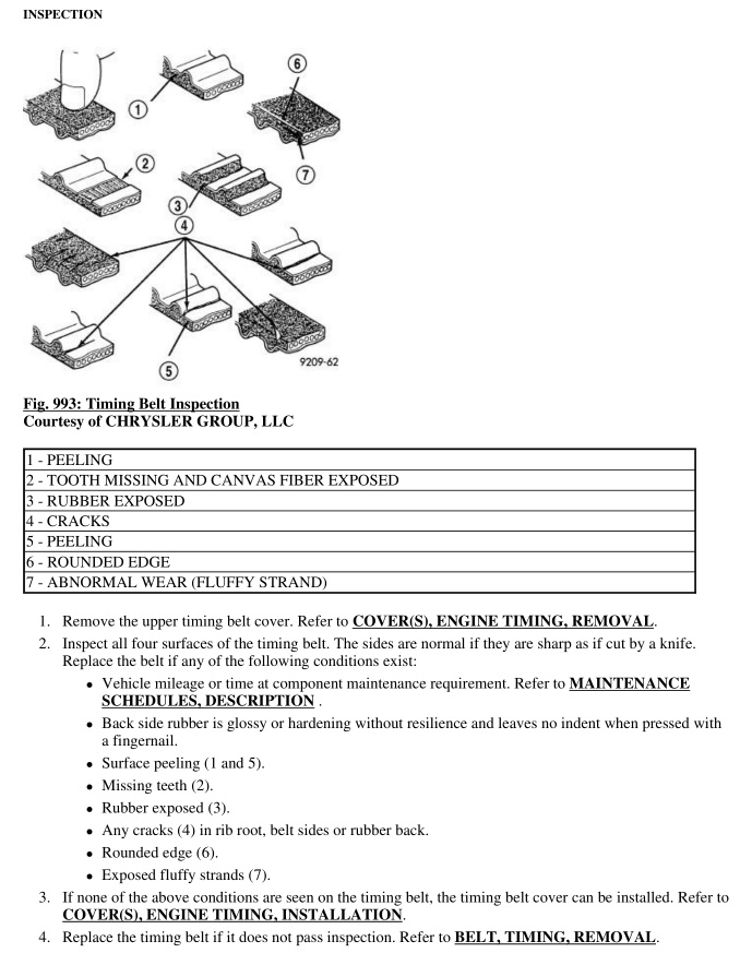

If you can, take off the timing belt cover off and inspect the belt (image from the Workshop Manual), this would give you more information for you to make a decision on delaying or not.

Belts do vary, some cars within their recommended schedules look terrible, with the belt sloppy and cracked as hell, just asking to fail and yet others, miles over the limits can look perfect and almost hard to justify changing.
A close inspection helps if possible, but at the end of the day the cost of it's failure on many engines is a scrap car time!:(
