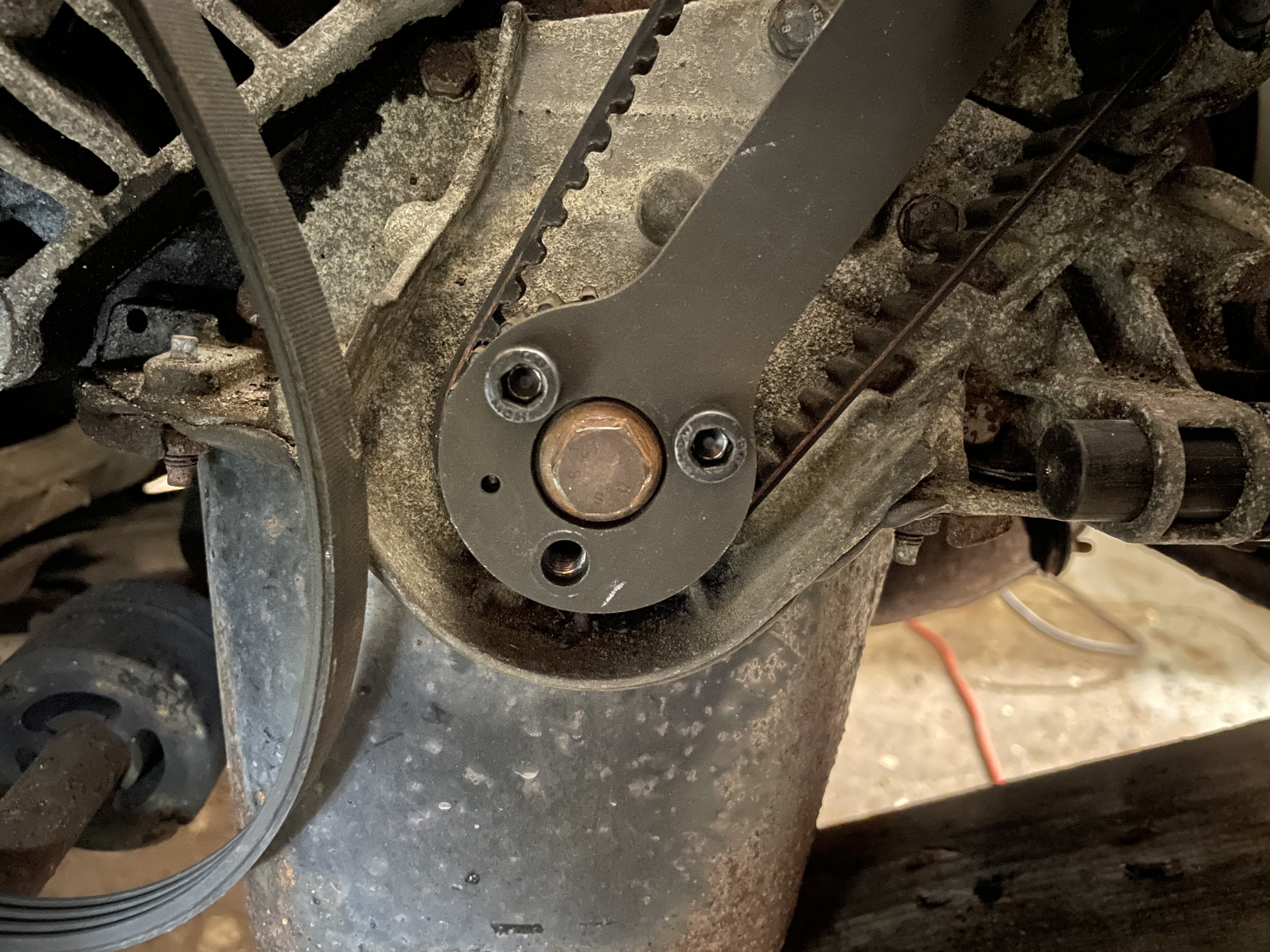

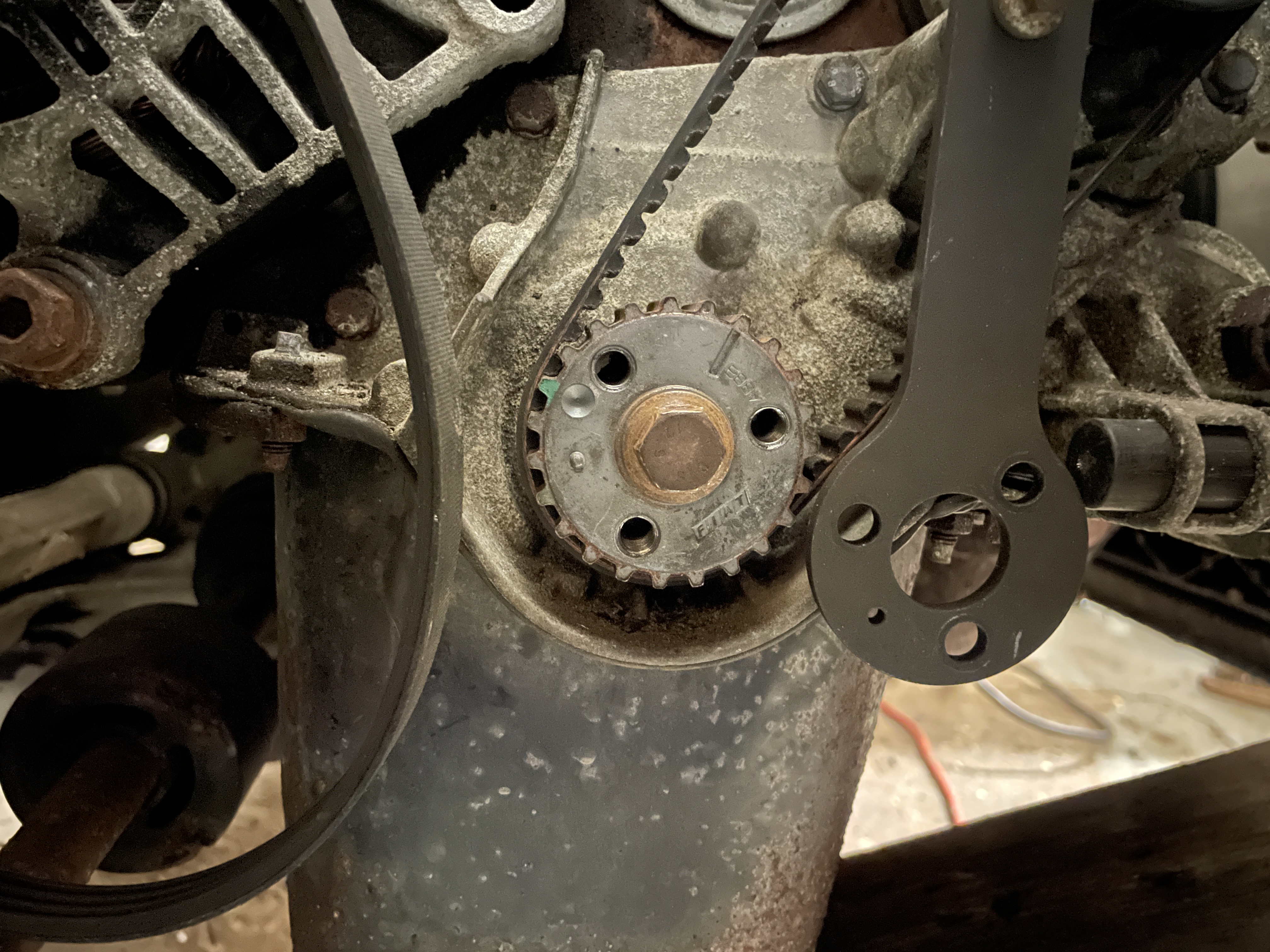

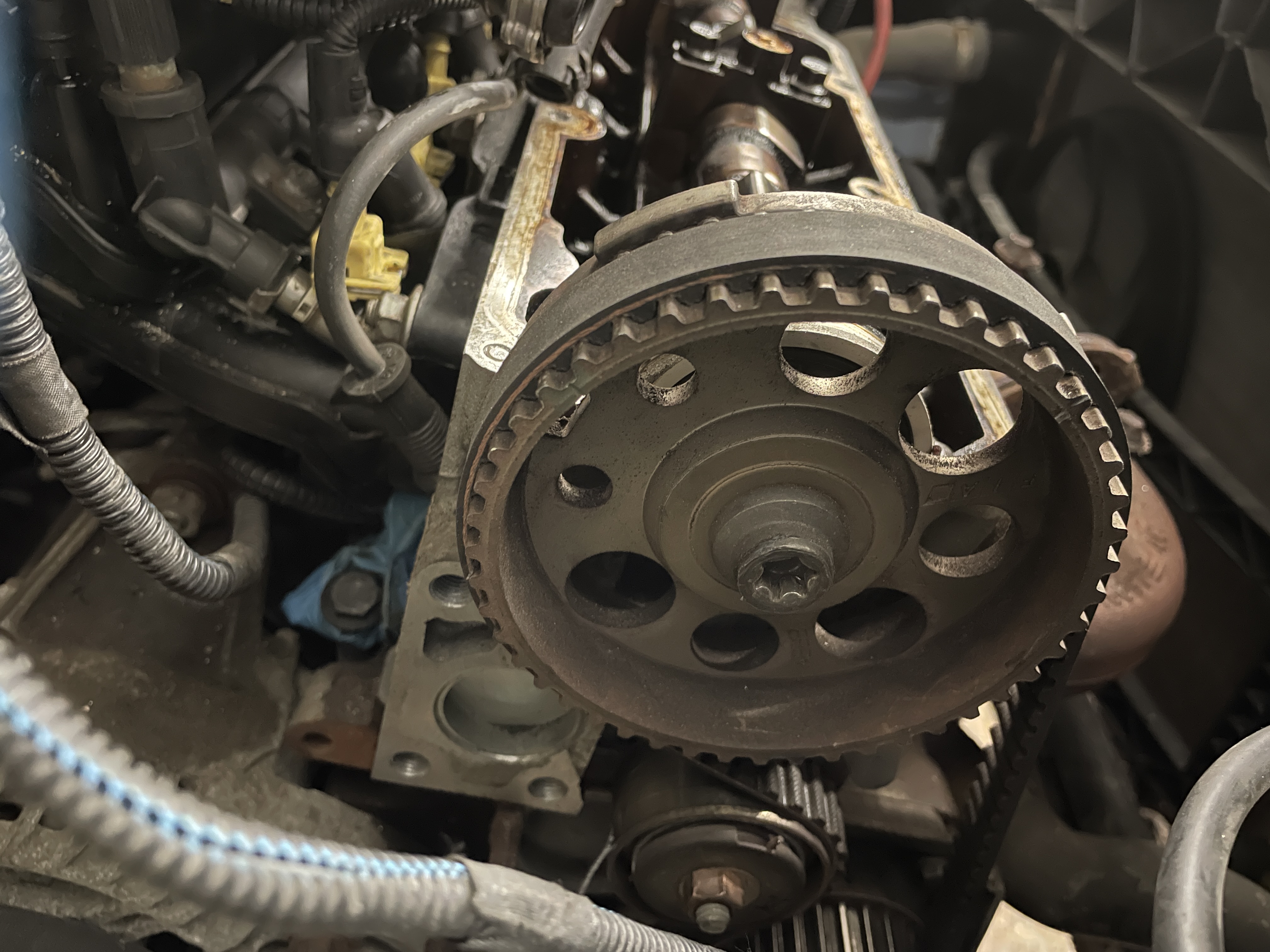

When i fit the locking tools the belts teeth and the cam sprocket teeth do t mesh they sit on top
Do i go clockwise 0.5 tooth or 1.5 toth
I can try both
Just pull it up and sit it on the teeth
It will be slack
You can see it's not tight in photo one
Mark it with some tip X or similar
Turn it back one tooth
Then put the locking tool back, the belt should be tight photo two

Tried 6 times now and each time after turning it by hand twice the locking kit fits but still no attempt to fire up
So turning by hand the locking kit fits
And the cut out is at the top 1a

If you can turn the engine over and the locking tools fit and the cam notch is at the top, it's unlikely to be a problem
Before posting the fiat drawing of the cam tool in position I did do an image search and there was one site with the cam being timed 180ish degrees out
Yeh notch 1a is always up and mark on cam sprocket is towards the left where a timing mark use to on previous models
