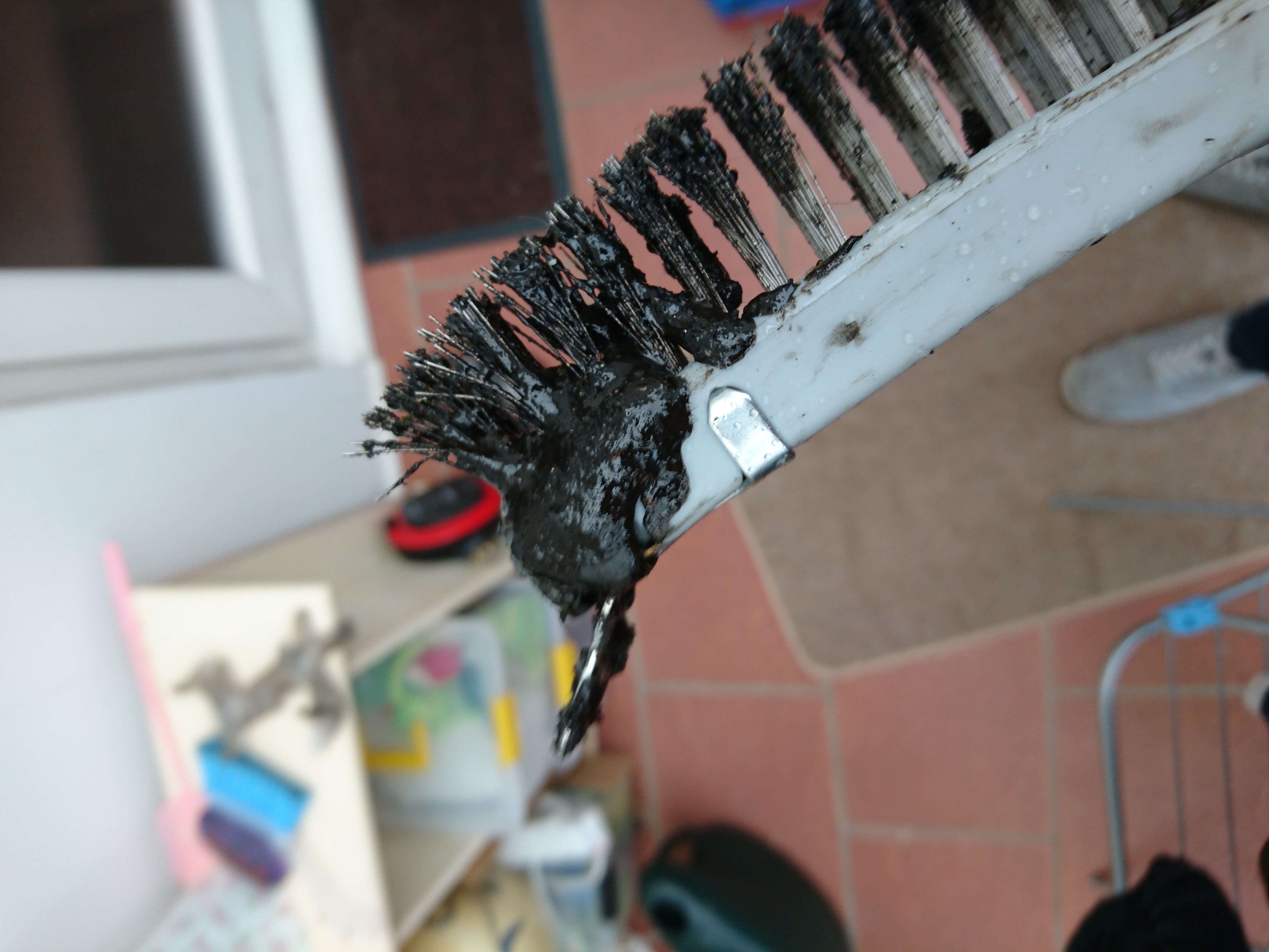

Started cleaning down the engine today, forgot to take before/after pics but it is significantly less oily now. It was literally caked in dry oil,
One gross wire brush and a destroyed cloth too :eek:

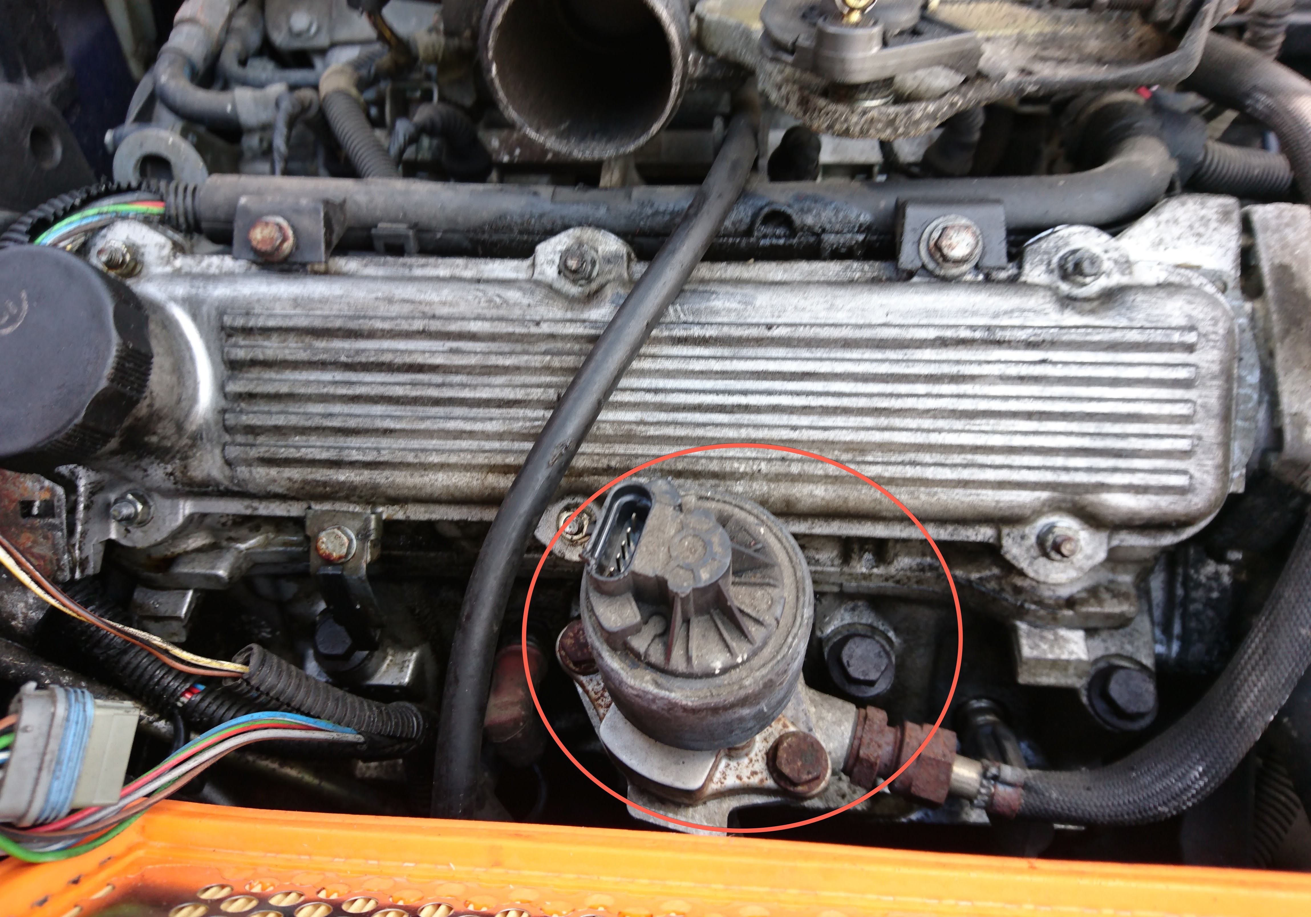

Anyway, this is going to be potentially a stupid question but I've only ever worked on FIRE engines and even my knowledge of those is limited.
What is this?? (outlined in red)
The pipe coming out of the right leads into the throttle body and it has some sort of sensor on it but I can't figure out what it is?? :confused:
That's the EGR valve, which I believe is only fitted to the 1.6 engine. I seem to remember from another thread that it is shared with the Vauxhall Corsa!

i would have guessed ICV but i never seen a 1.6 in the flesh so wouldn't know.... If its not the ICV where is it?
If its an ICV then surely if I unplug it and start the car it'll struggle to idle? That would prove it?
EDIT: Found this on eBay, would certainly suggest its an EGR, fits all Fiat's that use the 1581cc. At that price better hope mine never goes wrong :eek:
well they send exhaust gases back through the engine, which is not great for performance although not really noticeable power gains from blanking them really. But exhaust gases are far from clean and you eventually end up with loads of sooty crap all inside your inlet which can block things up, even stop the butterfly valve closing properly.
When EGRs fail they can cause all sorts of running issues, my old alfa 159 egr failed and the car plain wouldn't run at all.
tbh, for the ease and price i'd be tempted to try blanking it and see if you get engine management light, if not then just leave it as if it does fail the light will come on and stay on whether its blanked or not. Which really isn't a big issue but it is annoying. Plus you can't tell the lights come on for something else in the future if its always on for an egr failure.
My friends corsa kept having running issues once and cleaning up the throttle body always sorted it and eventually we plugged it in and found an egr error code (eml had been on for years but never read codes - not a car person) - so we blanked it - the code is still there obviously but the car runs great, better than ever before and now the intake doesn't get all coked up either so a win win.
I did some general research on the matter but my god there is a lot of mixed opinions... I think they're pretty good for a diesel engine as they help cool the cylinder temp when you lift off the throttle (overrun) which can be necessary in a diesel since they run a lot more compression. With a petrol I'm not entirely sure what the benefits are, as with diesels it also reduces the amount of NOx in the emissions.... Regarding blanking off it should be pretty easy, the plate goes on and a lot of people put the valve back on but swing it 180° so the valve is bolted on at one side and the other just hangs off, this way you can still have it plugged in to the ECU and the valve can still operate but it's not actually doing anything.
Googling brought up a lot of threads on Vauxhall forums, seems it was common on a lot of petrol Vauxhall's and the general consensus is to blank it off, apparently Vauxhall even sell the blanking plate themselves as later engines had a blanking plate from the factory, with all this it does make me think it is kinda useless on a petrol engine other than reducing some NOx with the expense of gammy'ing your intake...
They are, from manufacturers view, for reducing NOx. The cooling effect, not really read about that but it's certainly not needed per say and if you look inside an intake of a modern diesel that's not even that old you'd be amazed how dirty they are. Particularly if you look inside say a panda or cinq fire engine i.e. petrol engine without egr, they are clean as a whistle if they have been looked after.
I am sure if it weren't for the emissions benefits cars just wouldn't have egr at all.
Not sure I see the point of turning it round when blanking though. Is it something to do with not getting an eml? Are the blanking intake side or exhaust side? I suppose if you blank inlet side and then let the egr vent the exhaust gases into engine bay you may trick some older ecu that it's working and not get a code but not sure I like the idea of that myself.
