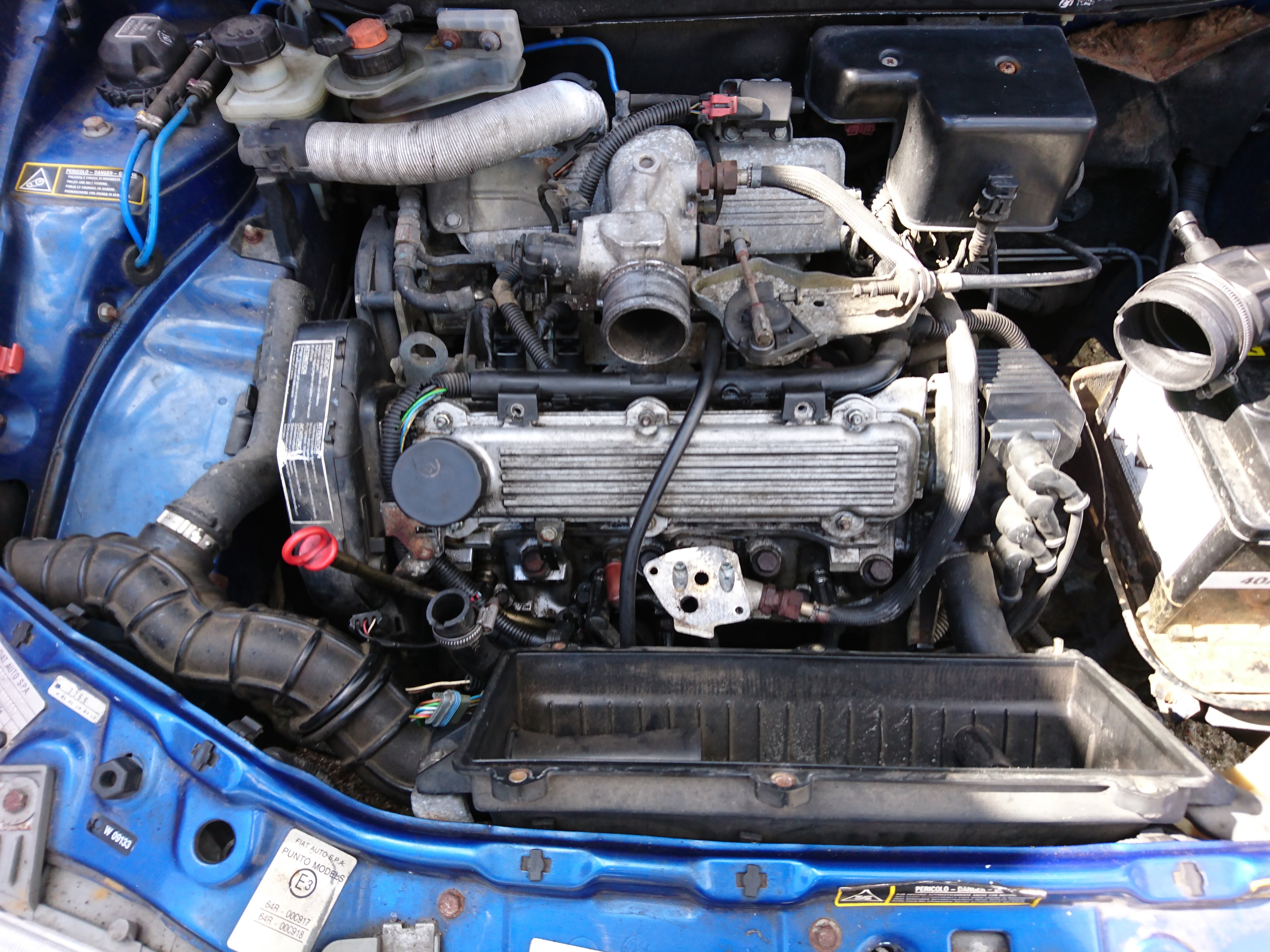

Did some more cleaning off the engine block today, pretty much got all the oil crud off the front of the engine now so hopefully I'll now decipher where an oil leak is coming from.

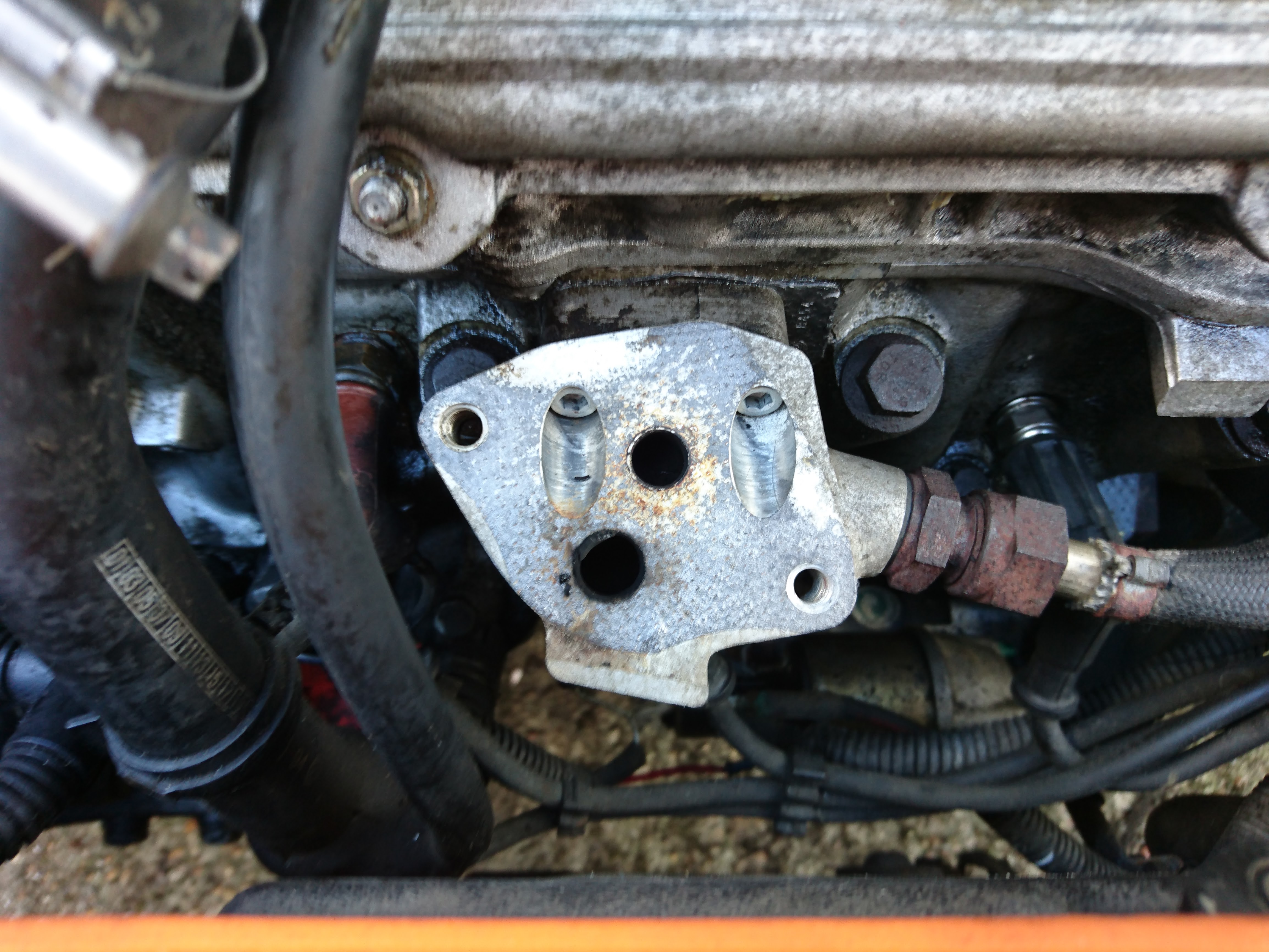

I took the EGR off too, wasn't particularly dirty, had a bit of carbon build up around the valve itself but it came off very easily, you can see where it mounts to the engine, the valve on the EGR itself pushes out into the upper hole pictured.

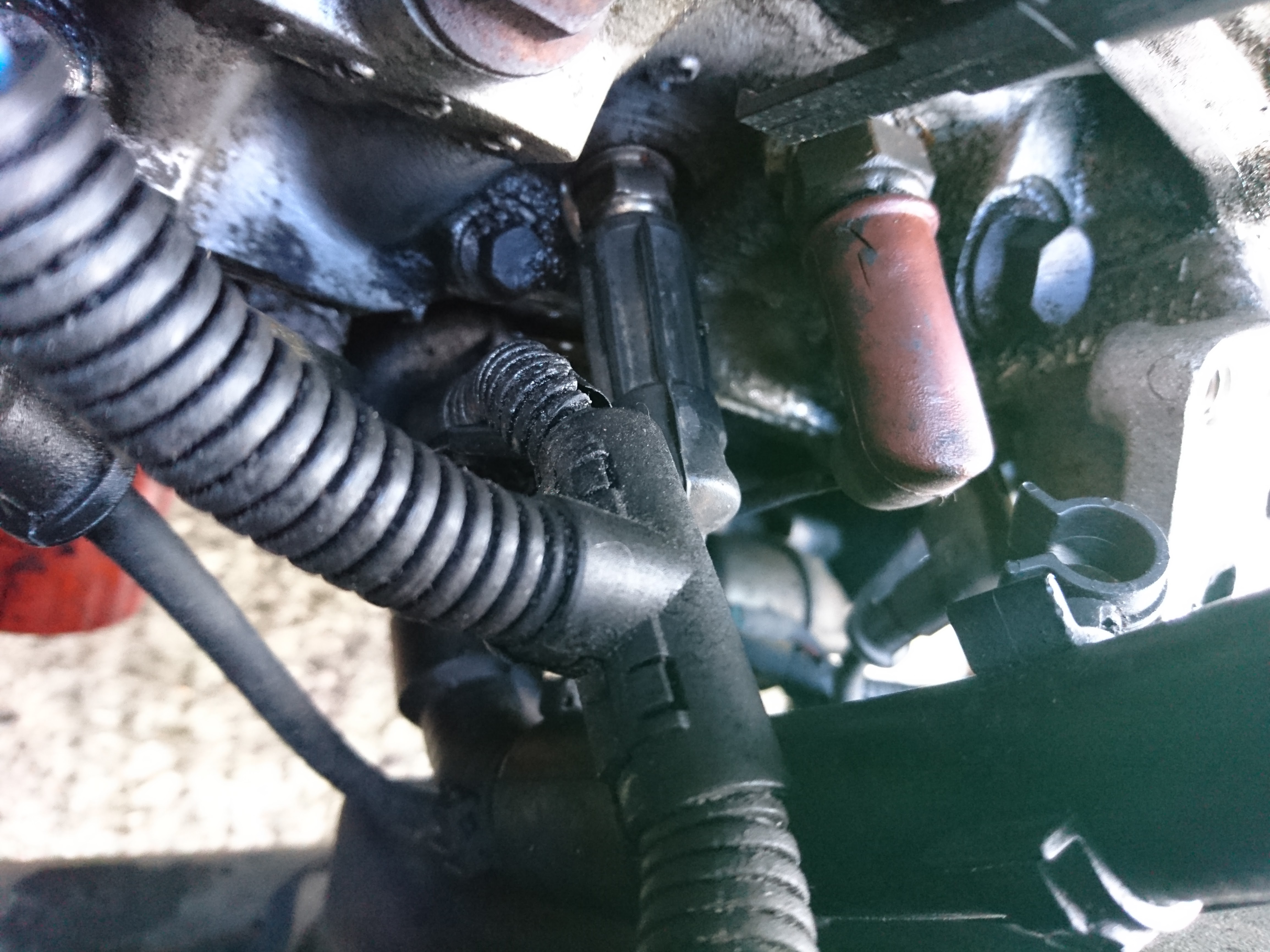

Just out of curiosity just above the spark plug for cylinder 1 there is a sensor with a red boot/cover for the connection, is it a knock sensor?

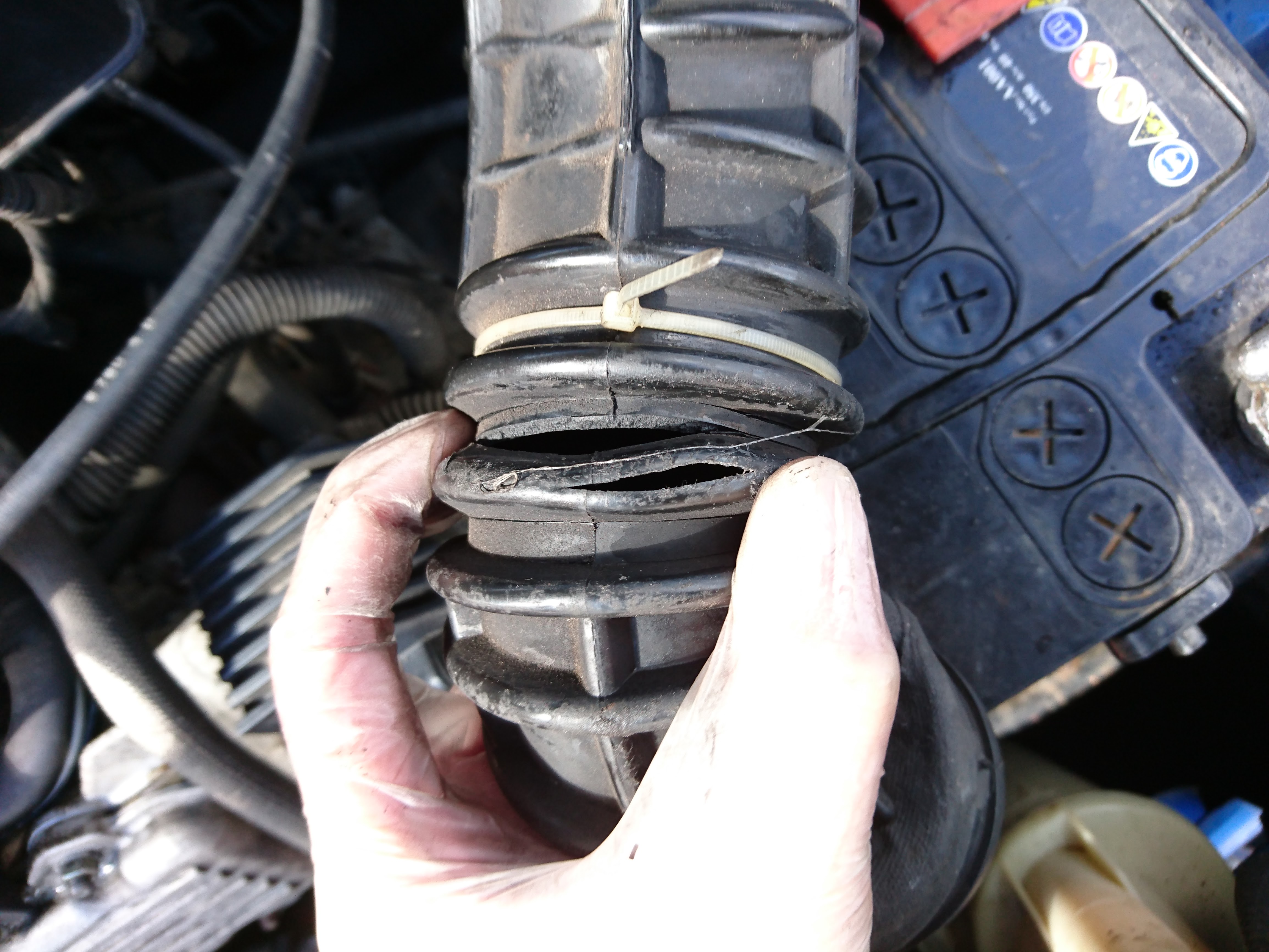

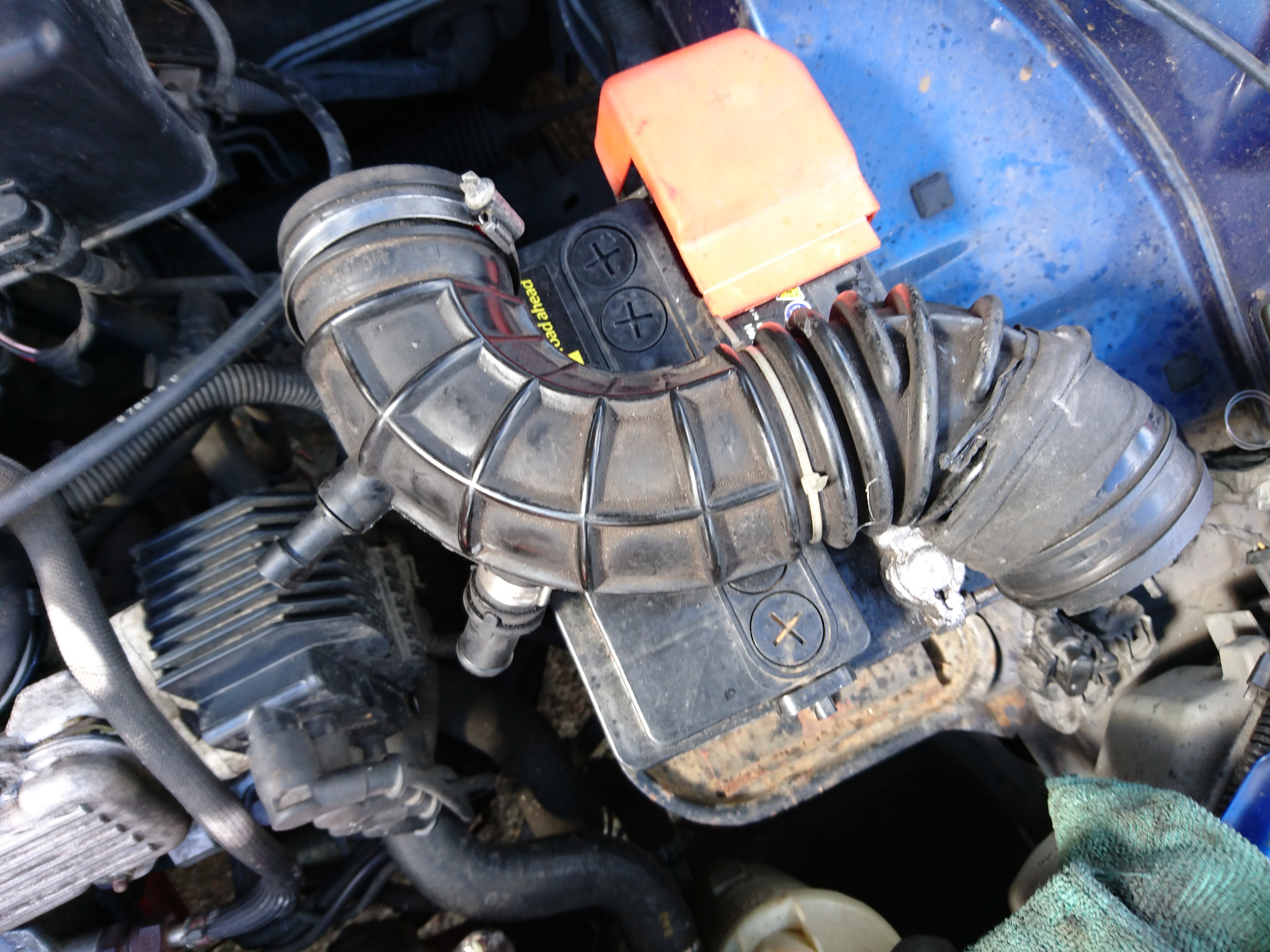

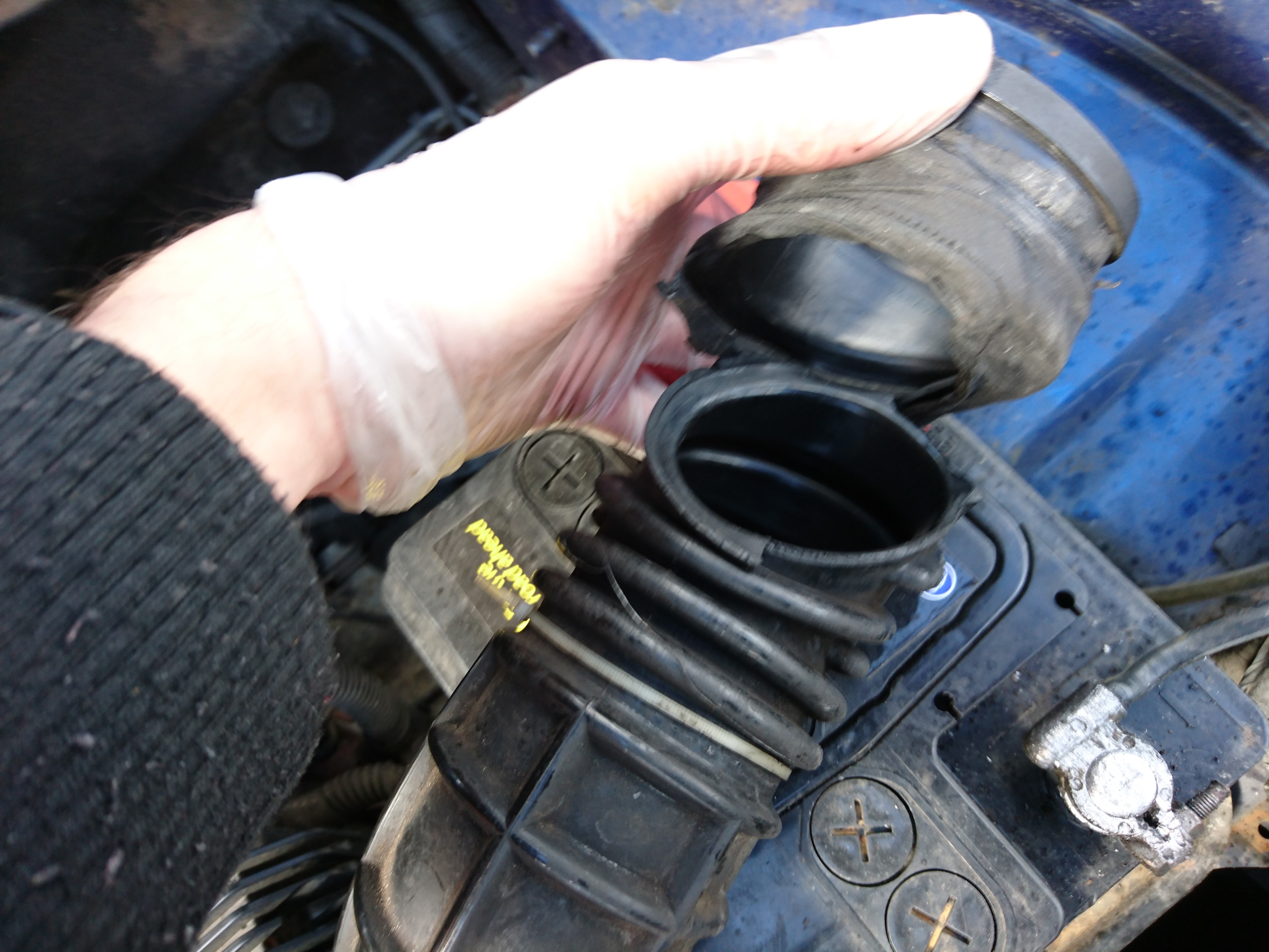

And lastly revisiting the topic of the 1.6's ability to destroy the throttle body pipe. The problem seems to be you have to remove it from the airbox in order to change the filter, and to get it off involves a lot of tugging and twisting of it, so over the years it gets weaker and weaker until mine and it seems many others break.
Mine is very split...
However I've come up with an idea to fix it, the part of the hose that enters the throttle body is very solid and doesn't have any real flex (the end on the left in the photo below), so I'm thinking if I cut the hose roughly where that white ziptie is on mine, and replace the torn bit with a 90° silicon bend and juiblee clip the two together?
The MAF sensor and oil breather T into the bit I'd be keeping so that's not a problem.
Thoughts?
Red unit is a coolant temp sensor that is sending a signal to your speedo.
There is also another coolant temp sensor on the thermostat's housing which sends signal to the ECU.
Thank you, I saw the one on the thermostat so had ruled this out as being one :rolleyes:
Do you know if the 1.6 has a knock sensor?
It does not have. nor MAF sensor.
It has just a Cranksensor, and the one that connects to the intake is called an "Intake Air Temperature Sensor" (IAT), and does not measure the air flow. (y)

Currently ordering bits for my idea to replace half of the TB hose with a silicone hose.

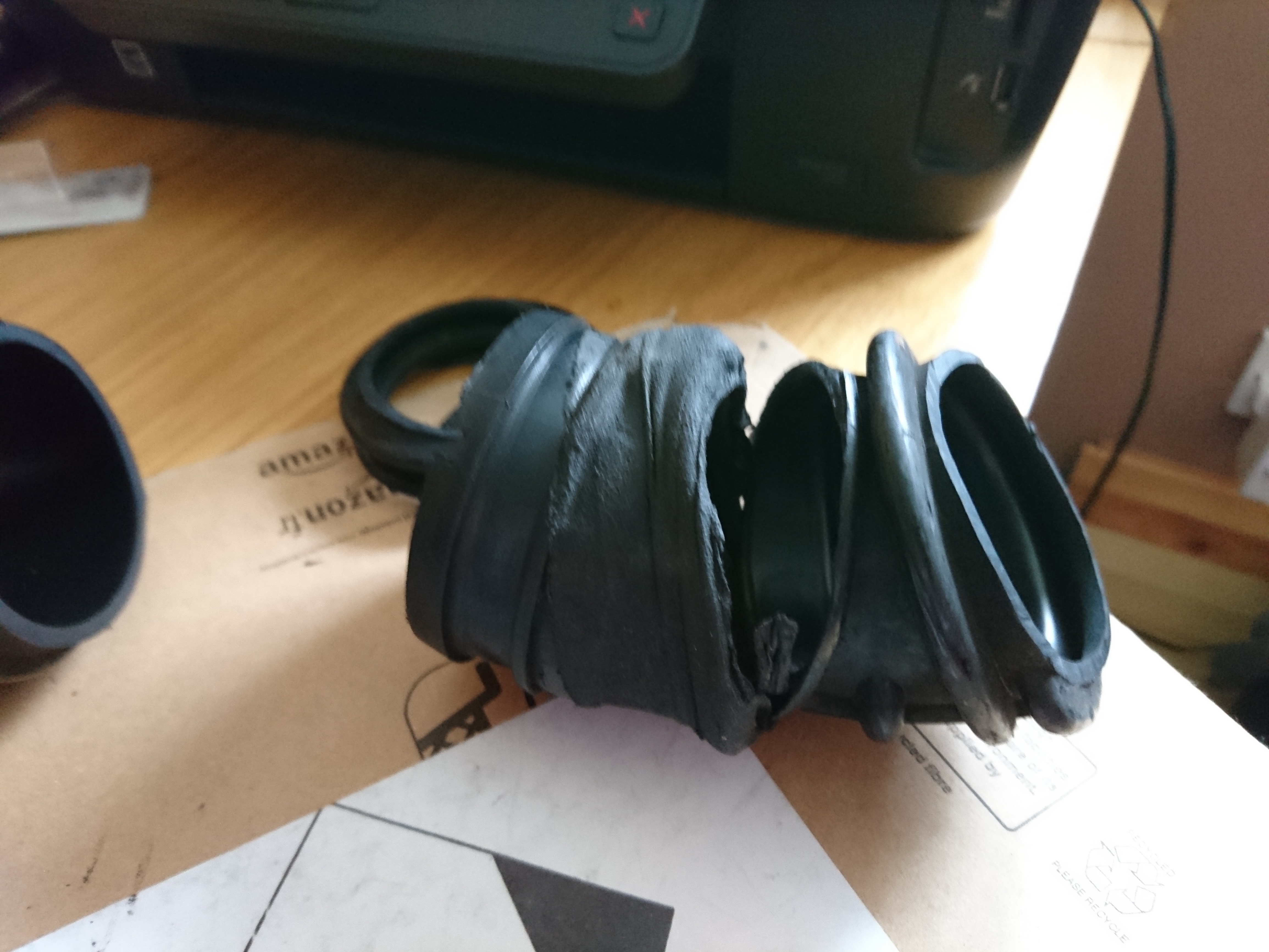

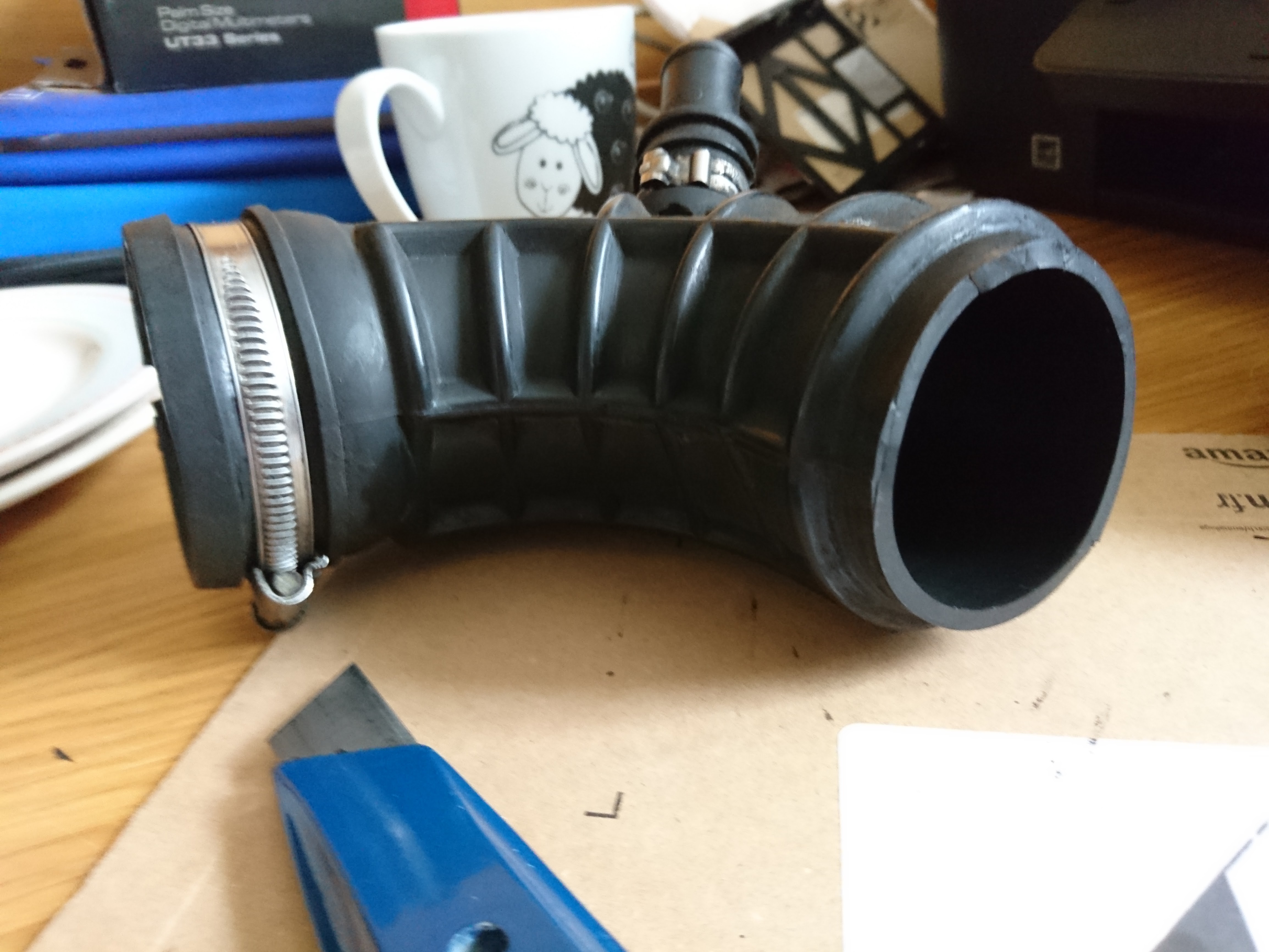

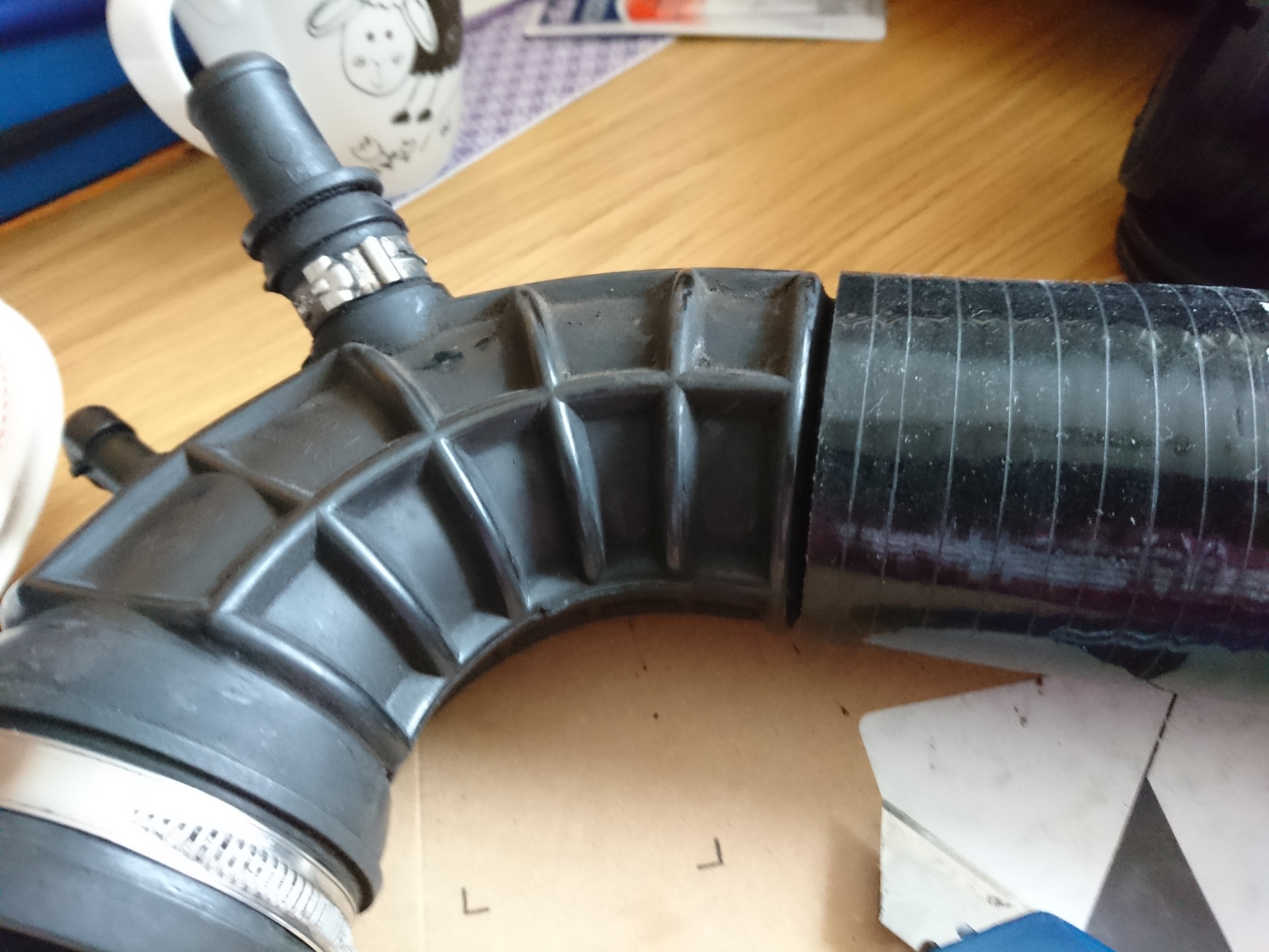

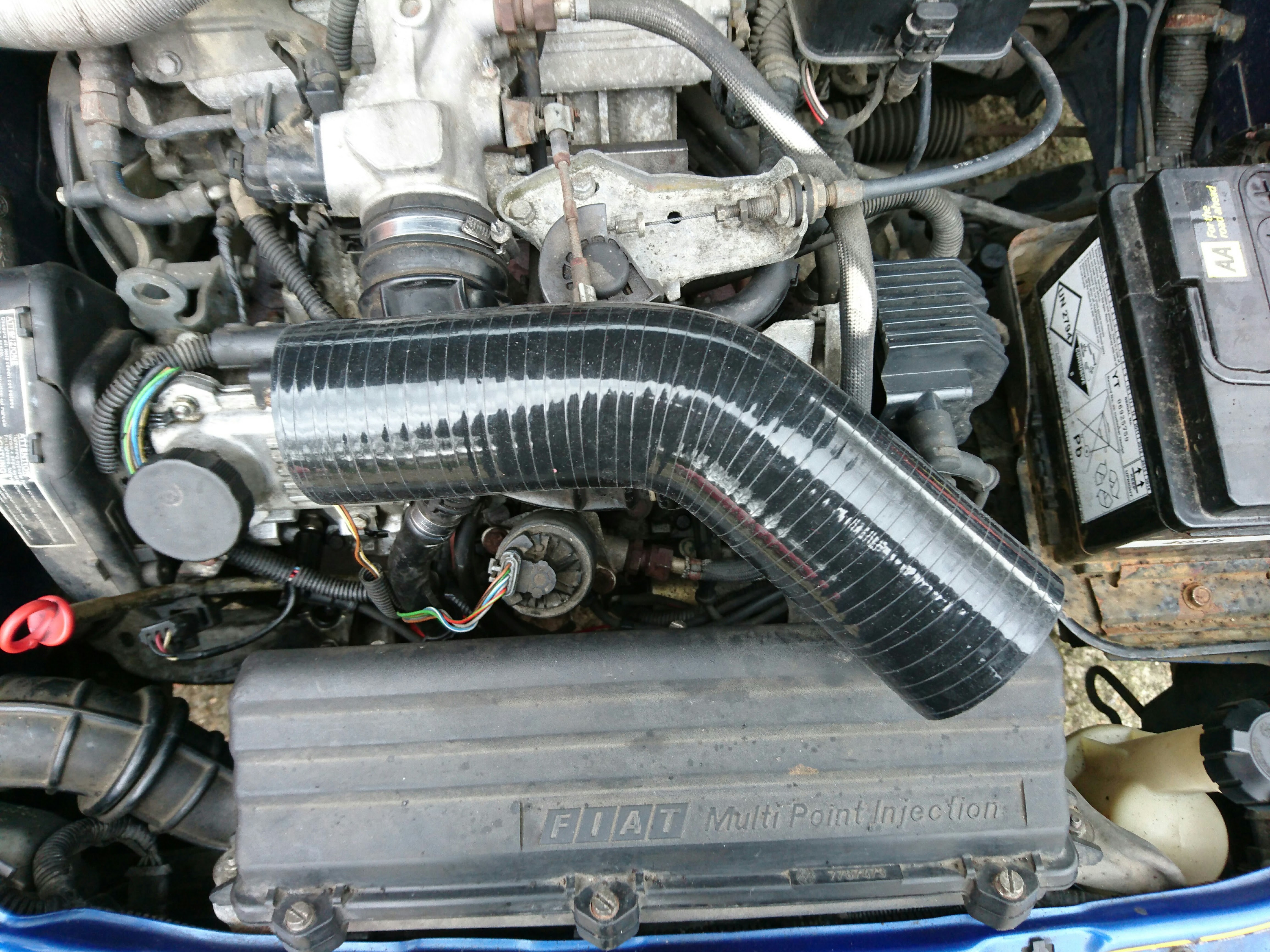

I have successfully repaired/replaced the intake pipe (y)
Bought some silicone pipe with a 45° elbow in it.
Cut the end torn bit off the old pipe and handily the new pipe slides right over it.
Measured, cut, measured again, cut a bit more until I eventually had the right length.
Few jubilee clips later and success a new intake that shouldn't break now :D
Will probably write up a little guide at some point as I assume a lot of 90's are like this.

So have you just pushed the pipe inside the silicone and stuck a jubilee clip round it or is there a actual joiner piece inside there??
I've unloaded so many cans of brake cleaner on the panda engine and general bay area - need to order some more actually as i ran out the other day. Something you should just buy in bulk, I use so much brake cleaner its silly.
Theres a 50mm metal joiner piece yes

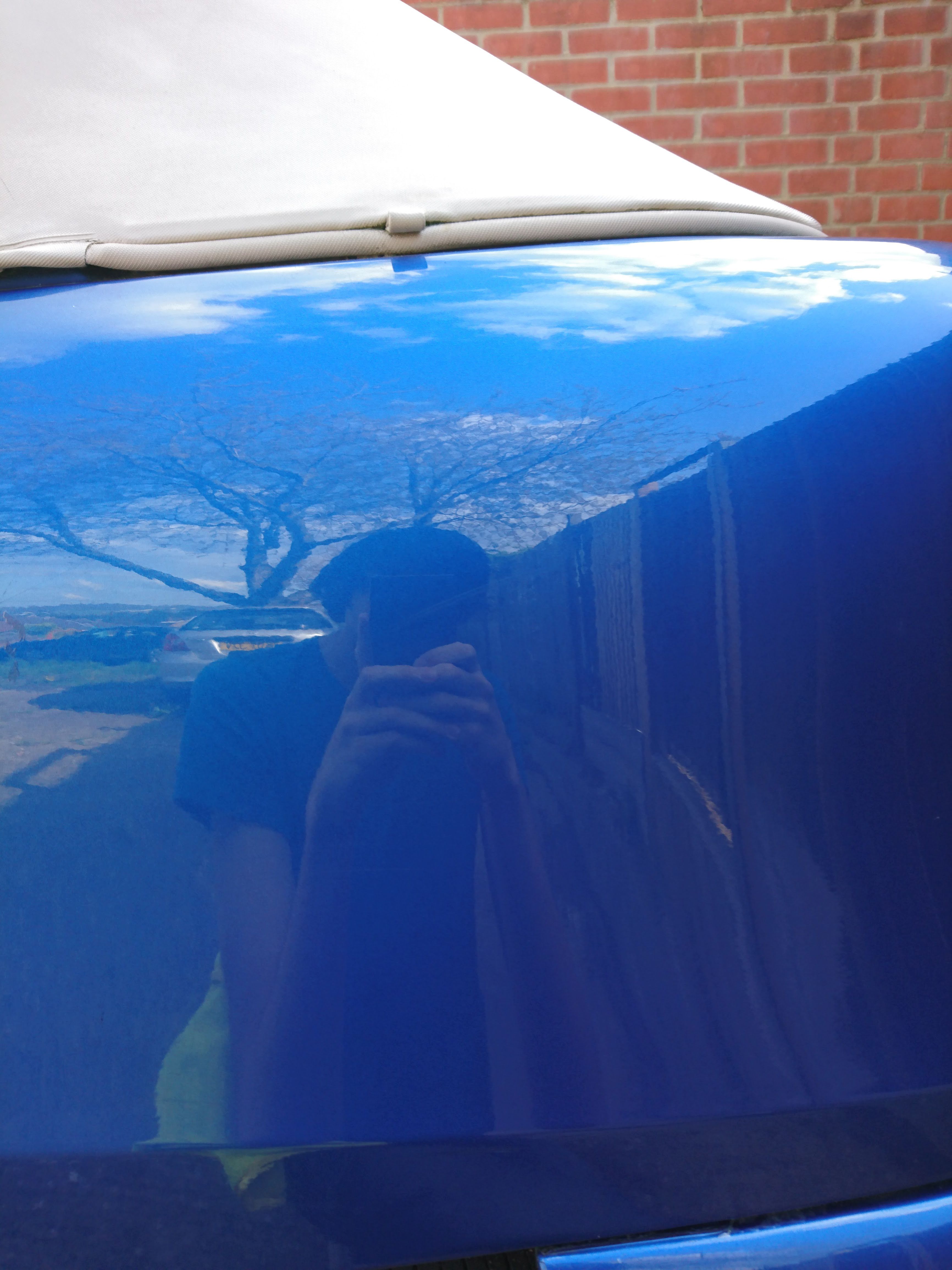

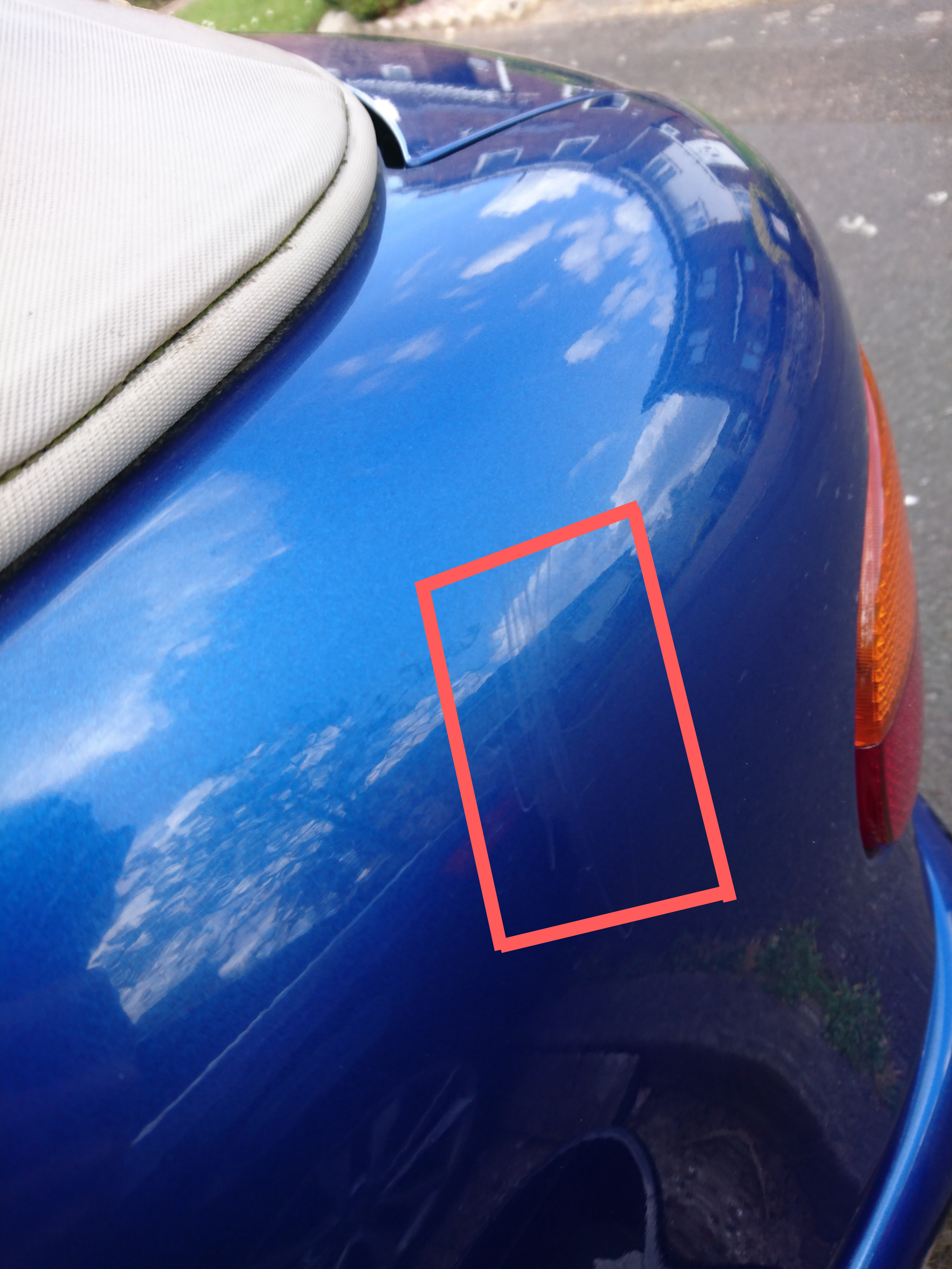

Inspired by blu73 and his work on my old Panda I decided to wash the Punto and try to give it a polish, historically I haven't had much polish as they always seem to come out looking the same... But this time I took my time (about 3hrs in fact) and successfully polished half the car!
These scratches (just two of many) I have managed to completely remove!
Now the panel is shiny and clear from scratches along with some other previously scratched areas of the car (y)
And at last I finally have a picture of the car that I'm proud of! :D (Well this side of the car...)
Tomorrow I plan to do the other side :eek:
