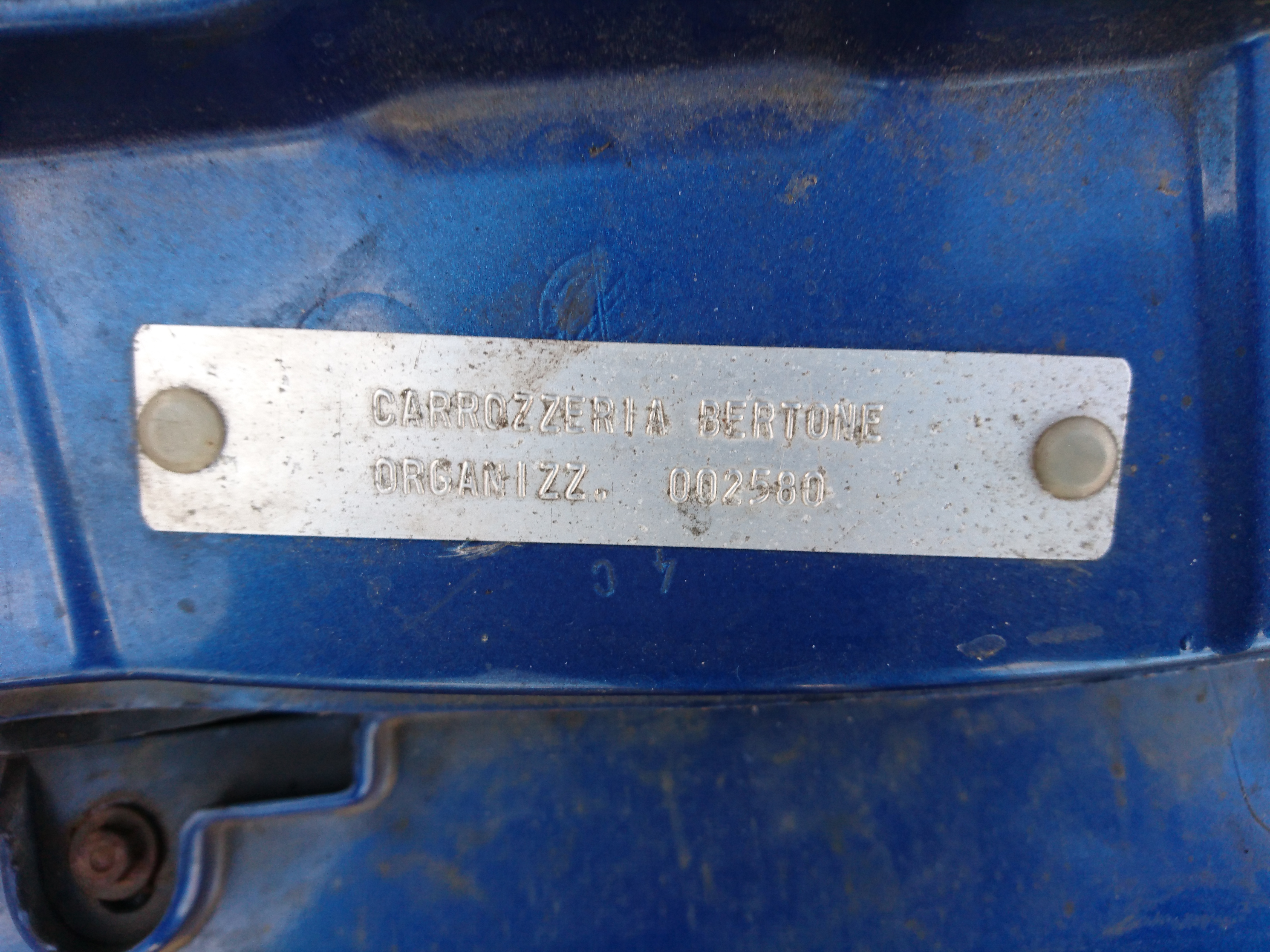

Perhaps you're right speedhunter in that they started to run out of parts for the later Cabrio's and some thing's weren't fitted. Out of interest what number is your Cabrio, you should have a metal plate under the bonnet, just to the right of the O/S headlight that looks like this,
As you can just about make out mine is an early car and is numbered 002580.
Very interesting! Our chassis no is ZFA 176000060443620 engine 0113307 Reg 21 08 98
VIN: ZFA176000*06044315
Engine No.: 0122638
Vehicle No.: 00043387 (or just '043387' on the Carrozzeria Bertone tag)
