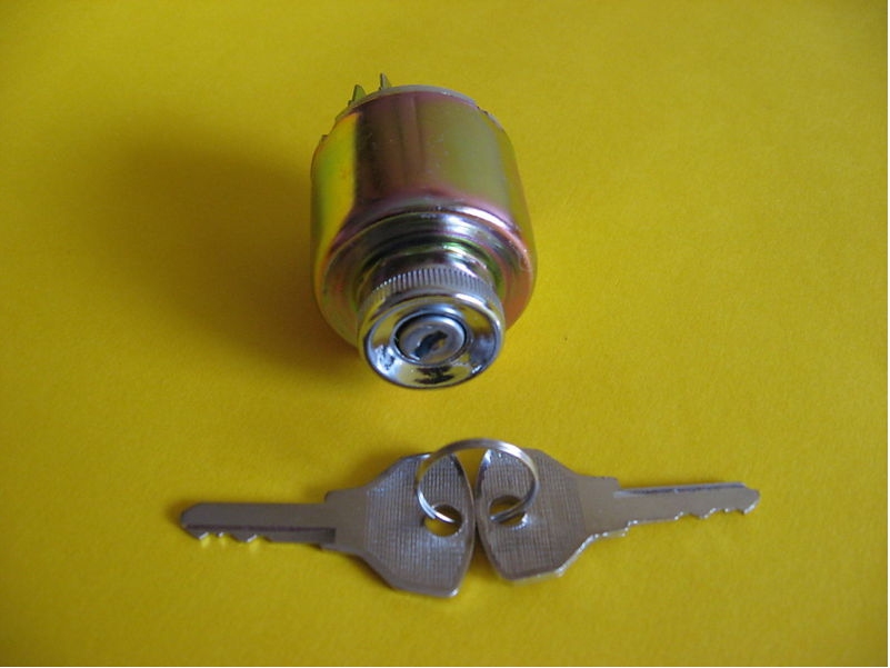

When I converted my car I too ended up with a solenoid starter and rather than fit a start button, I bought an ignition switch for a Fiat 600/850/1100. It fits the hole perfectly, looks original, is easy to connect and has the usual Acc/Off/On/Start positions. They are available on eBay and aren't expensive (~AUD40.00)
I left the levers in-situ and removed the cables. Neither are connected as in my climate even in mid-Winter, I do not require the choke to start the car.
Chris

Hi Chris
This is actually my preferred method and I've ordered one off ebay. When you took the wire from ignition to starter did you have to put a fuse or relay in the line?
Damian
Certainly neater than my solution.... :)
Hey - it's an Italian car. You have to expect some spaghetti ...
For Damian - I talked to a local autoelectrician prior to installing the new ignition switch and he said the neither a fuse nor relay was necessary as the current load is relatively low. A reasonably thick wire (5 to 8 amp rating) will be quite safe. All that is switched in this circuit is the solenoid which then acts as a heavy duty relay switching the big current to the starter itself.
