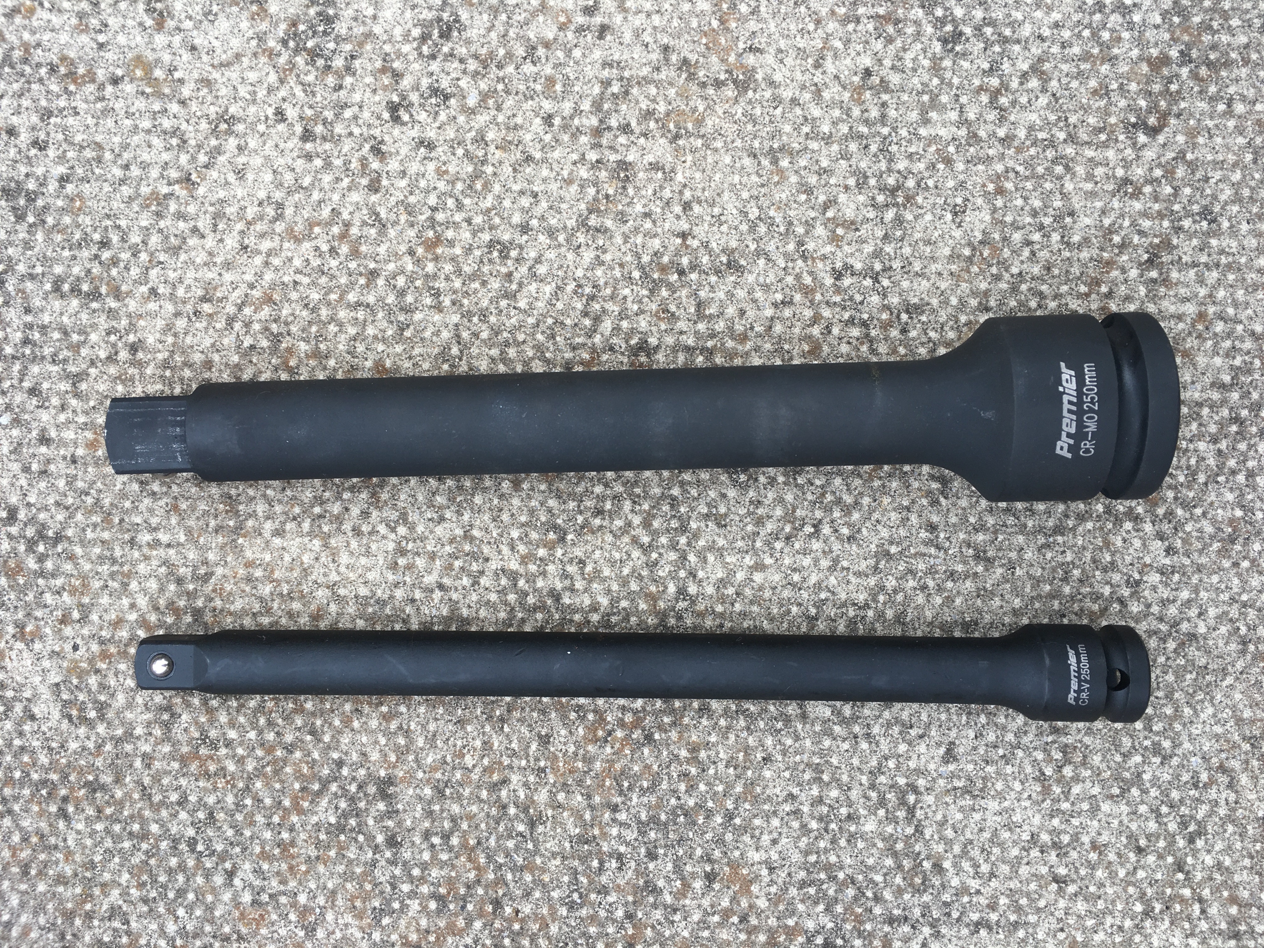

Continuing the 3/4” tool porn, here’s a pic of my 1/2” Sealey 250mm extension versus my 3/4” Sealey 250mm extension. The 1/2” is like a ballpoint pen, whereas you could quite easily beat someone to death with the 3/4” (if so inclined). 3/4” really is a level above if you want to give a tool some stick.
Got my 3/4” breaker on Amazon - think it was a pricing error!
