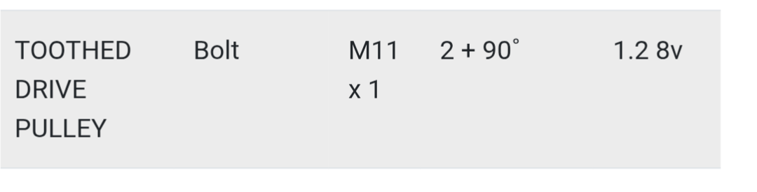

I uploaded a lot of torque values for Panda 169 in the downloads tab.
This is just a just a reminder to peope to check the downloads resources as there is a lot of info in there all organised into sections for different vehicles. Have a rummage folks best done before you are struggling. And do add anything useful you come across too.
