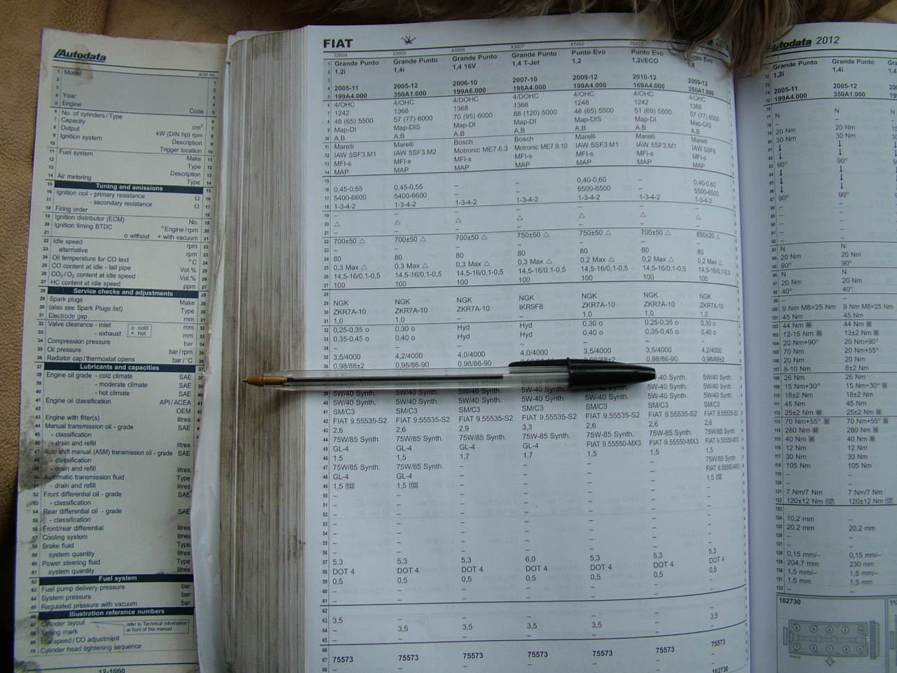

Disagree, engine thermostat opens at 88-90 degrees Centigrade, so coolant pipes at bulkhead going into heater matrix on a fully warmed up engine will be at that temp.
If not for pressurised cooling system that would be just under boiling point.
