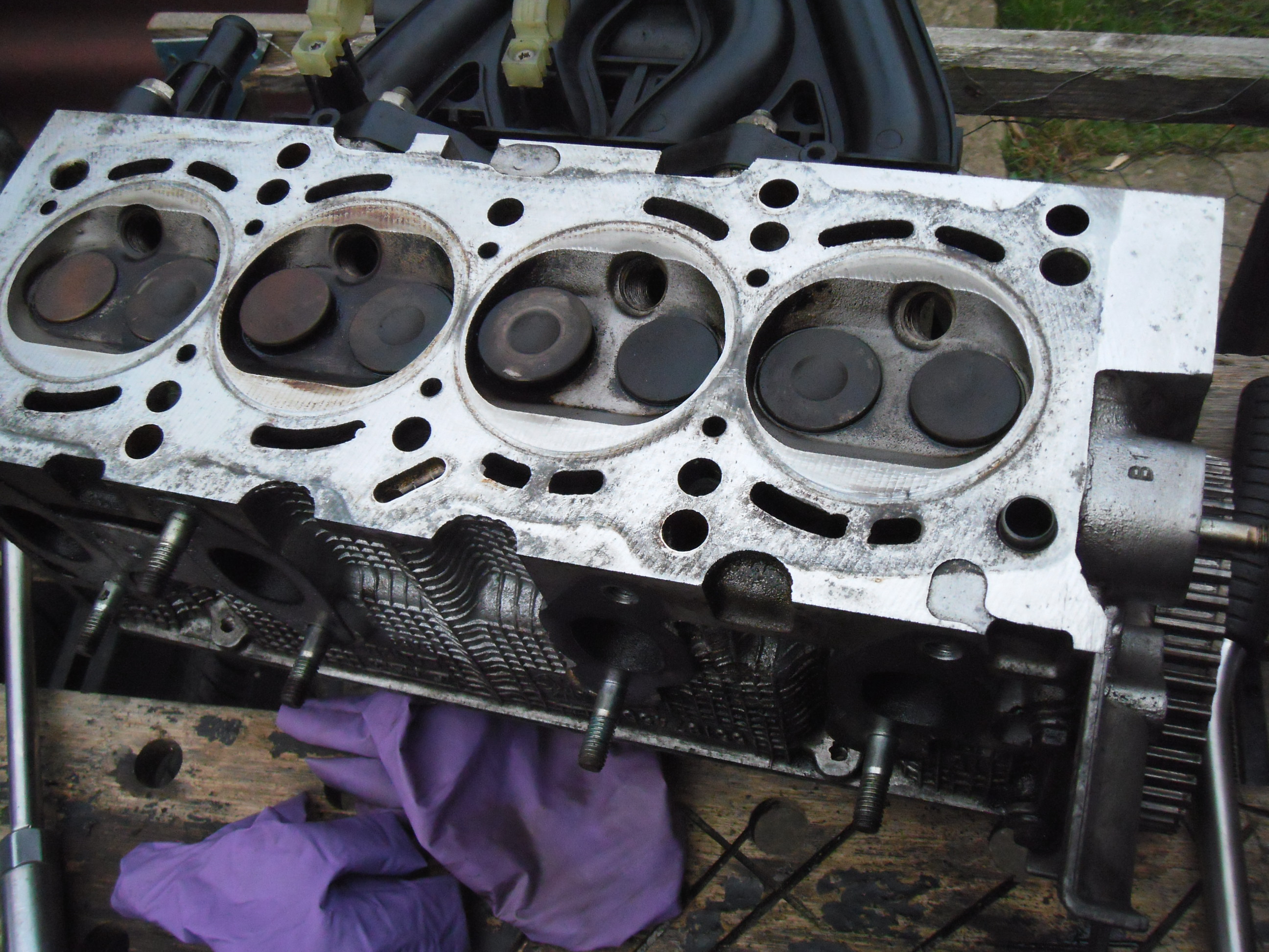

Hello there again,

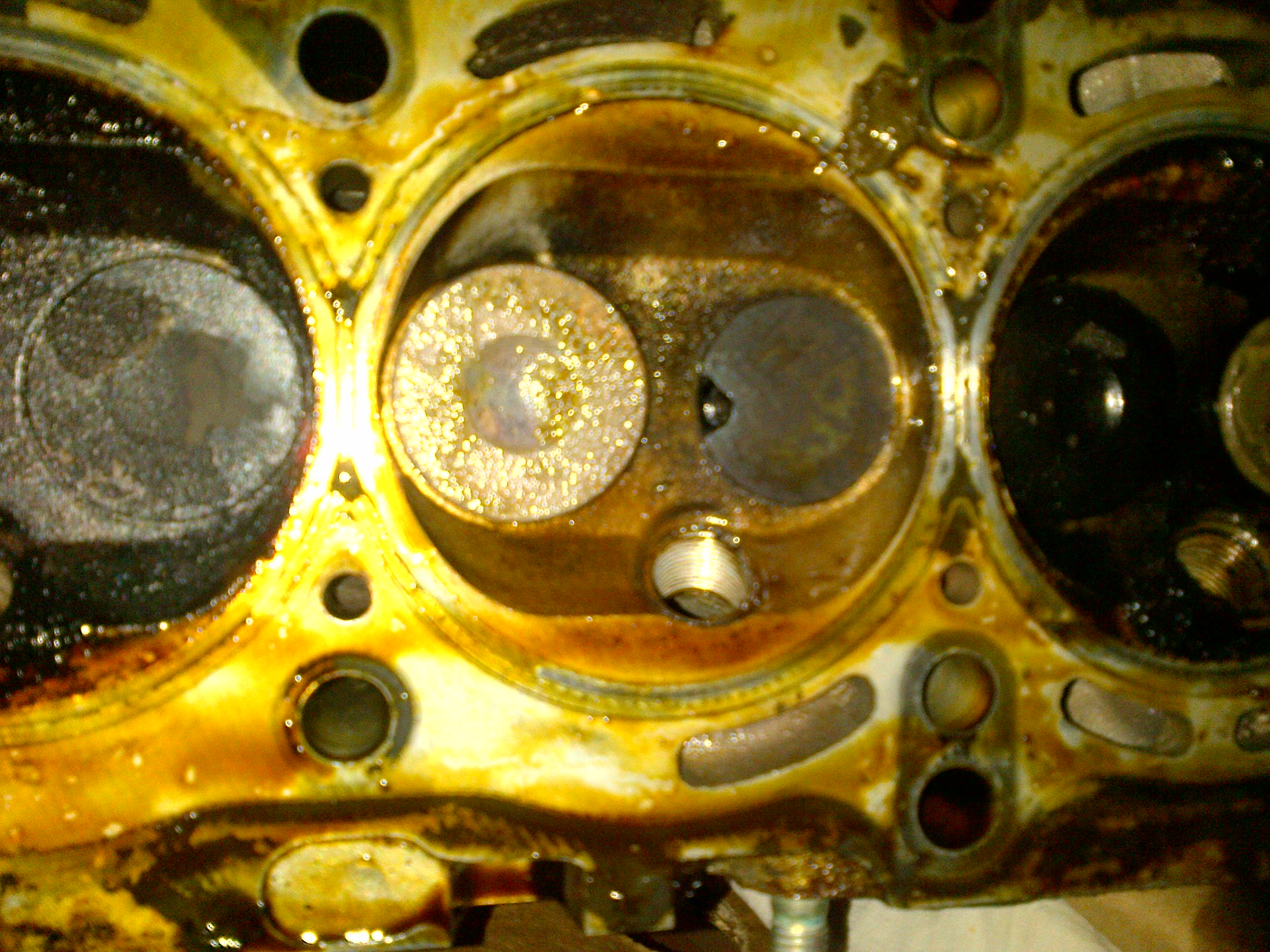

Me and my friend manged to get the head off, took us around 3.5hrs, not a difficult job, just lots of cleaning on the block and inlet ports to do.
Once it was off i discovered the horrors! Cylinder 3 exhaust valve has a substantial chip missing! :eek:
Any idea how this has happened?? :confused:

when you say CHIP.. has it square edges like a mechanical break
..or more rounded = burnt away..??,
Charlie
Hopefully it shouldn't be too costly to sort out!
The only issue is that the engine has moved out of place whilst it has been sat on the jack, hopefully i can move it back into position when i refit the head.
To make sure the job is done properly, how clean does the block need to be to ensure it seals properly?
Do the new head bolts need oiling when i put them in?
Would it be worthwhile purchasing a torque wrench that does angles as well? as i don't have one at the moment
Many thanks, Adam.
The only issue is that the engine has moved out of place whilst it has been sat on the jack, hopefully i can move it back into position when i refit the head. weve all done that one
To make sure the job is done properly, how clean does the block need to be to ensure it seals properly? clean clean,use xome petrol if nothing else to hand
Do the new head bolts need oiling when i put them in? no no no
Would it be worthwhile purchasing a torque wrench that does angles as well? as i don't have one at the moment the angles are angles ie a 1/4 turn is 90 %
Many thanks, Adam.
make sure you put the headgasket on the right way or there will be no oil going up
also you need to carefully check the bore where the valve broke to make sure no marks or the pistons rings will break within a day,usually these bits get kicked down the exhaust so hopefully its rattling about on top of the cat guaze:D
one just knew it was a valve from the start of the thread,i might have just changed the complete head mind just in case the valve stem moves in the coming weeks
Well the head has been send the machine shop to be looked at and I've just ordered the head gasket set. The Fiat parts department that I spoke to said i'm fine to reuse the old head bolts, what are your thoughts on this??
When cleaning the block, do i need to use anything else besides thinners, like fine sand paper or razor blade?
I'm just worried about putting dirt down the bores and oil ways and then trying to clean the debris out.
Does anyone have some good cleaning tips and things to look out for?:)
