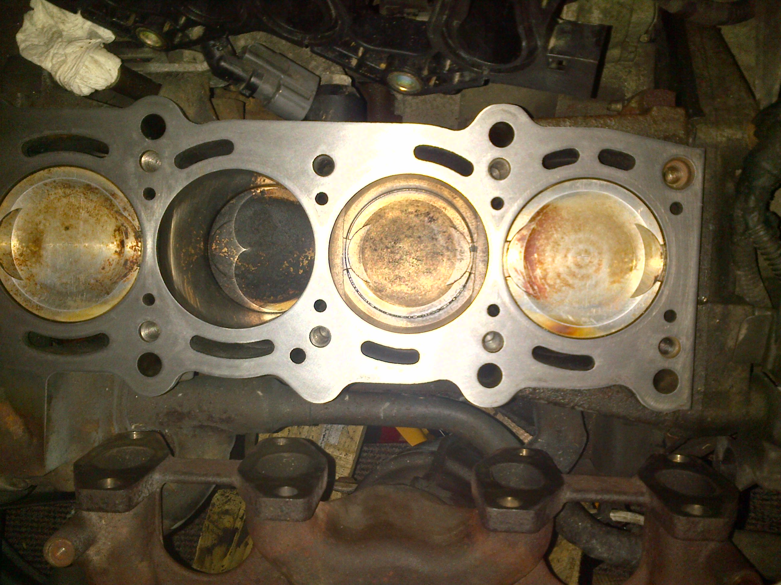

Almost finish the cleaning, has taken well over 4hrs! I've cleaned the block up as best i can trying to remove virtually all traces of the old gasket. All that's left is use air to clean out the bolt holes, and go over everything with some petrol. There are some minor imperfections on the block surface but hopefully it should still seal properly.

looking good..!!(y)
minor imperfections are just that.. it's scratches you want to be wary of.. but I suspect you've just got little pockets / pits which are just the nature of the block,

POST # 24 = am I looking at this pic funny.., :confused:( I'm on pain killers..!!)
3 pistons at TDC and one DOWN..?? :eek:
Charlie
Haha it does look like that from that angle! :p
As for the timing, you were correct, it was 2 teeth out! :rolleyes:
