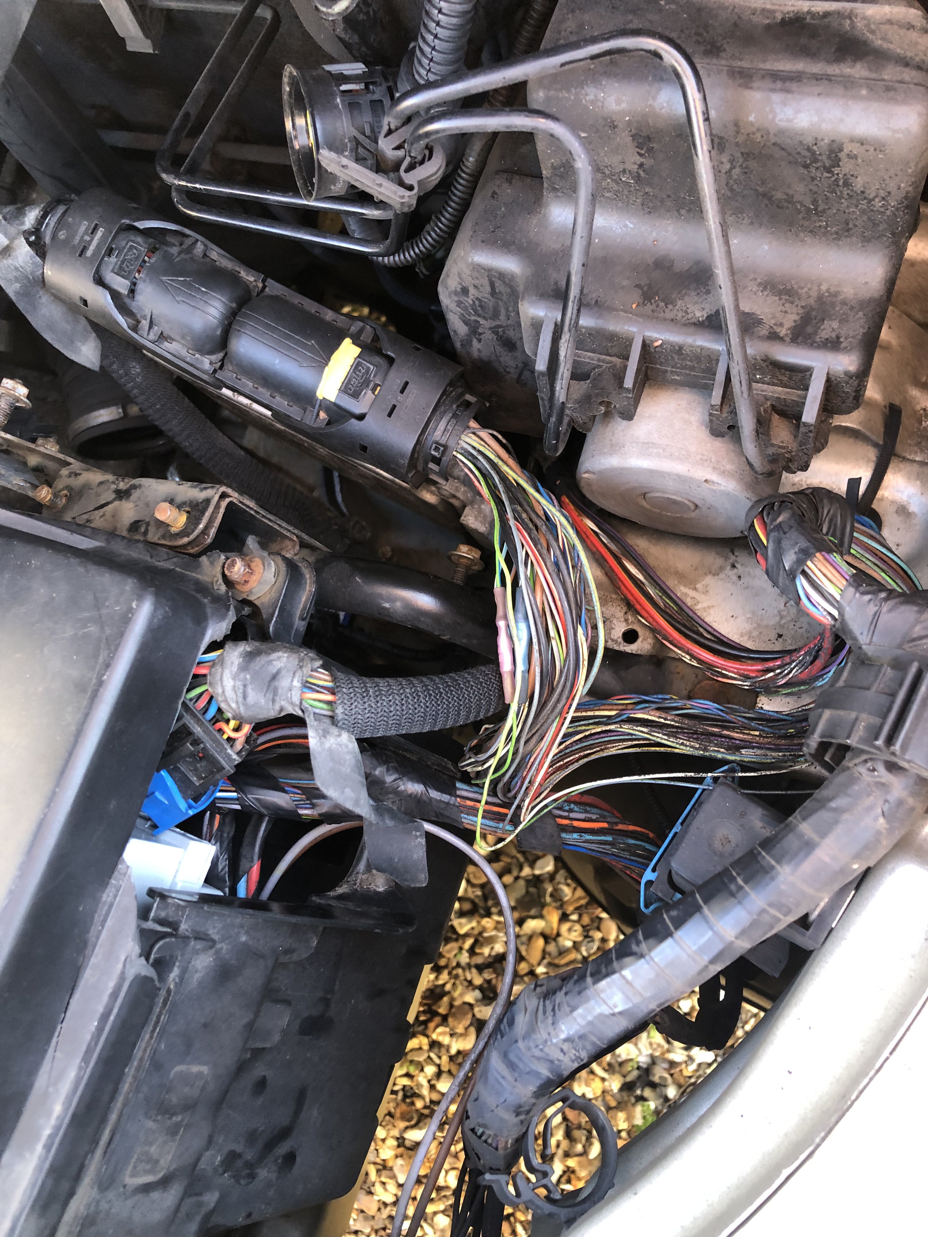

Can you tell us any more about this broken wire so we know exactly where to look and check?
Photo would be Great
Was it chafing somewhere?

Hi mate, the faulty wires were found behind the n/s headlight in the part of the loom connected to the ecu. Easiest to access by removing the headlight. Hope these pics are useful
Thanks for the pics. That seems a common trouble spot. I looked at my X2/50 and was surprised to see the loom had chafed on that smooth round tube, worn the paint off and trapped water, rusting the smooth surface of the tube so it was like sandpaper wearing through the loom!!
