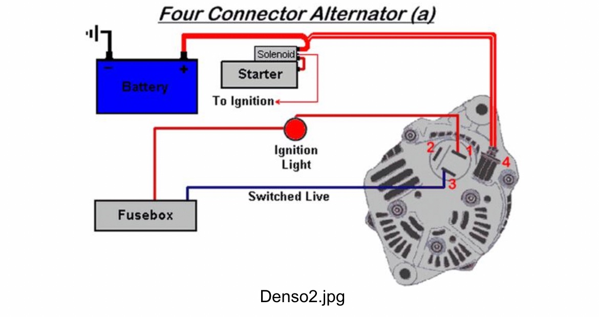

Also the earthing of the starter is just as important, this is normally physically returned from the starter motor casing to the engine, and ultimately through the engine earth strap back to the battery.

Also the earthing of the starter is just as important, this is normally physically returned from the starter motor casing to the engine, and ultimately through the engine earth strap back to the battery. View attachment 468830
