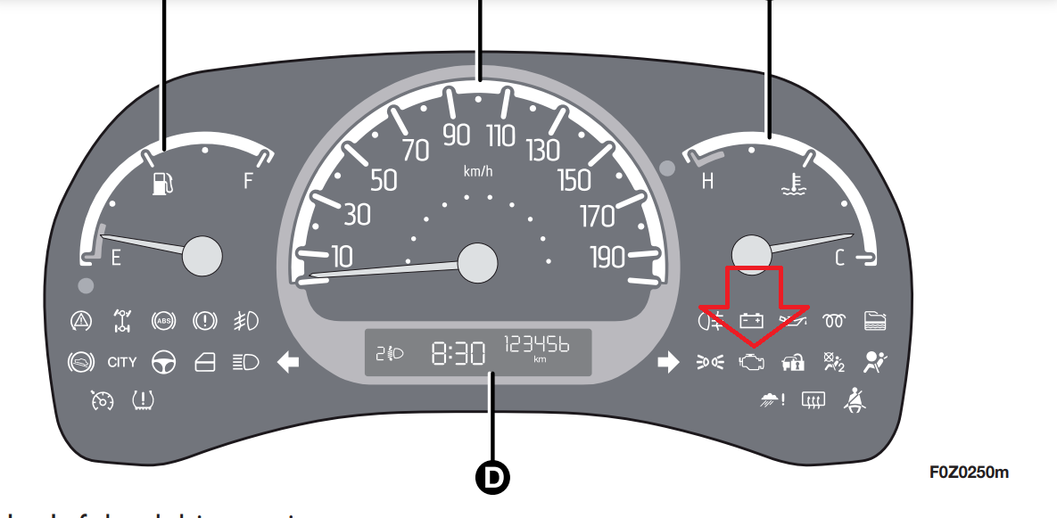

active petrol doesn't have an injector error light as far as I know
do you mean this one
most problems are simple and cheap to repair. But we don't have enough info to move forwards yet
most people except Fiat would call that the engine check light
the engine computer has detected a problem somewhere I the system
you can not from the lamp tell where
