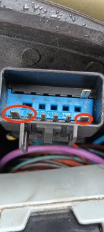

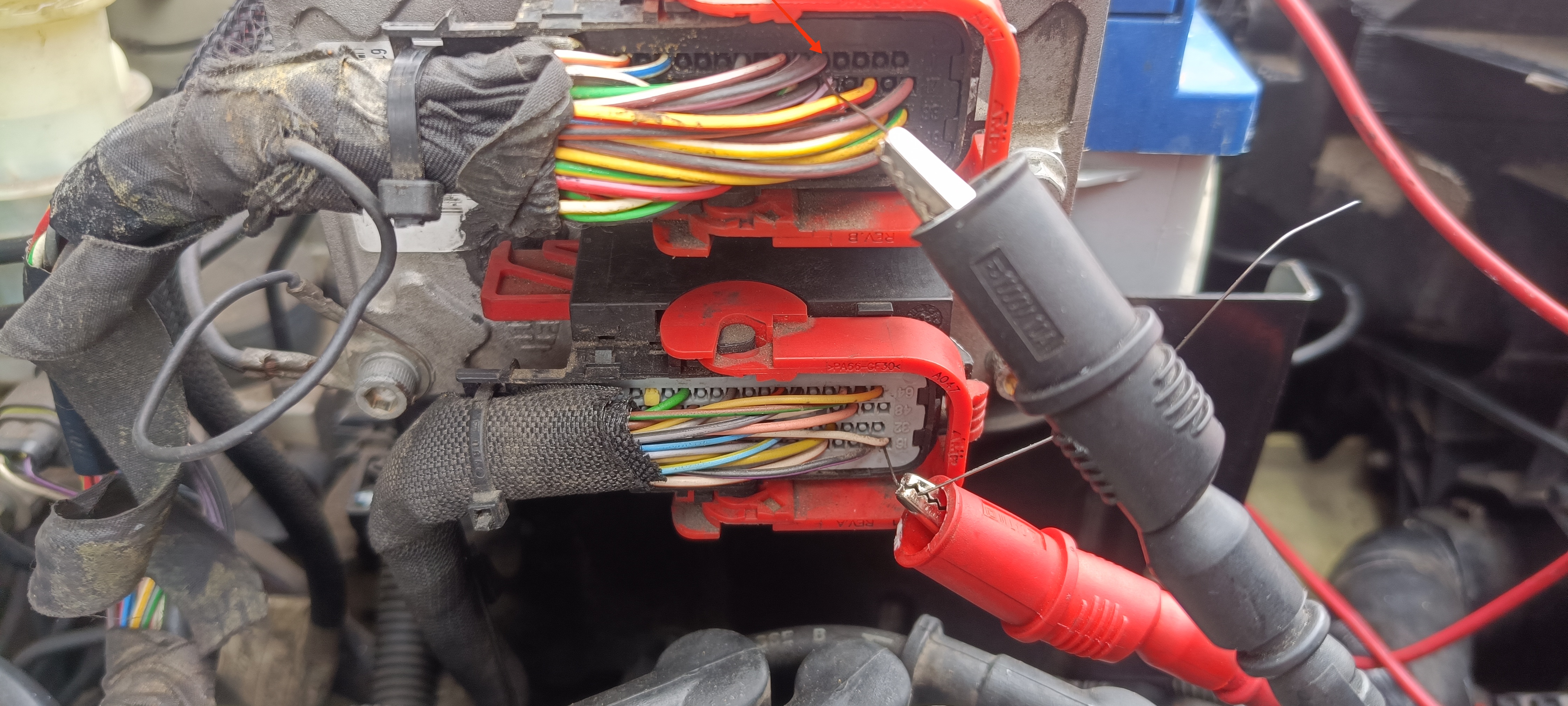

These are all 4 wires in the upper loom next to each other

There is also a black and purple next to the red and white if you can see it in the pic

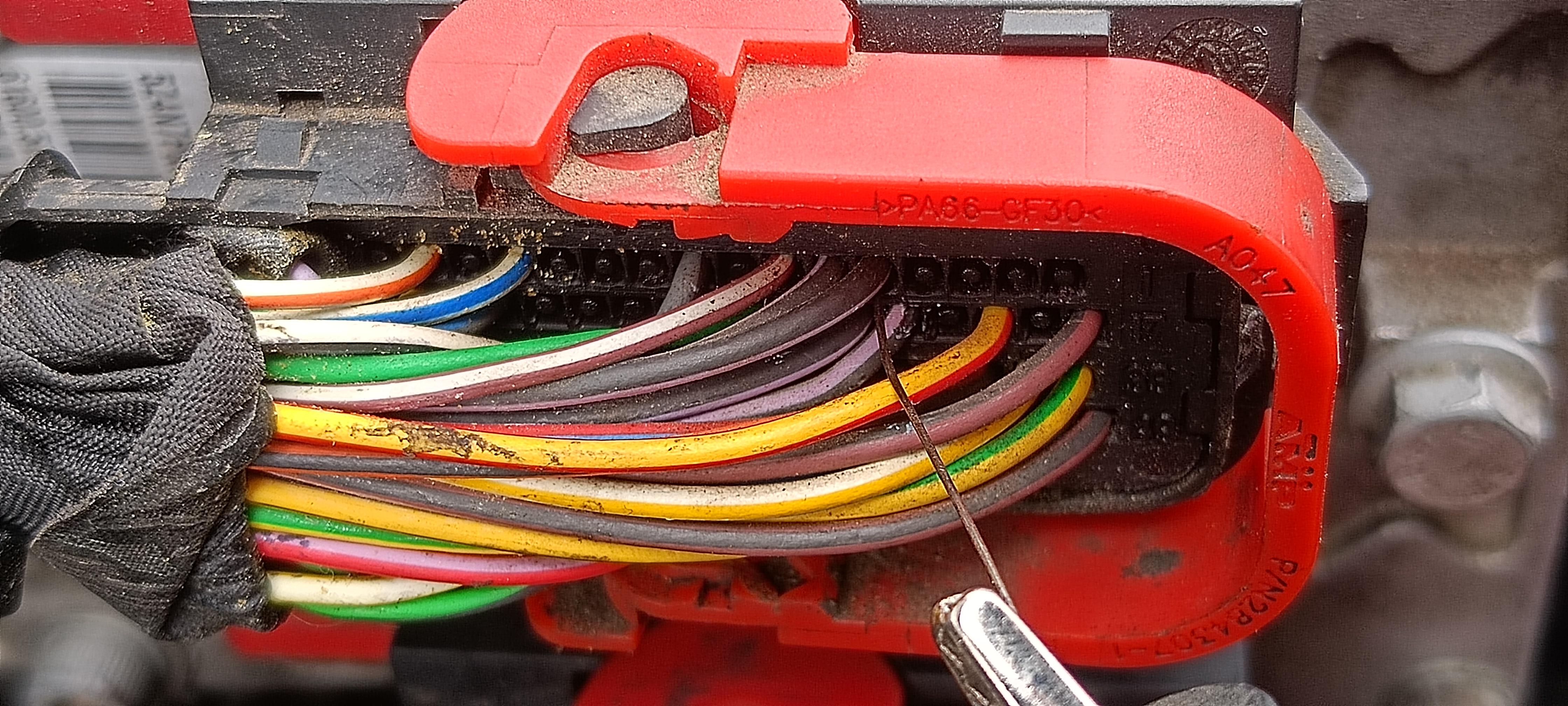

I'm getting continuity between these pins and wire

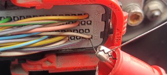

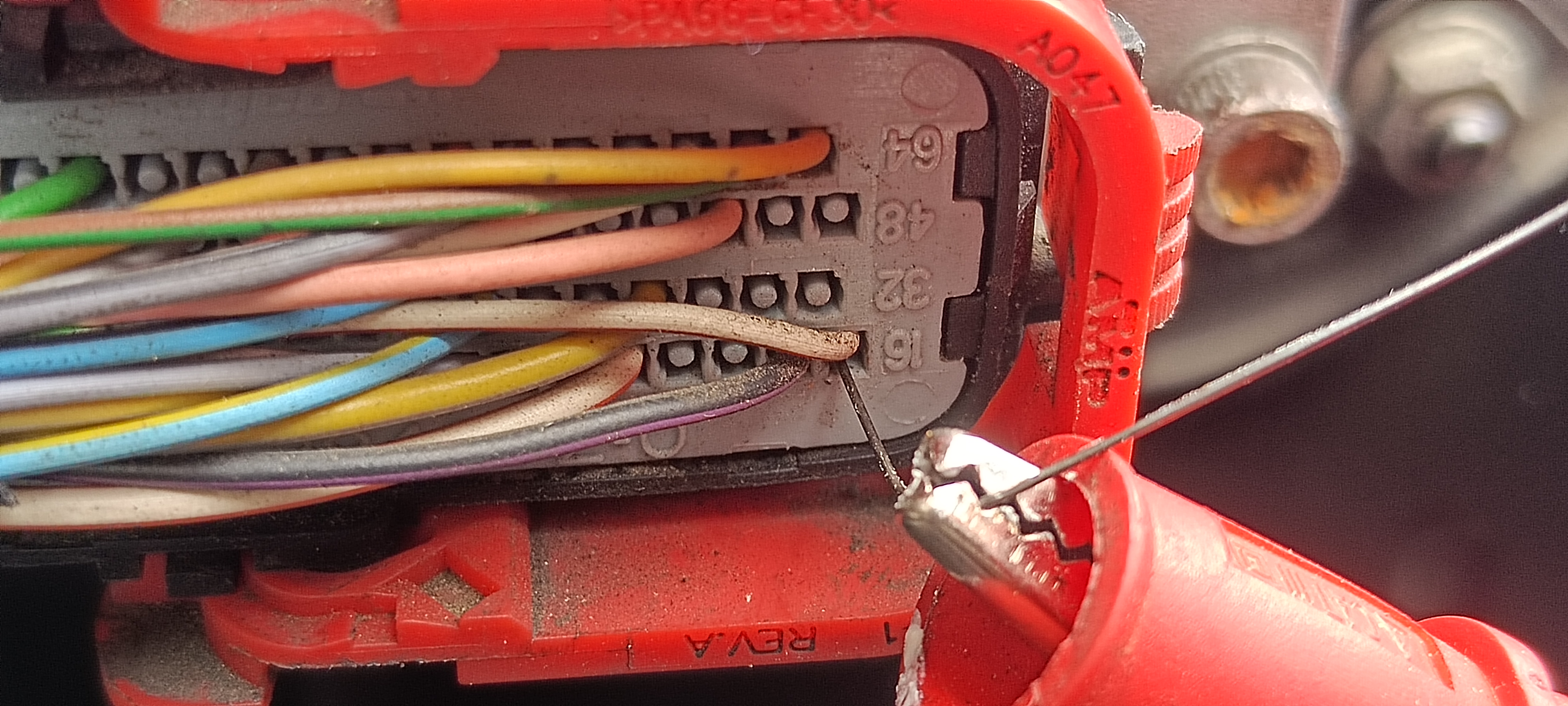

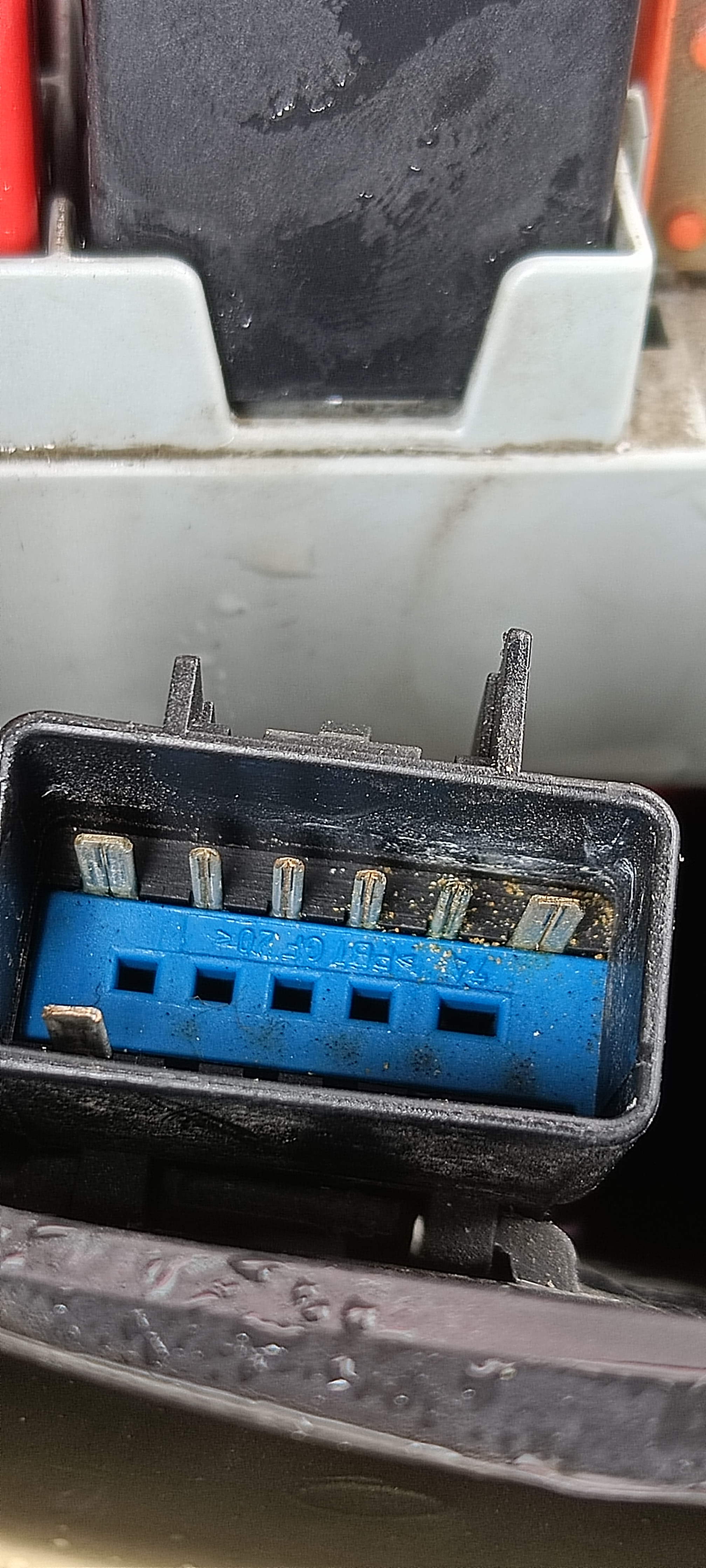

That's the upper connector not the one with the red and white can you mark the pins? Wires are coming from the right side of the picture

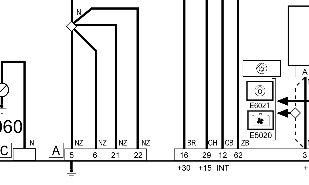

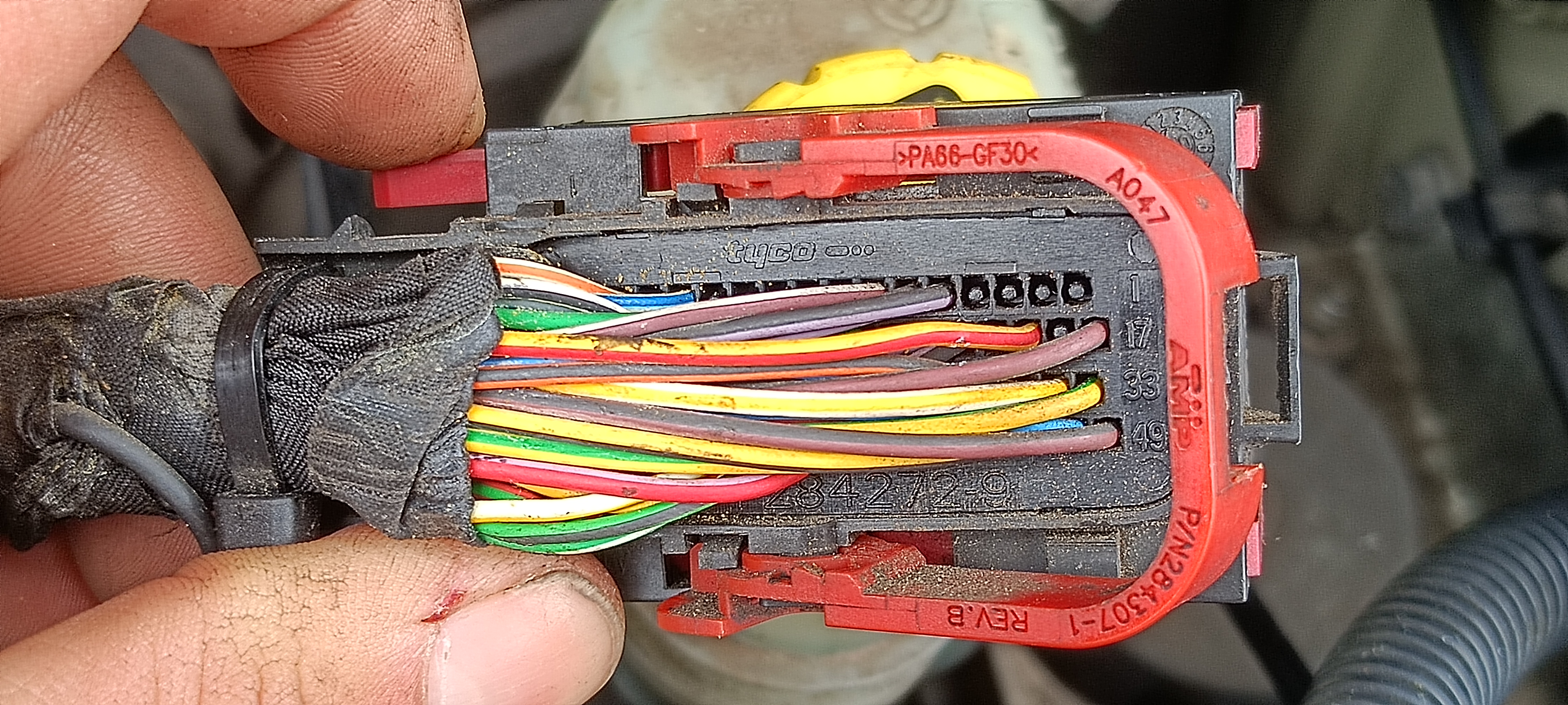

Found the numbers on the back 5 and 6 are correct the ones i was checking but there is 17 on the 2nd row how can i be sure that the 2 beneath 5 and 6 are 21 and 22?

And based on the seeable pins from inside the loom 21 is for the CPS and 22,23 are black and purple
That's what i mean and yeah these are all 4 how do you want me to test them?
While plugged ignition off the 2 on the left are giving battery voltage with the red and white but the 2 on the right are giving 9.6 and 9.3 v up and down respectively
