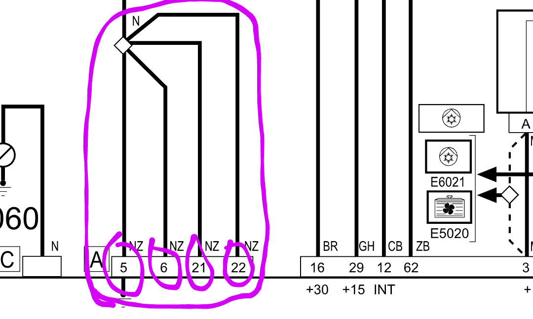

Traceback the 3 connected black and purple based on the diagram you sent? Aka possibly a bad joint?

The diagram I am using is wrong
But so far it look to me we have found a problem
All four wires should be identical

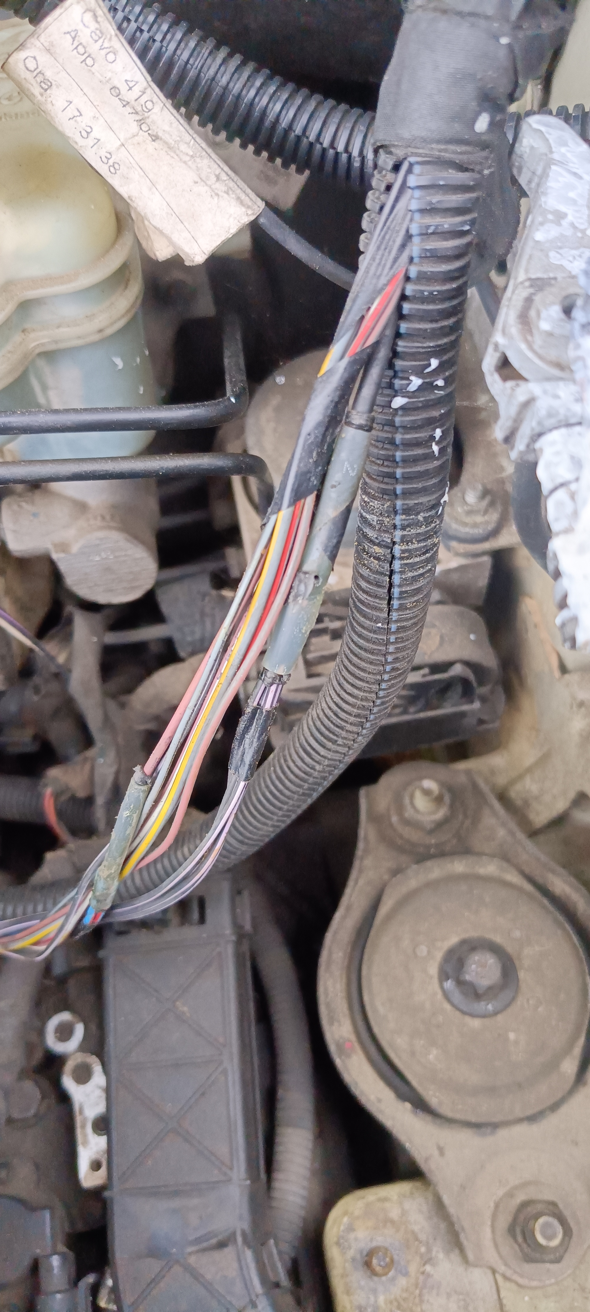

Hi there cut it open?
We don't know if the problem is before the joint
Black and purple cables
At the joint
Or in the black cable
Or the other end of the black cable is connected to the wrong place
We can confirm or eliminate the purple and black wires
By measure between each of the pins at the ECU
And check for continuity
What do you mean? It's a black thick wire to the 4 wires on the ecu and here's the connection in the picture, what do you want me to do now?

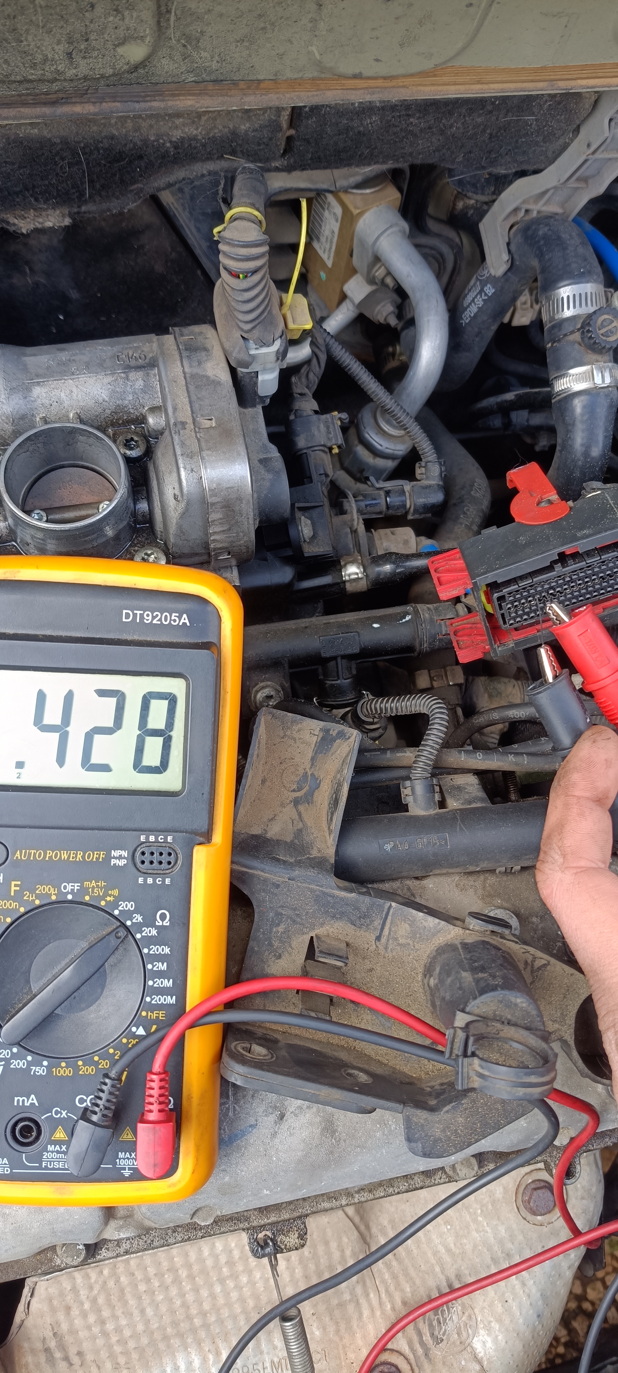

Very first pins i plugged in
And it's dropping slowly when it reached the 250 it started going down quickly till 160 then started going back up it's very unsteady value
It keeps waving between 360 and 160 no idea why and the battery is disconnected
It's mostly steady now like that flickering a little between the 2 pins without touching anything
