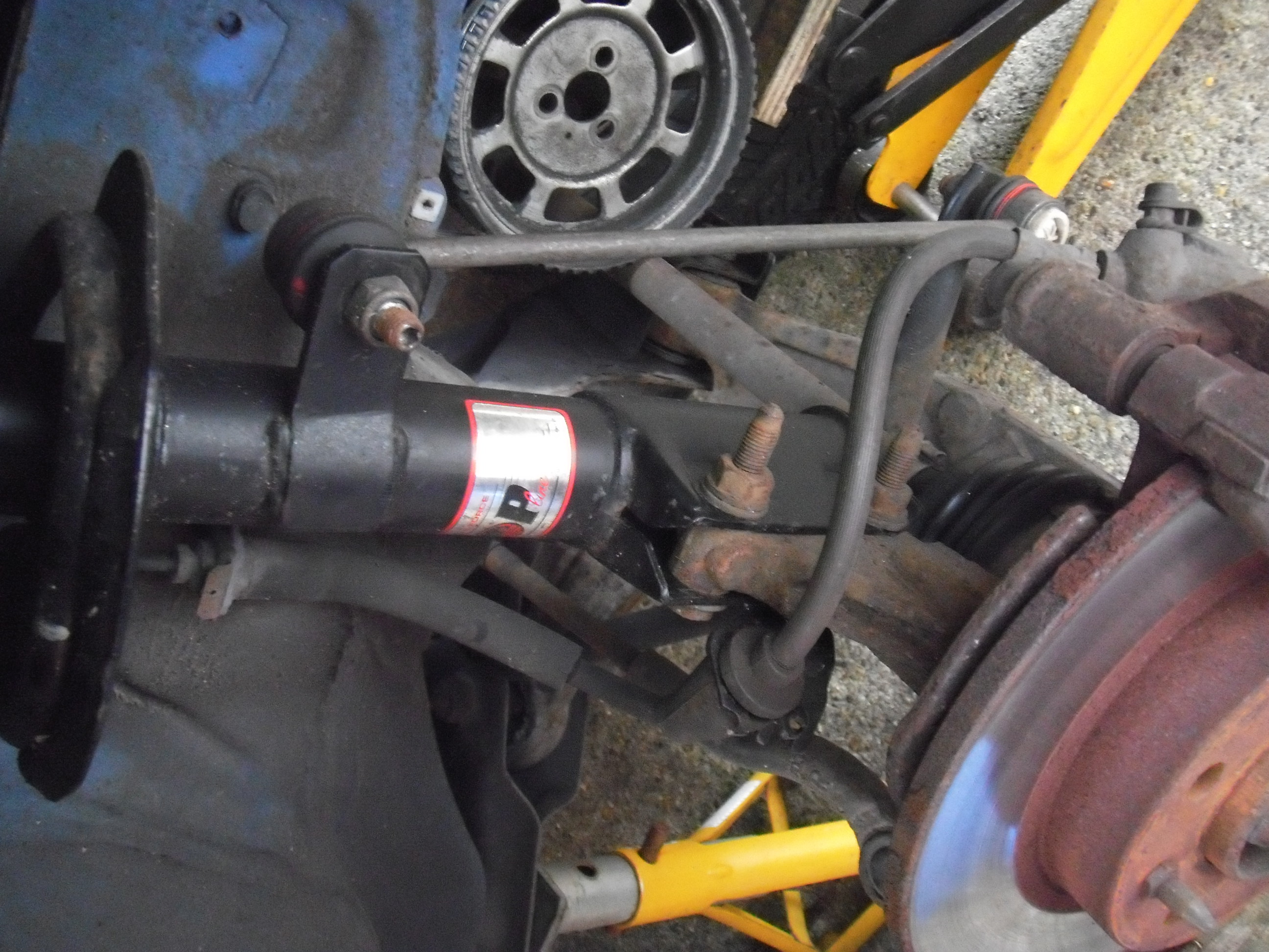

place a trolley jack under engine sump pan,
using a plate of solid wood as a load spreader
take the weight of the engine, you do NOT need to jack up the car..it can remain on it's wheels.
however for access / better pics I've removed the RHS front wheel, this may be the better option.
