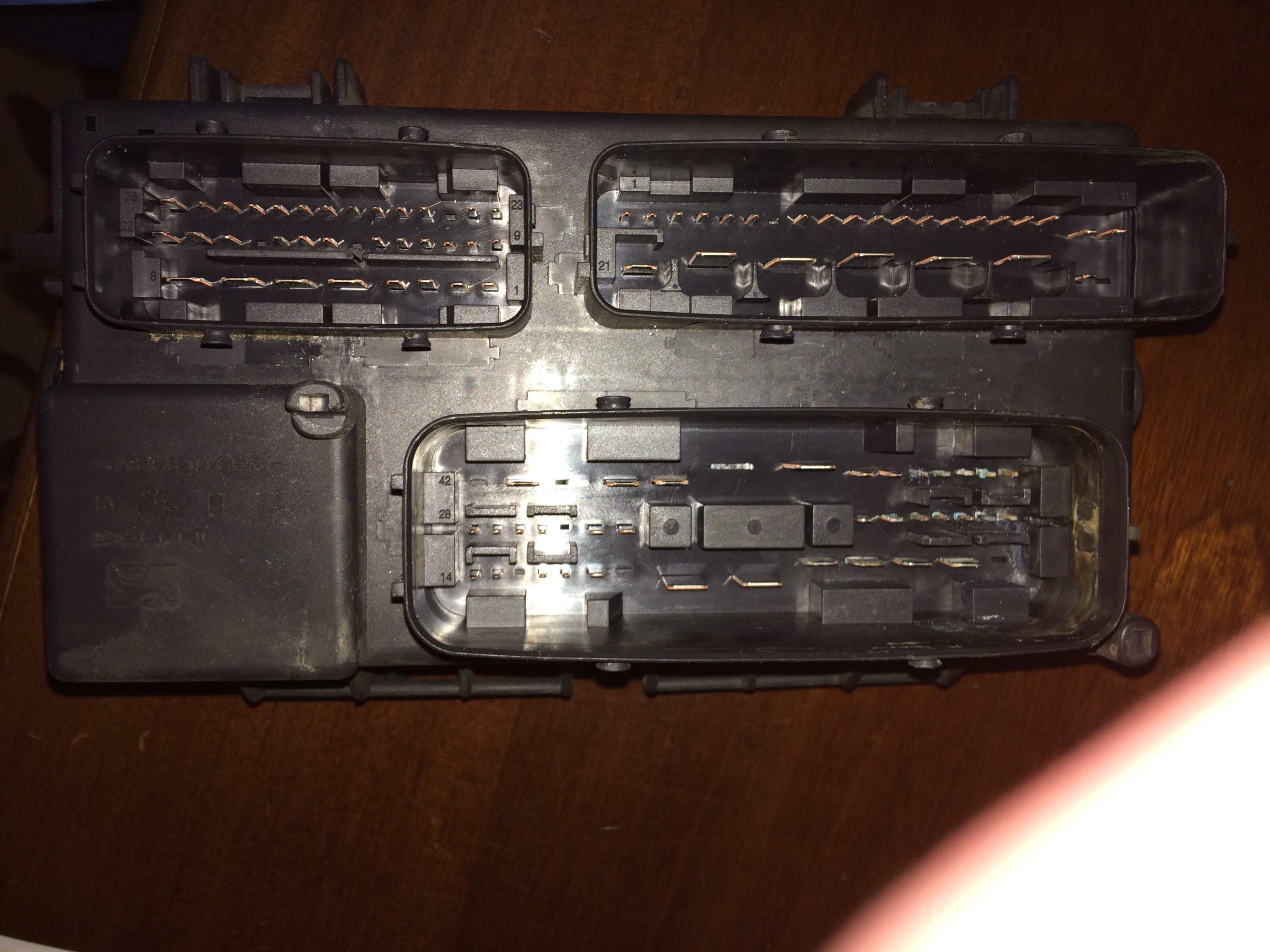

My daughter's 2007 1.2 Active had door open warning light on all the time, and other warning lights on intermittently. Periodically the headlamps would come on themselves and also the feed to the starter was also not getting power. I suspect that possibly the fuel pump wasn't getting power either, as the car refused to start with a tow.
