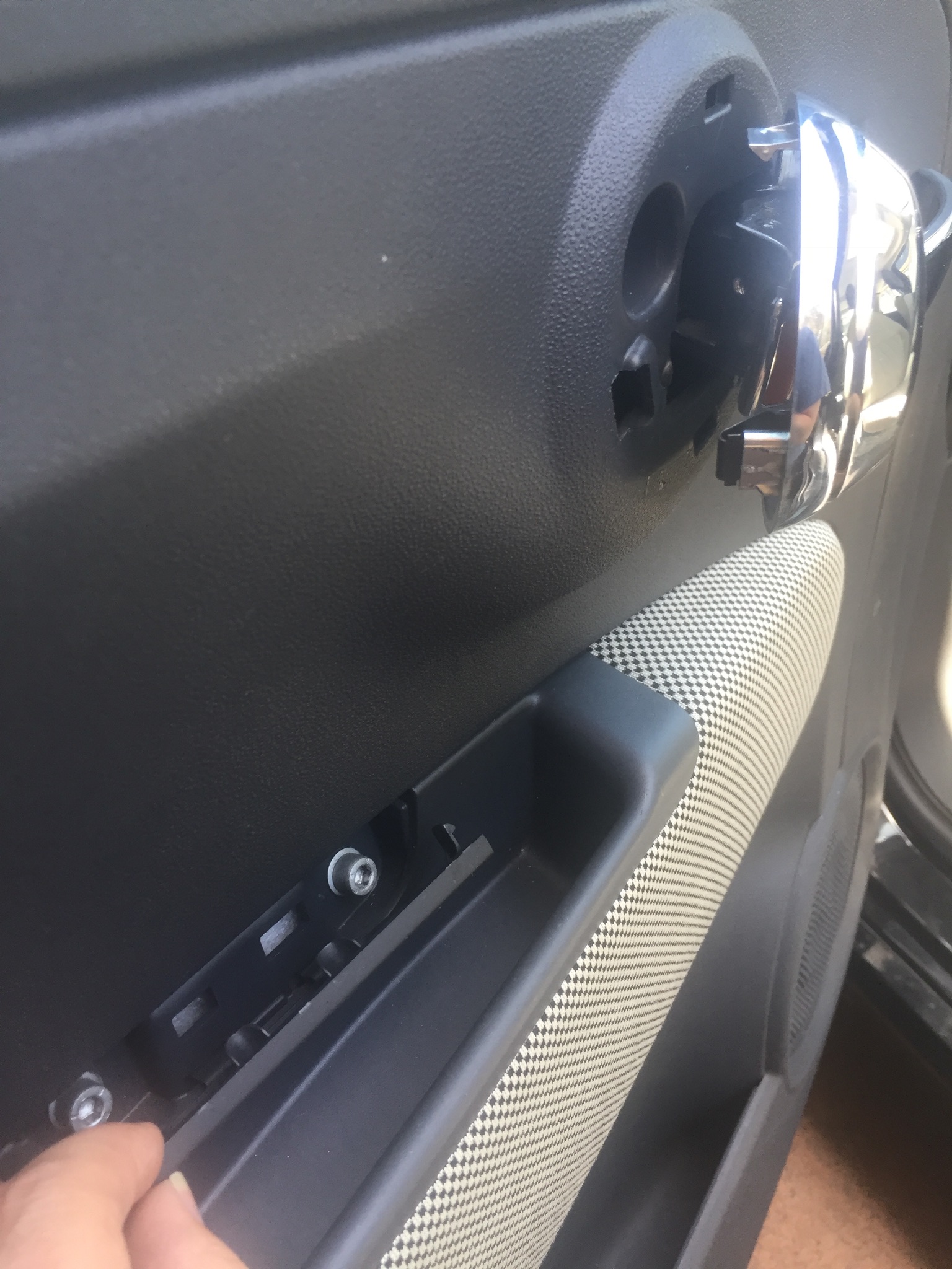

Start by prying off the shiny chrome escutcheon from around the door release interior handle - use your fingers or a screwdriver carefully applied. See photo 1 for the location of the clip (towards the back of the door). There is now a hex cap screw exposed - undo this with a 5mm Allen key or socket bit. I use an electric impact driver to speed things up. But there is nothing wrong with basic hand tools. A useful tip is to use a deep-reach socket (5mm to 8mm) to extend the short part of an Allen key - gives you a bit more torque to loosen tight screws.
Flip out the plastic panel in the door pull as shown. This exposes two more 5mm hex cap screws; undo these.

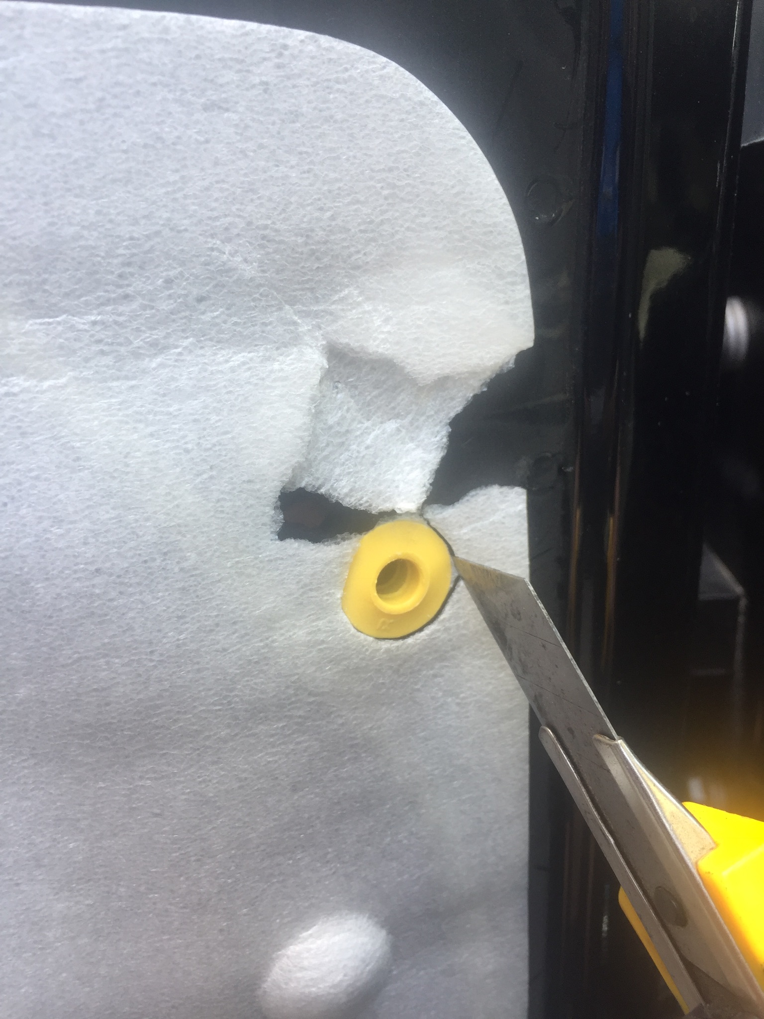

The white foam sheet fastened to the door requires care to remove. Resist the temptation to peel at the edge with your fingers - it will rip sooner or later. Instead, get a sharp knife and cut around any yellow grommets that are pressed through the sheet.

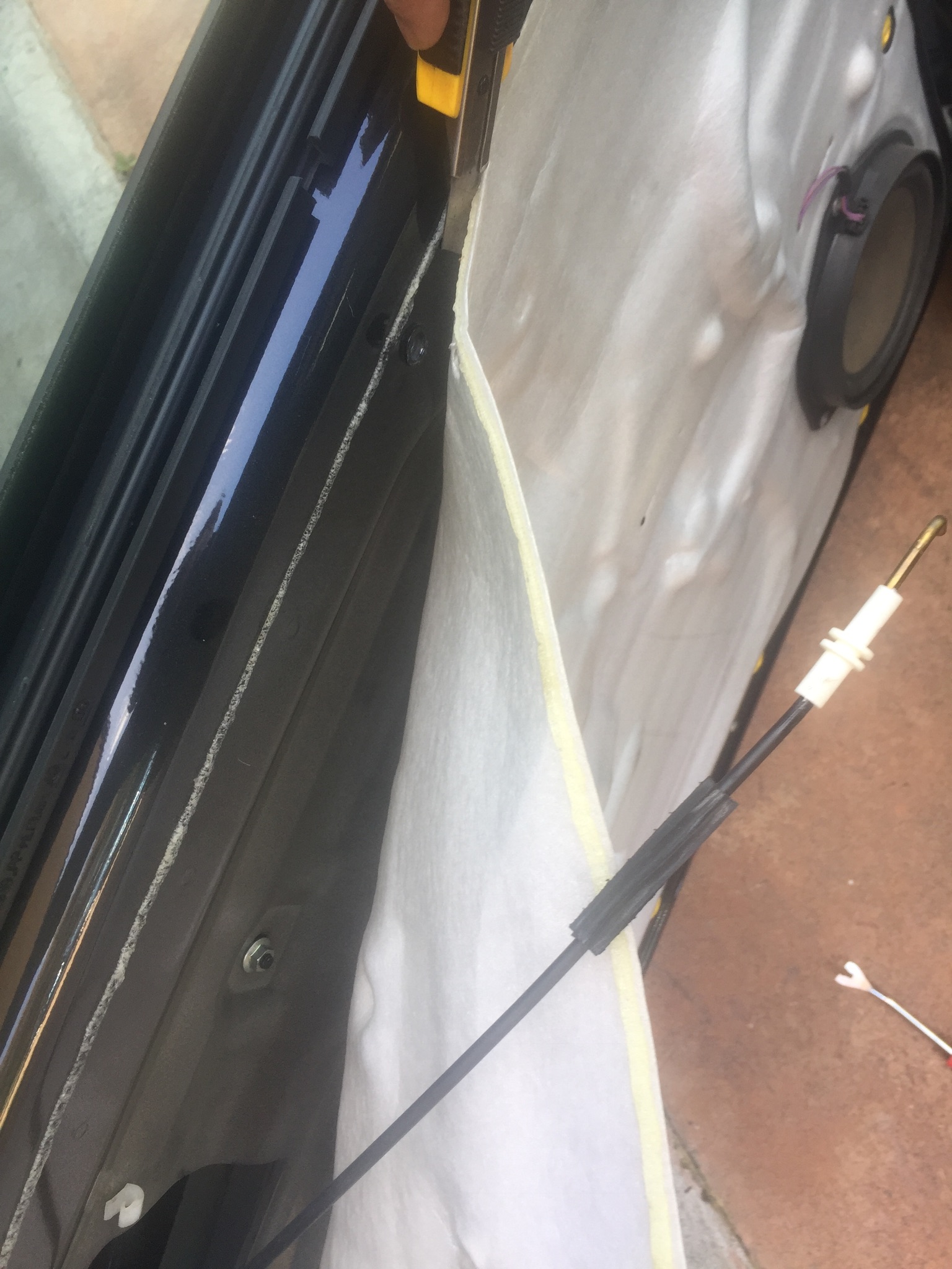

Then use the knife to cut through the adhesive bead as you peel the sheet off carefully. The adhesive will later re-join where you have cut it.
It isn't possible to remove the sheet completely unless you remove the riveted-on speaker housing. So, just cut the adhesive most of the way around and allow the sheet to hang down over the speaker - you'll have plenty of access for replacing the window regulator this way.
