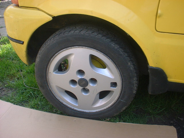

The offending wheel, round, and loose.
Jack up the rear arm, remove wheel.

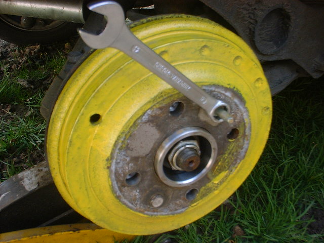

Remove dust cap covering the nut, release the staking from the nut to allow it to turn. I left the drum bolt/pin attached to the hub at this point, I was told removal would be easier with the lack of a puller [which wasnt needed!]
Pull drum/hub off the stub axle, mine just slipped off easily.
Then I removed the pin and bolt, to seperate hub from drum.

Apply handbrake and refit wheel

Takes about 30mins, you will need a good jack, wheelbrace, breaker bar with 30mm socket, 12mm spanner, mug of tea. No swear words needed for this job, its simple!! Oh yes, a new bearing/hub assembly!!! [if you are replacing]
