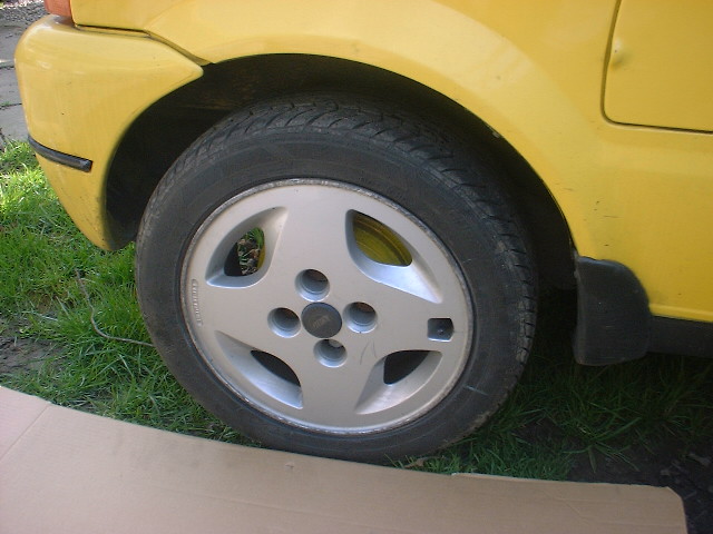

The offending wheel, round, and loose.
Jack up the rear arm, remove wheel.
